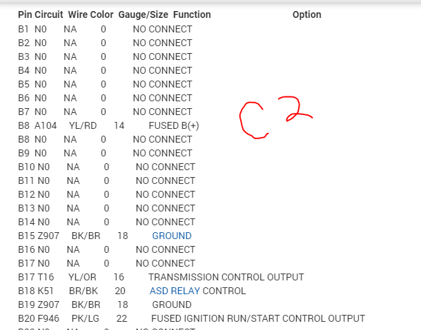

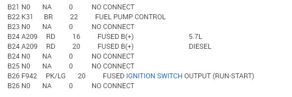

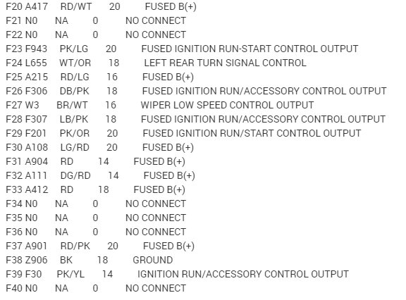

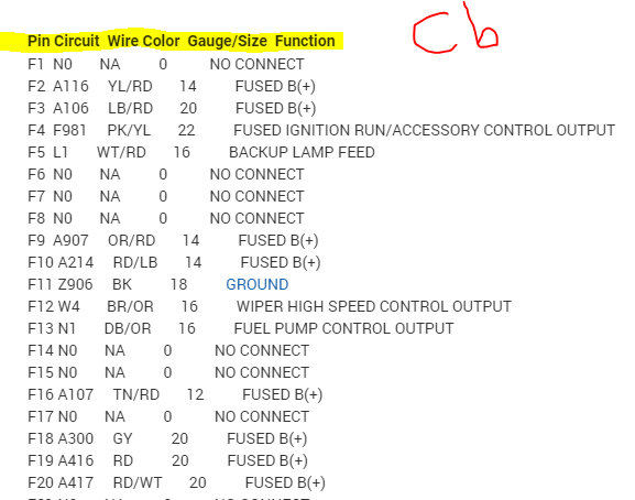

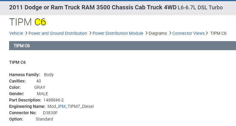

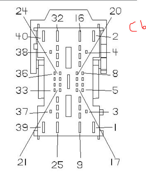

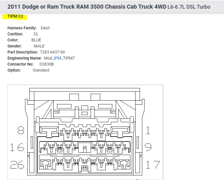

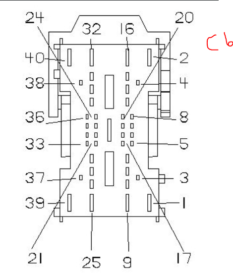

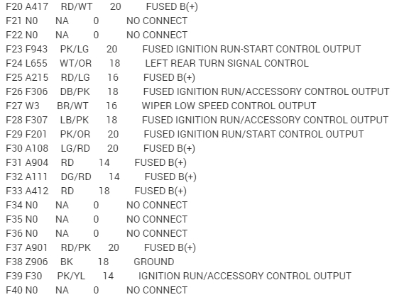

I have a cab/chassis and I just replaced the TIPM. In the process I had to repair 10 wires due to corrosion, I also had to replace connectors C2 and C6. I would like to find a wiring diagram for these two plugs to make sure I got the pin outs correct.
With the new TIPM installed, the display reads No Fuse, and the wipers turn on.
Feb 8, 2023 at 2:16 AM
  • 110,236 POSTS
I attached a pic of the connectors and how they are oriented. The pics under the connectors provide info on the wiring color, function, pin number and so on. Let me know if this is what you needed.
Take care and let me know if this helps.
See pics below. Connector 2/pics 1, 2, 3. Connector 6/remaining pics.
