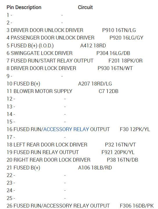

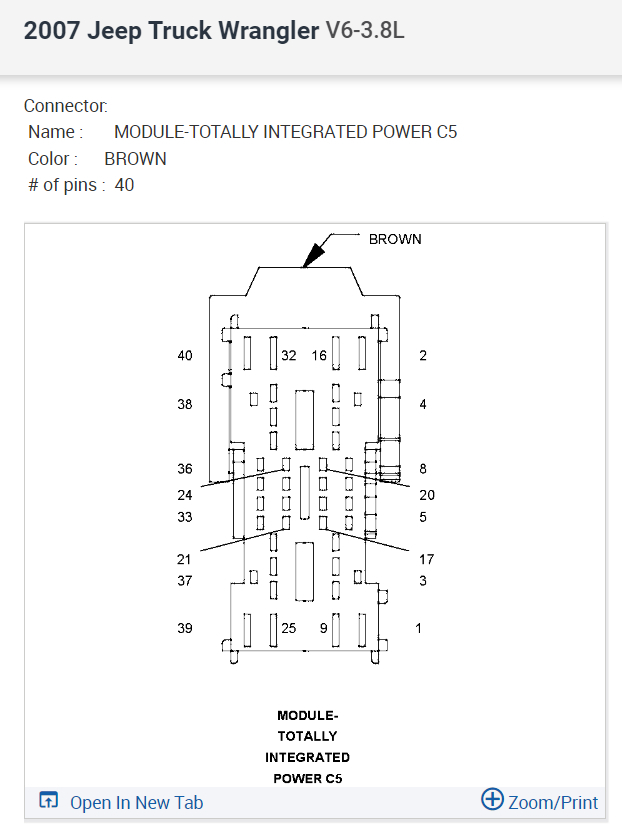

TIPM C5 and C6 wire connecting diagram needed?

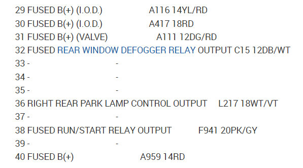

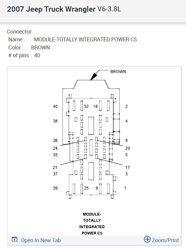

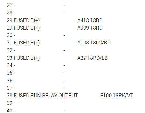

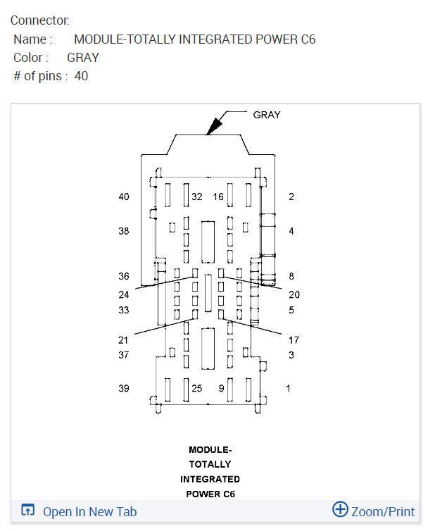

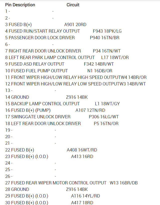

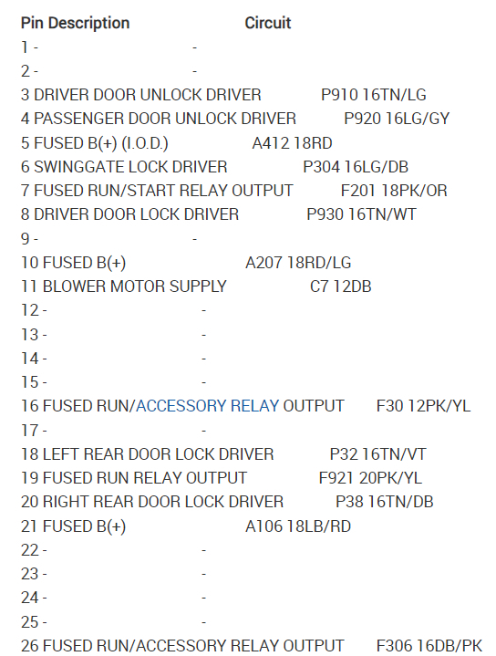

Hello Danny, I saw on your page you posted a wire diagram for the TIPM connect on a van. I was wondering if you could do the same thing but for the vehicle listed above Sahara Unlimited.
Feb 26, 2024 at 3:55 AM
  • 55,433 POSTS
Sure, here are the C5 and C6 TIPM connector view pin outs. Check out the images (below). Let us know if you need anything else.
