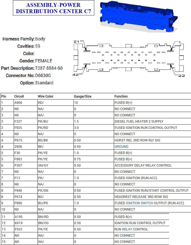

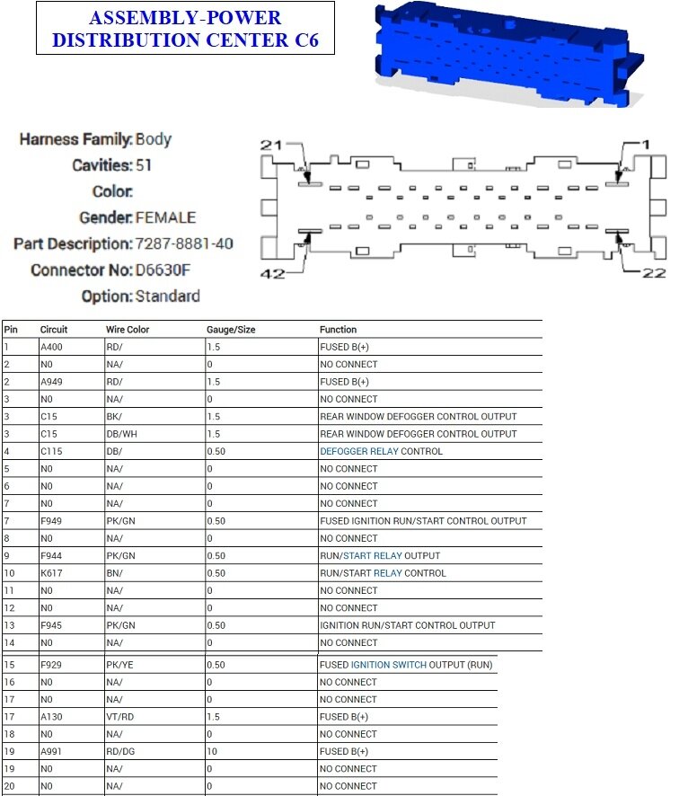

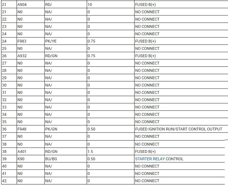

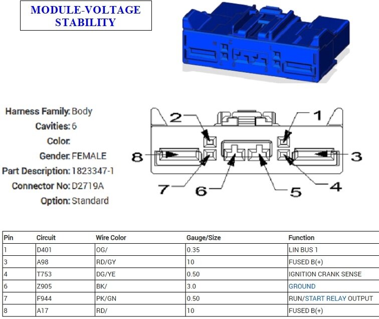

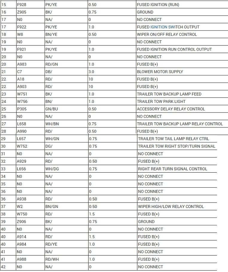

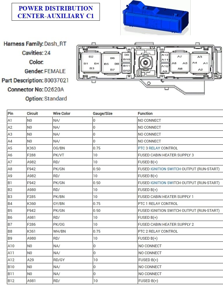

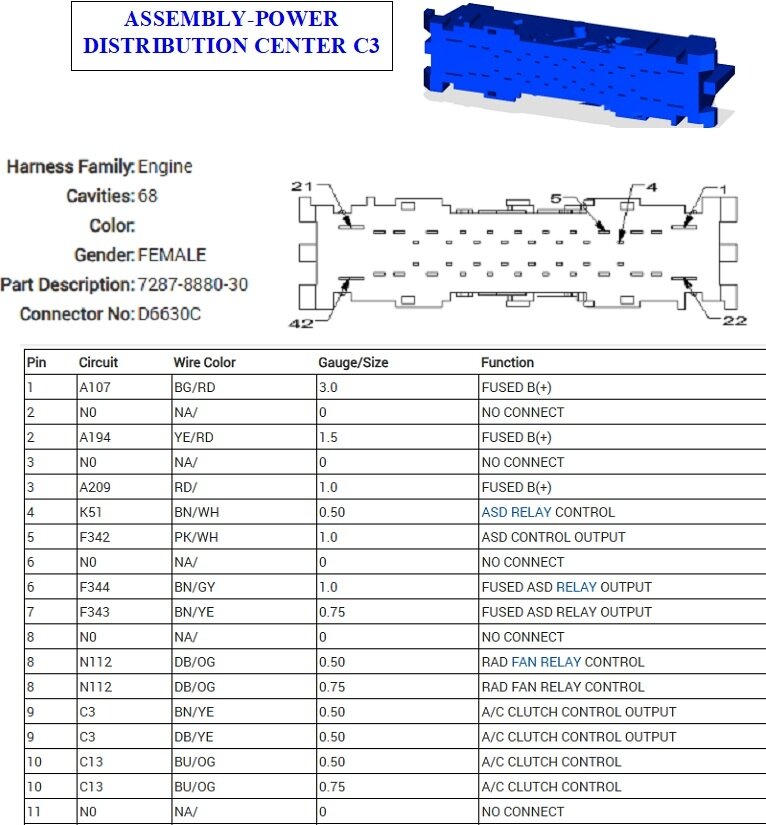

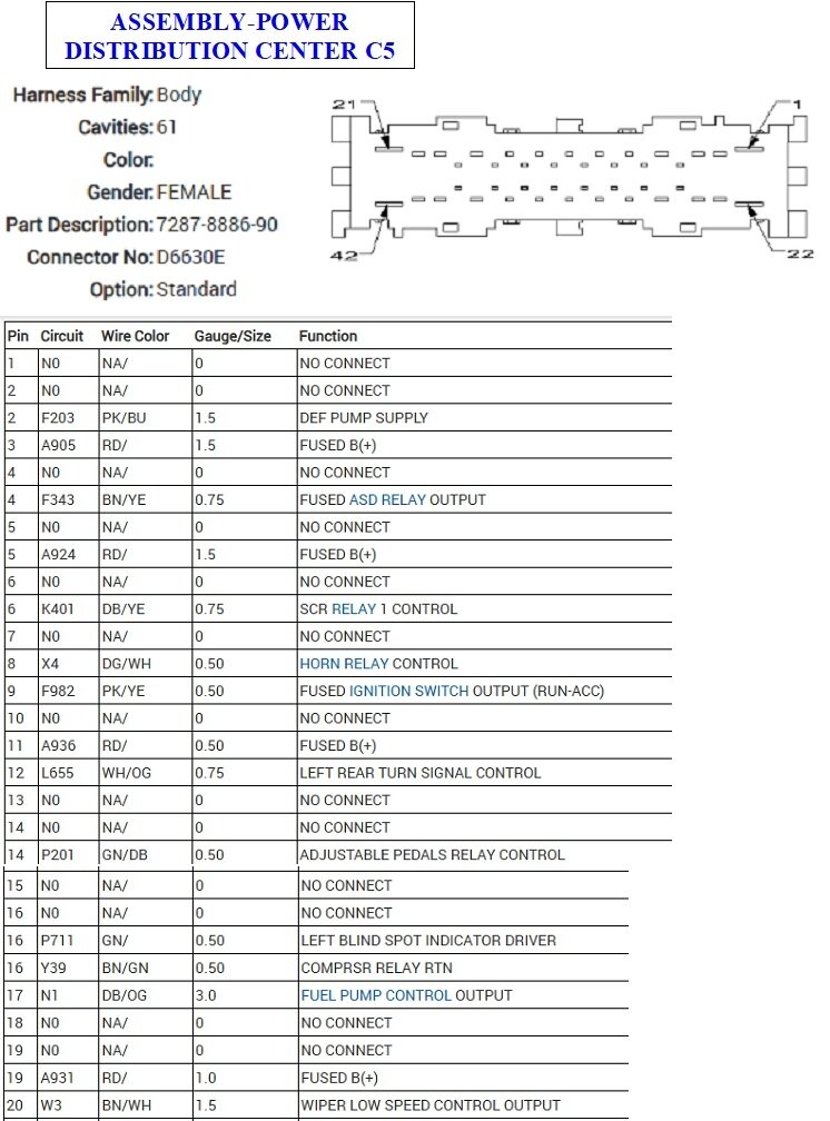

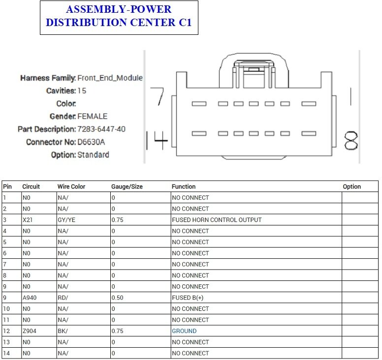

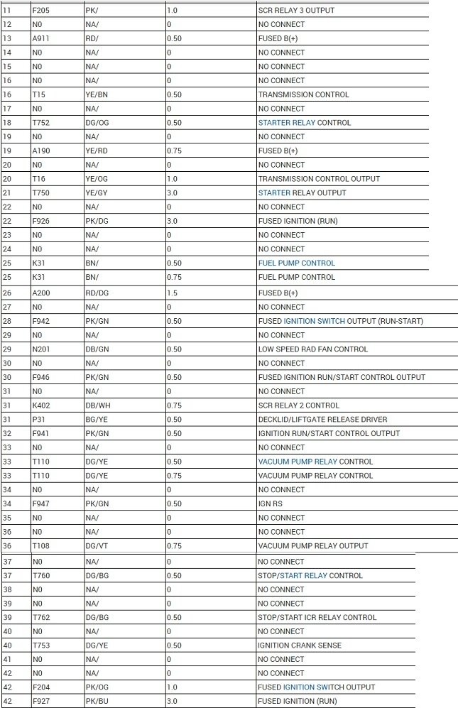

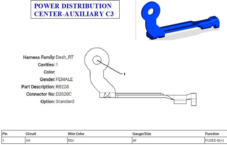

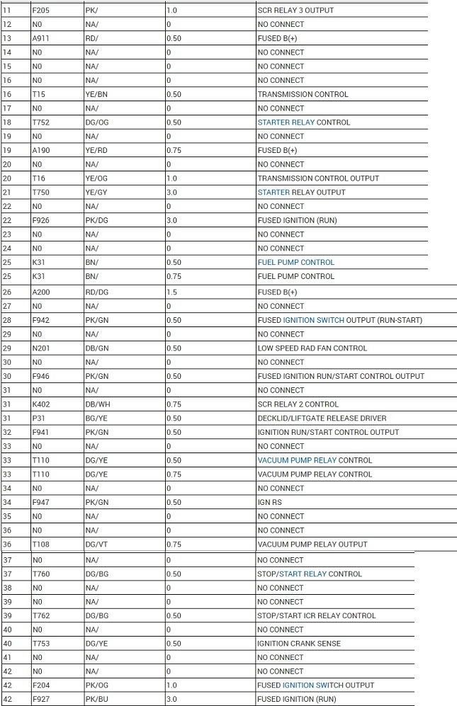

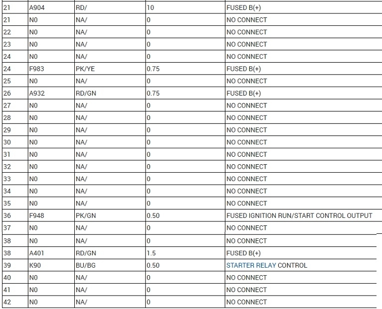

On the bottom of my totally integrated power module The blue C5 connector I have a few wires that have rotted off and need to sort out what pins they go back on.
The power to the electric control module for shifting it into gear for the 8-speed electric transmission. The power was coming on and coming off. Also my fan blower motor for the heat also quit working.
When I pulled the tipm out I cleaned it all up. It had some corrosion but seems to be in good shape.
But there were some wires that were rotted off.
Where can I order a new connector? And do they come as like a pigtail that I can just butt splice back onto the otherwise? And I'm looking for the pen layout and a spot to find good wiring diagrams. Thank you in advance.
Mar 4, 2026 at 10:06 PM
CARADIODOC
  • 34,330 POSTS

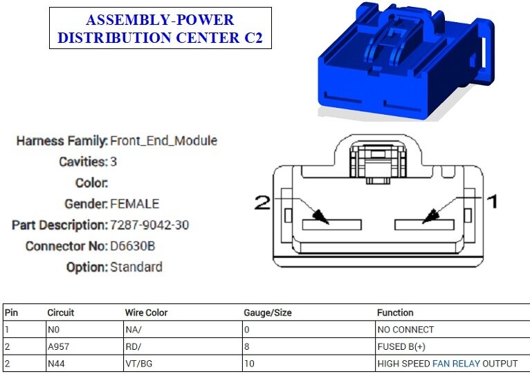

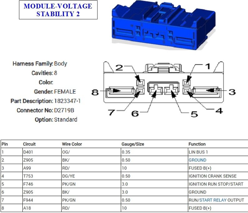

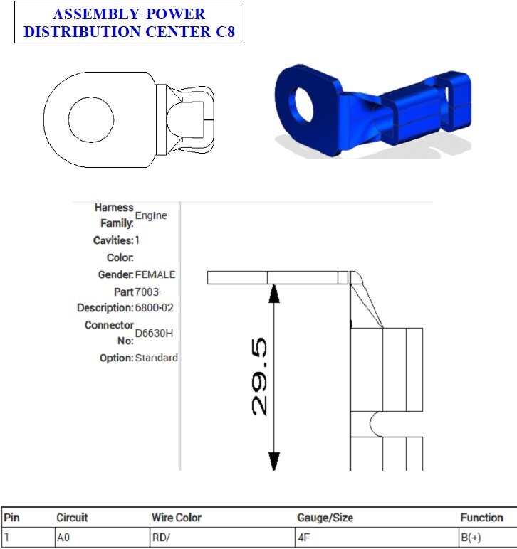

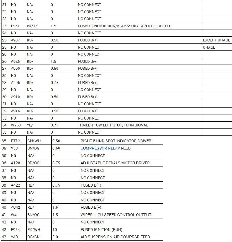

Here's the connector views. If you have trouble reading them, copy and paste them into a typing program such as MS Word where they can be expanded.
