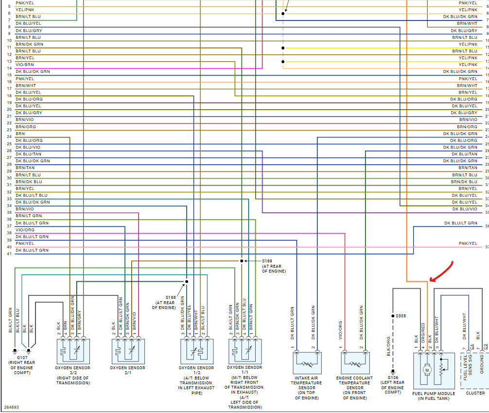

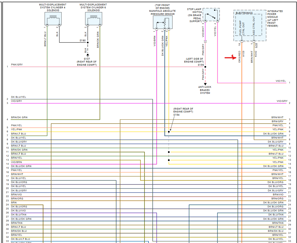

What color are the positive and negative wires to fuel pump?
Nov 2, 2024 at 1:33 AM
  • 55,399 POSTS
The fuel pump power wiring is an org/red color. Here are the fuel pump wiring diagrams as requested. Check out the images (below). Let us know if you need anything else.
