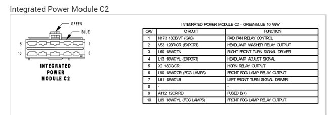

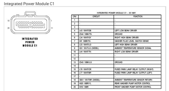

I got in a car accident. The front driver's side head light broke and when winter came my TIPM got wet! Well, the wiper went out first it was raining no wipers found out the TIPM got wet unplugged and dried. replaced wiper worked but now in limp mode thought i damaged wire on harness so i replaced harness with own harness and need TIPM wiring diagram because I obviously got a wire out of place because car won't start now.

First, make sure none of the pins in the connector are corroded, damaged, or bent.

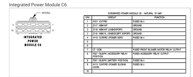

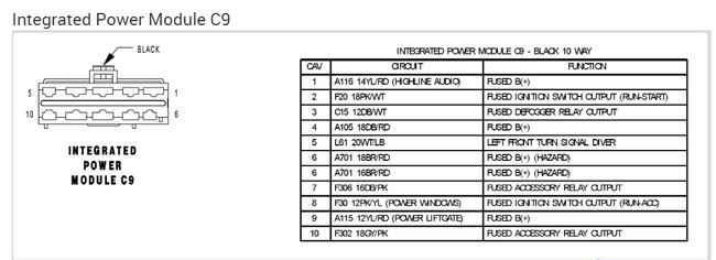

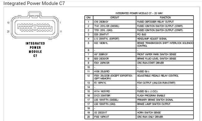

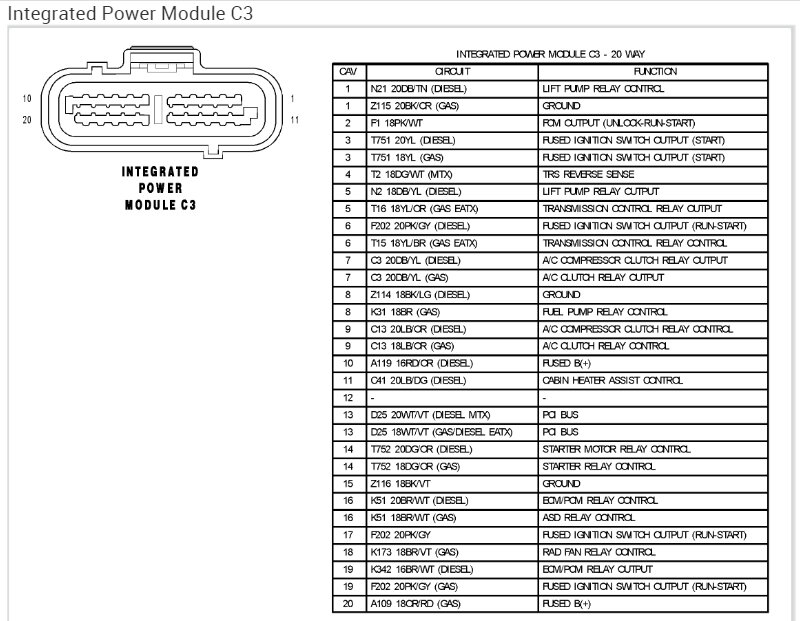

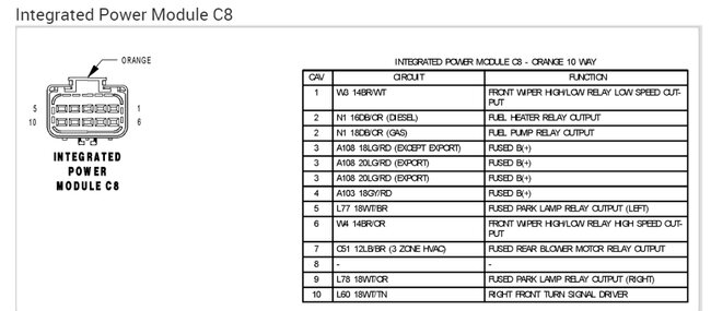

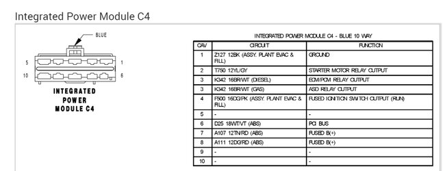

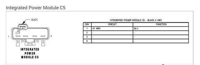

I'm not sure exactly what you need, so I attached the pinout for each of the nine TIPM connectors. Each one of the pics below indicates the connector number, pin orientation, wire color and gauge, and the connector color.
Let me know if this is what you need or if there is something other.

Where are the colors of the wire? This is what I need now along with what you sent me? Thank you

Joe will be back to help you soon. In the meantime, allow me to get you going as quickly as possible. The wire colors are listed on the charts Joe posted. In the first image, the first wire listed is in cavity # 4. It's listed as:
L43 18WT/DB Low left beam driver
Chrysler has standardized a lot of their terminology over many years. The "L" designates it's a lighting circuit. The "43" just differentiates it from all of the other lighting circuits. The next part is what you're interested in. The "18" means it's an 18-guage wire. It's white with a dark blue "tracer", or stripe.
