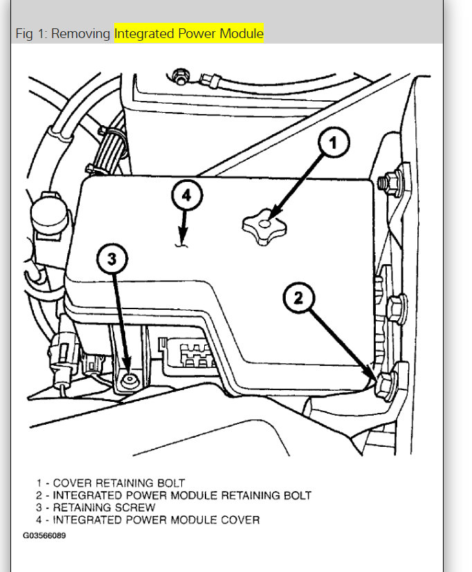

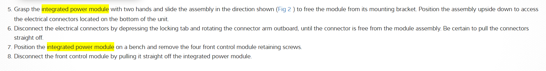

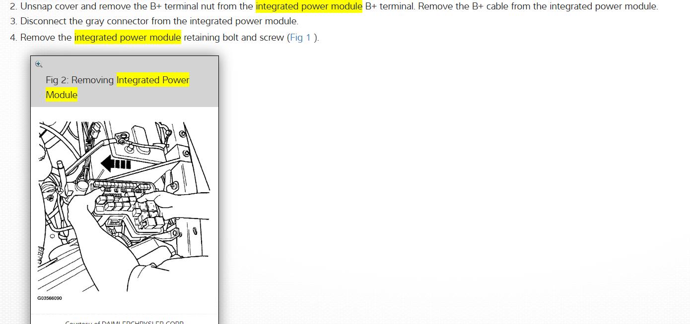

Yep, the TIPM is a common failure and ties all of these systems together but it is easy to replace because it self initializes. Check out the diagrams (below). Let us know what happens and please upload pictures or videos of the problem.
