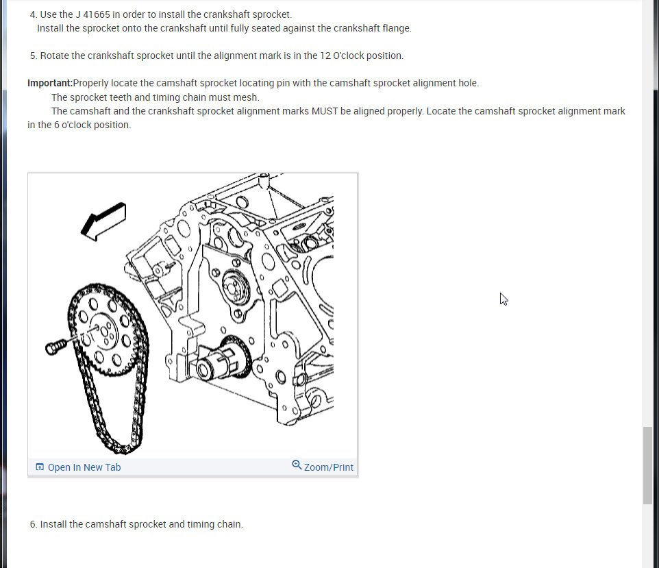

Not a issue yet but I'm wondering how long until I need to do it? Runs great and all and has been cared for regularly.
I'm old school and 100,000 mile timing chain?
May 23, 2021 at 3:04 AM

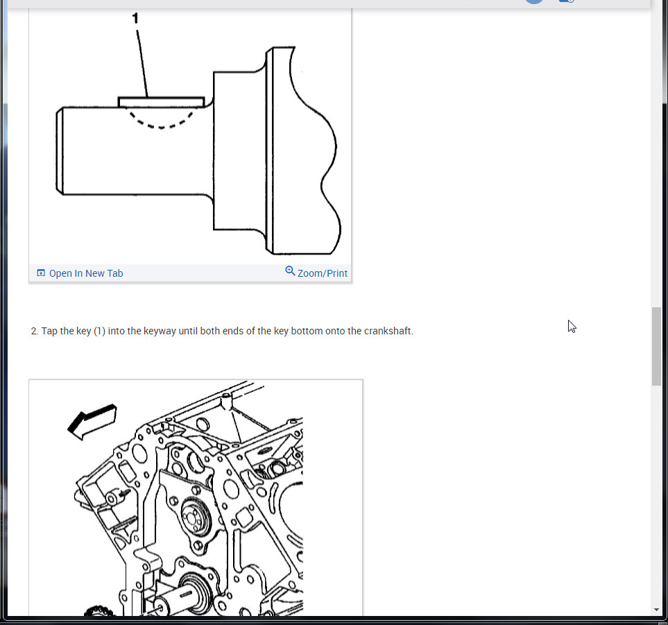

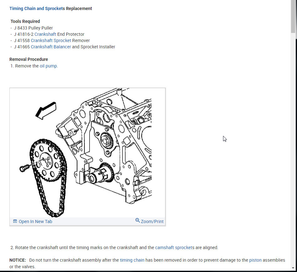

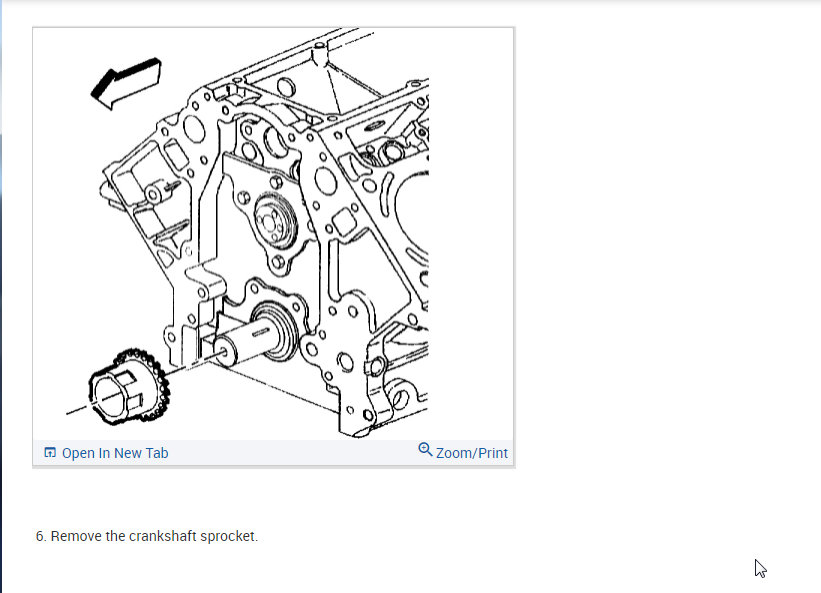

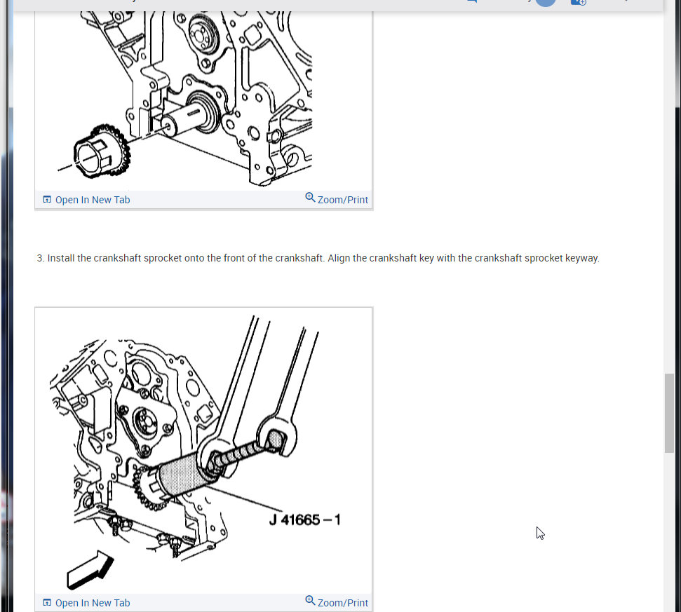

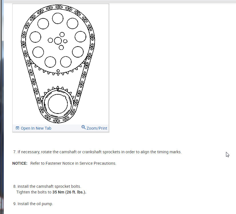

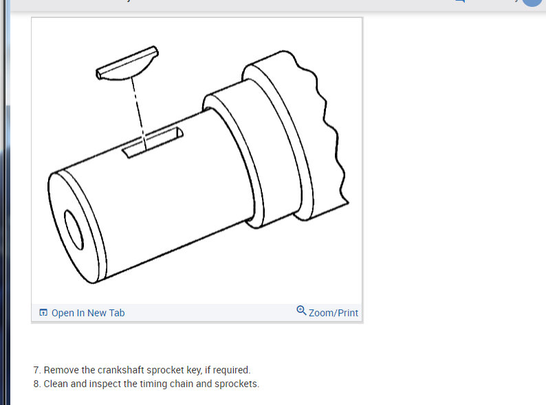

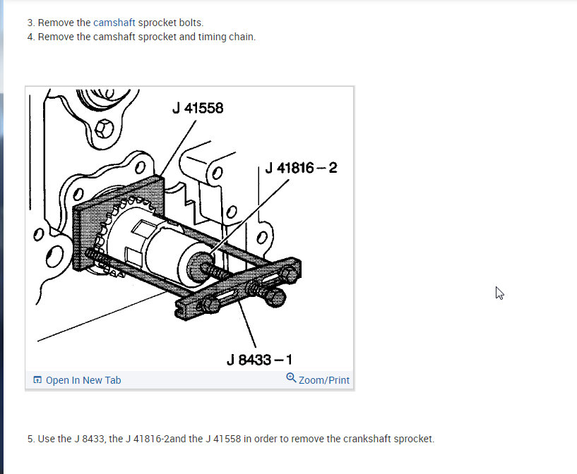

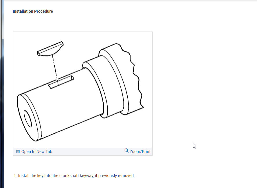

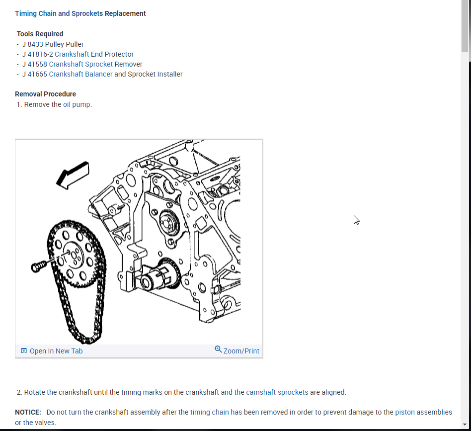

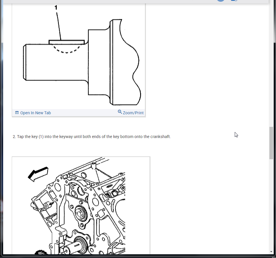

Due to this being a chain, it is not required to be changed until there is an issue or a reason to change it.
Timing belts are what require to be changed at certain intervals.
I am including the process below in case you just want to do it anyway or need to do it in the future.
Please let us know if you have other questions. Thanks
