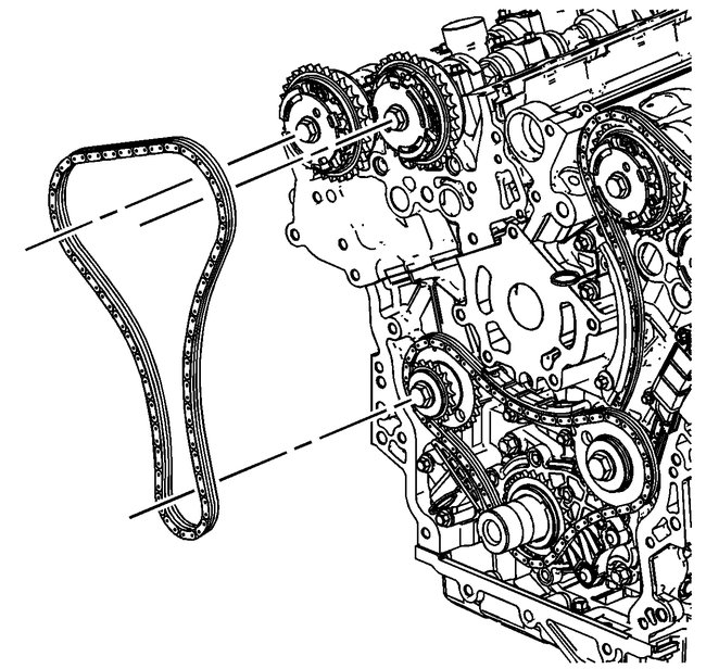

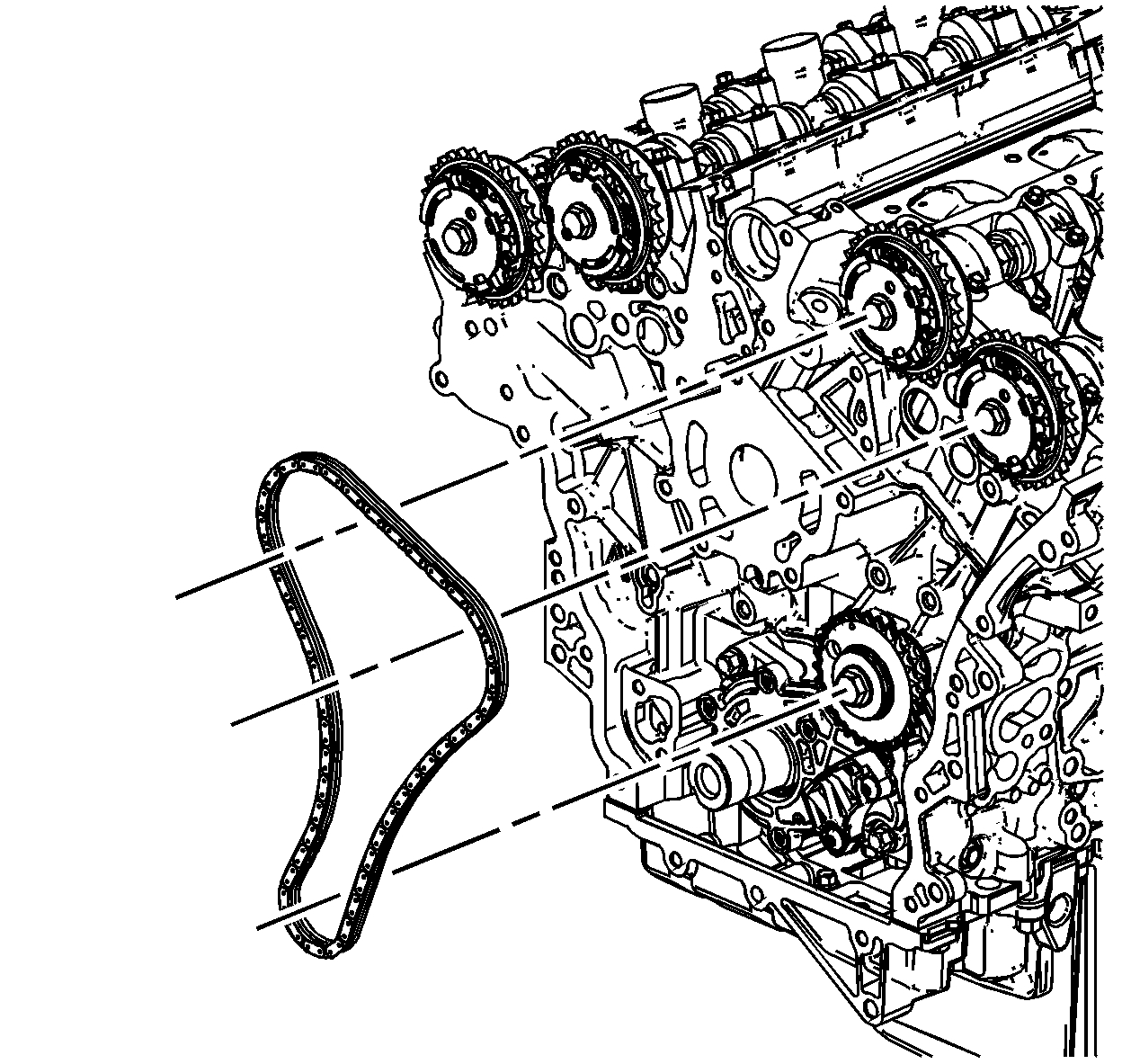

Timing chain replacement guide needed. Engine is a 3.6L.
Sep 27, 2019 at 10:10 AM
  • 110,240 POSTS
Welcome to 2CarPros.
Here are the directions for both the primary and secondary chains. The attached pictures correlate with the directions.

7. Remove the primary camshaft drive chain tensioner. See: Engine > Overhaul > 20. Primary Camshaft Drive Chain Tensioner Removal
8. Remove the primary camshaft drive chain upper guide. See: Engine > Overhaul > 21. Primary Camshaft Drive Chain Guide Removal - Upper
pic 1

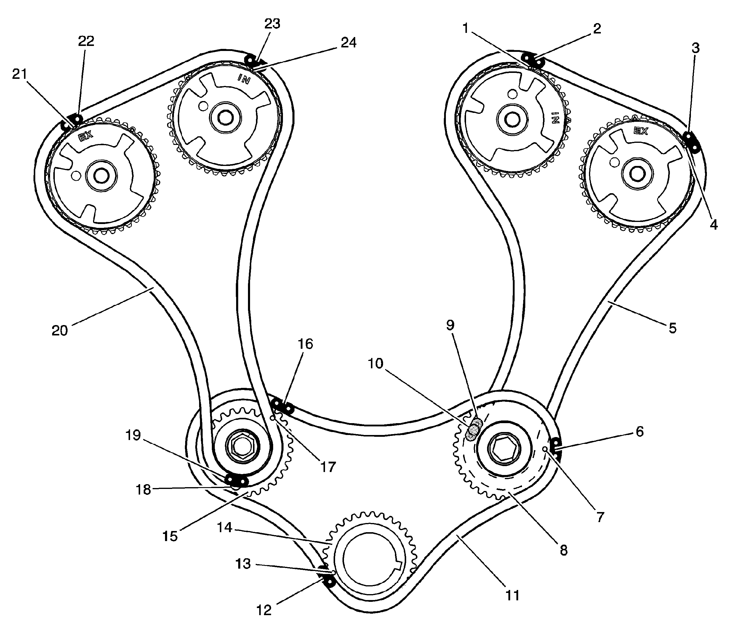

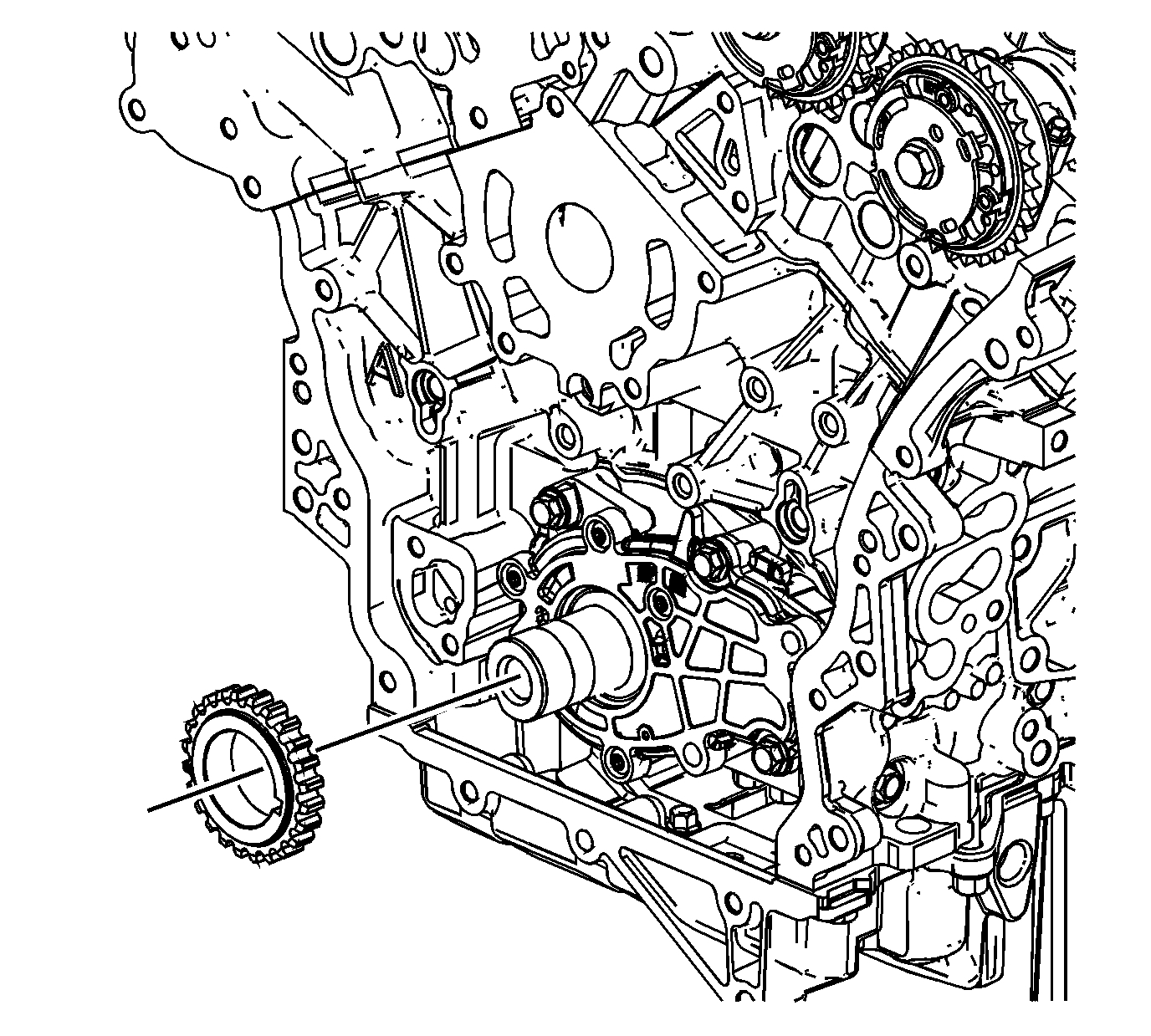

9. Remove the primary camshaft timing chain. See: Engine > Overhaul > 23. Primary Camshaft Drive Chain Removal
pic 2
10. Remove the crankshaft sprocket from the nose of the crankshaft.

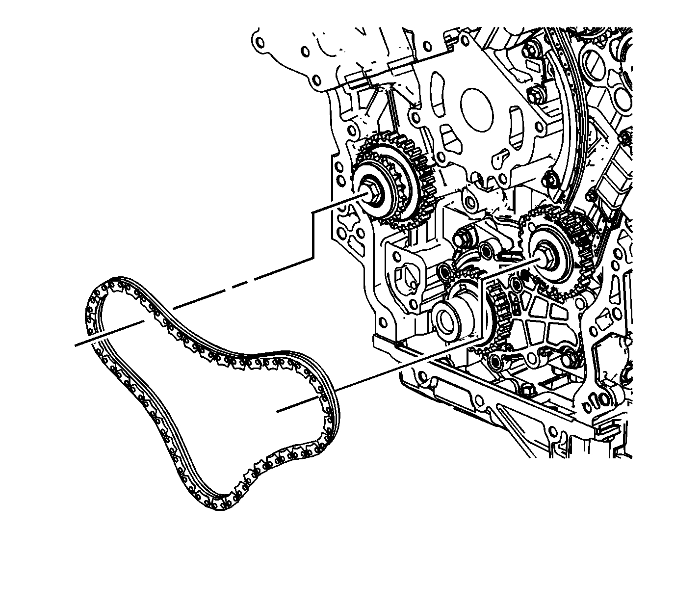

Installation Procedure

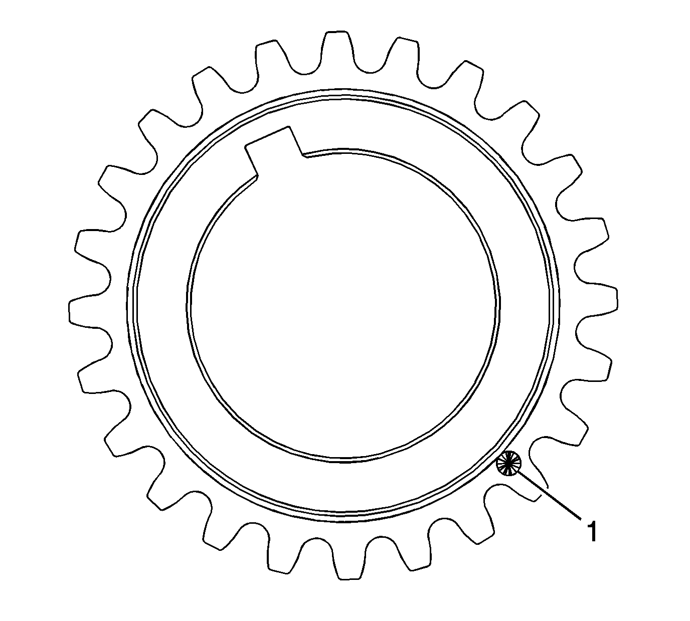

1. Ensure the secondary timing chain is in the stage 1 timing position. See: Timing Component Alignment Marks > Components
pic 3

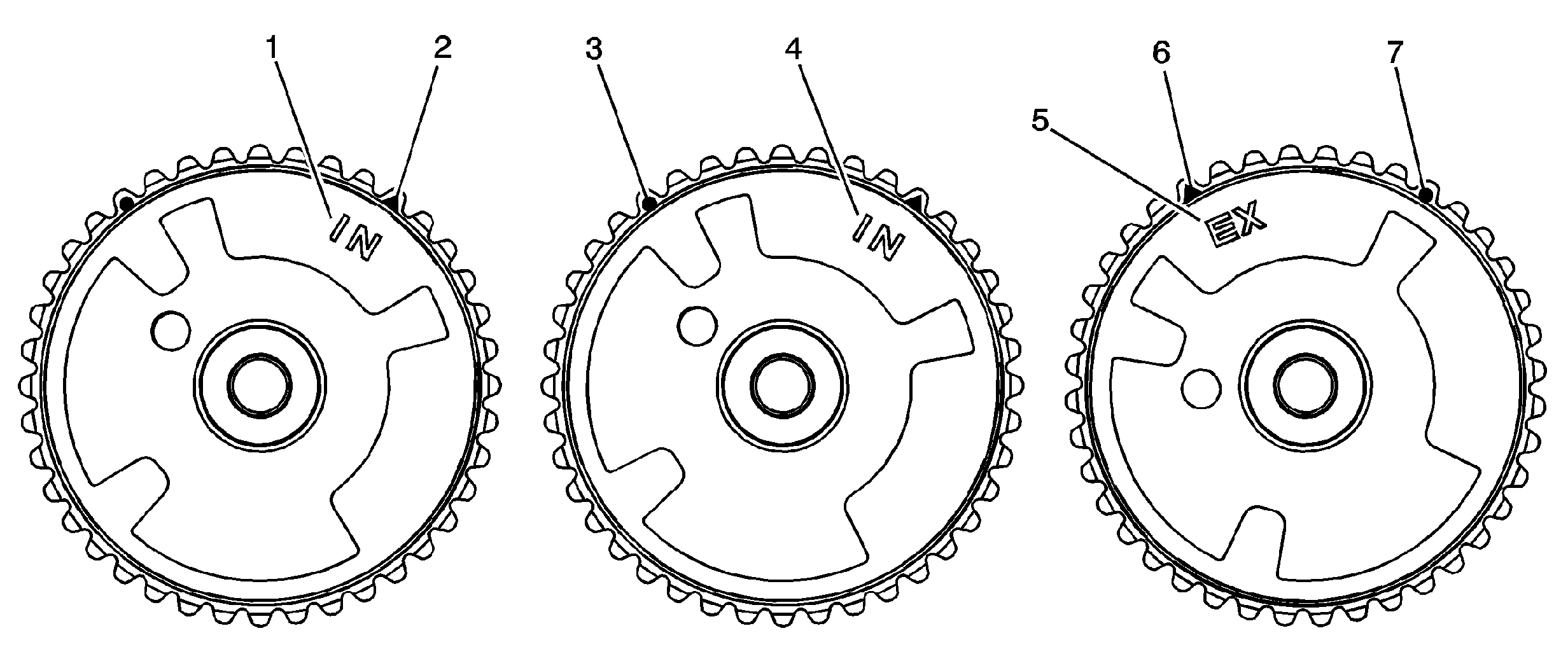

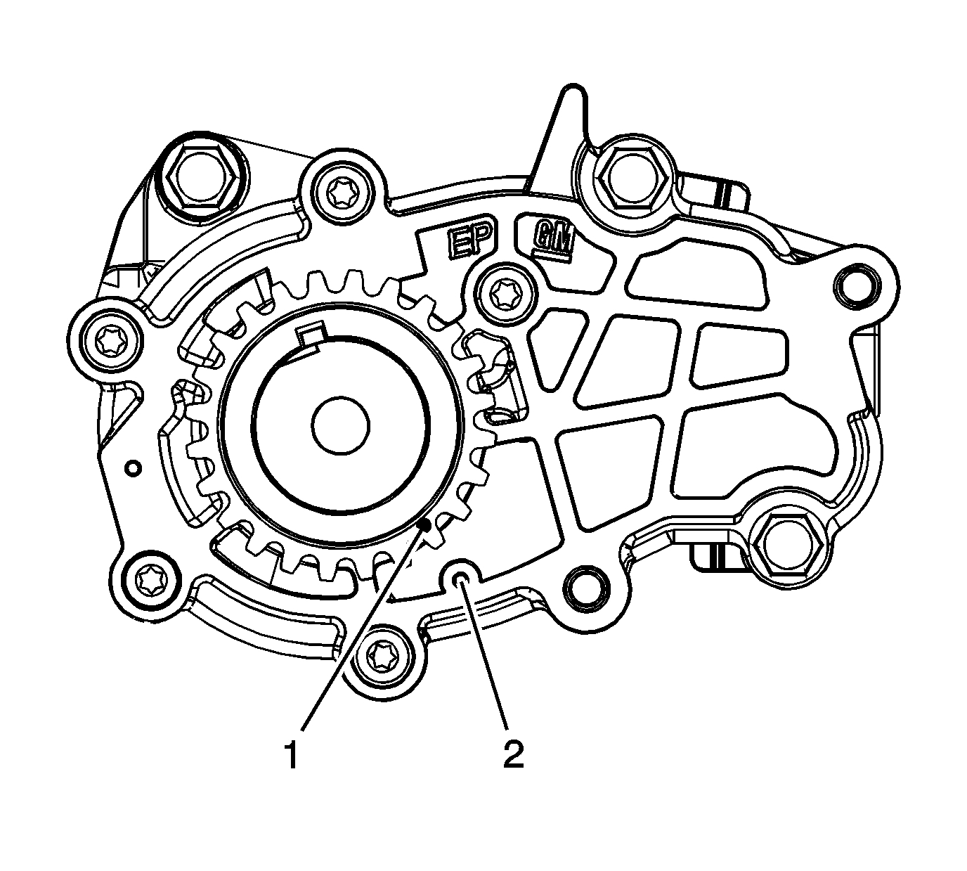

2. Ensure the crankshaft sprocket is installed with the timing mark (1) visible.
pic 4

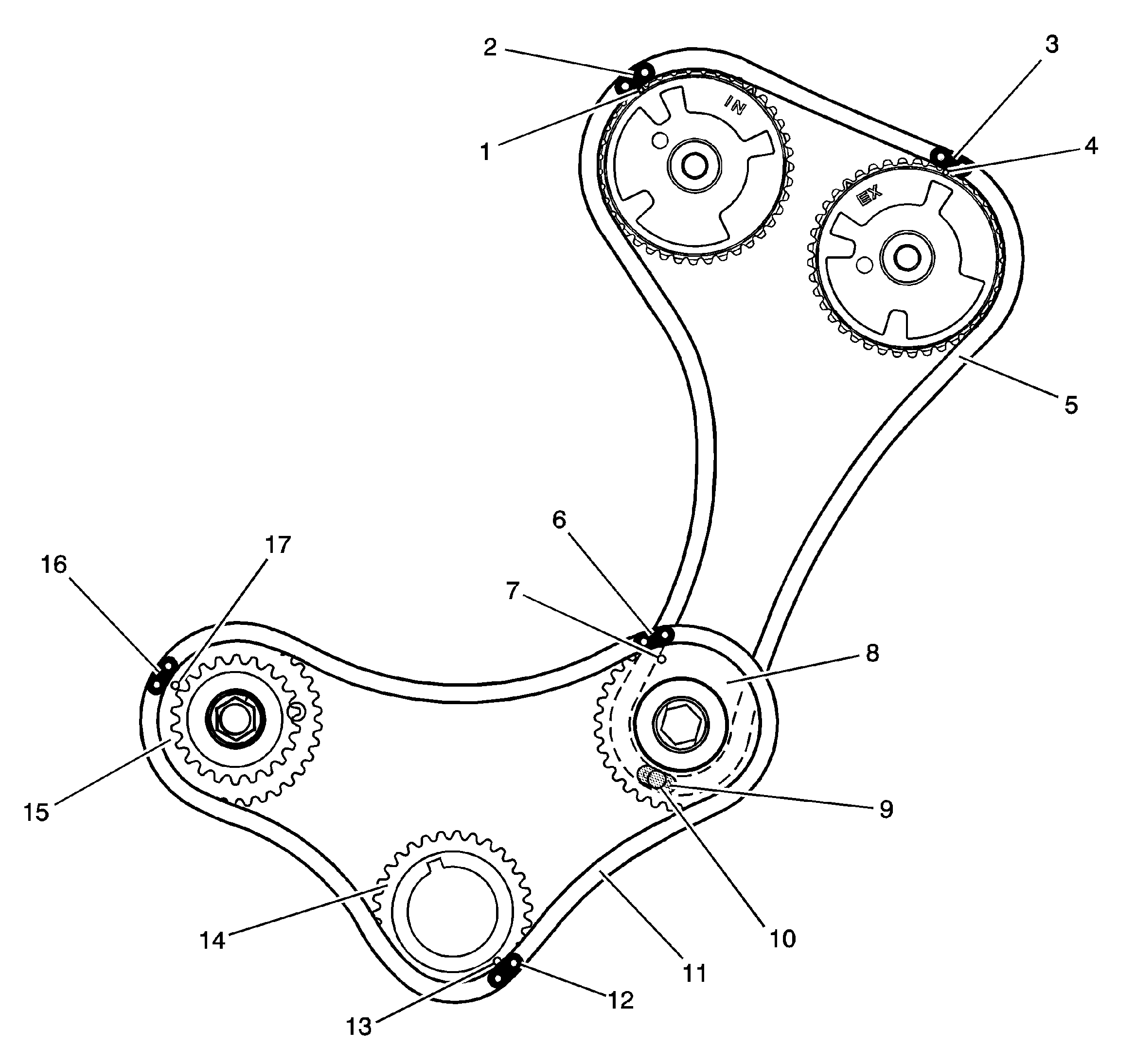

3. Install the crankshaft sprocket on to the nose of the crankshaft.
4. Align the notch in the crankshaft sprocket with the pin in the crankshaft.
5. Slide the crankshaft sprocket on the crankshaft nose until the crankshaft sprocket contacts the step in the crankshaft.
pic 5

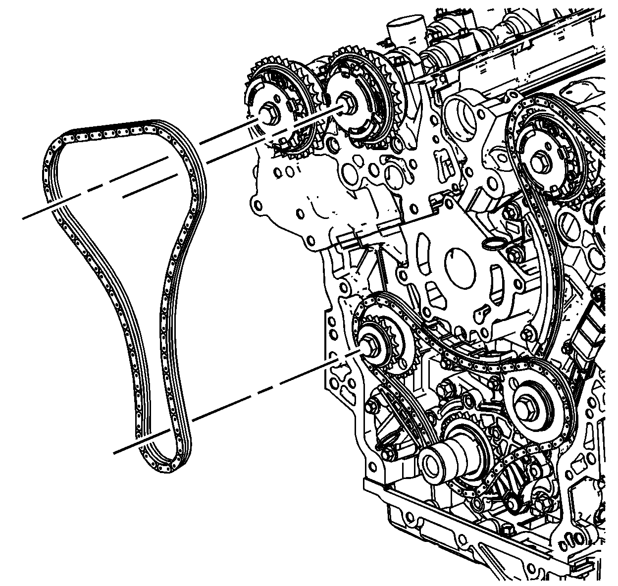

6. Ensure the crankshaft is in the stage one timing position with the crankshaft sprocket timing mark (1) aligned to the stage one timing mark on the oil pump cover (2) using the EN 46111. See: Timing Component Alignment Marks > Components
pic 6
7. Install the primary camshaft timing chain. See: Engine > Overhaul > 114. Primary Camshaft Drive Chain Installation

Timing marks: Stage 1
2007 Saturn Truck Outlook V6-3.6L
Stage One
Vehicle Engine, Cooling and Exhaust Engine Timing Components Timing Component Alignment Marks Locations Components Timing Chain Alignment Diagram - Fourth Design Stage One
STAGE ONE
STAGE ONE
pic 11
1. Left Intake Camshaft Position Actuator Timing Mark - Circle
2. Left Intake Secondary Camshaft Timing Drive Chain Timing Link
3. Left Exhaust Secondary Camshaft Timing Drive Chain Timing Link
4. Left Exhaust Camshaft Position Actuator Timing Mark - Circle
5. Left Secondary Camshaft Timing Drive Chain
6. Primary Camshaft Drive Chain Timing Link for the Left Primary Camshaft Intermediate Drive Chain Sprocket
7. Left Primary Camshaft Intermediate Drive Chain Sprocket Timing Mark for the Primary Camshaft Drive Chain
8. Left Primary Camshaft Intermediate Drive Chain Sprocket
9. Left Secondary Camshaft Timing Drive Chain Timing Link for the Left Primary Camshaft Intermediate Drive Chain Sprocket, behind hole in sprocket
10. Left Primary Camshaft Intermediate Drive Chain Sprocket Timing Window for the Left Secondary Camshaft Timing Drive Chain Timing Link
11. Primary Camshaft Drive Chain
12. Primary Camshaft Drive Chain Timing Link for the Crankshaft Sprocket
13. Crankshaft Sprocket Timing Mark
14. Crankshaft Sprocket
15. Right Primary Camshaft Intermediate Drive Chain Sprocket
16. Primary Camshaft Drive Chain Timing Link for the Right Primary Camshaft Intermediate Drive Chain Sprocket
17. Right Primary Camshaft Intermediate Drive Chain Sprocket Timing Mark

22. Right Exhaust Secondary Camshaft Timing Drive Chain Timing Link
23. Right Intake Secondary Camshaft Timing Drive Chain Timing Link
24. Right Intake Camshaft Position Actuator Timing Mark - Triangle
Camshaft Position Actuator Timing Marks
Vehicle Engine, Cooling and Exhaust Engine Timing Components Timing Component Alignment Marks Locations Components Timing Chain Alignment Diagram - Fourth Design Camshaft Position Actuator Timing Marks
CAMSHAFT POSITION ACTUATOR TIMING MARKS
pic 13
1. Right Intake Camshaft Position Actuator Identifier
2. Right Intake Camshaft Position Actuator Right Side Timing Mark - Triangle
3. Left Intake Camshaft Position Actuator Left Side Timing Mark - Circle
4. Left Intake Camshaft Position Actuator Identifier
5. Exhaust Camshaft Position Actuator Identifier
6. Exhaust Camshaft Position Actuator Right Side Timing Mark - Triangle
7. Exhaust Camshaft Position Actuator Left Side Timing Mark - Circle
