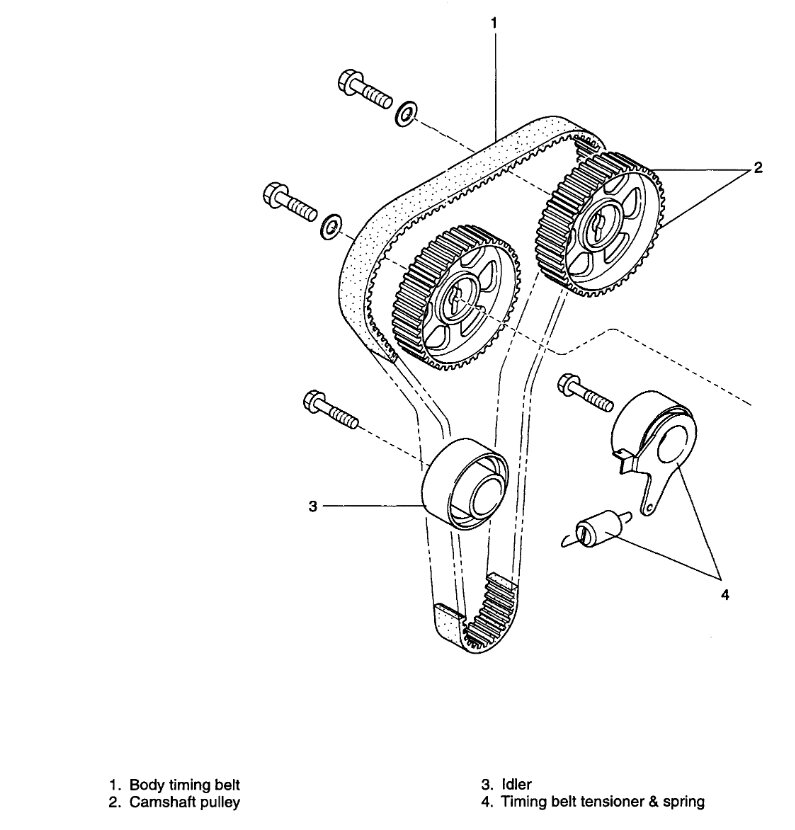

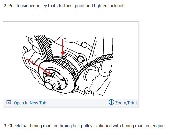

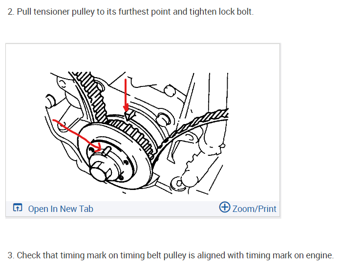

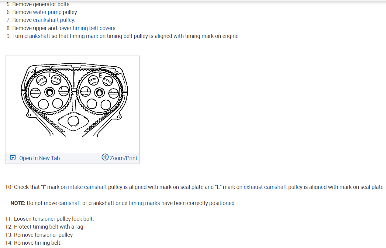

How to I align timing up and how do I get the head top dead center I got belt on it.
Sep 2, 2024 at 9:13 AM
DEETURNER
How do I align it up top dead center?
Sep 2, 2024 at 9:14 AM
  • 55,636 POSTS
Sure, here is how to align the timing marks and how to put the crankshaft on top dead center. Check out the images (below). Let us know if you need anything else.
