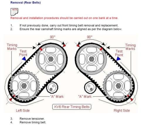

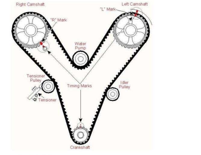

Can you please help with correct timing alignment as I am having difficulty.
Jun 18, 2018 at 9:09 AM
KHLOW2008
  • 41,814 POSTS
Attached are the two diagrams for the timing belt and their markings. Check out the diagrams (Below). Please let us know if you need anything else to get the problem fixed.
