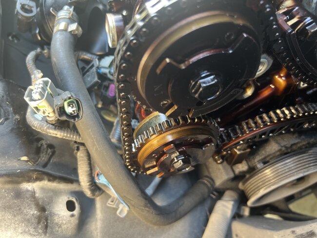

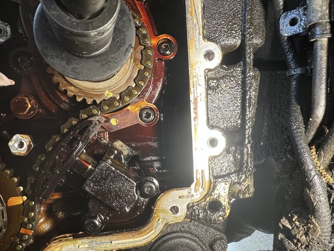

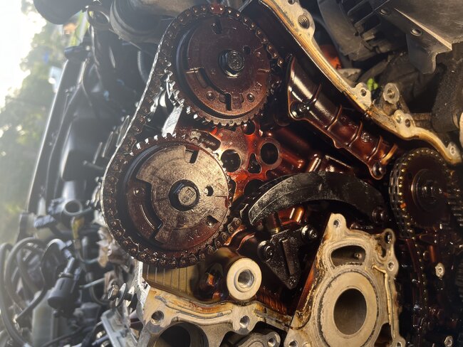

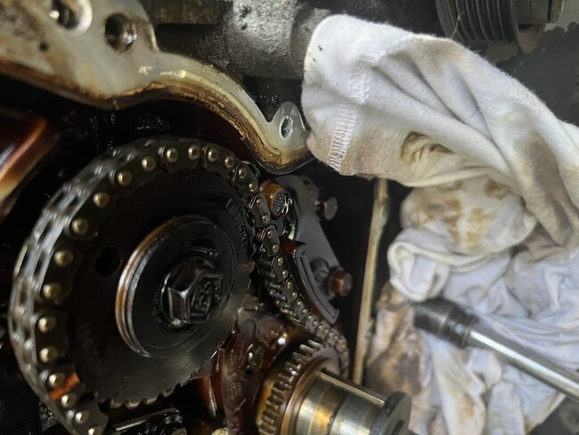

The flats on the camshafts do not line up together. On one side the flat is up, and the crank sprocket marks are lined up. The other side is off set from top. My question is, at that point, can I remove the chain and turn that one off set camshaft until the flat is at top? If not, what shall I do?
May 25, 2024 at 12:00 AM
  • 110,248 POSTS

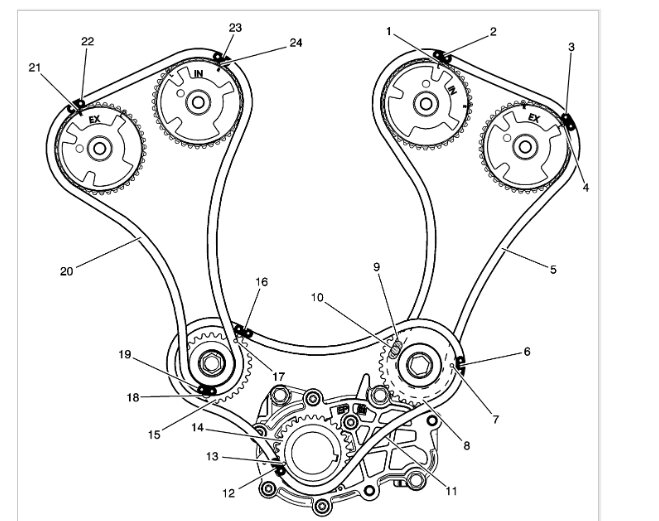

They need to be aligned, so yes you will have to turn it. I attached a pic below showing timing mark locations.
Let me know if this helps.
May 25, 2024 at 12:13 PM

I see where the marks are supposed to be. Is that where each has to be in each Stage Timing? Or when I put it in Stage 2 timing, it supposed to look like the pic. Or, after putting it in Stage 2 timing and removing the chain, the other side should look like that in Stage 1 timing. Because, the way my engine is, when putting it in Stage 2 timing. the IN and EX letters is not facing up. The other side is facing down, so if I rotate the engine and align the crank sprocket marks to Stage 1 time they should be facing up. Also, the Cam Sprockets has rectangular mark (arrow) and a circle mark on them. What's the difference?
May 25, 2024 at 11:14 PM
  • 110,248 POSTS

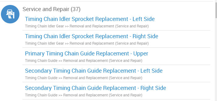

The pic I sent is after the secondary chains are installed.
I attached a pic below. Take a look and let me know if there is one option there that fits exactly what is needed and I'll get it for you.

i will go ahead and remove the chain on the right side and turn the other cam so that is they both is facing up. then continue. Hopefully that will work as long as i can get it in Stage 1 timing.

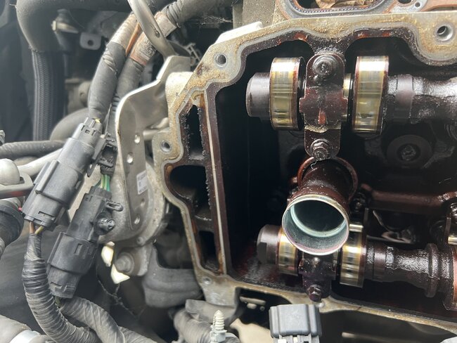

So, I got the left side chain assembly on. But on the right, I noticed the camshaft is pretty loose. Just seeing if that's normal or not. I have attached a video of it. Let me know, thanks.
Jun 1, 2024 at 4:39 AM
  • 110,248 POSTS
Is the chain attached? Also, if all cam lobes are off the lifters, it should turn easily. But there should be some resistance. That does appear to be somewhat loose.
Is there any play front to back or side to side in the bearings? There shouldn't be.

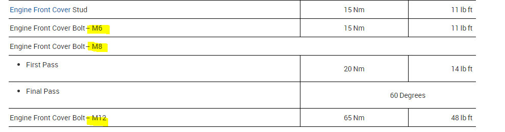

I finished replacing all the chains and i got the front cover on but i don't know if there is a torque sequence or not. I am using an online Chilton's Repair Manual but it doesn't mention torque specs on the installation procedures.
Jun 5, 2024 at 10:00 AM
  • 110,248 POSTS
I wasn't able to find a sequence for it, but I did find the torque specifications. As far as bolts, it indicates three different sizes. I'm not sure if all are relevant to what is needed. However, I did attach them below.
Note that the one size indicates the procedure is done in two steps.
Let me know if this helps or if you have questions.

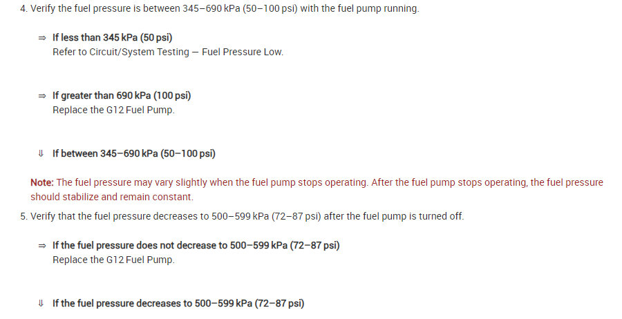

  • 110,248 POSTS
If you were able to resolve the hard start by cycling the ignition switch (good idea, by the way), that tells me there is a pressure drop off issue.
When you turned the key off, how long did the pressure hold? If you have your scan tool connected before turning the key on for the first time, what is the pressure before cycling the switch?
Jul 8, 2024 at 12:24 PM

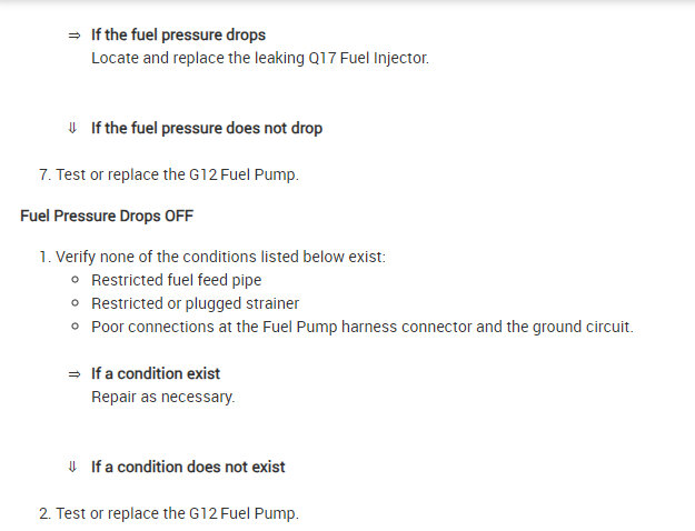

Before turning on the ignition, there was no pressure. Once I turned on the ignition, the pressure read 60.3 PSI. After shutting the engine off, the pressure held. But it dropped over night. It did hold for 20 minutes.

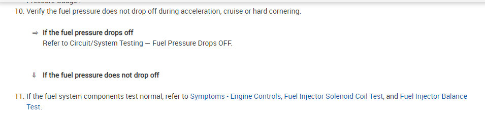

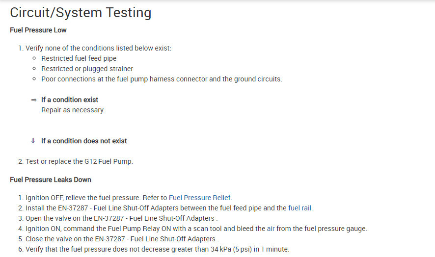

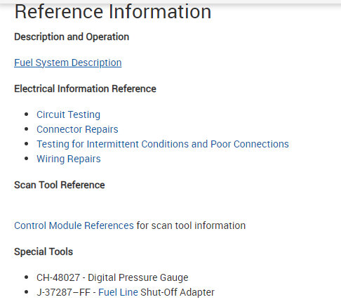

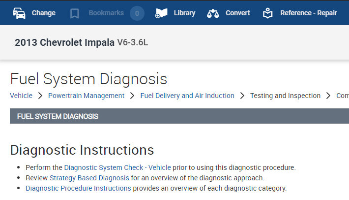

  • 110,248 POSTS

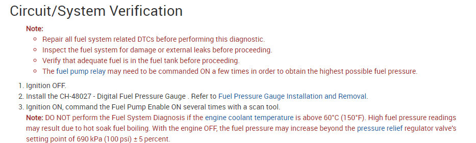

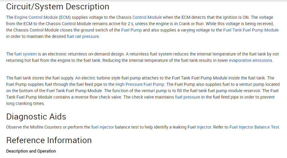

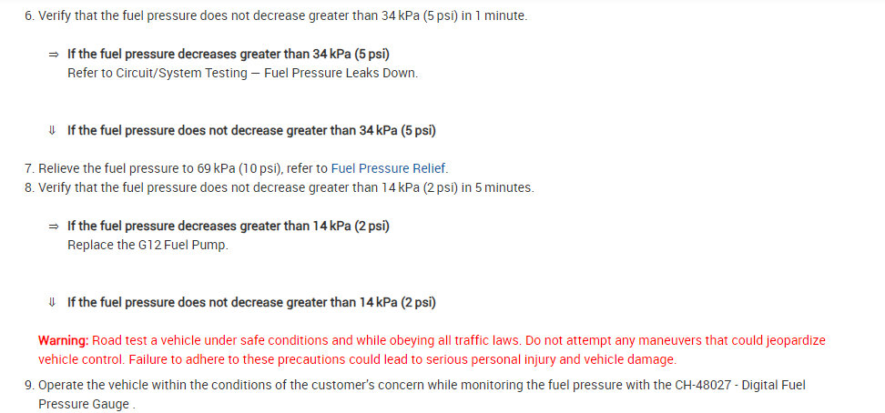

It shouldn't drop off to 0 psi. I attached the manufacturer's diagnostics below. Take a look through them and let me know if you are comfortable performing them.
