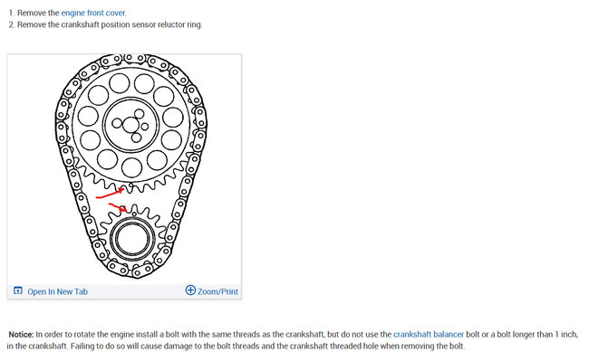

need information about changing the timing chain set.
Mar 21, 2025 at 2:34 AM
  • 55,711 POSTS

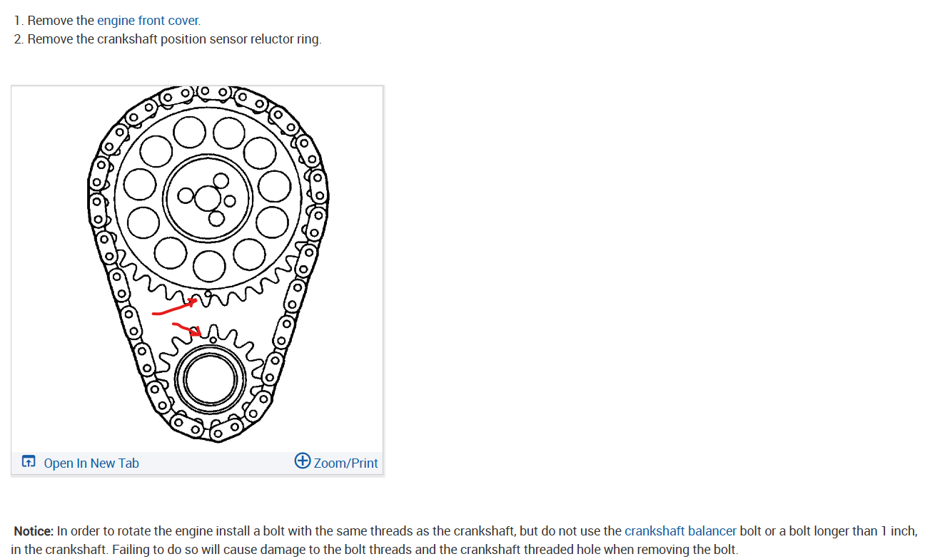

Okay, what kind of information, the timing marks? If so, I have included them in the images below. Line up the dots on the gears. Check out the images (below).
Mar 21, 2025 at 6:32 AM
DANIEL KELLER
  • 7 POSTS
Yes, that helped a lot thank you.
