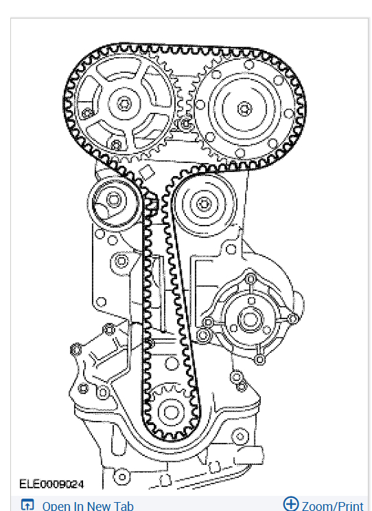

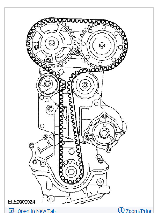

sorry it's the cam timing i can't quite get it right or find anything on how to.
Jan 19, 2025 at 5:37 AM
  • 55,402 POSTS
Gotcha, here is the timing belts marks for the timing belt replacement procedure. Check out the images (below). Let us know if you need anything else.

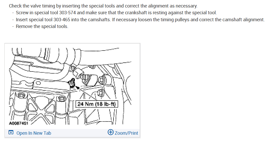

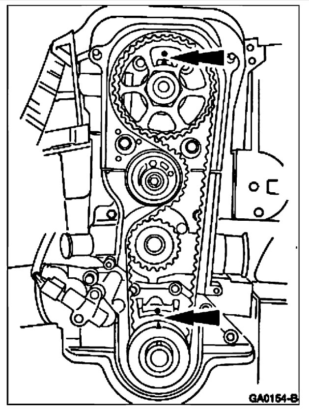

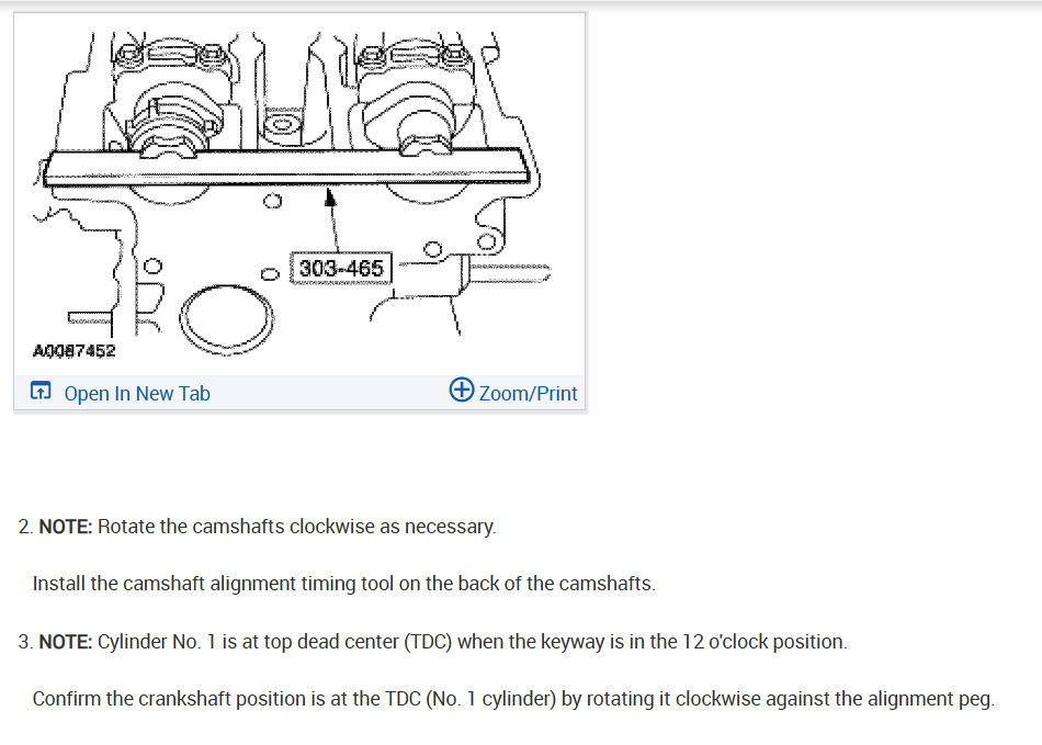

yeah that's what i need but for the 1.6 16 valve DOHC. It's a 2002 Ford laser LXI.
Jan 20, 2025 at 11:49 AM
GALWYNN
Has got letters for intake and exhaust on both cam pulleys but not sure where they're meant to line up.
Jan 20, 2025 at 11:54 AM
  • 55,402 POSTS
Okay, this one is a little different, you will need a couple special tools that line up the camshaft and crankshaft. Here are the instructions. Check out the images (below). Let us know if you need anything else.
