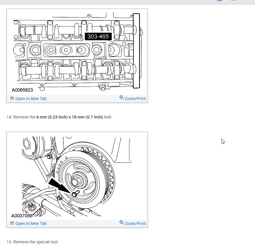

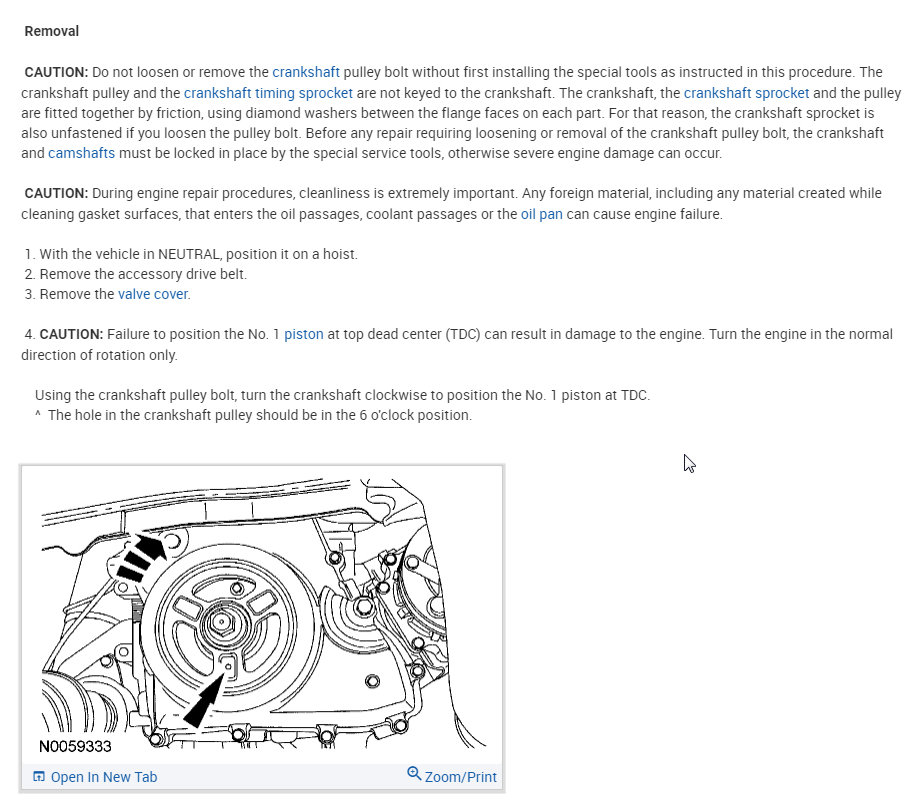

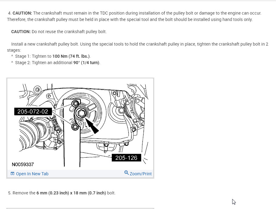

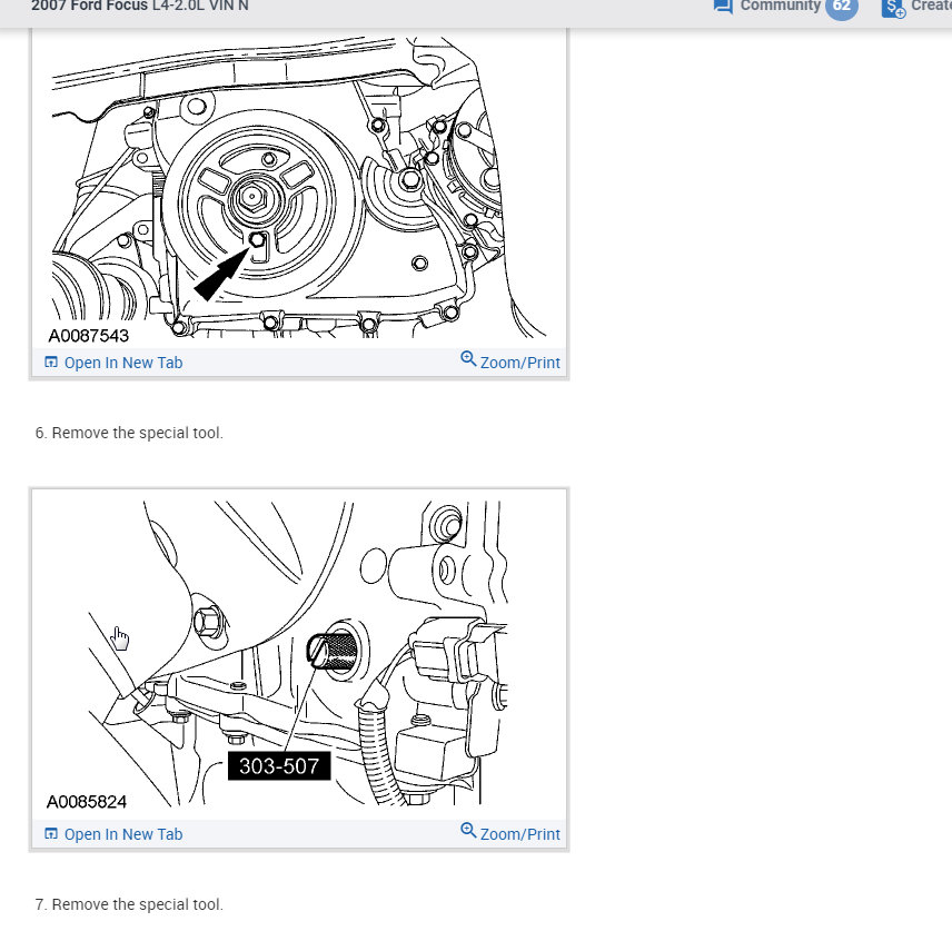

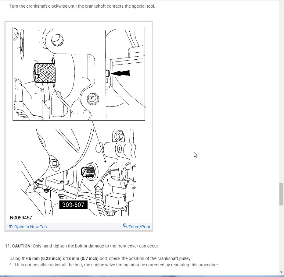

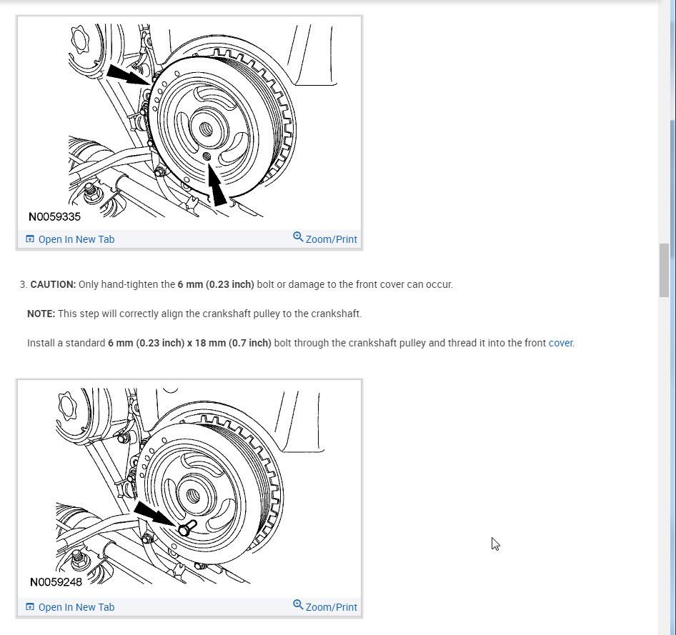

FATI6610

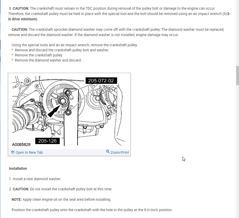

I replaced front crank oil seal and need don't know crank pulley position to knock sensor for car listed above St150 model.please show pictures.
Oct 7, 2020 at 4:56 AM (Merged)

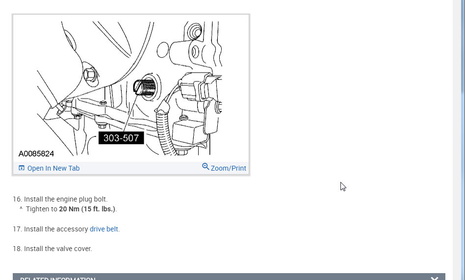

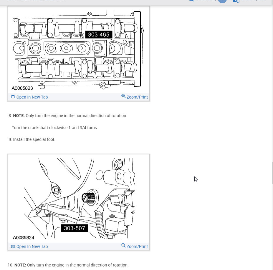

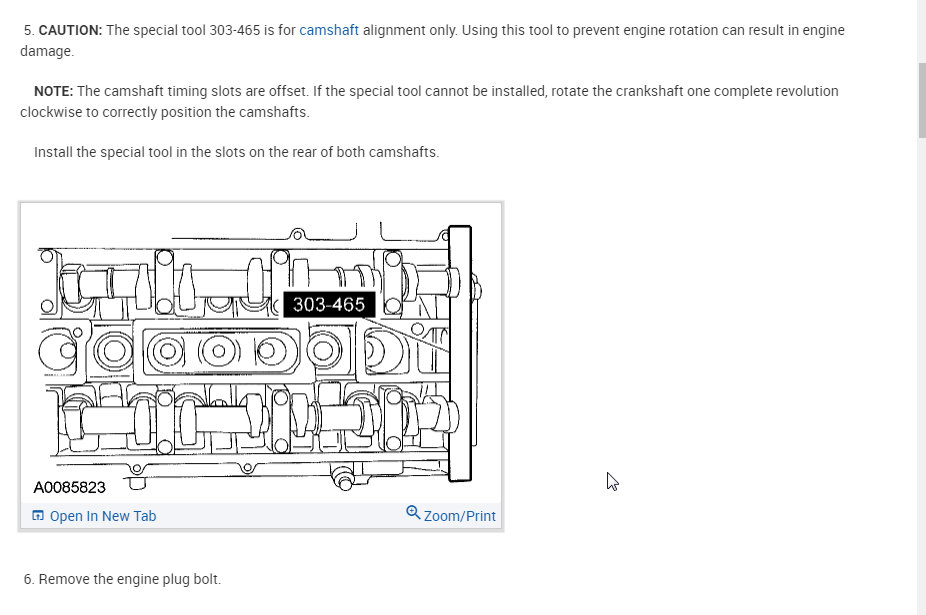

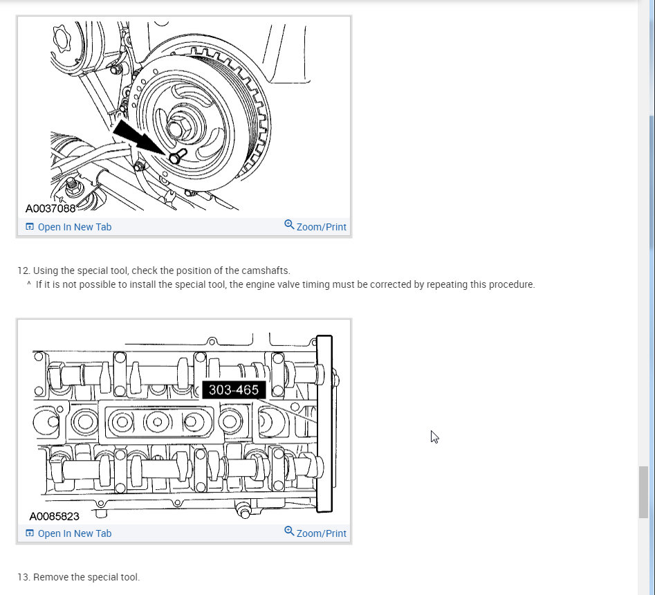

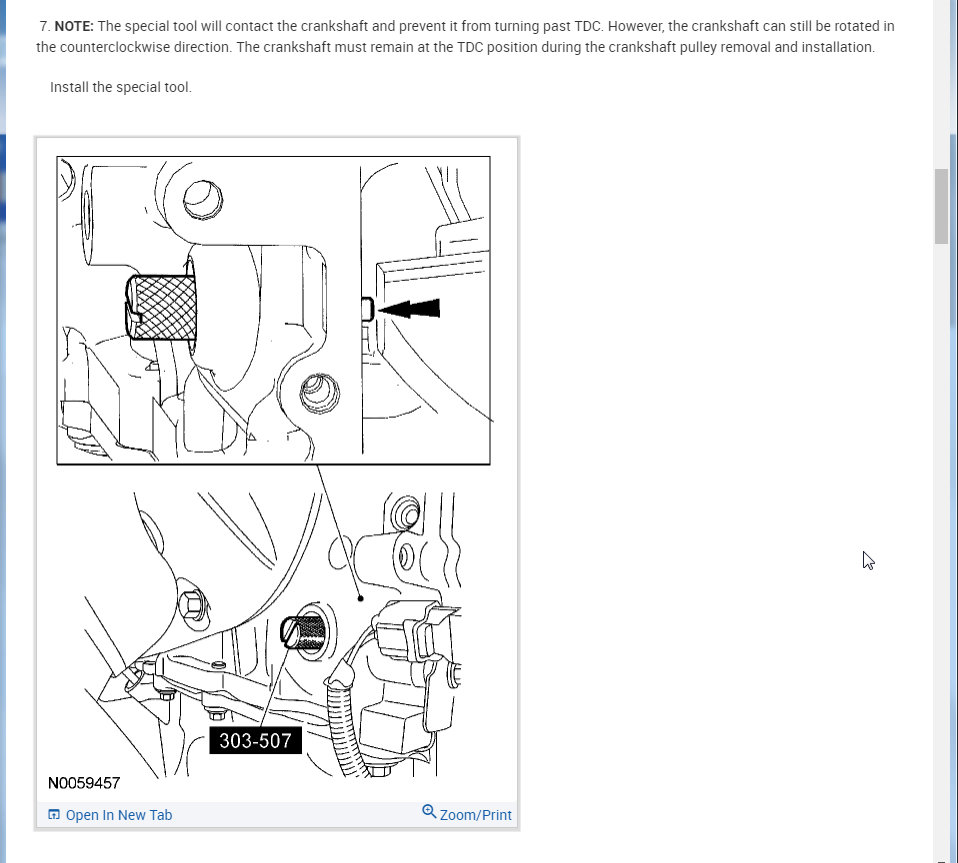

Attached you will find the procedure for the crank pulley on a 2.0L. This should be what you need. Check out the diagrams (Below). Please let us know what happens. Thanks
