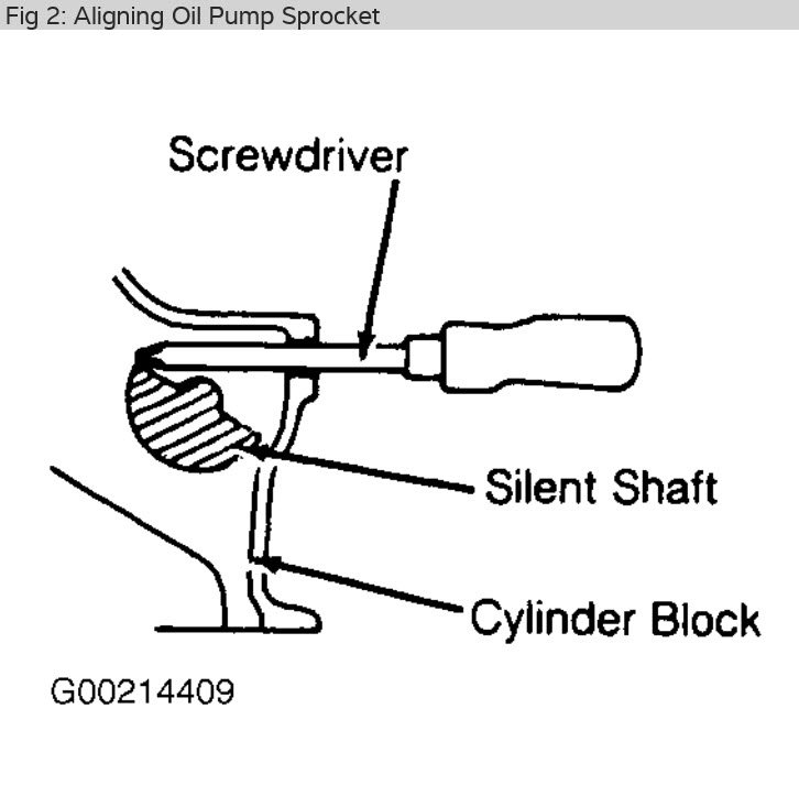

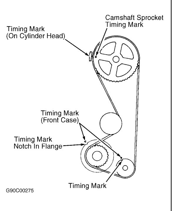

I replace the head I thought I was at top dead center when I pull the head off, but now the engine wont start. how do I get my timing back correct?

i am assuming this is a pickup this is for a 2.0 liter which is pictured. silent shaft must be aligned as well. see pictures.

That worked .What is the correct firing order on a 1988 two liter four cylinder?

1-3-4-2.

Thanks for your help. Running OK
