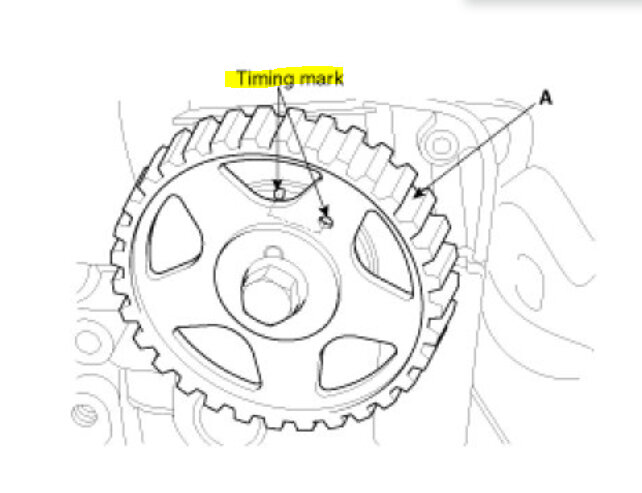

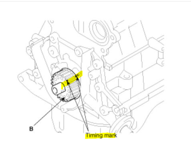

Timing marks on the timing belt?
2010 HYUNDAI ACCENT
1,407,880 MILES • 1.6L • 4 CYL • 2WD • AUTOMATIC
JOSHUA W BYRNE
Trying to set the timing on the gear and I'm not sure the cam is turned the right way?
Nov 19, 2023 at 11:56 PM
  • 110,244 POSTS
I attached what I believe you need below. Take a look and let me know if that helps.
Also, please remember this is an interference engine. Once you get things together, turn the crankshaft by hand to make sure there is nothing hitting and stopping it from turning. If something does stop it, do not force it.
Nov 20, 2023 at 11:34 AM
