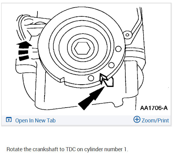

What are the timing marks for 2.0 Zetec?
2004 FORD FOCUS
250,000 MILES
JOHNBOY80.
Looking for timing marks or diagram.
Apr 30, 2025 at 11:04 AM
  • 55,423 POSTS

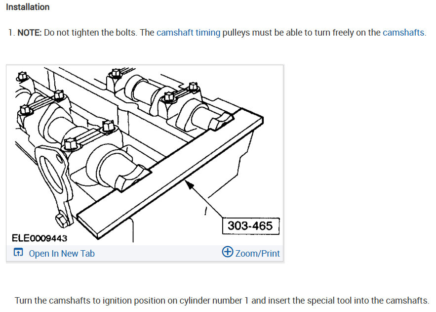

This engine does not have marks like you would think, they use a bar type tool which holds the camshafts from the rear of the engine, I think the auto parts store will have this they can rent to you for free. Here are the marks for the crankshaft though and how to install the timing rig. Check out the images (below). Let us know if you need anything else.
