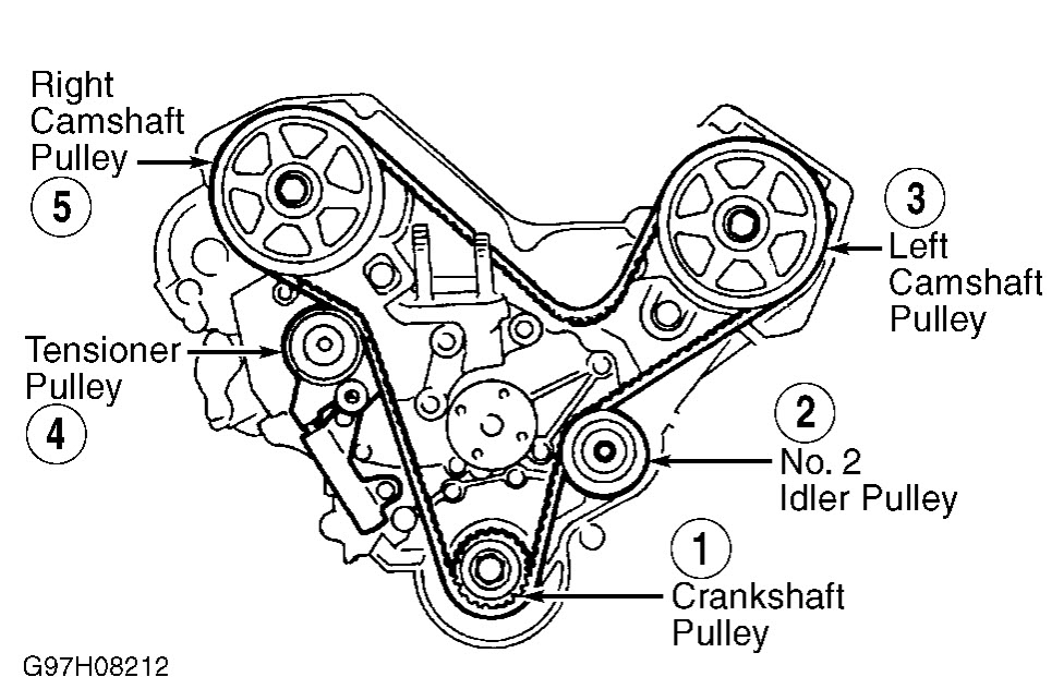

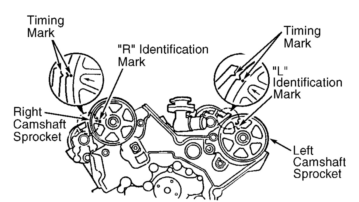

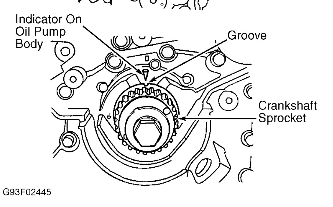

I need the timing marks for this car.

See pictures after install rotate two rotations to make sure they are properly aligned.
