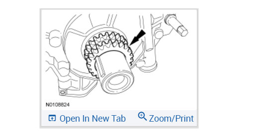

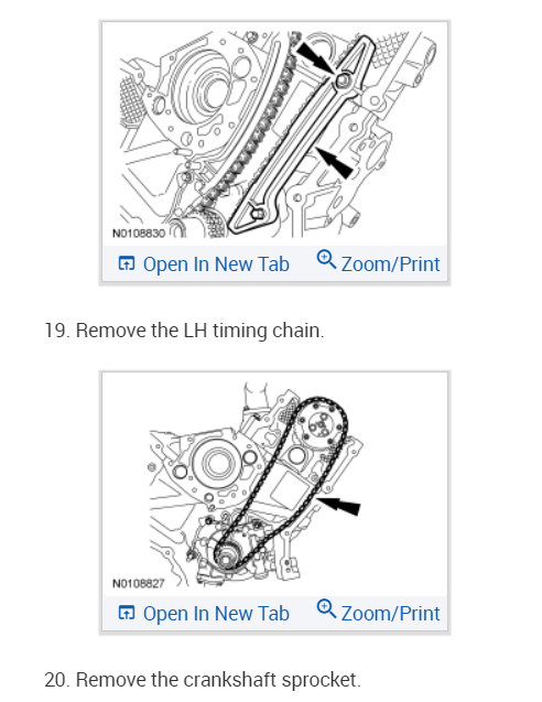

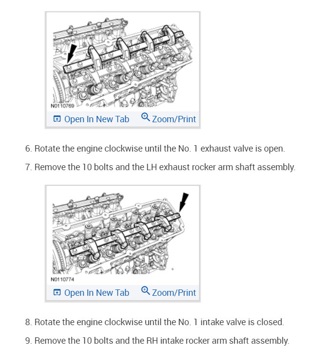

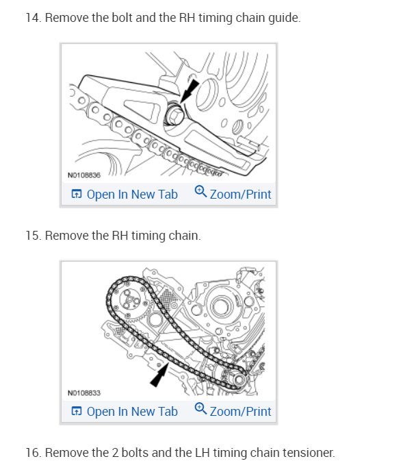

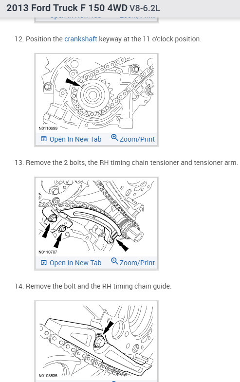

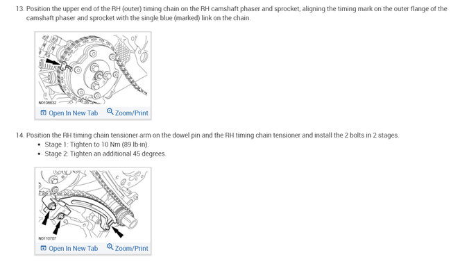

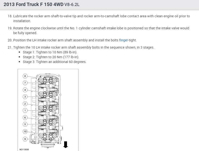

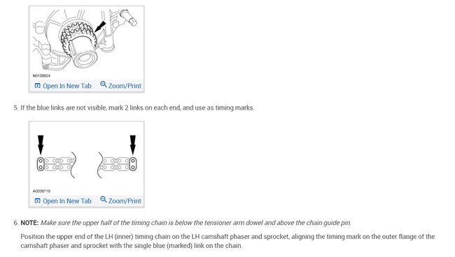

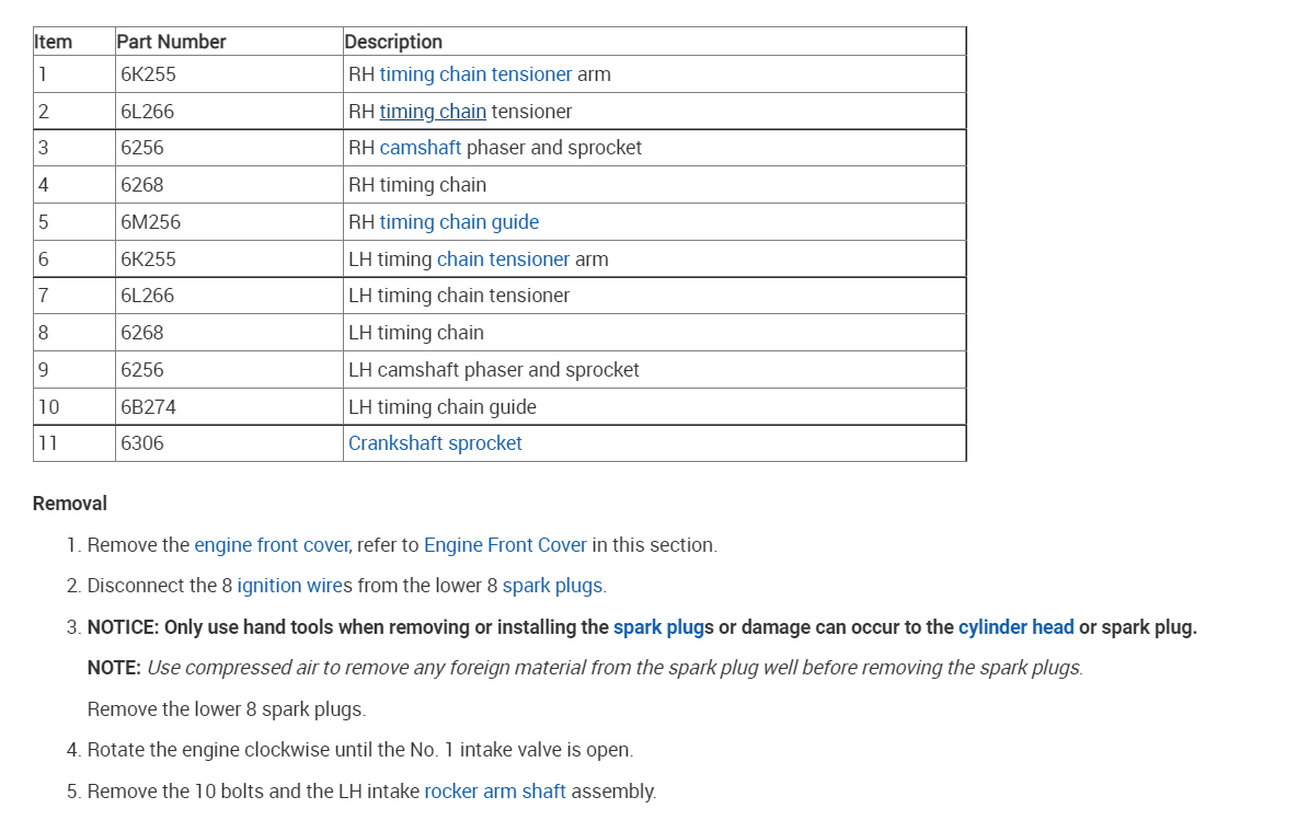

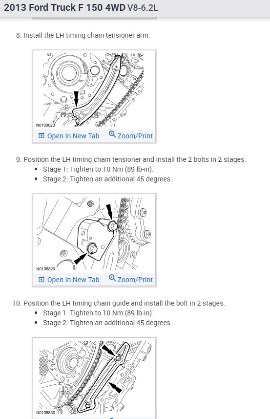

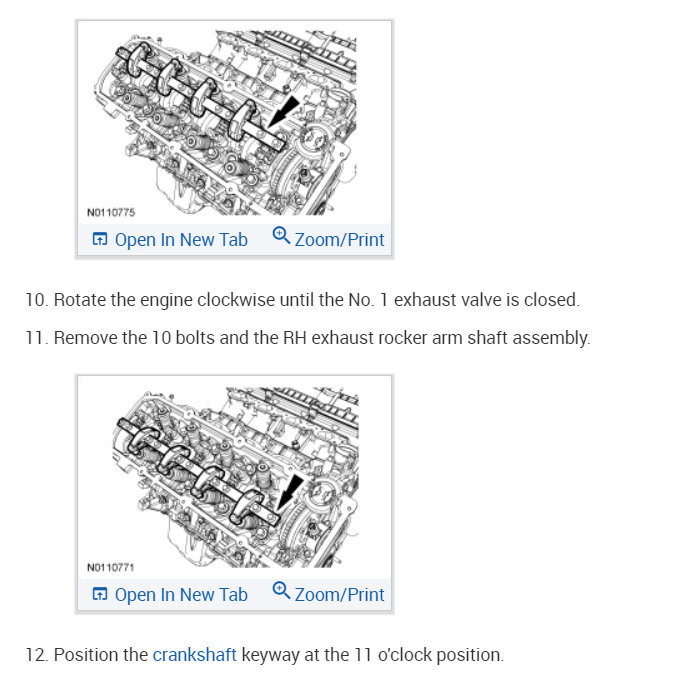

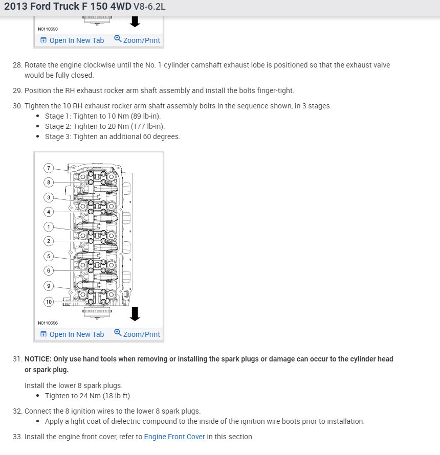

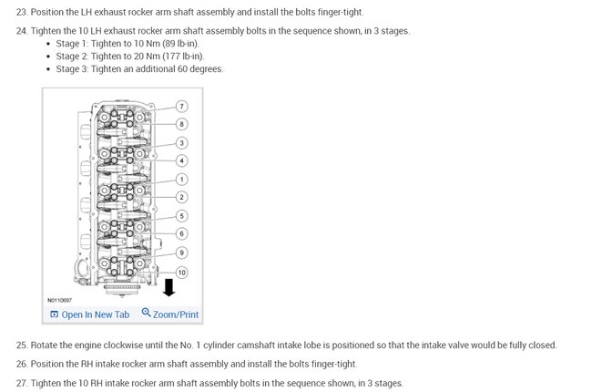

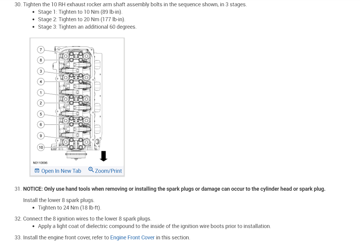

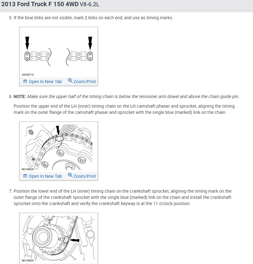

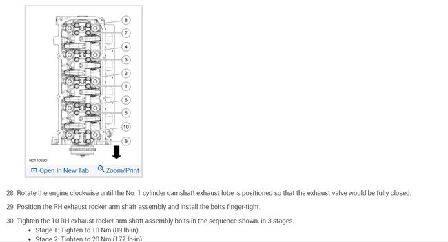

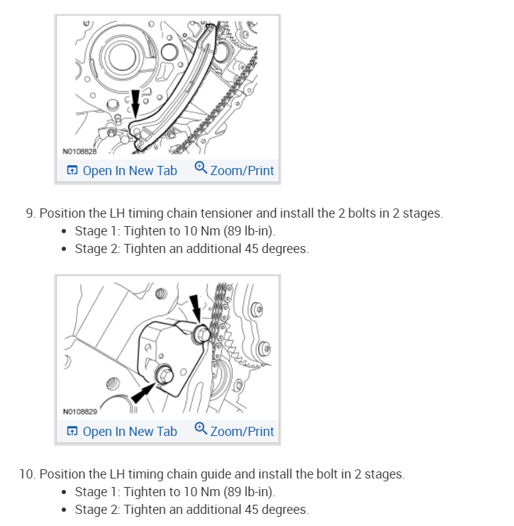

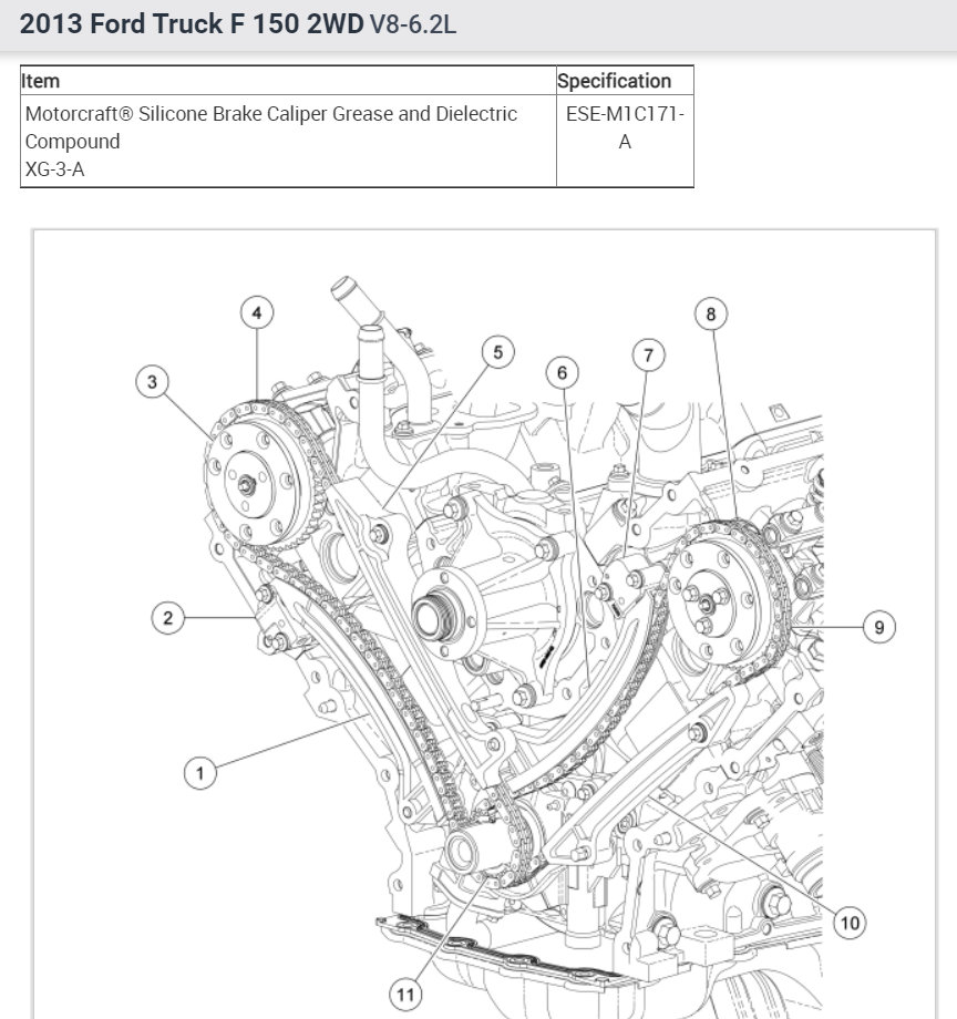

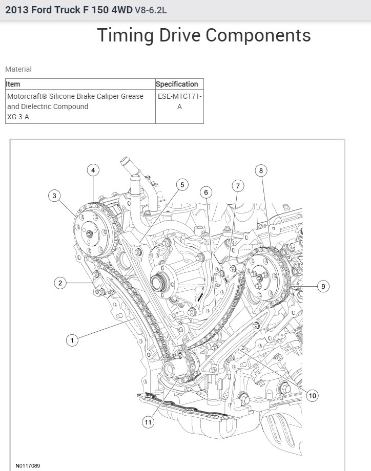

How to get correct timing marks for both camshafts?
Jul 3, 2022 at 12:18 AM
SQM
  • 6,383 POSTS

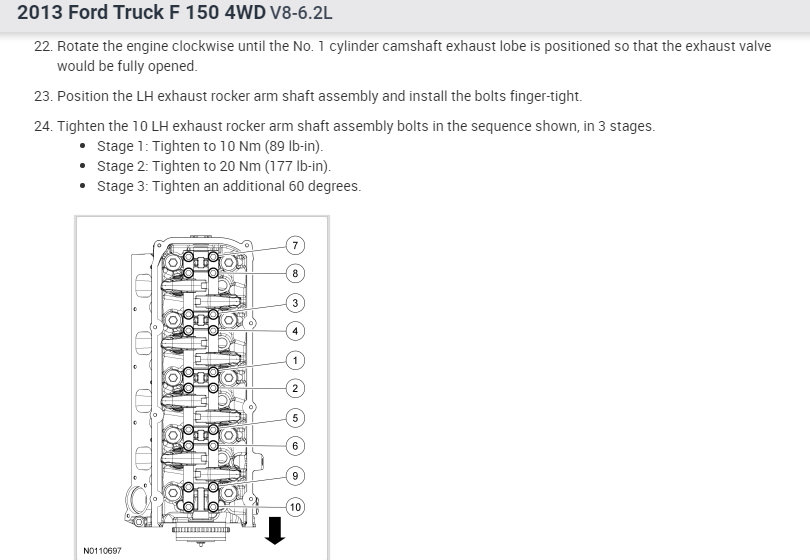

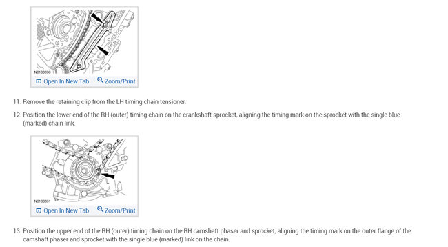

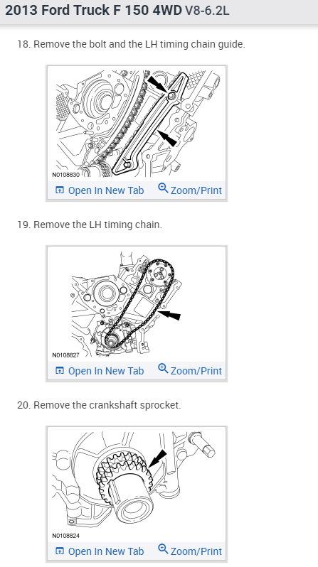

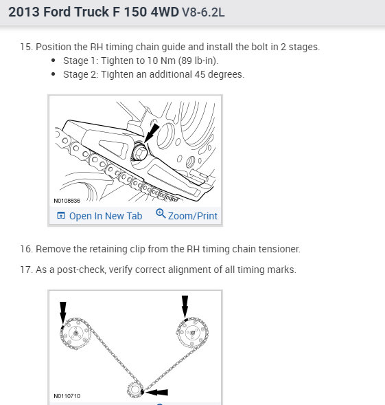

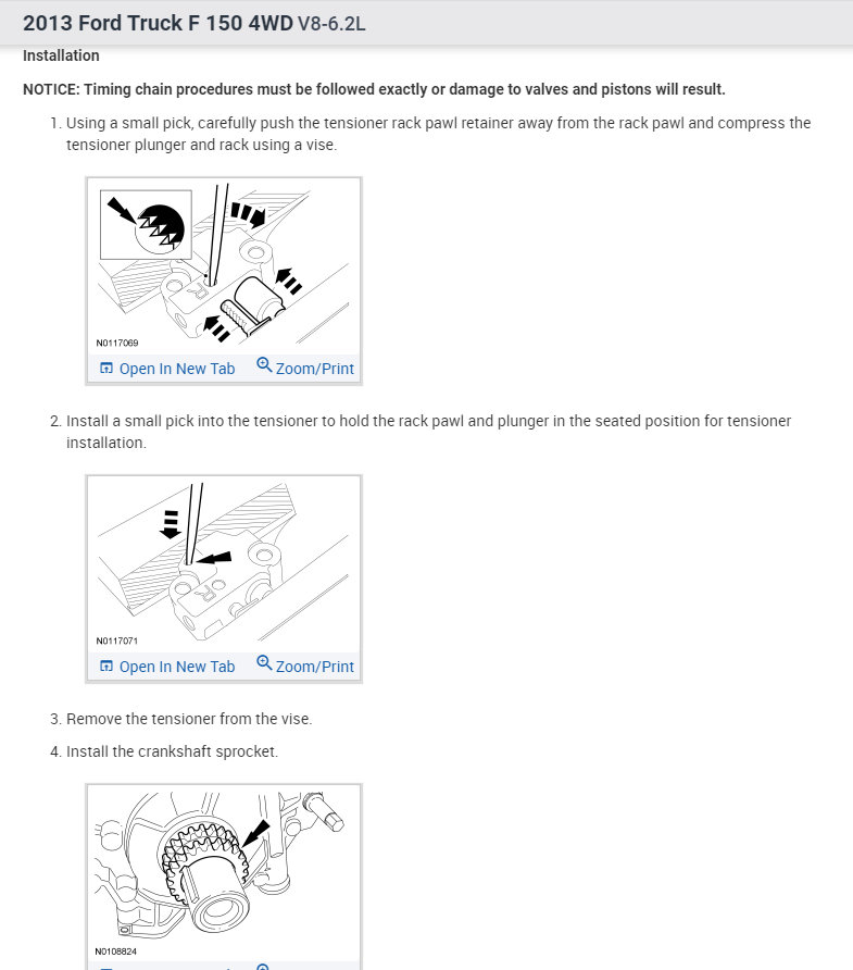

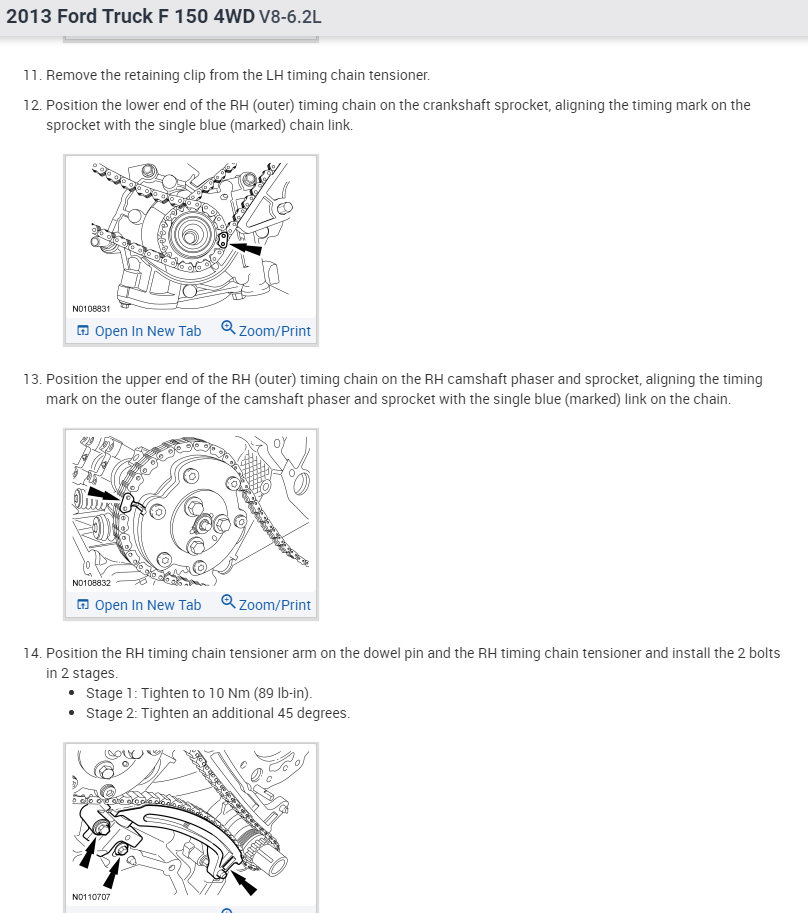

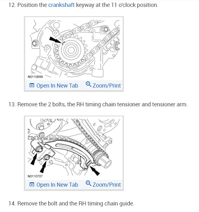

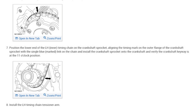

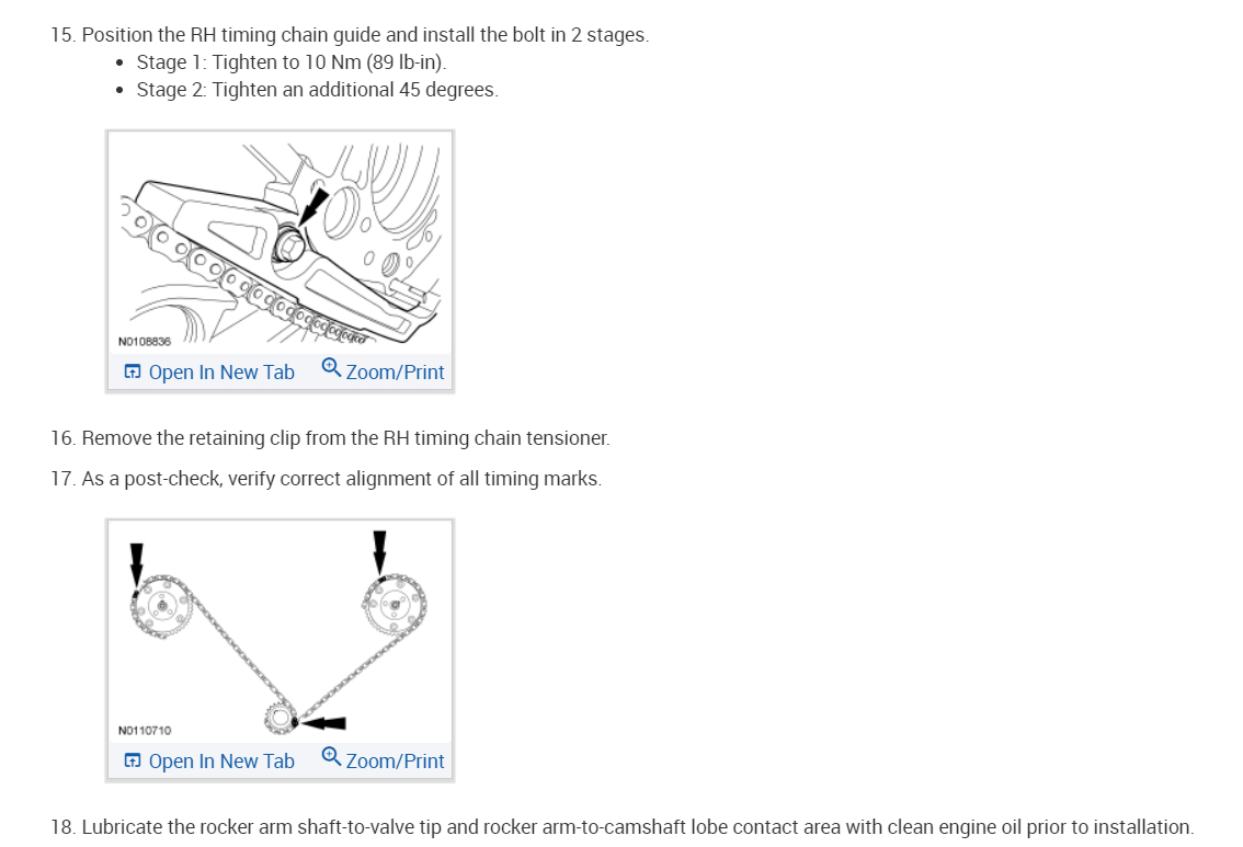

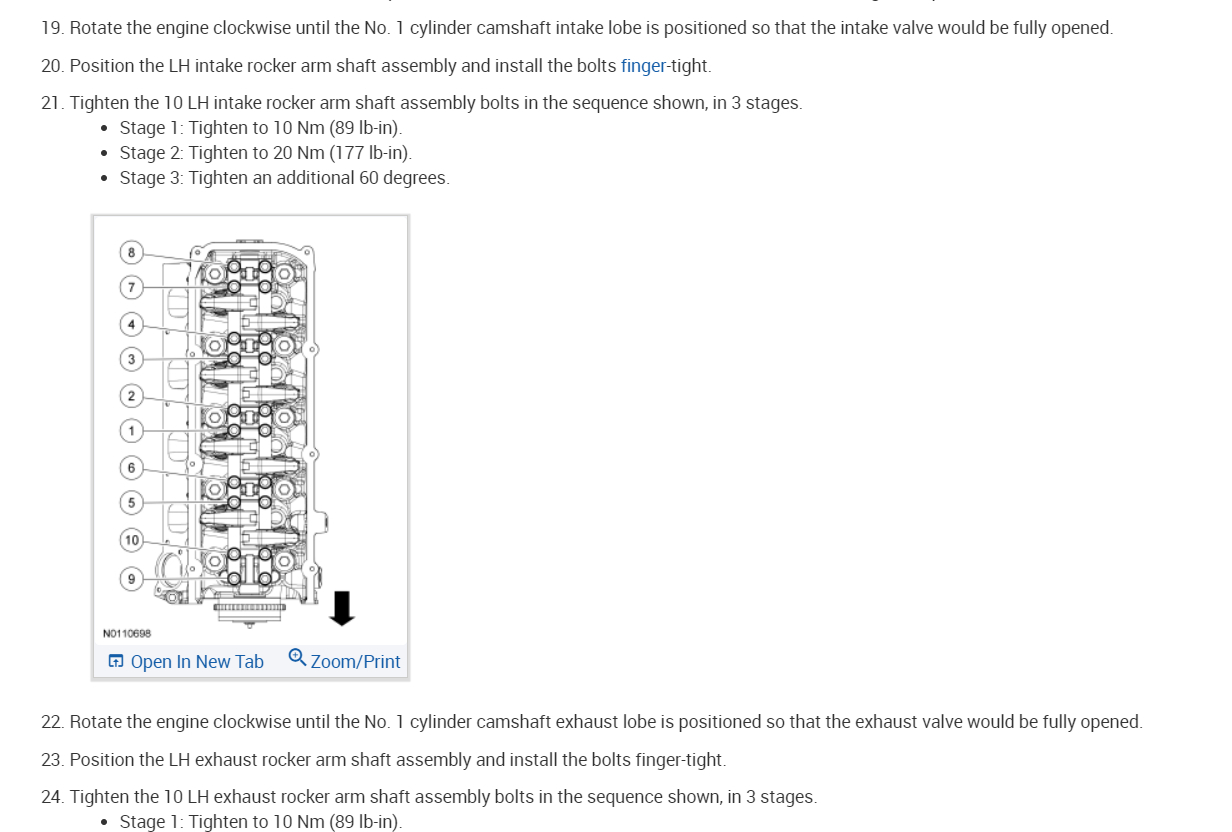

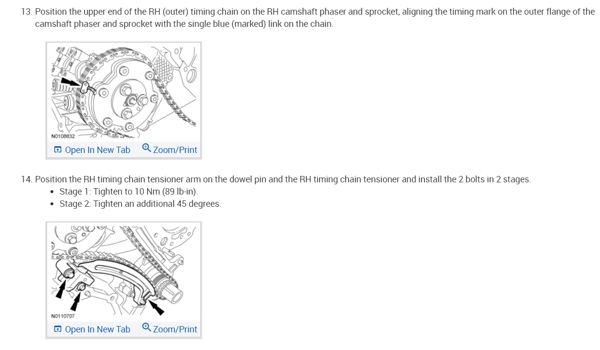

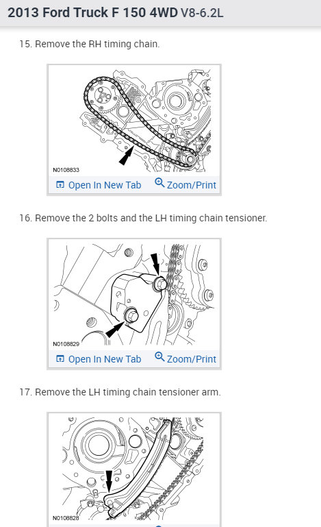

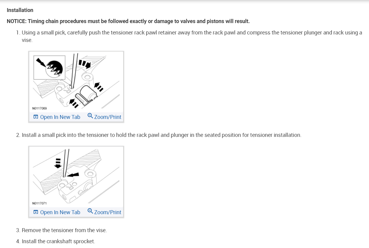

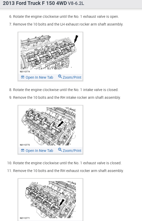

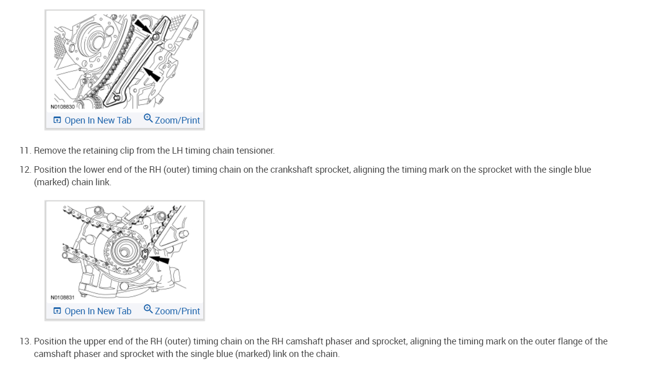

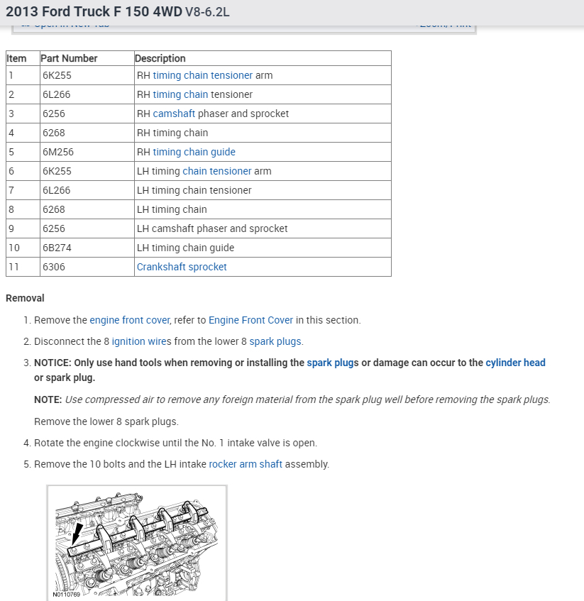

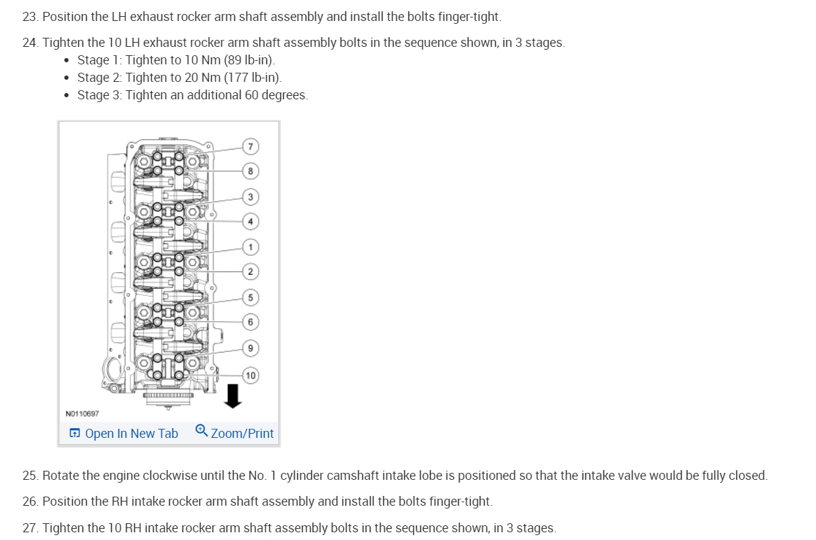

See attached for the timing chain replacement procedure including the timing marks.
Let me know of any questions.
Jul 3, 2022 at 3:13 AM
  • 55,214 POSTS
It is a process to get the timing chain marks correct, here are the timing chain replacement procedures and marks in the diagrams below. Check out the diagrams (below). Please let us know if you need anything else to get the problem fixed.
Jul 3, 2022 at 3:20 AM
UBONNKE
Please is the type of engine I am working on, I love if more similar engine will be touch, yet still a timing diagram of coyote engine with twin camshaft, 5.0liter v8 f150 Ford truck. 2013 - 2014 f150 Ford.
Jul 3, 2022 at 5:01 AM
UBONNKE
I mean 2012 Gen 1 coyote timing marks with diagrams.
