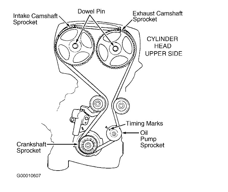

What are the Timing marks?

The timing belt broke. I'm trying find the timing marks to put a belt on so i can see if it bent the valves. but the timing mark that i found on the crank is on the right side of the plate. Could it be that someone put the plate back on wrong? Under the crank sensor. Also, what position does the crank moon key supposed to be when it's on TDC?

It looks like the woodruff key should be straight up.
Here is a guide to help you with the job plus check the image below:
https://www.2carpros.com/diagrams/hyundai/santa-fe/2002
Check out the images (below). Let us know what happens and please upload pictures or videos of the problem.
