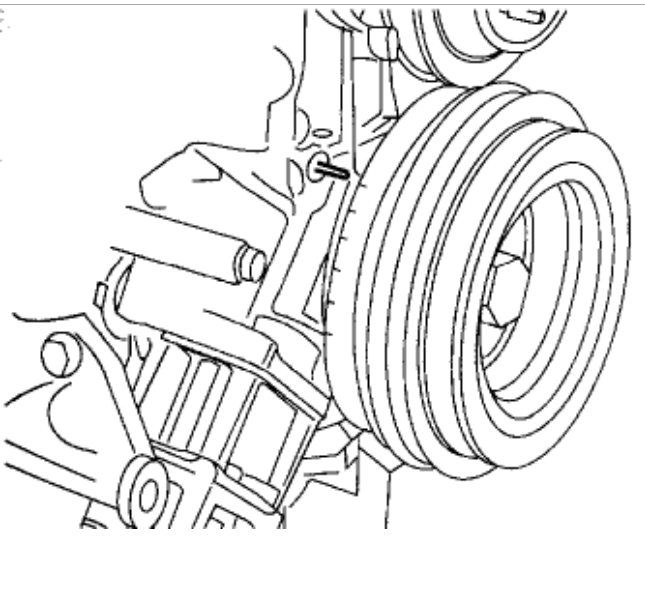

I am having trouble on finding the crankshaft timing mark. please help.
Oct 27, 2017 at 7:25 AM
STEVE W.
  • 15,349 POSTS
The mark lines up with the crankshaft gear key. This guide can help as well

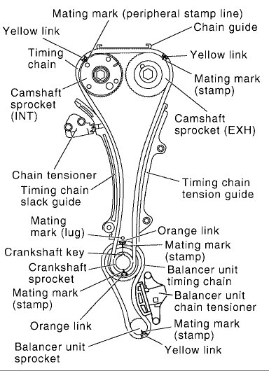

VINCENTTUDISCA
ive located the timing mark on the cam sprocket and cam sprocket but cannot find the location of the one on the engine? can you tell me where to find it or how to determine what it is???

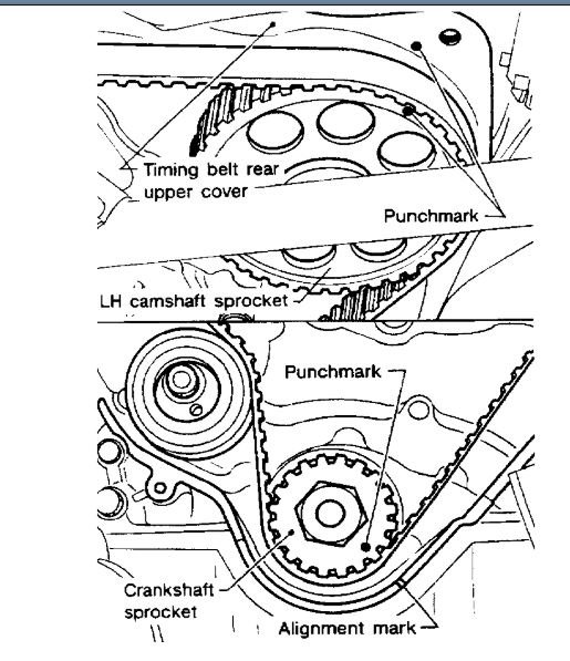

BLUELIGHTNIN6
  • 16,542 POSTS
count teeth. needs 40 teeth betweem camshafts and 43 teeth between left cam and crank pully mark. .

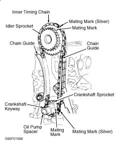

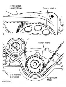

JENDSLEY
please show me timing diagram for 1998 nissan frontier
May 21, 2021 at 9:07 AM (Merged)
DOCFIXIT
  • 18,828 POSTS
https://images.2carpros.com/forum/automotive_pictures/198357_Graphic_367.jpg
https://images.2carpros.com/forum/automotive_pictures/198357_Grafic_3_98.jpg
https://images.2carpros.com/forum/automotive_pictures/198357_Graphic_5_13.jpg
How about this
May 21, 2021 at 9:08 AM (Merged)

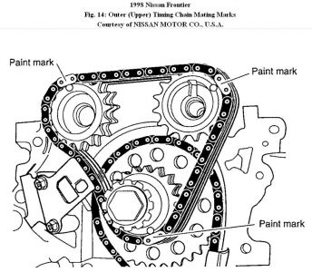

S.DURAN
on the two gears, there are two marks instead of one.
how do I know which mark to use?
WRENCHTECH
  • 20,761 POSTS
The chain has colored links that are to be matched up with the timing marks. https://www.2carpros.com/images/external/78975287.gif
S.DURAN
Each gear to the cam has two marks instead of one mark. I will try to send a picture tomorrow. And yes, the chain has colored links to match the timing marks, The question is which of the two marks is correct?
WRENCHTECH
  • 20,761 POSTS
There should only be one actual timing mark there.

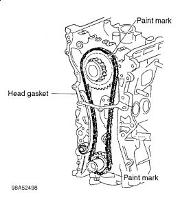

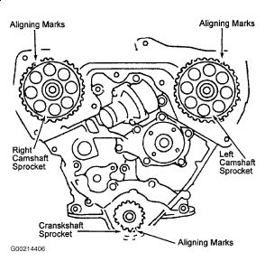

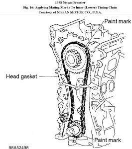

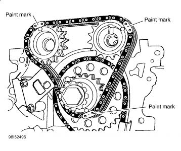

DARLENE2508
how do i know how to get the timing chain in the right place how does it fit on the cam?
Jul 6, 2021 at 8:24 AM (Merged)
KHLOW2008
  • 41,814 POSTS
Hi Darlene2508, The timing chain has paint marks on certain links for mating purposes. You need to get them lined up.
https://images.2carpros.com/forum/automotive_pictures/192750_TimingChain98FrontierFig14_1.jpg
https://images.2carpros.com/forum/automotive_pictures/192750_TimingChain98FrontierFig16_1.jpg
If the paint marks are not visible, you need to clean the chain and check for links that are slightly darker to get the mating marks. Ignition Timing - Base 20 +/- 2 Deg. BTDC Check out the diagrams (Below). Please let us know if you need anything else to get the problem fixed. Cheers
