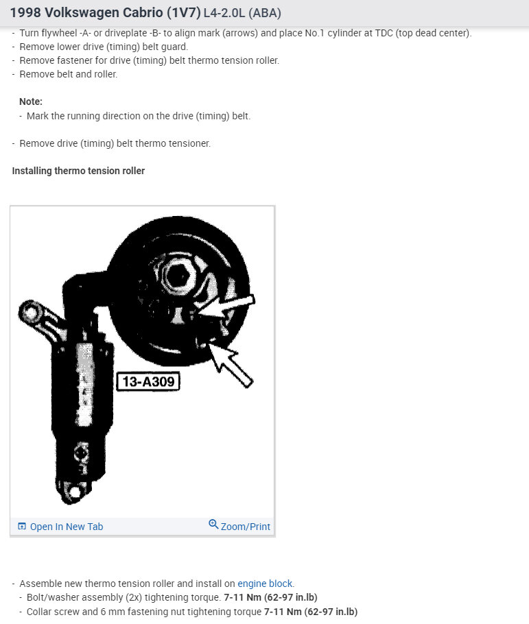

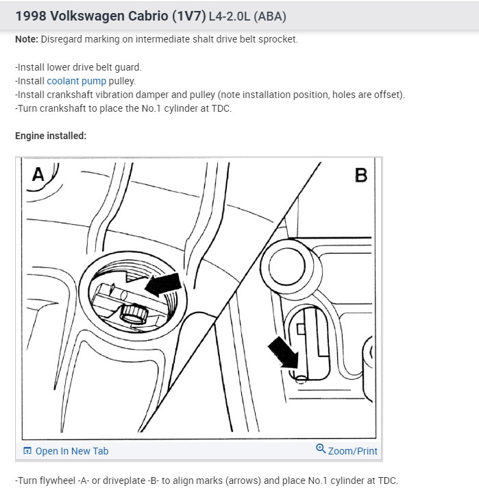

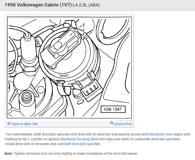

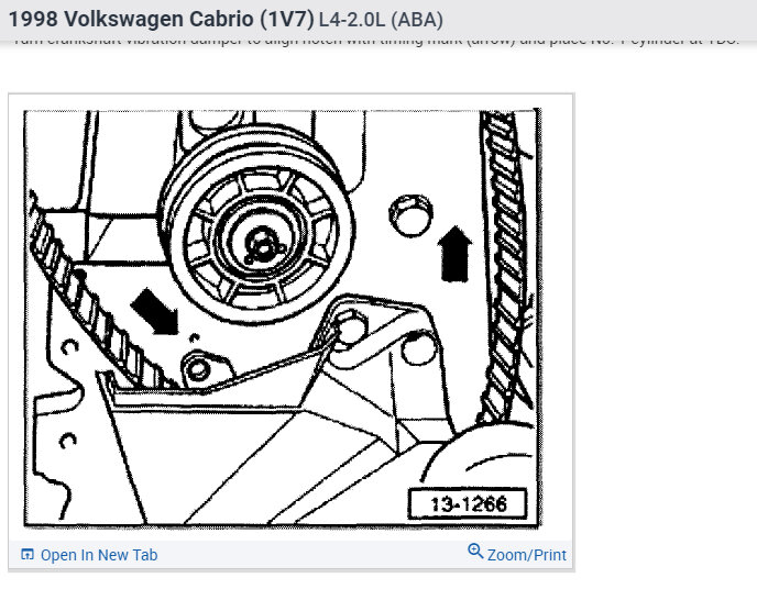

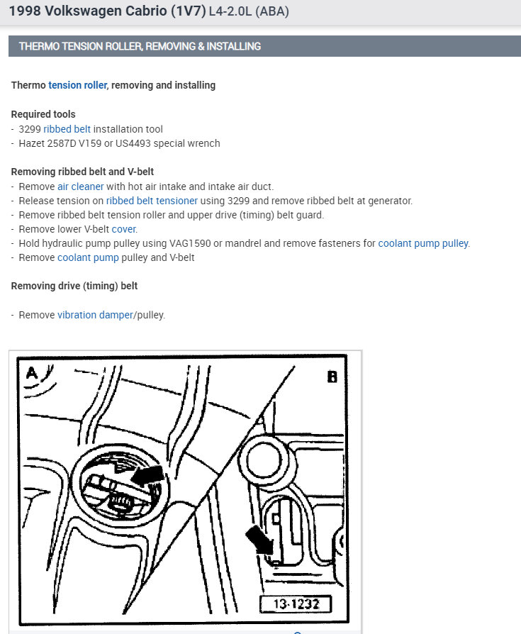

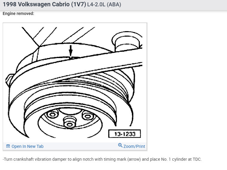

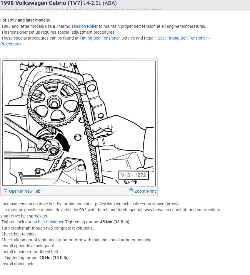

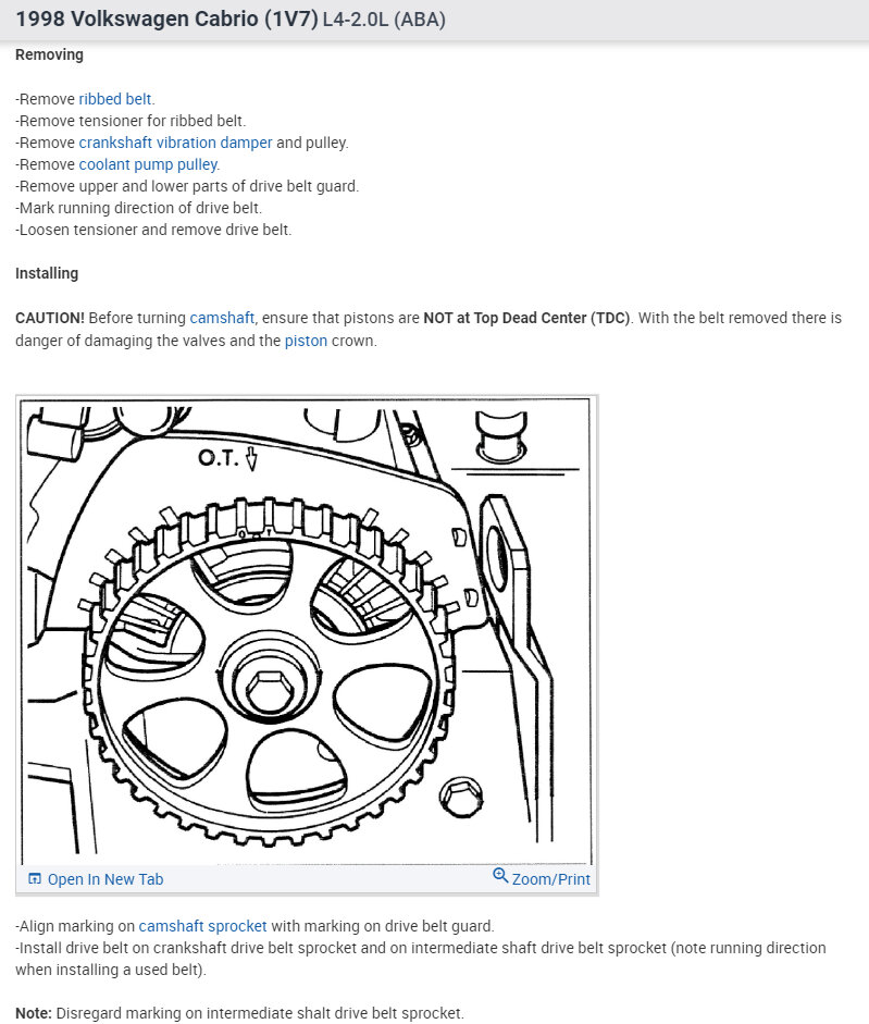

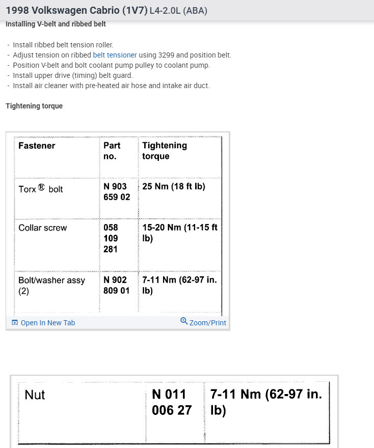

Hi guys. Unfortunately, I have been roped into finishing someone else's unfinished job of replacing a water pump on this car. So, I guess if I could just get a copy of the whole run down the timing belt and alignment should be included. Thank you.
Alex
Oct 21, 2022 at 7:24 AM
SQM
  • 6,383 POSTS
Hello Alex,
See attached for the timing belt procedure.
Let me know if you have any questions.
Thank you
https://www.2carpros.com/articles/how-a-timing-belt-works.
Oct 21, 2022 at 1:15 PM

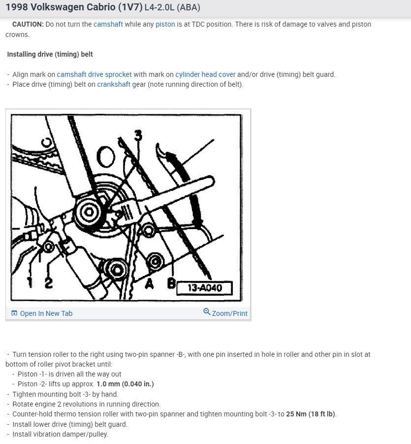

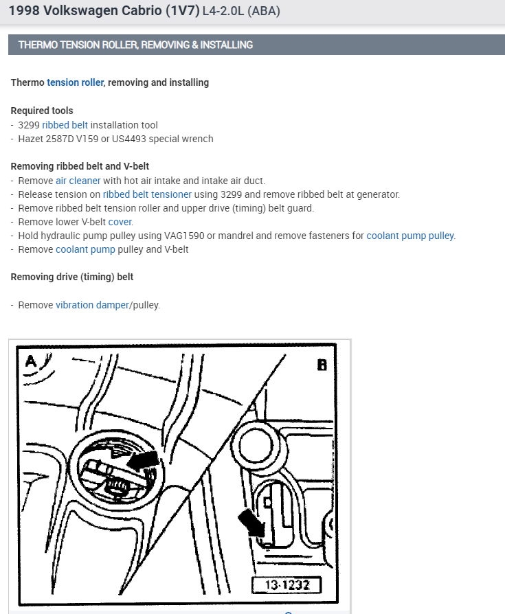

Can I also get the "special procedures" for the thermo tensioner please? Thank you for your help.
Alex
Oct 21, 2022 at 3:29 PM
SQM
  • 6,383 POSTS
See attached for the tensioner procedure.
Oct 22, 2022 at 1:25 PM
