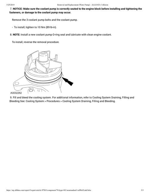

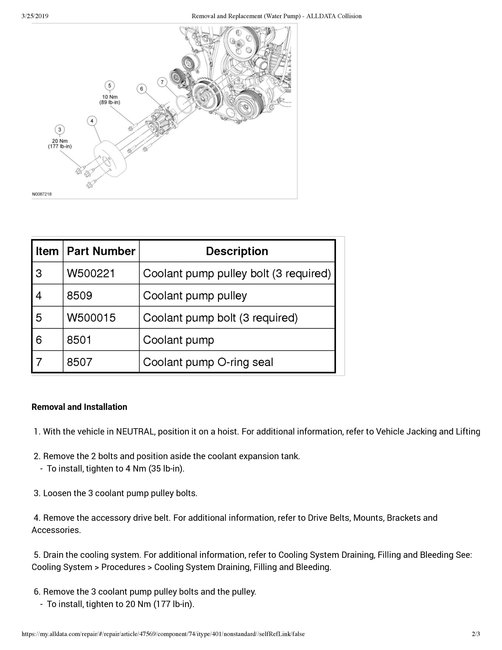

Interesting. How about the water pump?
Mar 24, 2019 at 4:37 PM
JOETECHPRO
  • 705 POSTS

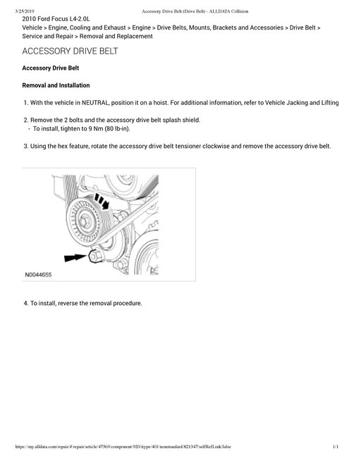

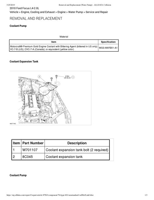

Hey JONSOLOW13,
The water pump is driven by the auxiliary belt.
I have attached instructions to replace the water pump, i have also added how to remove and install the drive belt.
Any further questions don't hesitate to ask.
Regards, Joe
