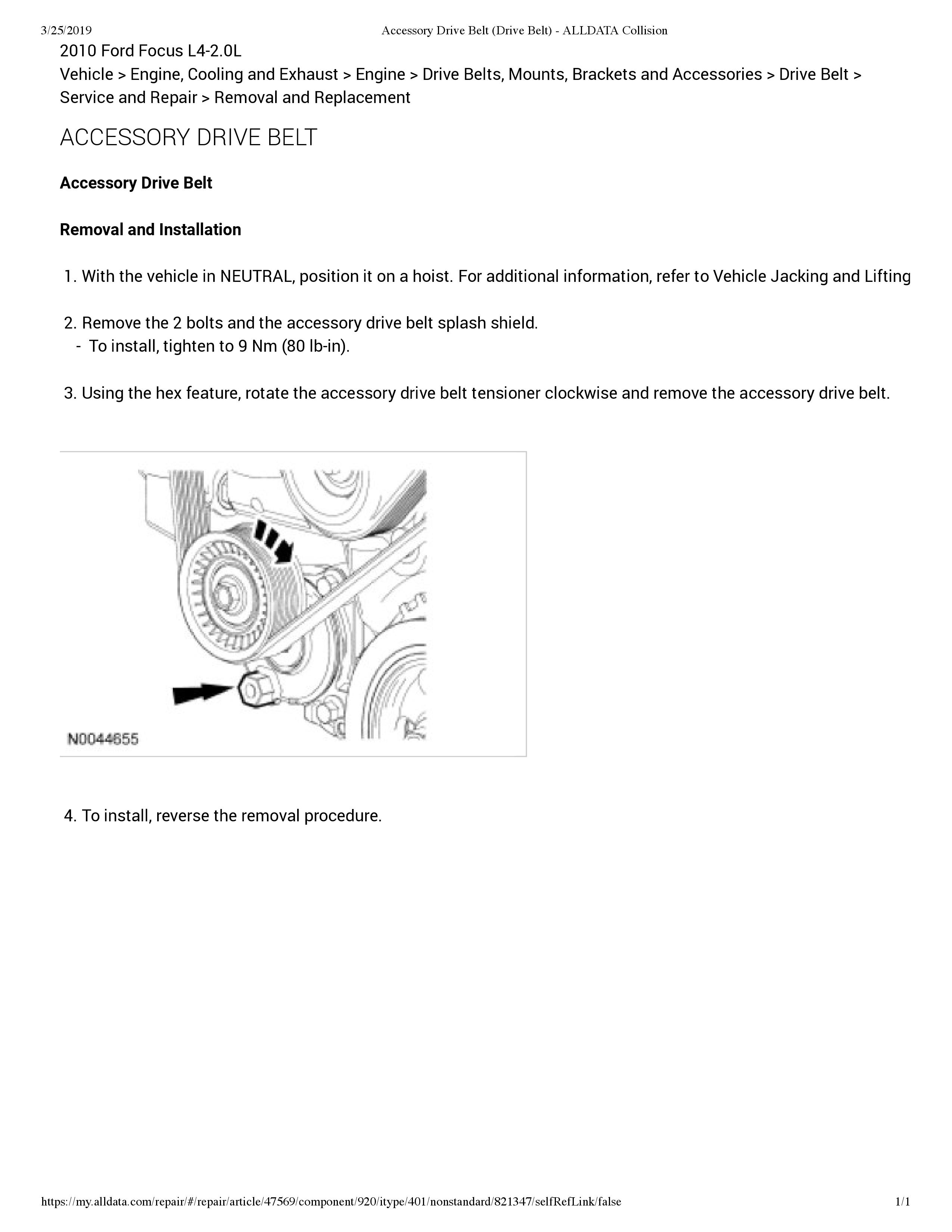

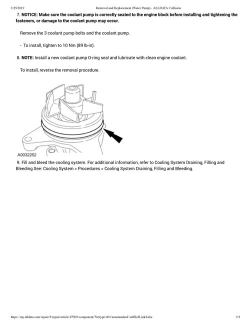

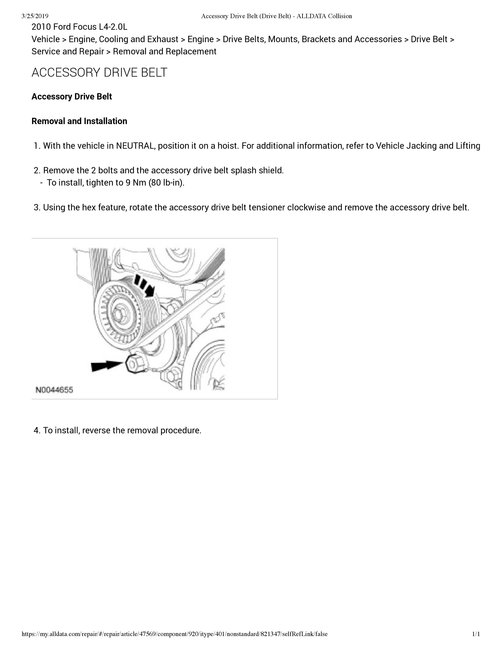

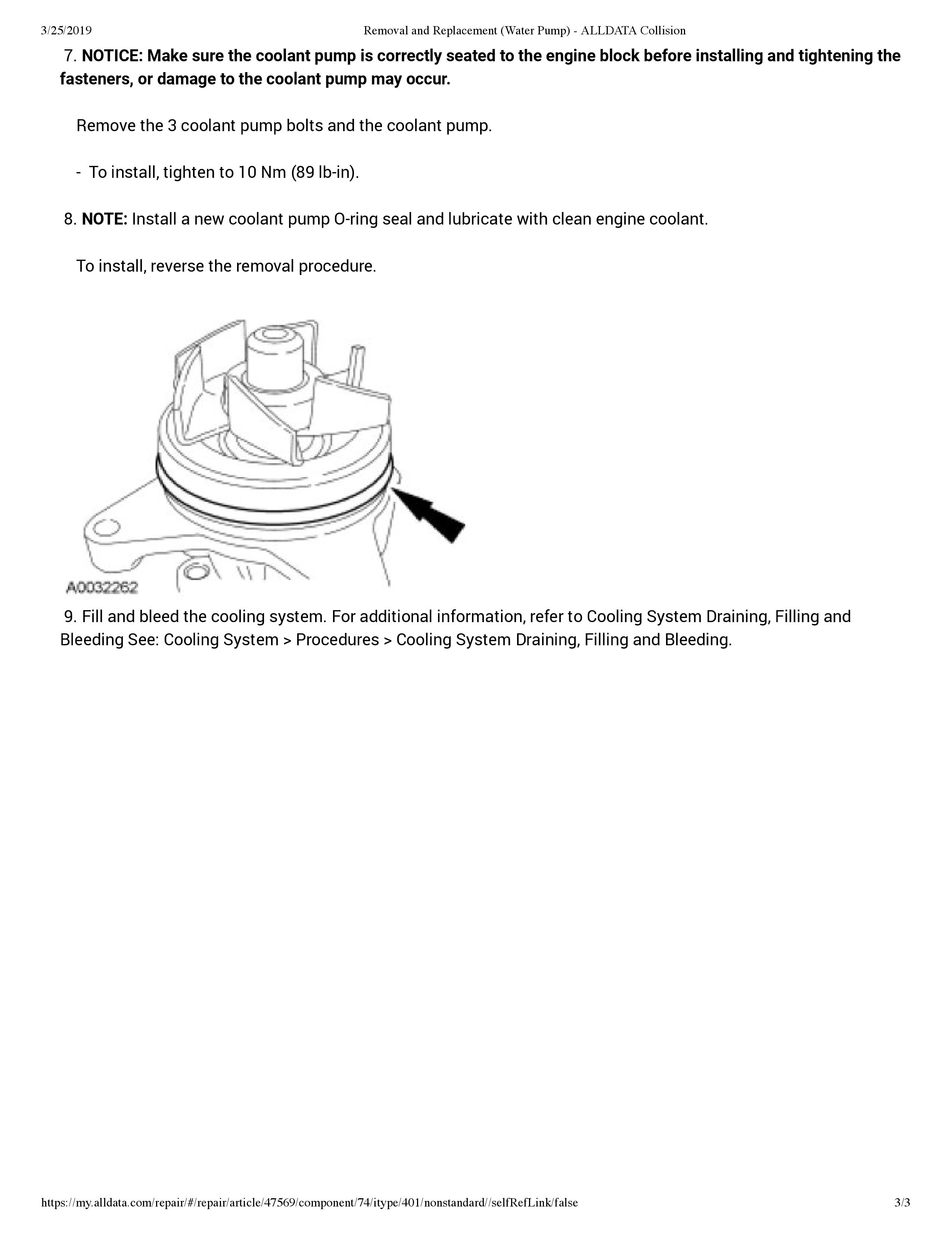

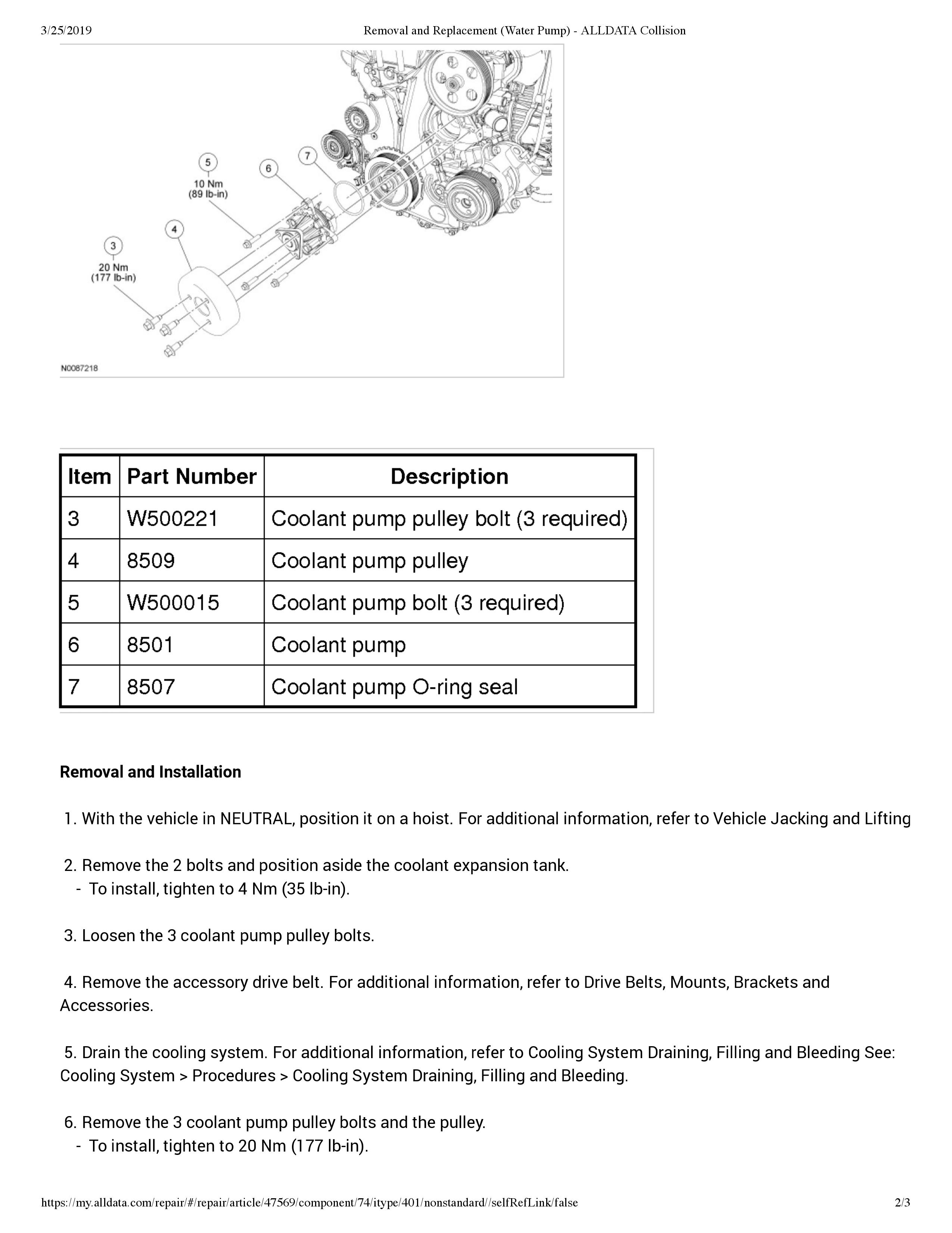

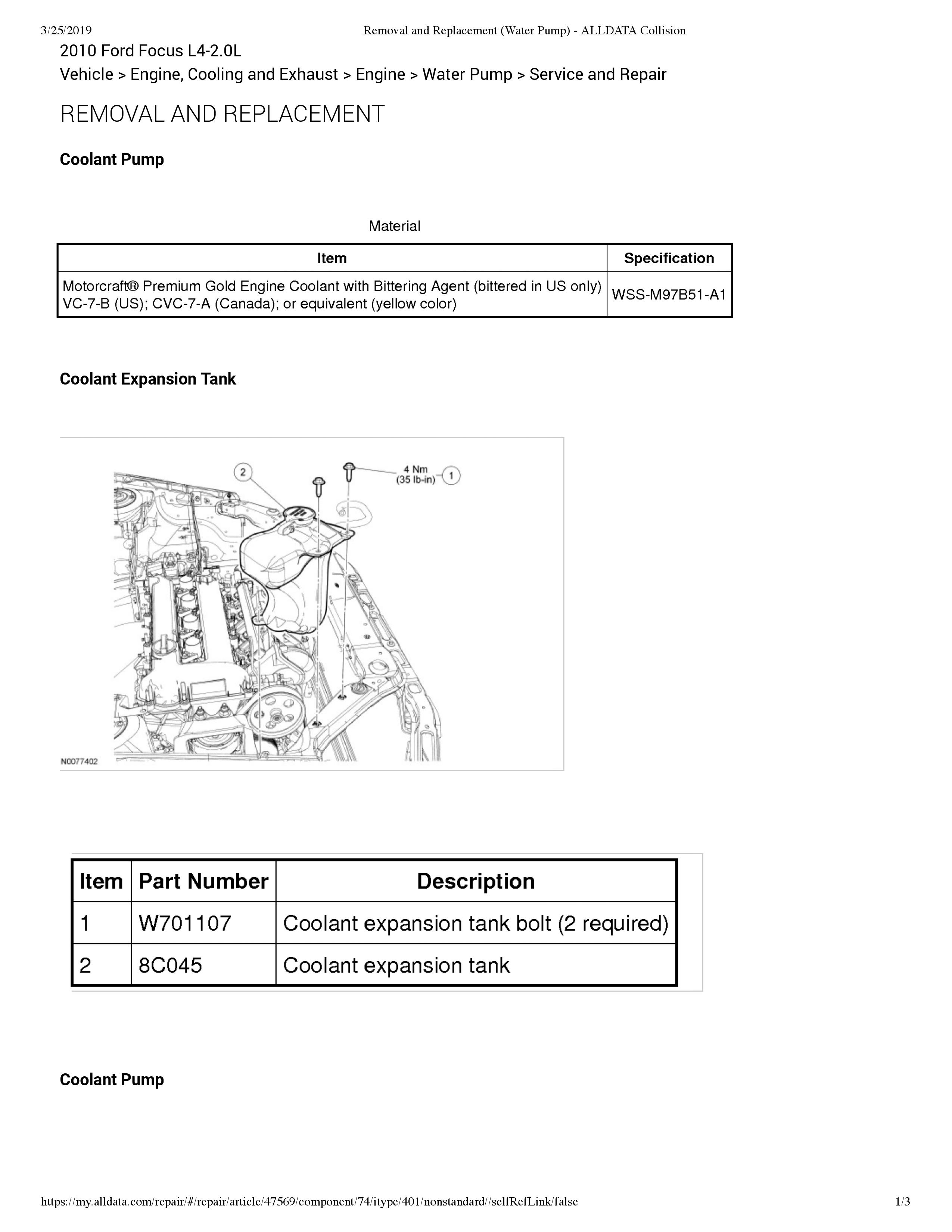

Hey JONSOLOW13,
The water pump is driven by the auxiliary belt.
I have attached instructions to replace the water pump, i have also added how to remove and install the drive belt.
Any further questions don't hesitate to ask.
Regards, Joe
