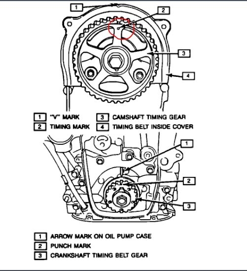

can't find clear mark on crank pulley to time distributor after timing belt replacement.
Aug 25, 2020 at 12:23 PM
Good afternoon,

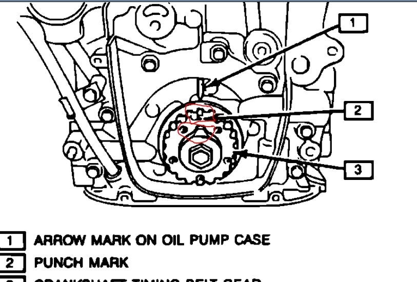

I attached a picture for you. You will have to clean off the crank pulley to see the mark.
Also, the key way being at 12 o'clock is also top dead center as well.
Aug 25, 2020 at 12:35 PM
MICHAEL GOSNEY
  • 16 POSTS
I've got conflicting info but not from you. One site or page said while putting belt on he had the cam mark at almost a quarter past, while the others, both cam and crank were at 12:00 and that's how I installed it. Yet when resetting distributor, they say use #4 cylinder at TDC. So if it's 180 out, can I use the #1 instead or pull it back apart and reset the belt again?
Aug 25, 2020 at 2:38 PM
Okay, where or how is the belt set at this point?
Aug 25, 2020 at 2:52 PM
MICHAEL GOSNEY
  • 16 POSTS
With both the crank and cam gear at twelve o'clock, with the factory marks. I'm not 100% sure if it was on compression stroke because of it not starting. I've lined up the timing mark at TDC and set distributor at #4 cylinder.
Aug 25, 2020 at 2:58 PM
With the marks set where you are, you are at top dead center number 1 cylinder. Your distributor is 180 out.
I attached the cam mark as well.

Okay, yes,the old belt broke so everything had to be reset.I'm wondering,if the gear marks were lined up and new belt installed,if it was on exhaust stroke,can I reline the marks and make sure if the compression stroke and reset distributor then?Also,with the tracker 1.6 8 valve have you heard of the distributor lining up with #4 cylinder?
Aug 25, 2020 at 3:21 PM
Never on number 4.
Set the marks on the same as in the diagram I sent you. Then drop in the distributor with the rotor pointing to number 1 cylinder. Then you are good.
Do a compression test as well to see if the valves are damaged from the belt failure.
Aug 25, 2020 at 3:30 PM
MICHAEL GOSNEY
  • 16 POSTS
Okay Roy, thank you very much, I know your time is valuable and it's been a while since I've done a broken belt replacement. The #4 thing is info out there by several people, not sure of experience level. I'm going to do it on #1and again. thank you. I'll update with results.

It turns out I was looking at a mark on the front pulley, when I spun it around a couple more times, I found the actual mark on the back pulley. By that one, the rotor was in between,(on 2-3)so I was so glad to discover it was my 58 year old eye sight, not my forgetting how to time a vehicle. Interestingly, it runs good but when the owner comes back, I'm going to see about the #4 cylinder adjust. I think it possibly will run better. I believe it's been set the normal way by default. I'll get the distributor in the center of the housing that way for more adjustability. Again, I'll update you and thank you Roy for your time.
