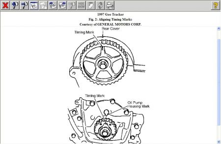

how should the timing marks be set on this tracker i set the marks by the book but it does not start (fyi)it did start befor i changed the head gasket.

Put the engine's no.1 piston on its compression stroke/TDC then line the sprockets up as shown and slap the T/belt on.
https://images.2carpros.com/forum/automotive_pictures/12900_timing_8.jpg
