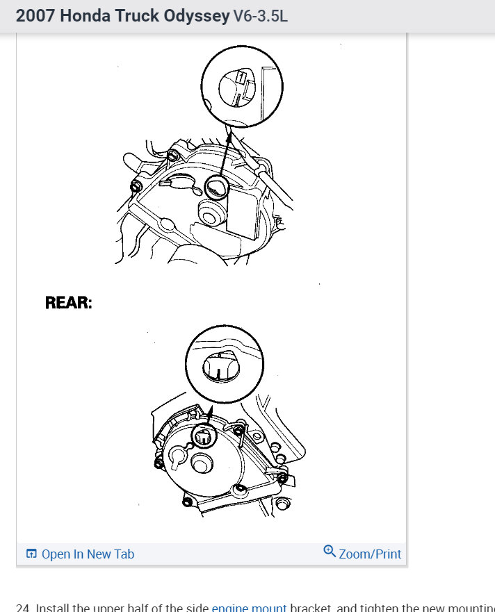

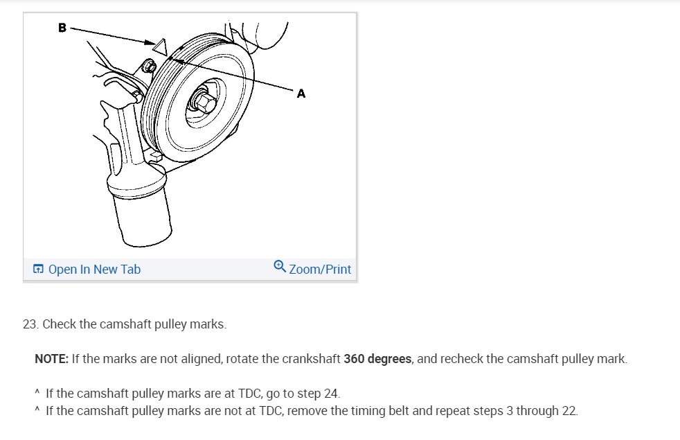

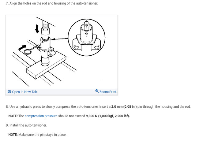

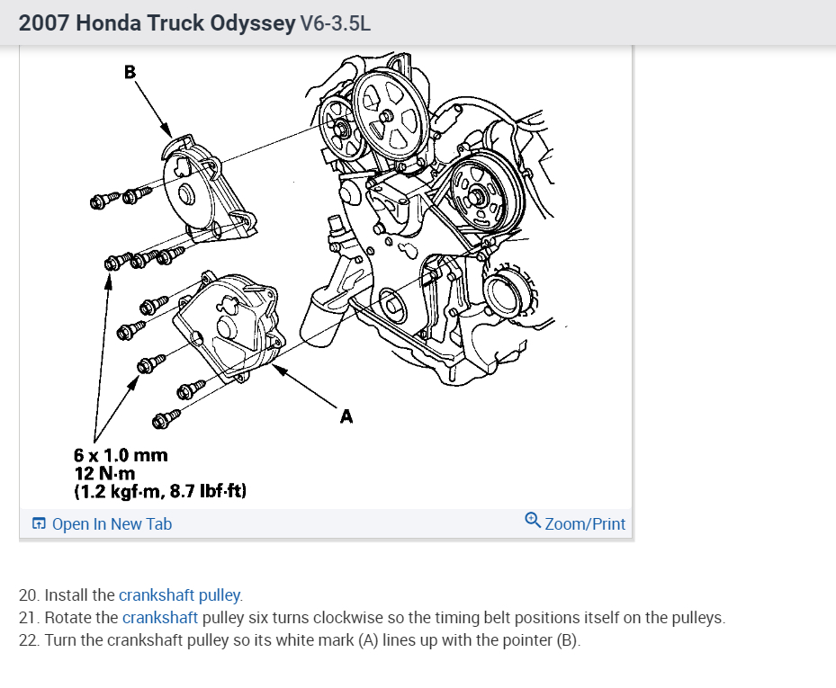

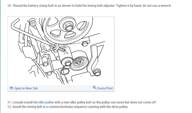

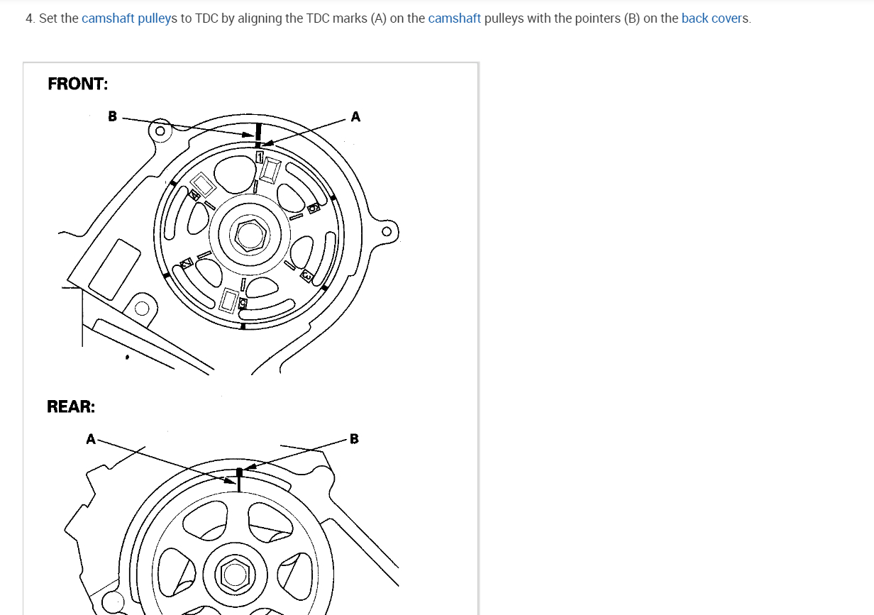

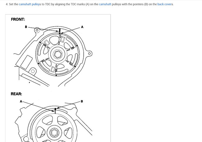

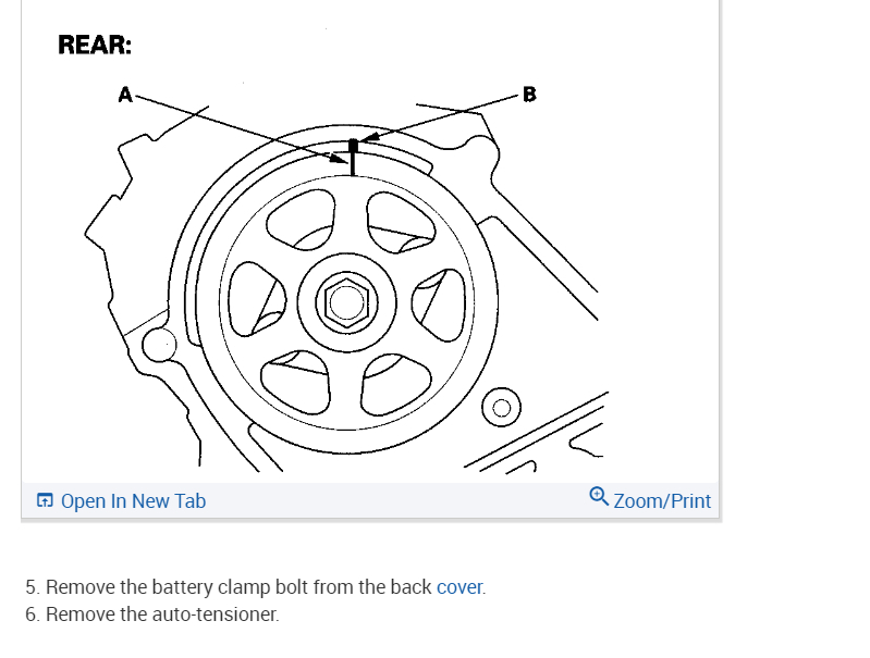

Replacing the timing belt, and the crank and front cam are at TDC, but rear cam is sitting about 20 to 30 degrees forward. What could cause this, and how to fix it?
Oct 24, 2022 at 8:28 AM
  • 55,399 POSTS

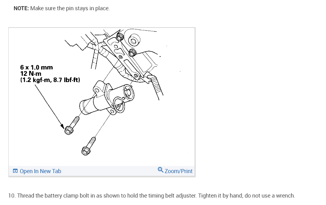

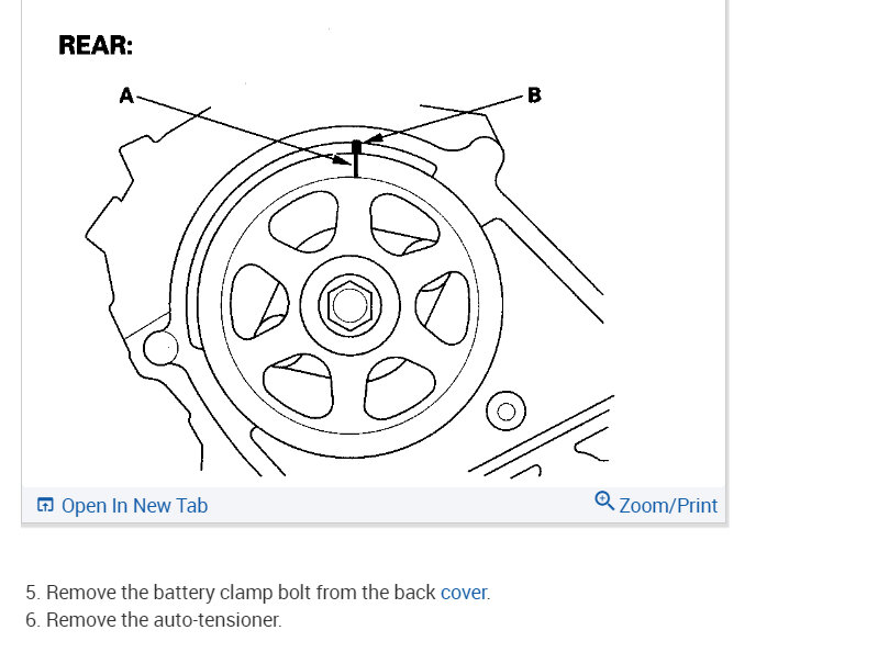

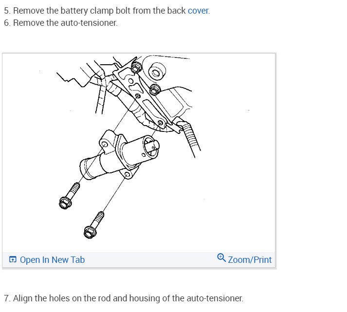

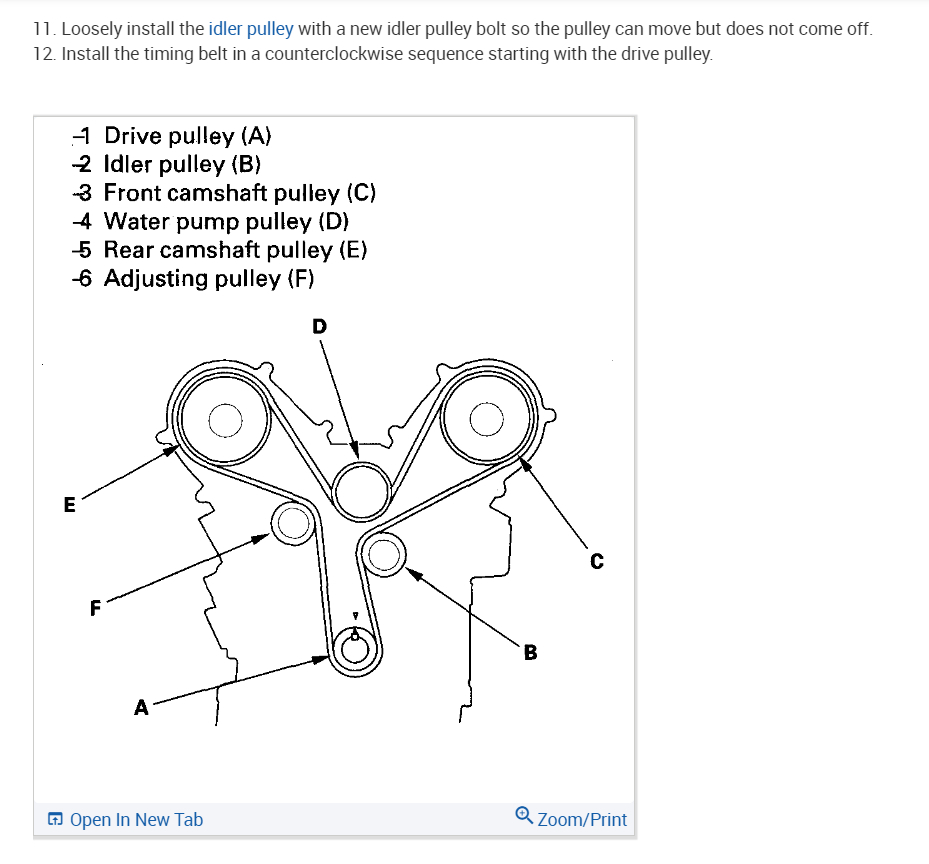

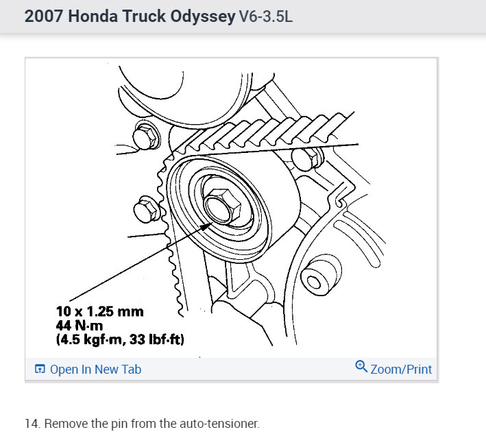

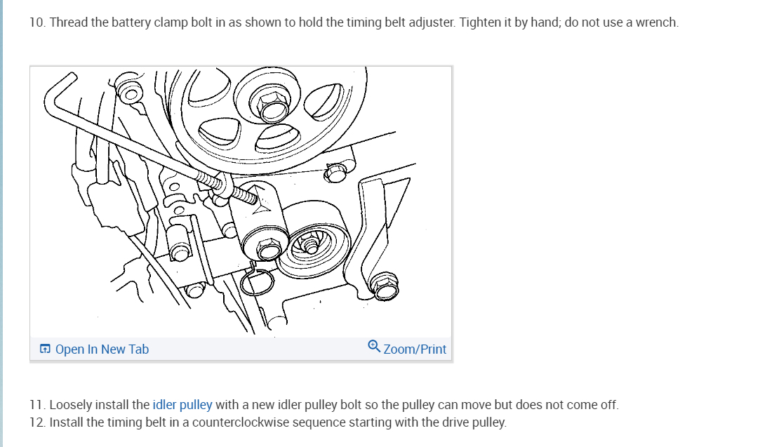

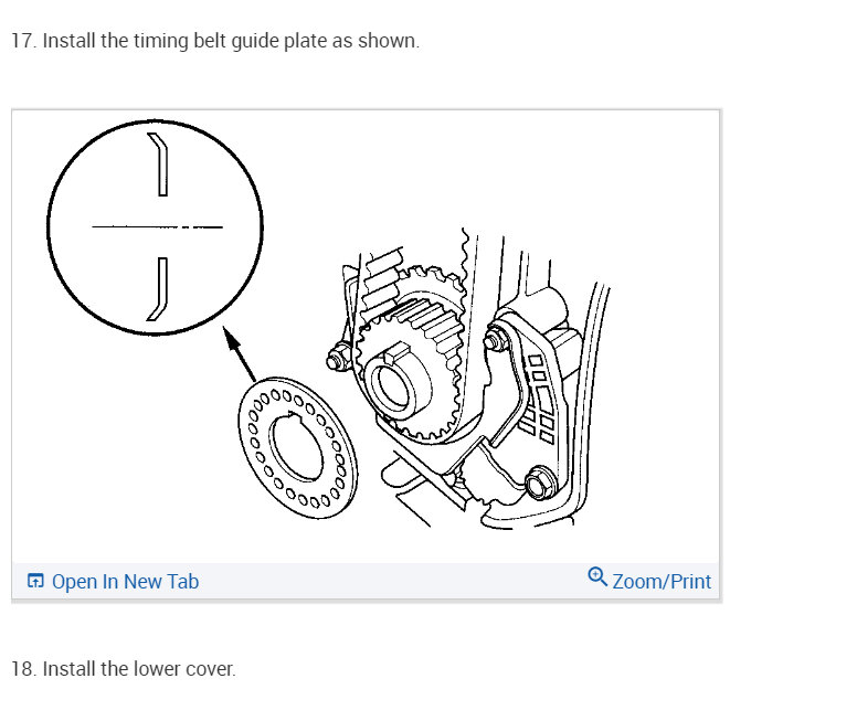

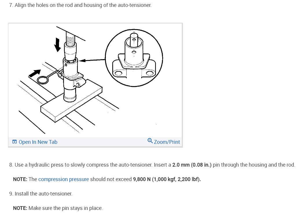

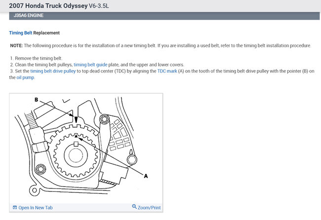

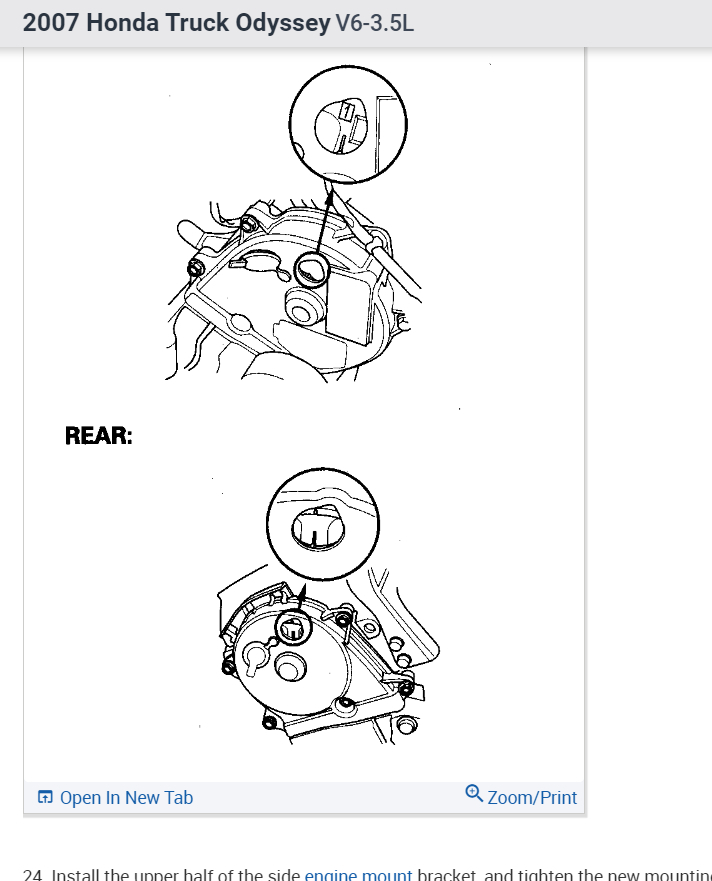

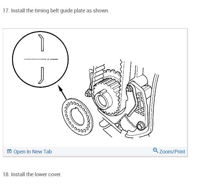

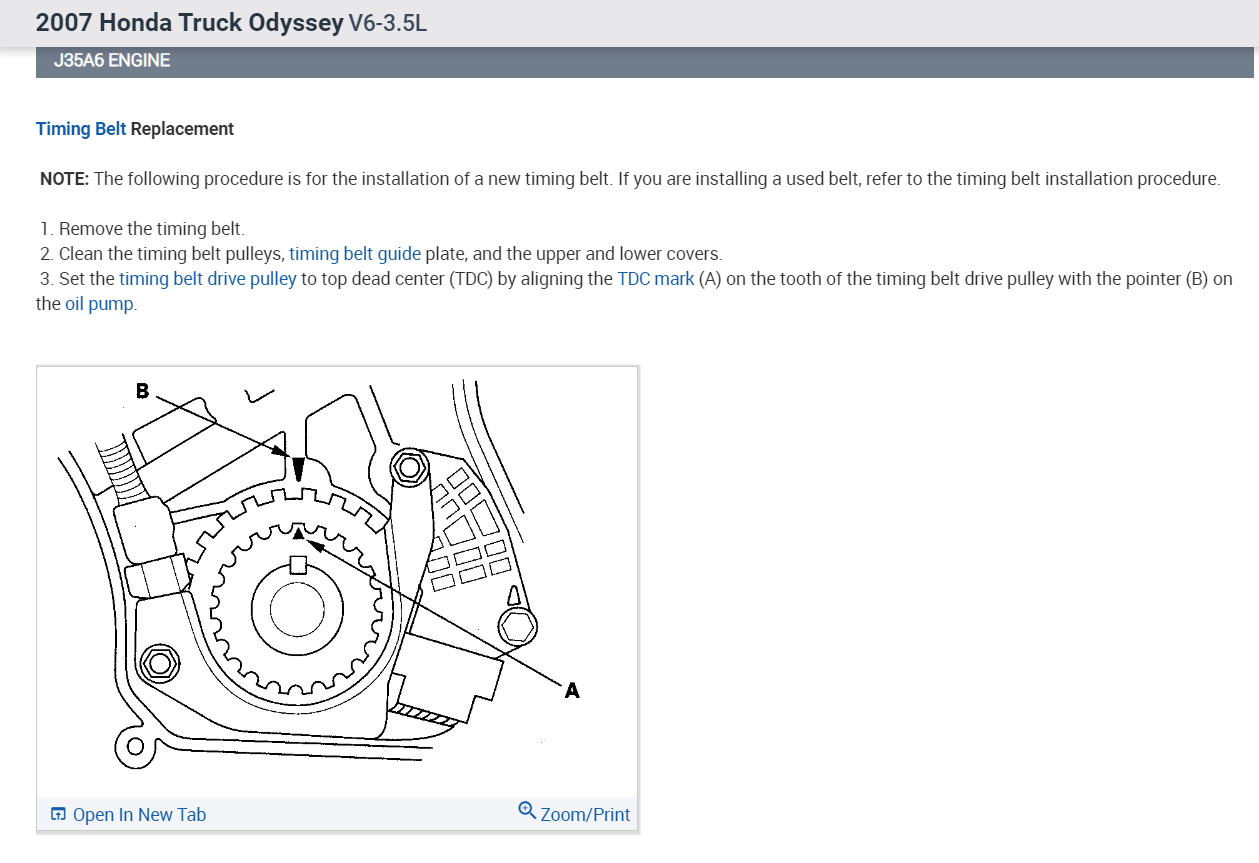

It sounds like the belt has jumped which is common. here is how to align the timing belt marks and replace the belt. You will need to reset the timing belt tensioner; the instructions are in the images below. Check out the images (below). Please let us know what happens.
