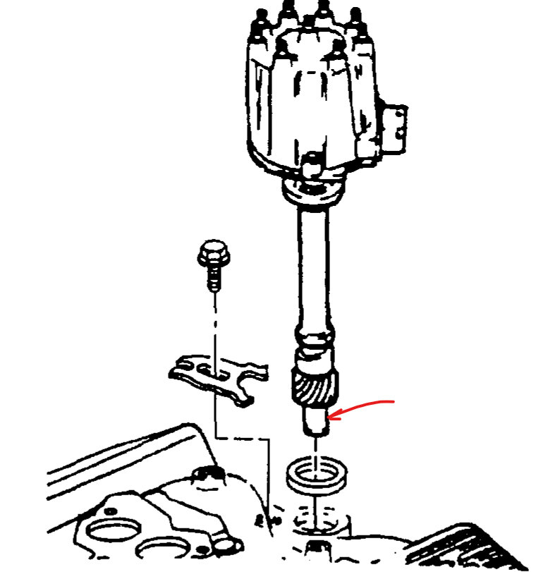

I have seen the distributor gear roll pin shear and allow the gear to "slip" on the shaft changing the timing, or you have a bad PCM.

There is a roll pin at the bottom of the distributor gear which can "shear" allowing the gear to slip on the shaft which will change the timing. Just to confirm you say the timing changes after you run it, correct? For the PCM you will need to send it in for testing.
