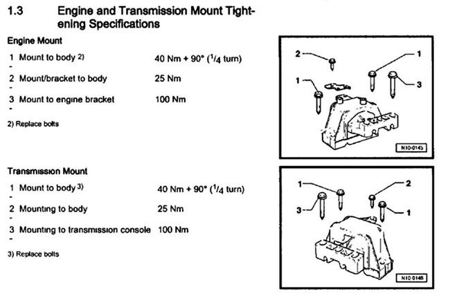

I have attached the directions right from Alldata for belt removal and replacement. Additionally, I have attached several pictures which correlate with the directions as a guide. I believe picture 7 is what you are referring to.

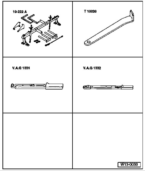

Special tools and equipment
Engine support bridge -10-222 A- (guide -10-222 A/21- changing)
Adapter -10-222 A/8-
Torque wrench -V.A.G. 1331-
Torque wrench -V.A.G. 1332-
Pin wrench -T10020-
