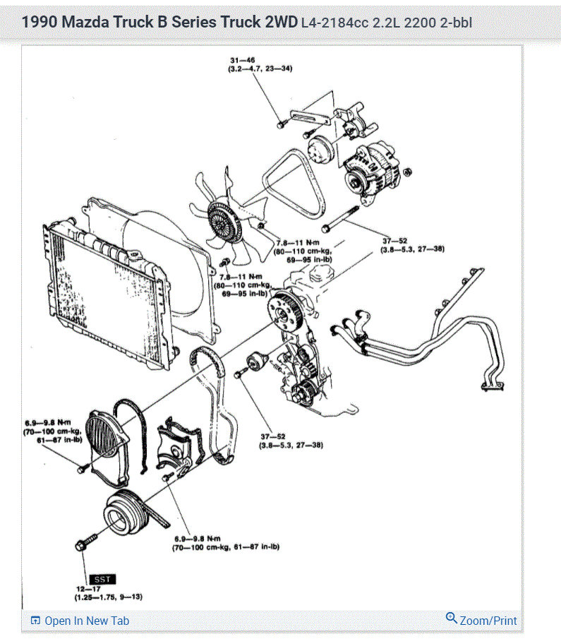

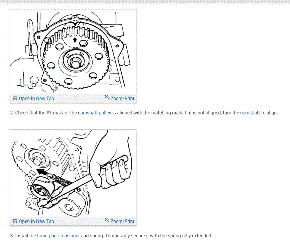

Could I set my cam timing at TDC take the belt off and set my Crank at TDC to set timing? It's too off to the point where nothing else has worked.
Dec 29, 2021 at 5:17 AM
  • 110,240 POSTS

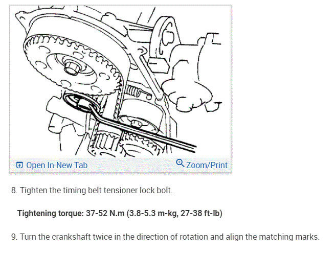

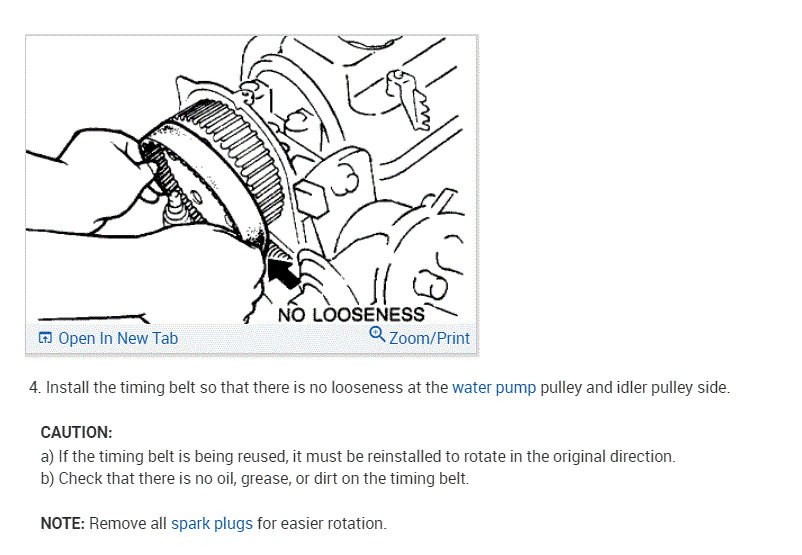

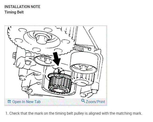

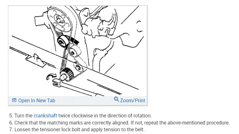

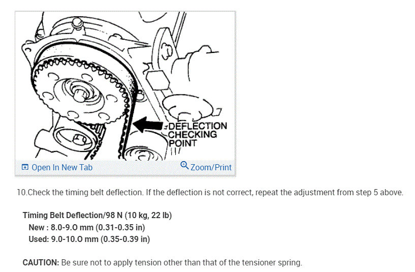

I guess it is possible, but I'm not sure how you will manage the tensioner if everything isn't exposed. Do you have the entire belt and covers removed?

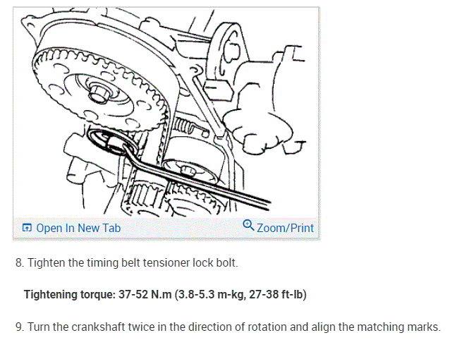

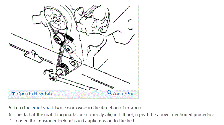

I attached the directions below for the installation of the belt.
Let me know if that helps or if you have other questions.

If the cover is off, follow the directions listed above. If you run into any trouble, let me know.
Let me know how things turn out for you.

hey Joe, thanks for all the help those really helped me, and she runs smooth.
