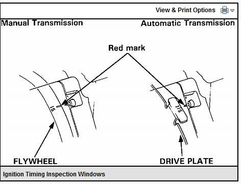

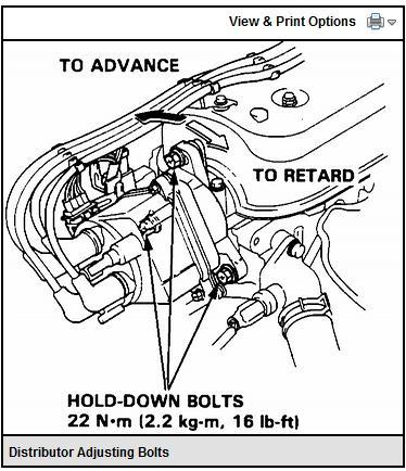

Here is what I found for your Accord. With engine running the ignition timing should be 13-13 degrees before top dead center at 650-750 RPM's. If you were just changing the spark plug tube gaskets on the valve cover I'm just curious as to why you removed rocker arm? I've attached two pictures for a timing reference. Hope this helps and thanks for using 2CarPros.

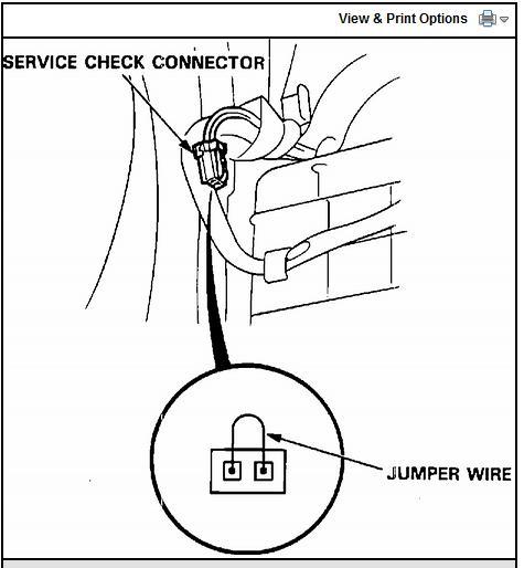

timing for 2.2L is 13-17 btdc but yo need a jumper to do this. Same thing for a 2.7L i'm including pic ofr jumper.Best thing to do with this is to change oil and filter, drive for about 15 miles on eway then get it tested, it should pass then.

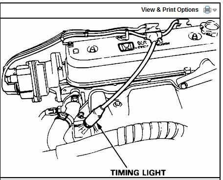

It could be the timing. Question is, has it been like this since the second you had the work done, or did it happen later. If it happened later, chances are that it jumped time. You can attempt to adjust the timing first, following the below procedure. If that doesn't work, you will have to remove and reset or replace the belt. Some techs do not correctly tighten the timing belt tensioner, so you may want to look into that, if you are able to get it back into time. I also attached some images for aid.
1. Remove the rubber cap from the inspection window of the cylinder block.
2. Start the engine and allow it to warm up (cooling fan comes on).
3. Connect the ORN/RED and GRN/WHT terminals of the service connector (BLU) with a jumper wire.
4. Connect a timing light to the No. 1 ignition wire; while the engine idles, point the light toward the pointer on the flywheel (for M/T), or on the drive plate (for A/T).
5. Adjust ignition timing to: 15~ +/- 2~ BTDC @ 700 +/- 50 RPM
6. Adjust as necessary by loosening the distributor adjusting bolts, and turn the distributor housing counterclockwise to advance the timing or clockwise to retard timing.
7. Tighten the adjusting bolts and recheck the timing.
8. Remove the jumper from the service connector and replace the rubber cap to the inspection window.

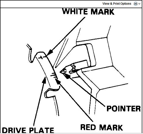

I know that you have to disconnect the vacuum hose to the distributor because it's the fuel injected model,but which timing mark do i place the distributor at? There are three marks and then 1 mark above those. The 3 look like a T.

Good morning,
I attached the picture of the timing marks for you to view. You will need to use a timing light that can read advance or adjust to show how much advance. Parts stores have them for rent or purchase.
You hook up the light to the battery and number 1 spark plug. Remove the hoses from the vacuum advance and aim the light at the pointer. Adjust the timing light to the solid mark as that is 0. Then read the scale on the light for the timing. Adjust to the specs below.
Fuel-Injected engine:
ALL MODELS: 13-17° BTDC (Red mark), (at 700-800 rpm in neutral).
