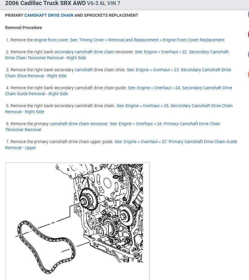

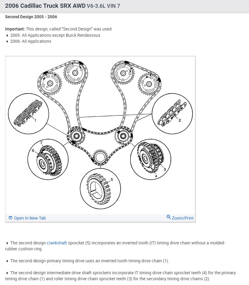

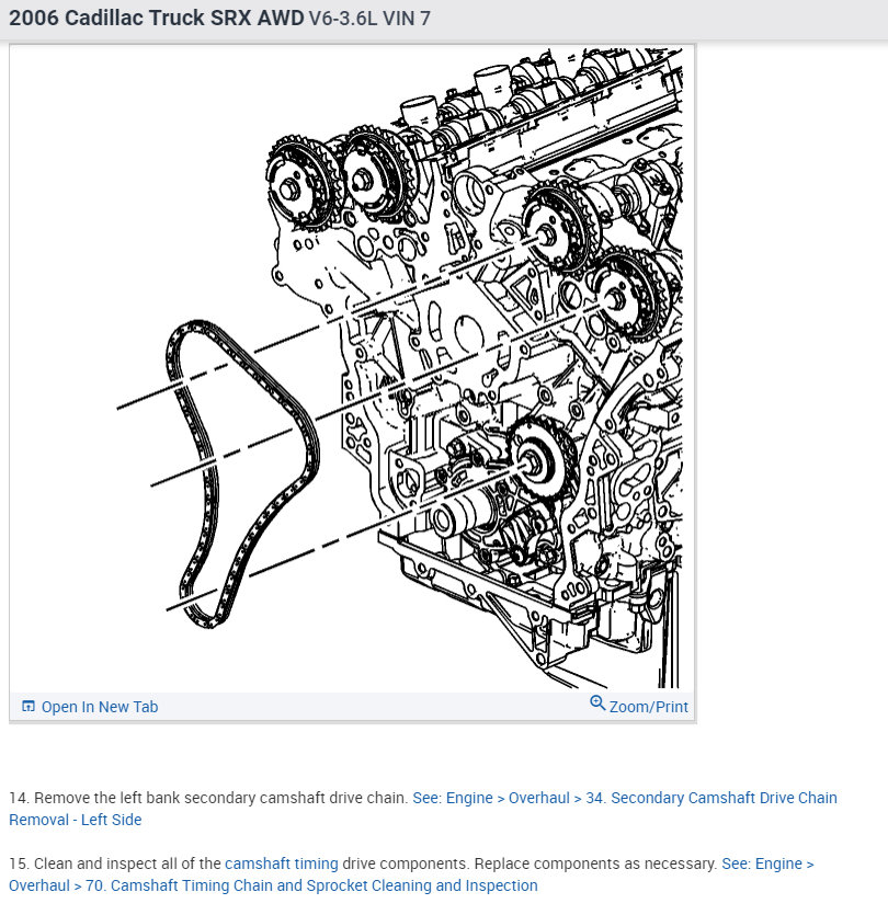

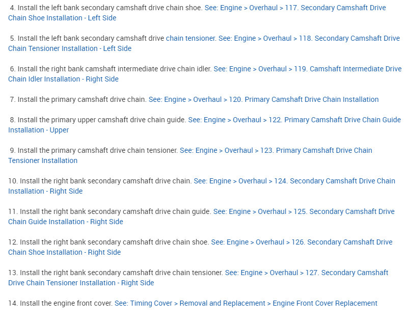

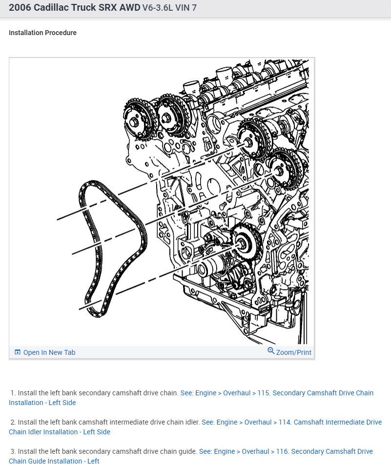

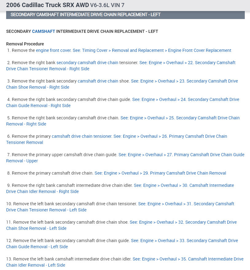

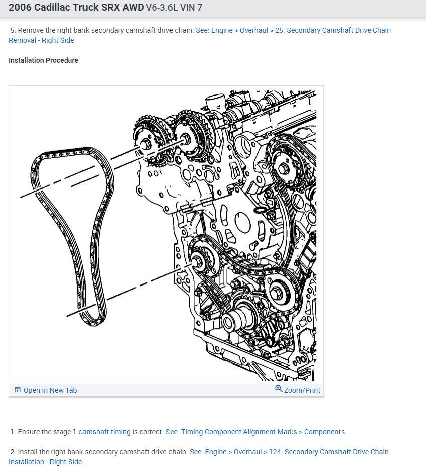

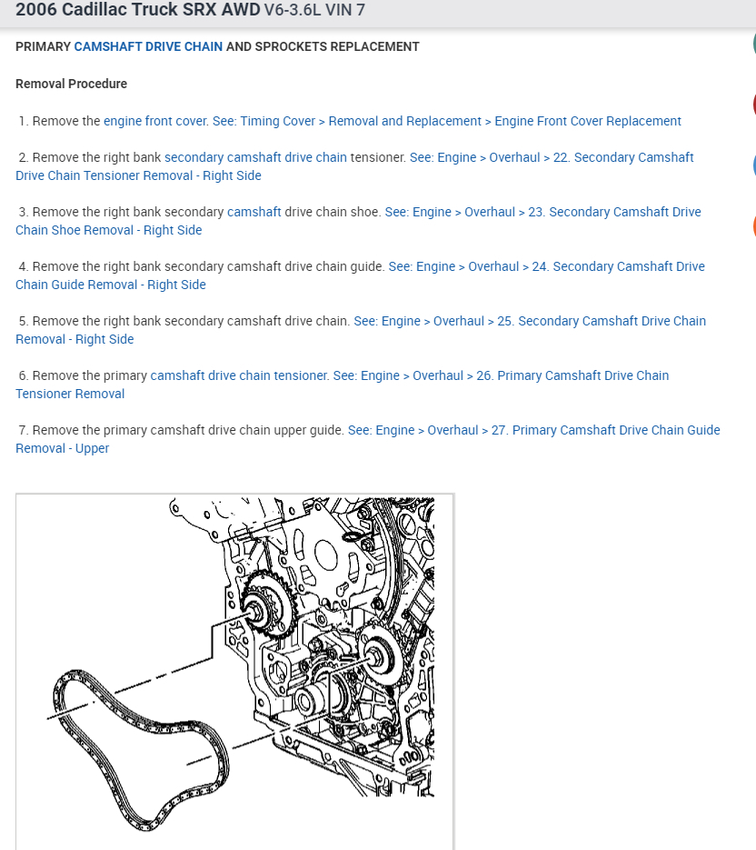

Need diagram to install chains and gears.
Aug 7, 2022 at 2:09 AM
SQM
Experienced Mechanic
6,383 POSTS

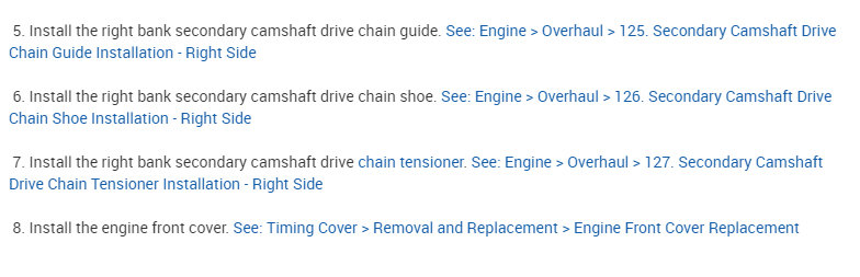

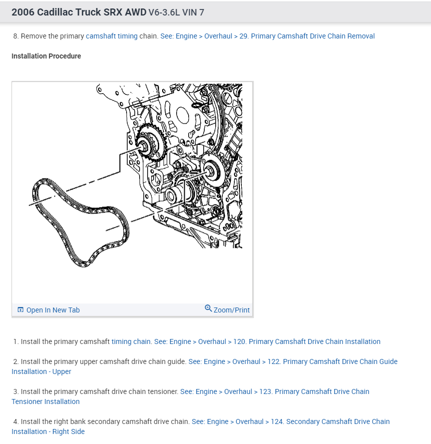

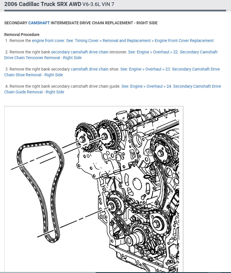

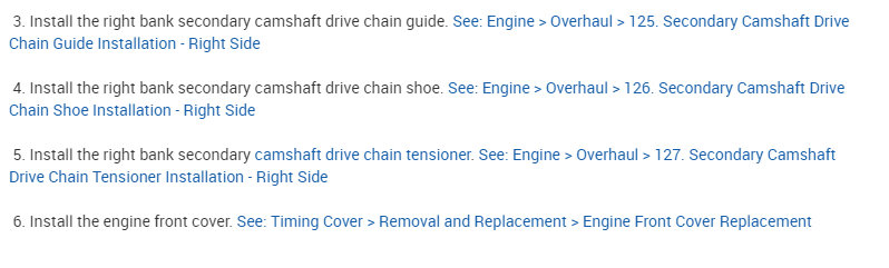

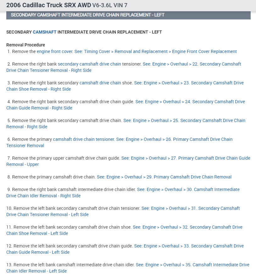

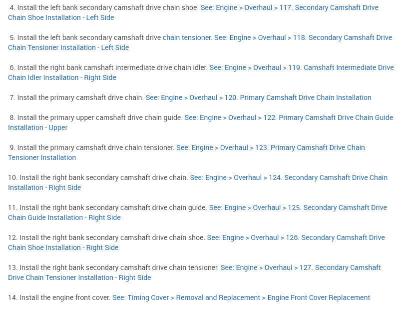

See attached for the timing chain replacement procedure.
There are several components that will need to be removed. If you need instructions to any specific component just let me know.

Can't see on my computer. It's real blurry. Sorry
Aug 8, 2022 at 2:52 AM
55,649 POSTS
Did you click on the images to enlarge them?
