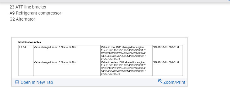

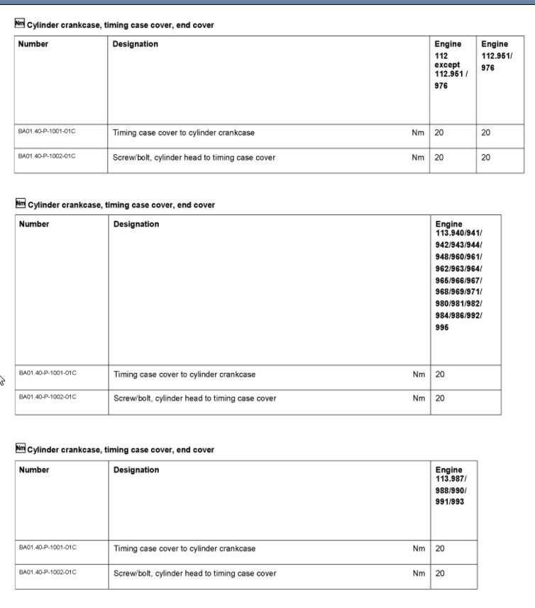

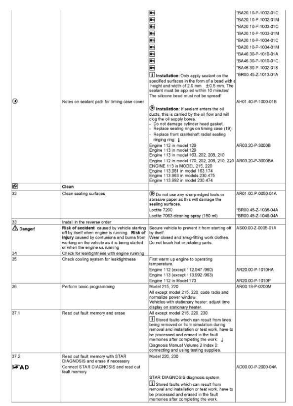

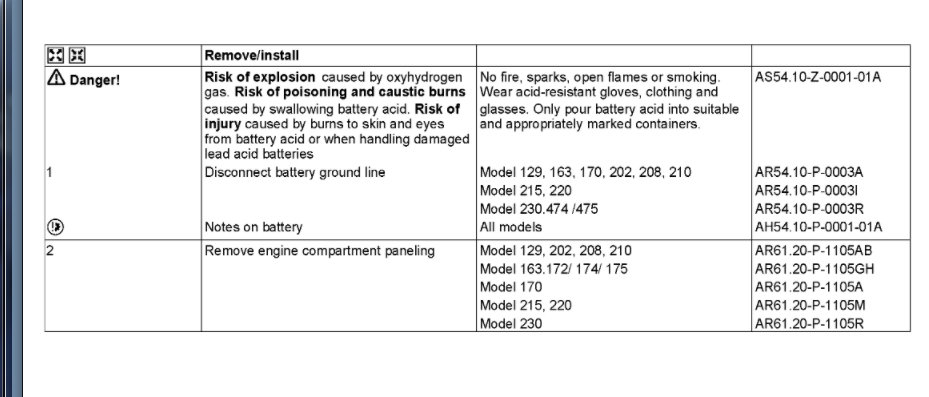

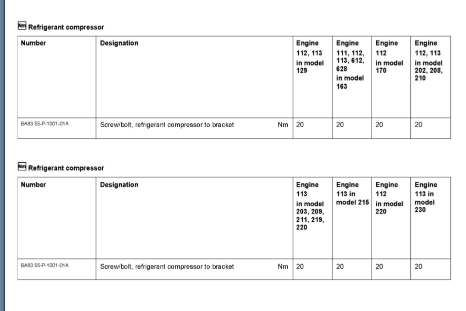

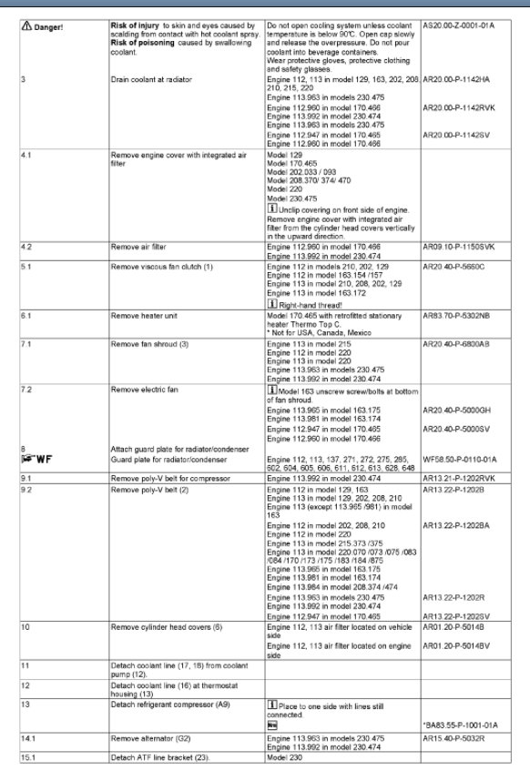

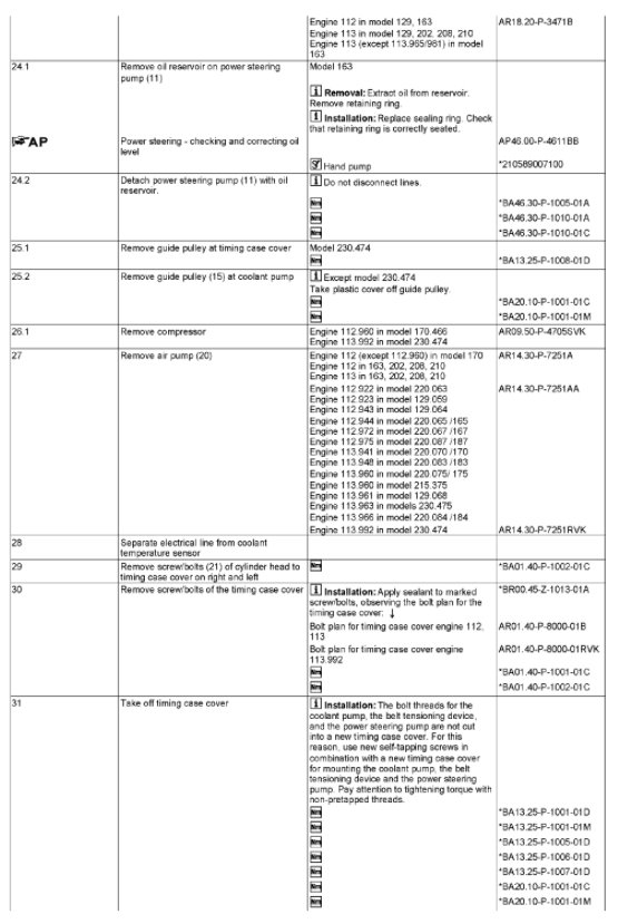

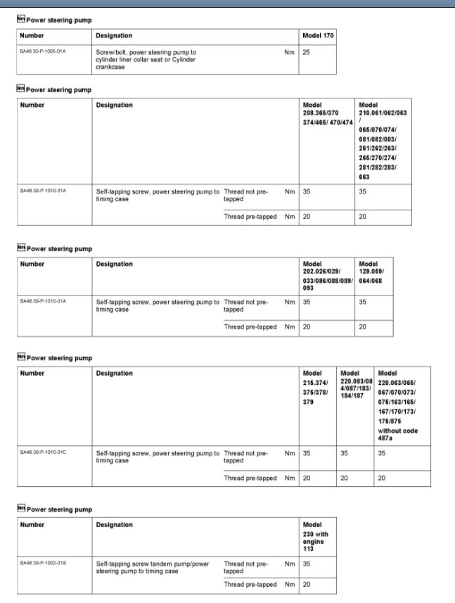

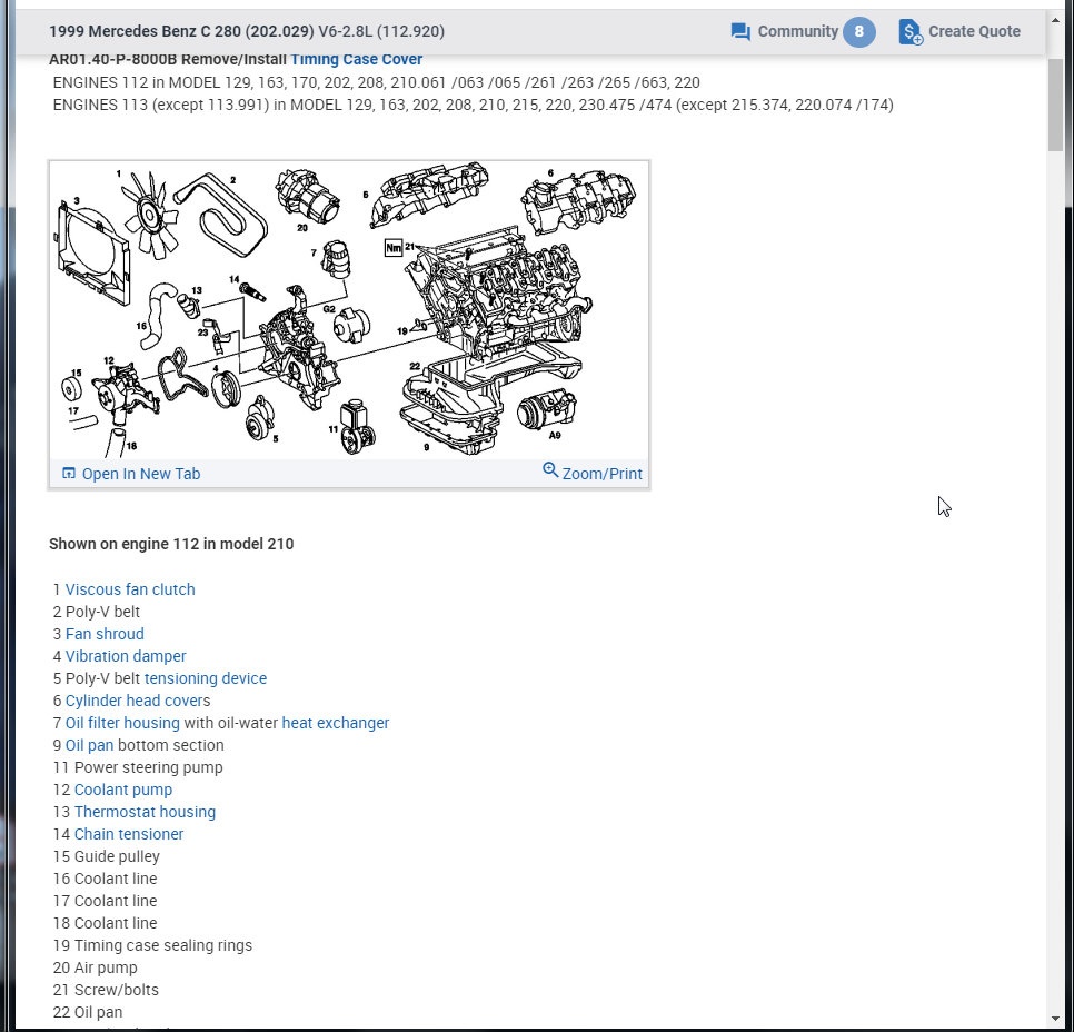

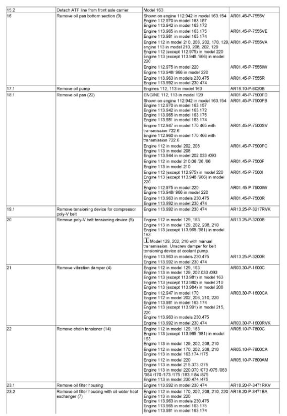

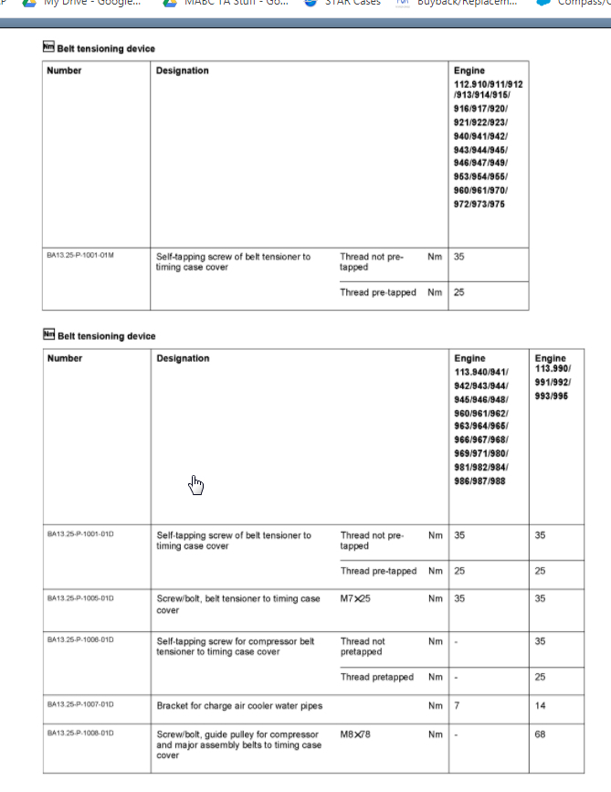

Is engine removal necessary to replace timing cover?
Sep 27, 2020 at 2:07 AM
I am attaching the process for the manual. Check out the diagrams (Below). Please let us know if you need anything else to get the problem fixed. Let us know if you have more questions. Thanks
