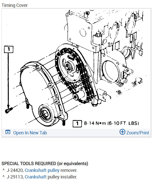

What size torx head are the 2 studs in the bottom of the timing cover?
Nov 10, 2024 at 8:31 AM
  • 55,423 POSTS

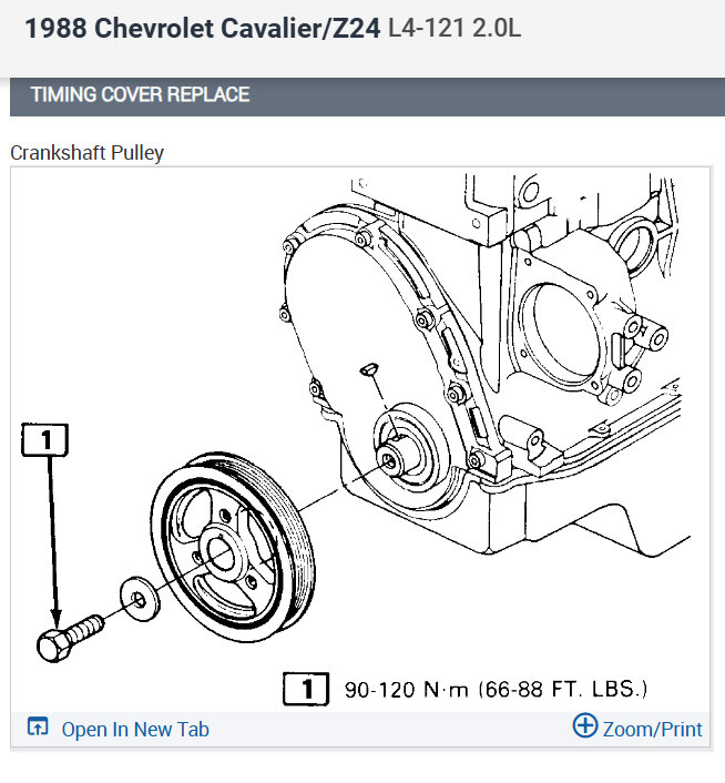

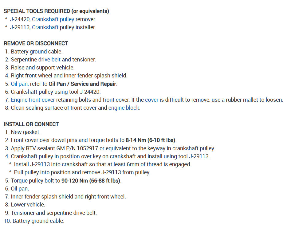

With the 2.0L engine, the two studs at the bottom of the timing cover typically require a T40 Torx bit for removal.
Here is how to remove the timing cover correctly:
This video will show you how to remove the balancer:
https://youtu.be/WITN7Q8SX1U?si=1yvm-4mihmRsCSRH
Check out the images (below). Let us know if you need anything else.

TJMOWBRAY
  • 85 POSTS
Thanks, I just had to remove oil pan.
