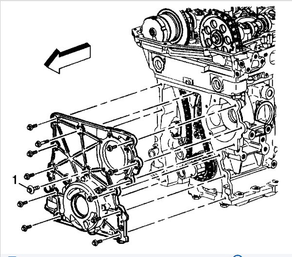

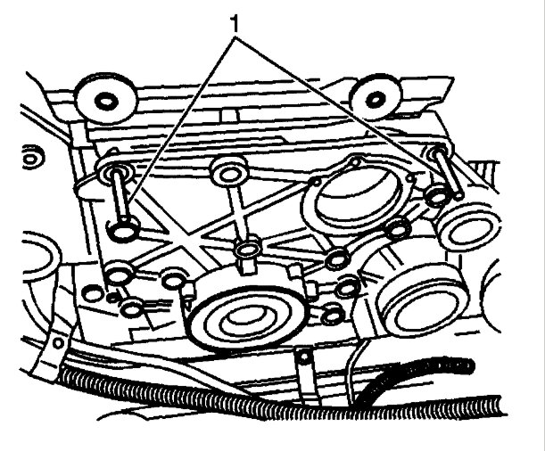

Is there a diagram that illustrates where the specific hardware pieces go for the timing cover? There are a few with different lengths, and want to make sure i put them all in the correct places as im reinstalling the cover

Yep, that can be tricky, I would judge the leigh of the bolts by how much or little the bolt sticks out without being screwed in. Here are a couple if images that kind of show the bolts so you can get an idea of which bolt goes where. Check out the images (below). If you have more question please upload images of what you are dealing with so I can see. Ken
