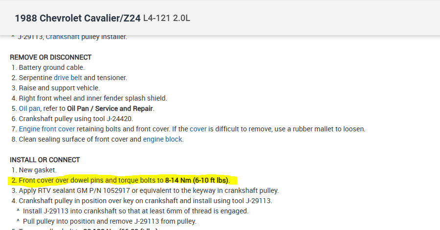

I need the timing cover bolt torque specs.

Regardless, if you look at the pic below, it will provide the torque specifications you are looking for. Let me know if this helps.
Take care and Happy Thanksgiving.
See pic below.

generally range between 8-15 ft-lbs,
