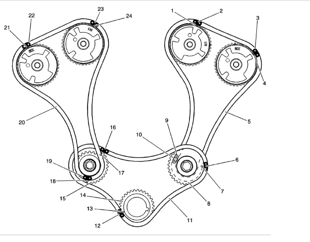

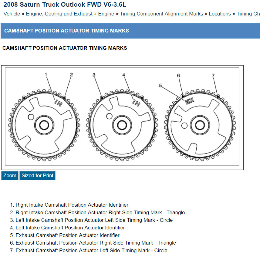

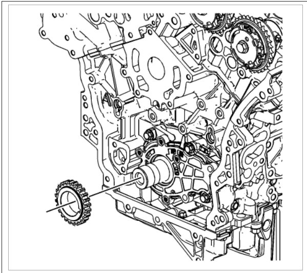

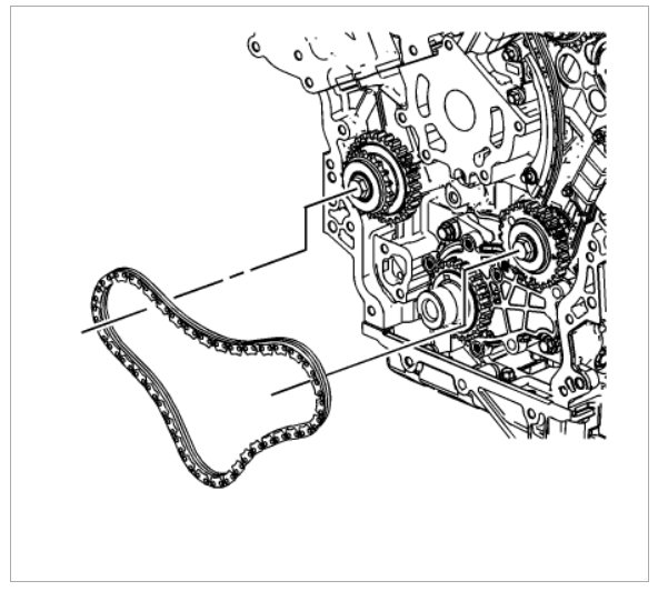

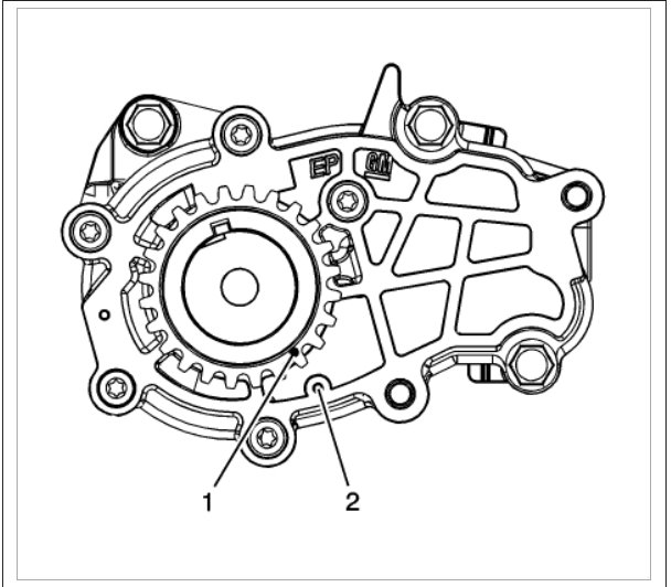

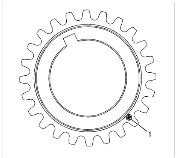

CPICK1946

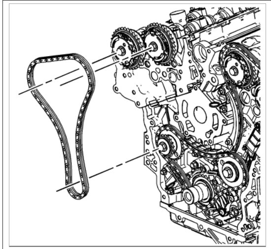

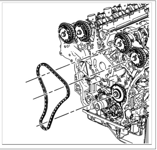

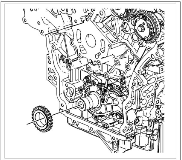

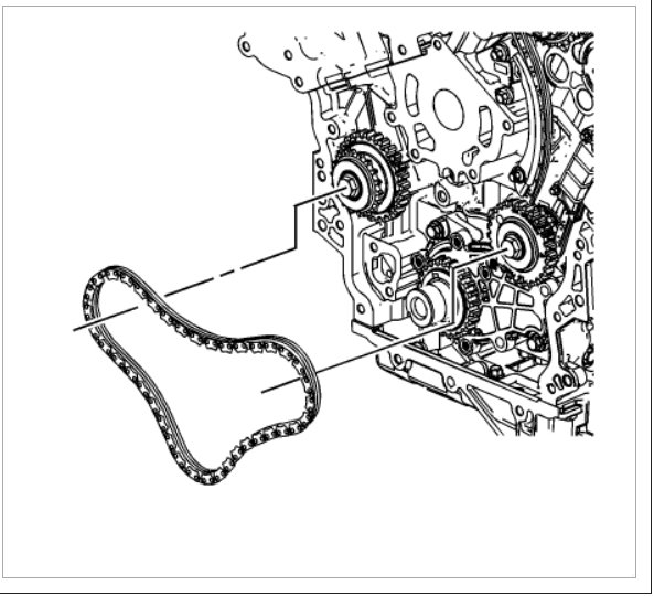

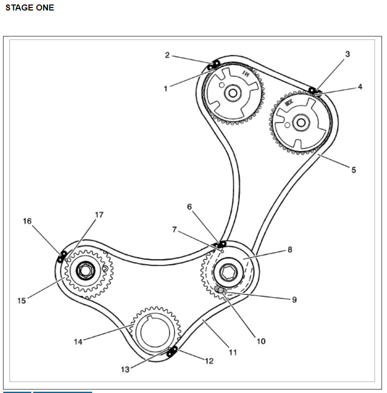

Well,
2008 saturn outlook 3.6.
Saturn tech says codes P0016,17,18,19 points to worn timing chain and other worn sprokets.
Can these be changed without engine removal?? How difficult? ??
Changed crankshaft position sensor, did not cure problem above.
Where to next, need to drive home 1500 miles to fix. Engine runs smooth, no misfires in cruise. Hard starting on first crank but starts on 2nd attempt. Slight surgING rpm in idle.
Yikes!!!
Charlie
Mar 9, 2018 at 1:18 PM
  • 55,711 POSTS
Hey Charlie,
Yep yikes! It does sounds like the timing chains needs replacement. Here are guide to help you see what you are in for when doing the job.
It does look like you can do the job in the car.
Mar 12, 2018 at 5:53 AM
