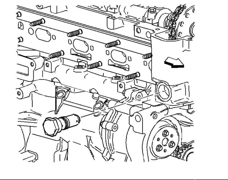

Important: The timing chain tensioner must be removed to unload chain tension before the timing chain is removed. If not removed, the timing chain will become cocked and it will be difficult to remove.
8. Remove the timing chain tensioner.

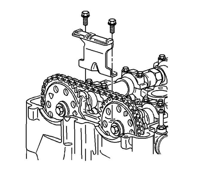

9. Remove the upper timing chain guide.

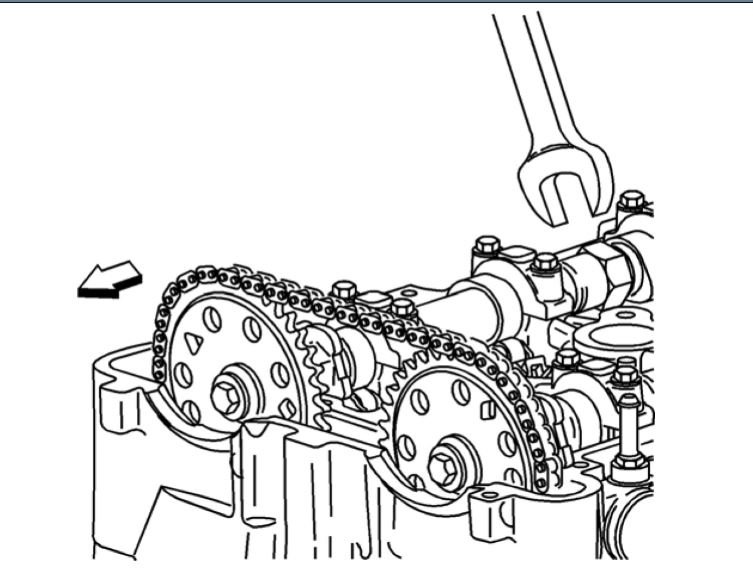

10. Use a 24 mm wrench to hold the camshafts from turning.

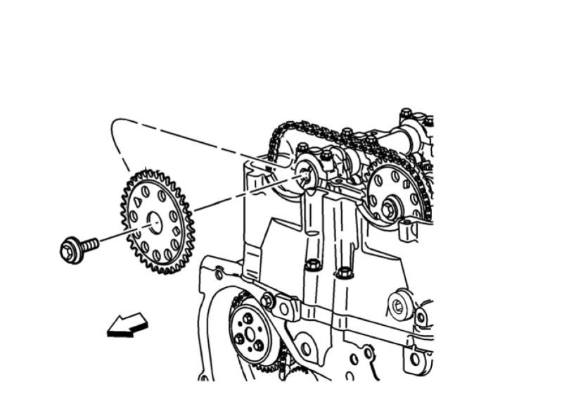

11. Remove the exhaust camshaft sprocket bolt and discard.
12. Remove the exhaust camshaft sprocket.

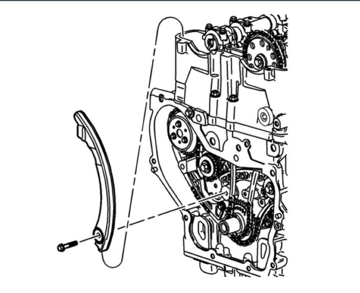

13. Remove the timing chain tensioner guide.
