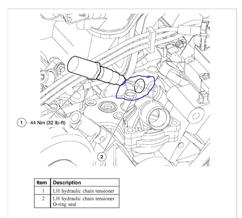

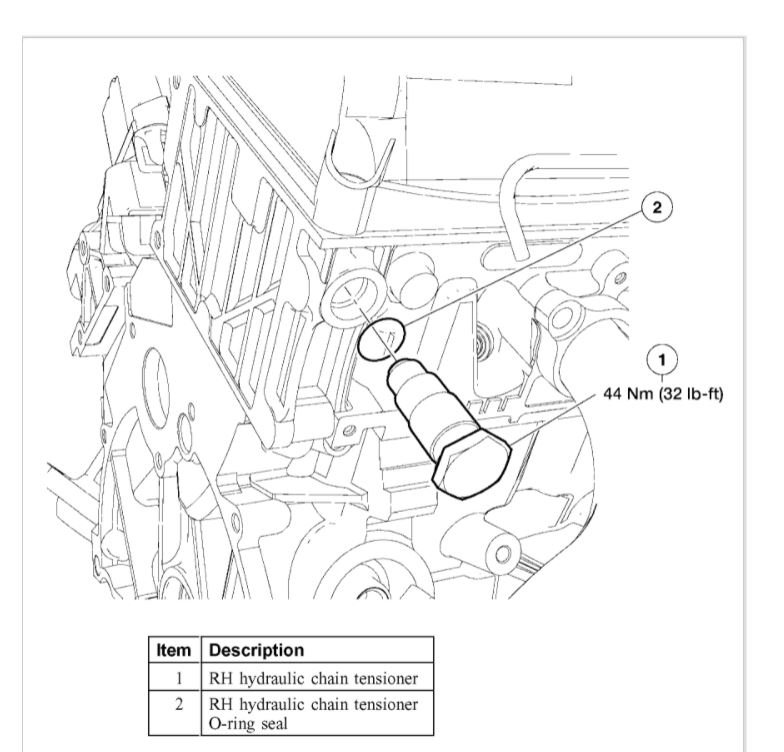

Good morning,
They are not washers; they are O rings to keep it from leaking.
I attached pictures for you of the tensioner and it requires an O ring on each one.
Mar 28, 2022 at 2:44 AM

It must be rubber O-ring, not a washer.
Look at the pictures I sent for reference.
Make sure they are the correct tensioner as well.

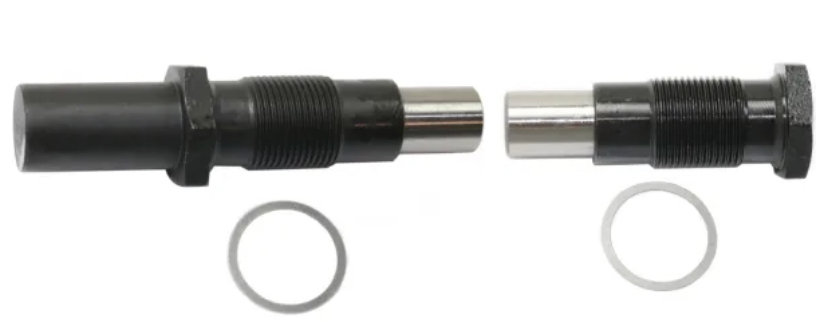

I gave them my VIN before I bought the tensioner. Mine look like the one in the image below.
Apr 2, 2022 at 2:33 AM

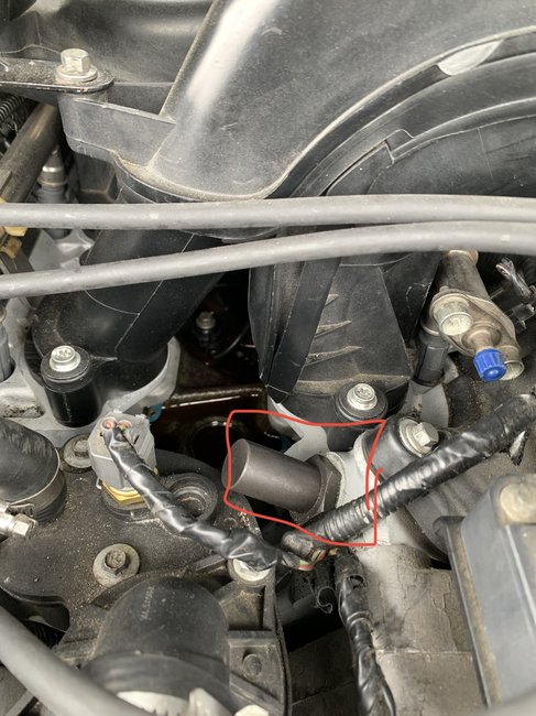

I have a 4.0 V6 SOHC engine. Here’s a pic of the tensioner that’s leaking. You can see that it’s filling up the valley with oil.
Apr 2, 2022 at 2:41 AM
It does not make sense.
I still think you need the ones with the o ring, not a gasket.
