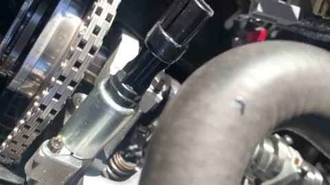

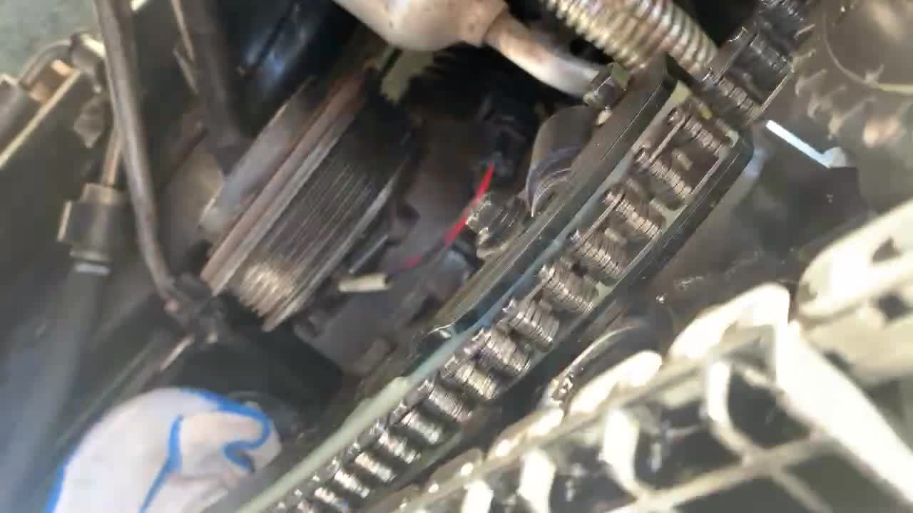

Truck has been running just fine after reinstallation. About 100 miles in I started to hear a loud ticking noise at idle that would increase or decrease with the engine RPM, or all together go away when cruising.
I took the valve covers and front cover off and found that the right hand (passenger) timing chain is going slack then re-tensioning again and slapping the top chain guide when turning it over by hand. You can watch the hydraulic chain tensioner loose pressure and retract when the chain goes slack. Okay, replaced the tensioner thinking bad luck and turned it over by hand again... same problem; new tensioner retracts and the chain goes slack by about two fingers width.
Has anyone ever seen this before? i'm quite confused as to why it's doing this. Left hand (drivers side) is fine.

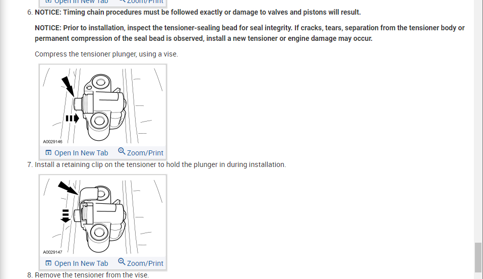

This is odd but we need to rule out another possible tensioner issue by removing it and compressing it with vice grips to make sure the tension is sufficient.
Also, before you remove it, can you get a video of what you are seeing?
The only reason I am hesitant that this may be a different issue is just because you replaced it already and it is still doing it. Clearly that makes us think there must be another issue.
Seeing the issue may help trigger other thoughts about what this could be.
Also, if you have it assembled right now, can you get a recording of the noise?
Do you have marks on the cover when the chain is hitting it?
The way you described it could also be a lifter issue so let's go step by step and I am sure we will figure this out.

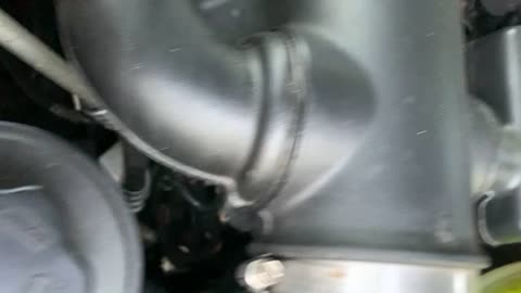

Kase, thanks for taking the time to respond. It's still apart because, well frankly i've pulled it apart three times now and i'm trying to see if this is the source of my tick. I did a video showing the symptoms of what I am seeing which I hope will help.
Jun 16, 2021 at 6:11 AM
MBLACHFORD
  • 6 POSTS
Video attached.
Jun 16, 2021 at 6:15 AM
MBLACHFORD
  • 6 POSTS

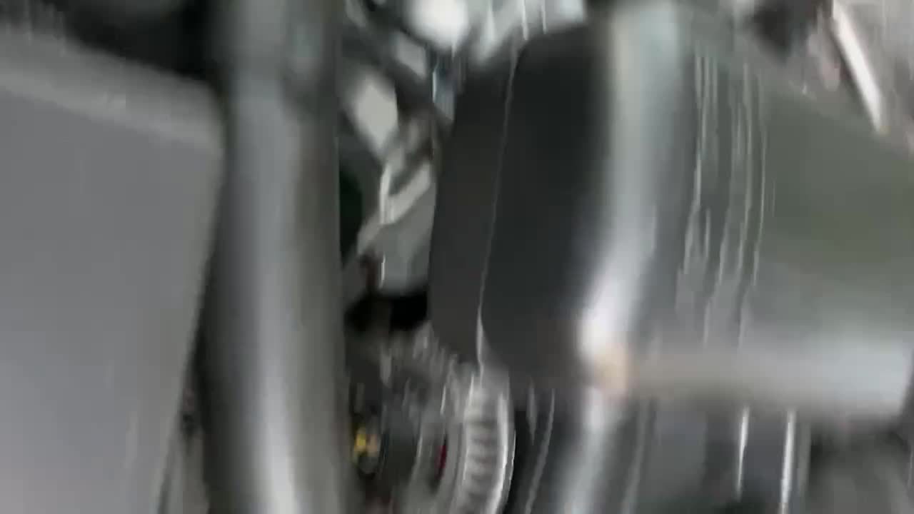

The video of it all together and running with the tick I’m trying to eliminate. During this video the OEM CAM Phaser is less than 6 months old (both banks). The tick is more pronounced on the passenger side.
After I took this video I got a new motorcraft timing chain and another motorcraft cam phaser and replaced them (same ones in the video above) with new phaser bolt.

Okay, and I don't have any chain slapping marks on the cover where its hitting. My hypothesis is that the tensioner is vacillating between being pressurized and not, and its causing the chain to go slack then taught causing a slap on the upper chain guide. Happy to be wrong, of course.

That is interesting. I know for a fact that I have spun this motor over and the chain does go slack in different positions based on valve lift. However, the fact that the tensioner is collapsing like that is a new one. I can't remember ever seeing it that dramatic.

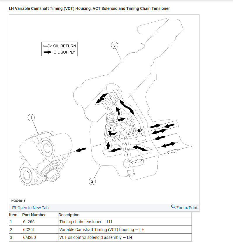

Correct me if I am wrong but that tensioner does not have a seal on the back of it correct? It should be spring pressure only. I think the Left hand is the only one on this engine that is oil pressure filled.
I definitely hear a slight ticking but it is hard to make out. Can you raise the RPM and it gets louder? You said it will increase or decrease with RPM.

No, both tensioners have springs to hold the plunger in place until oil pressure builds, meaning yes they're both oil fed. One random posting on a Ford trucks forum stated that they had a similar issue and the fix was to pull the oil galley plugs at the back and front of the head and to clean any debris out of the head as perhaps there is an obstruction not allowing for full pressure to get to the tensioner. Perhaps i'll give that a try.
Jun 17, 2021 at 11:28 PM
That is funny you mention that. This is why I was asking. I did not see that posting but I was thinking we had a possible oil contamination issue and I thought only the other side was oil feed. Please let us know what happens with this because I am not sure where else to go with this but if nothing comes of this, I have a number of contacts at different Ford dealers that I can run this by and see what they say.
