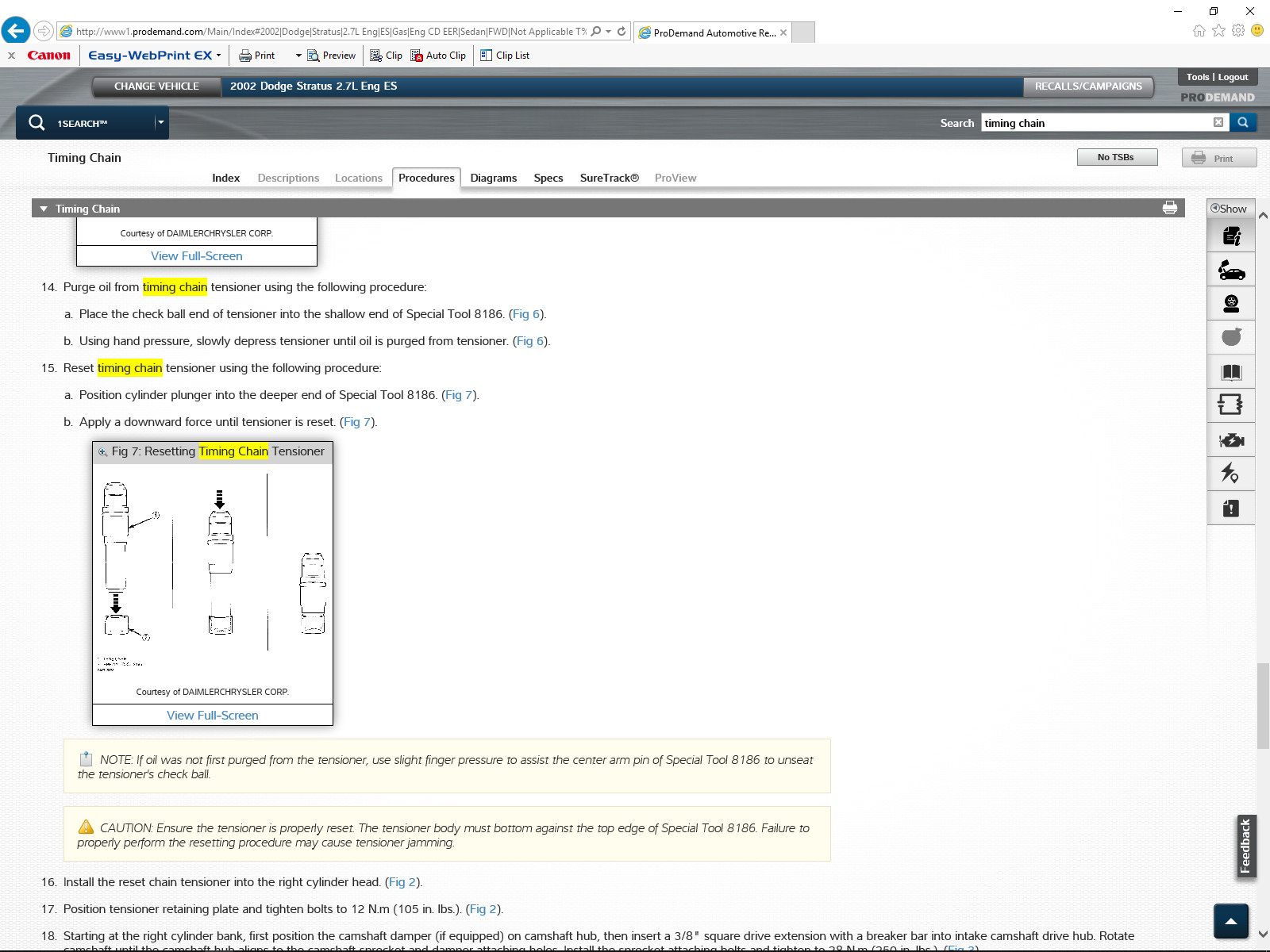

purged the oil out of tensioner and the ball bearing is stuck on the side I can see it but it is stuck. does any one know a way of getting it off the side? Thanks

This is what I could find for your vehicle.
