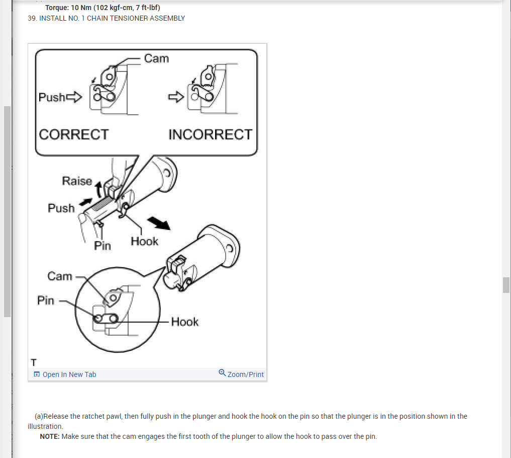

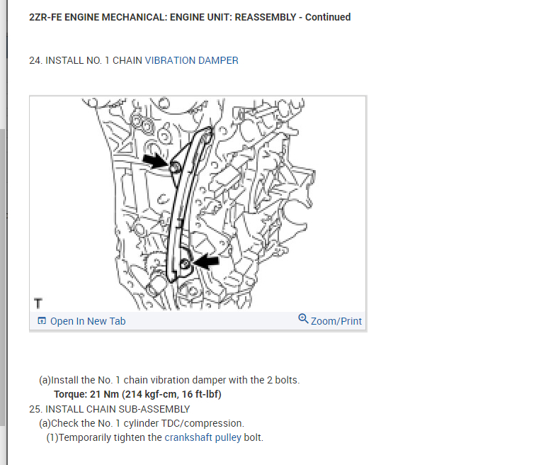

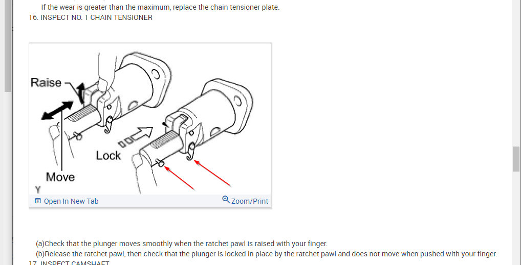

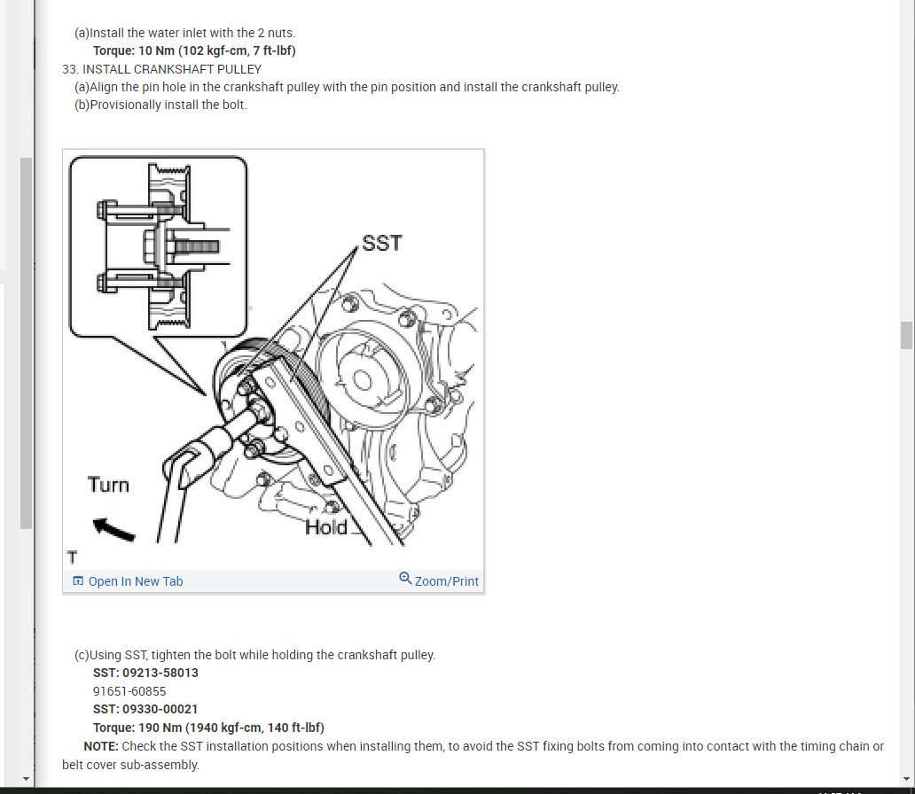

Would you please explain the procedure for releasing the plunger of a newly-installed timing chain tensioner?
2008 SCION XD
216,000 MILES • 1.8L • 4 CYL • 2WD • AUTOMATIC
PLEBE
On a 1.8L 2ZR-FE engine? Thank you!
Aug 6, 2021 at 11:33 AM

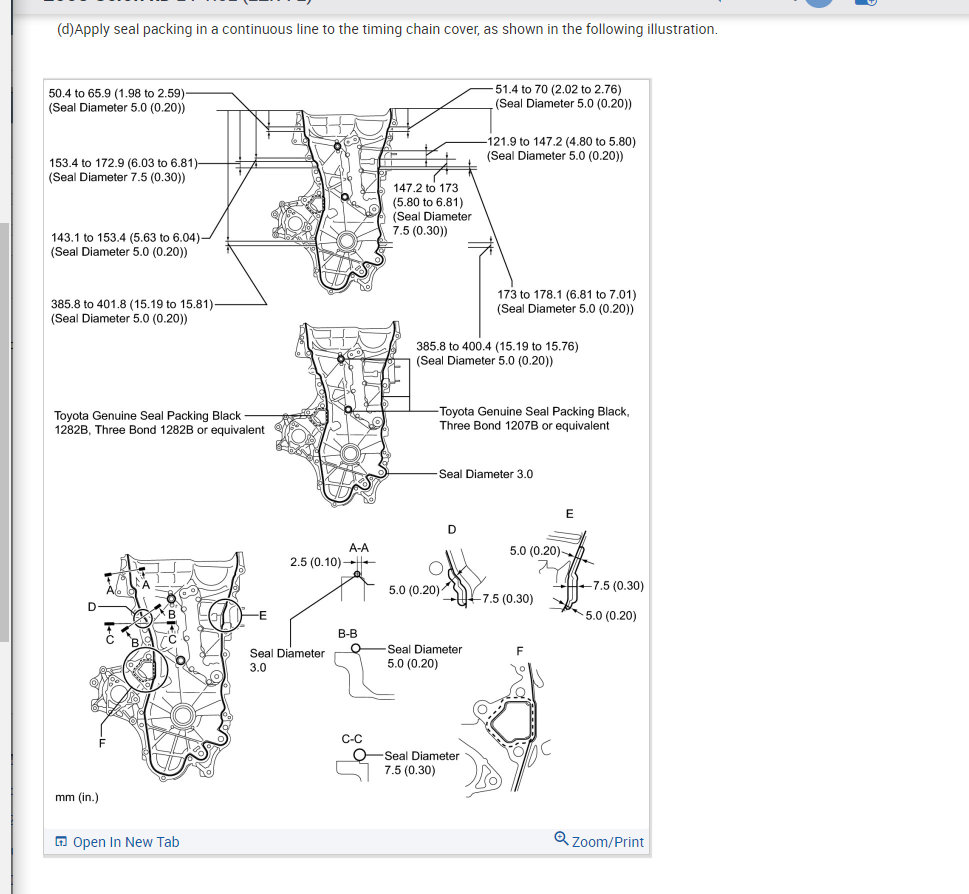

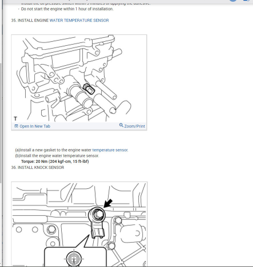

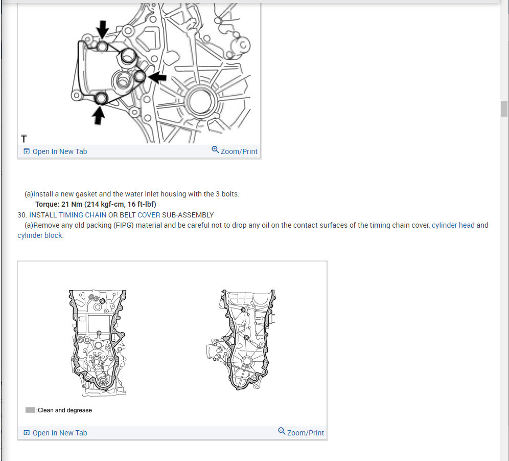

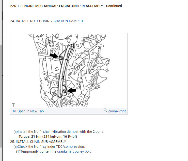

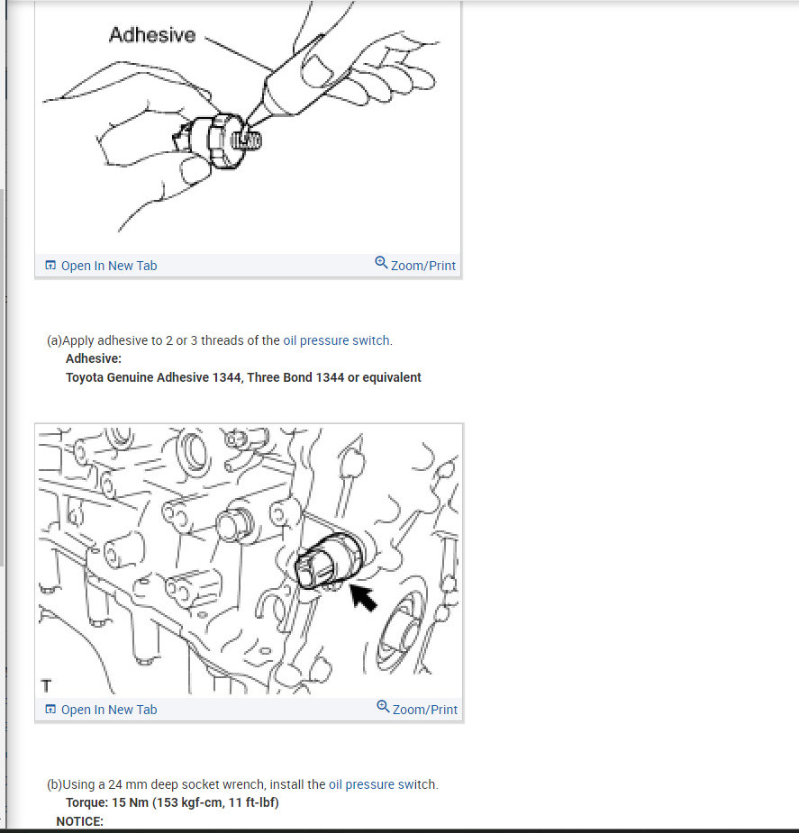

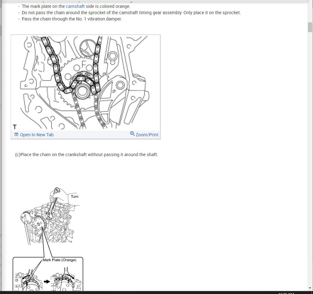

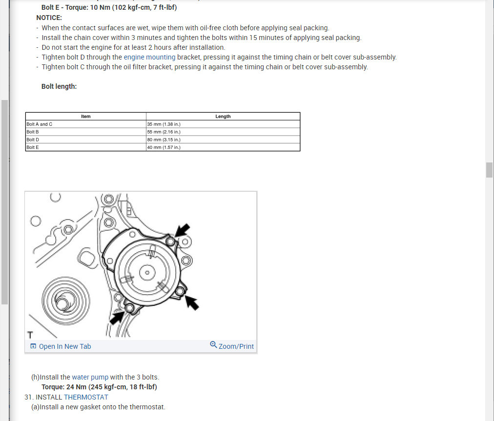

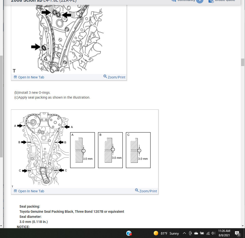

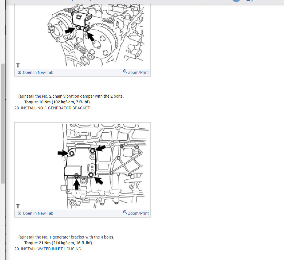

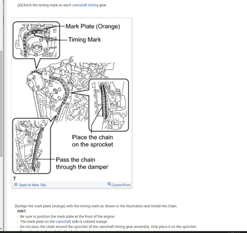

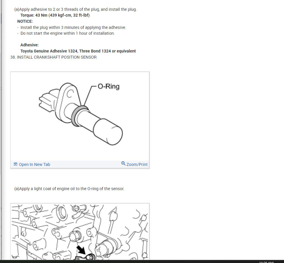

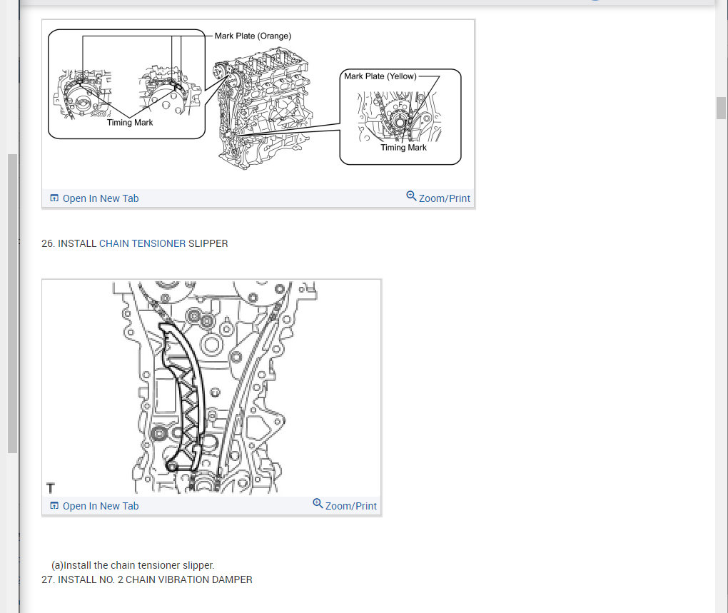

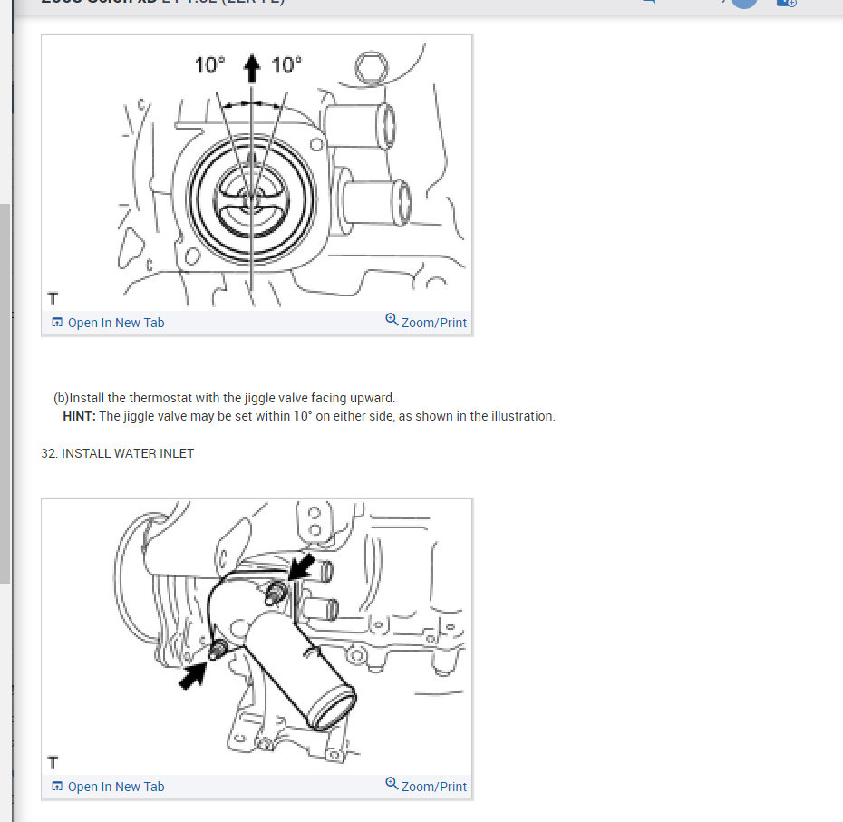

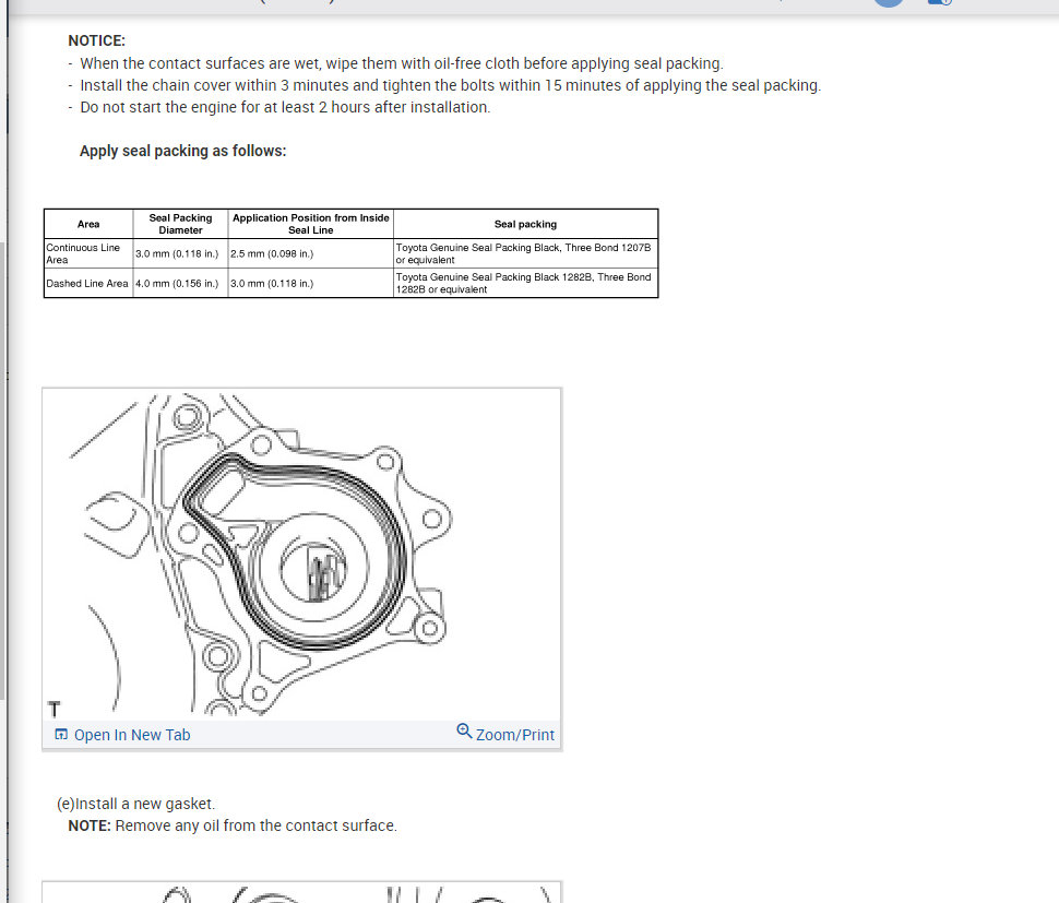

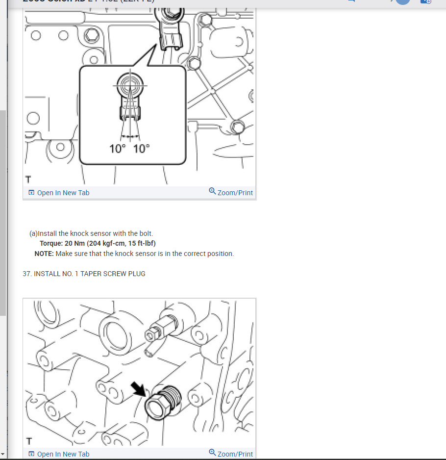

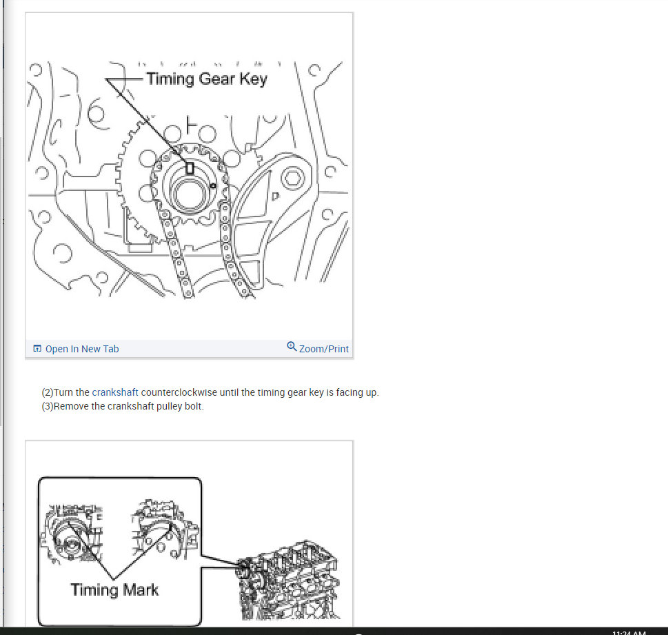

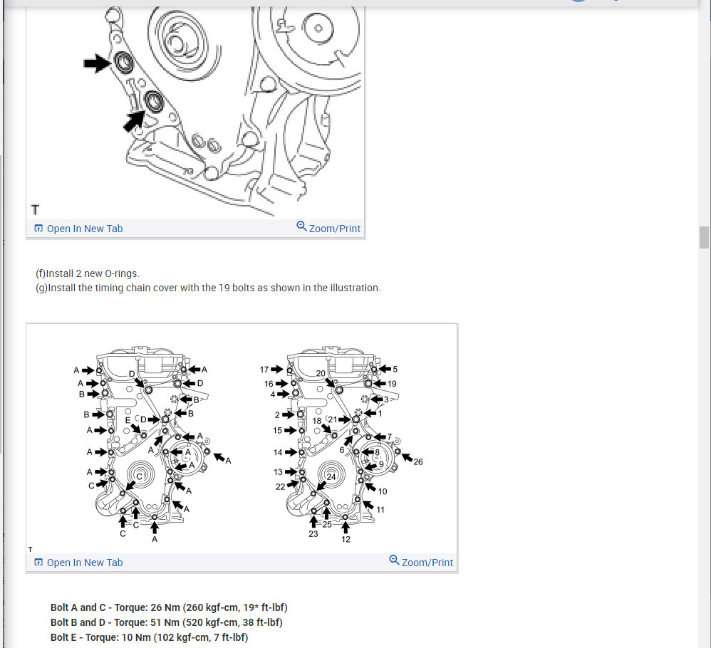

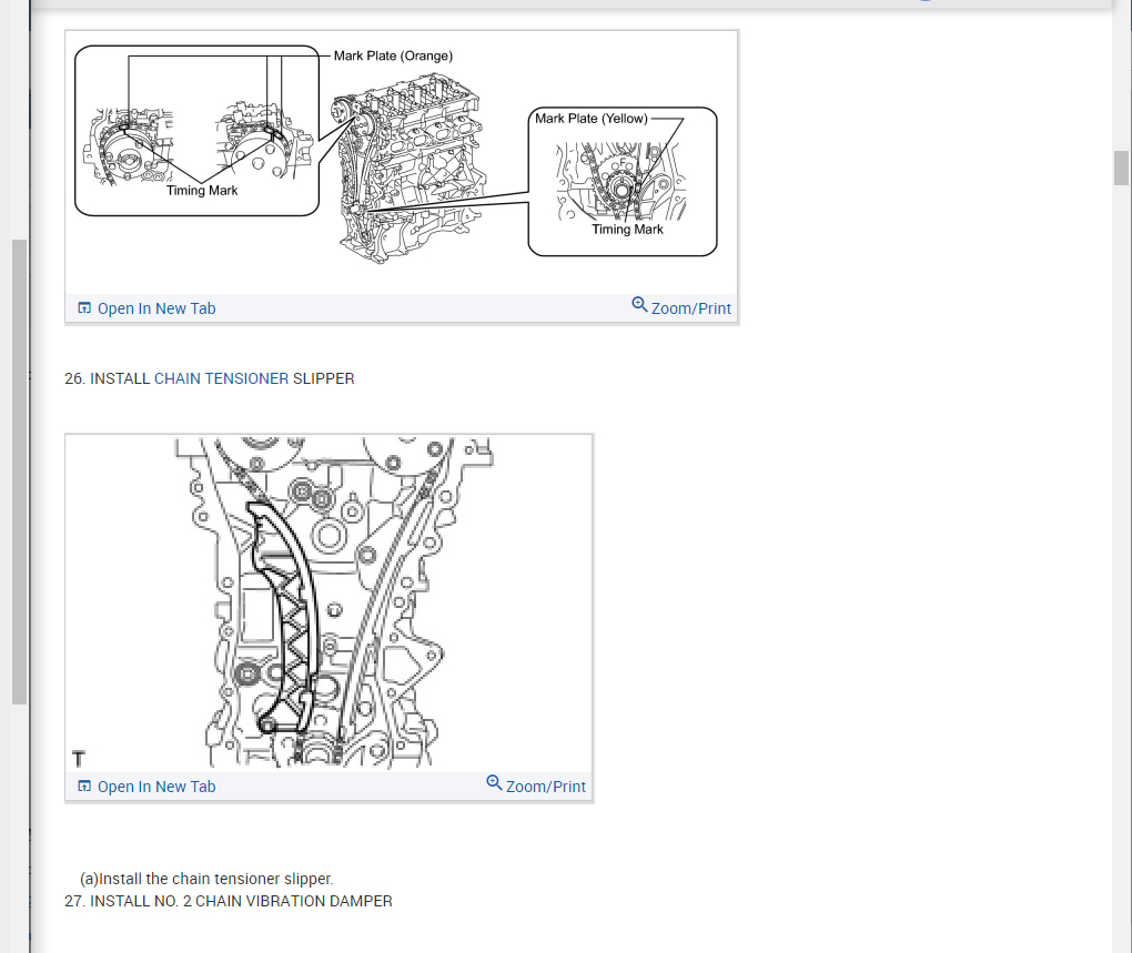

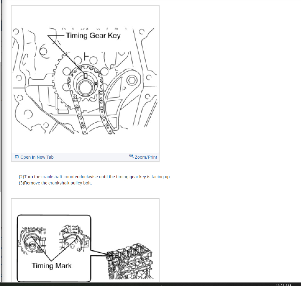

I am attaching the info below but this guide does have useful info that you or others could use when doing these repairs.
https://www.2carpros.com/articles/serpentine-belt-timing-belt-timing-chain-diagrams

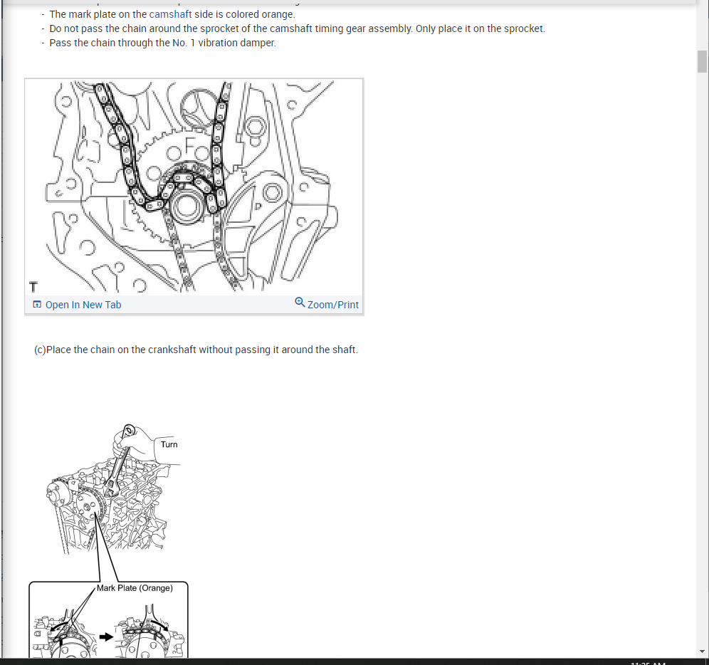

However, below is the info for not only the tensioner but the installation of the chain including timing marks. The first page gives some detail on the tensioner but the last page shows the actual part of the manual that covers the installation and release of the tensioner.
Please run through this info and let us know what questions you have.
Thanks
