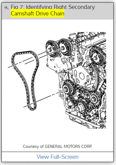

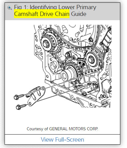

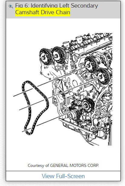

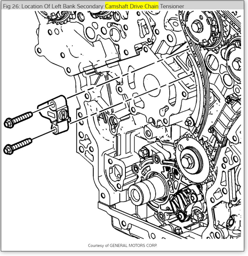

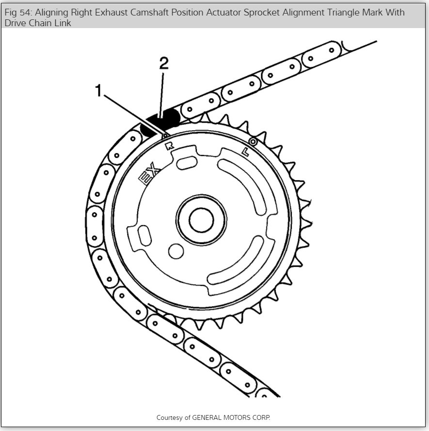

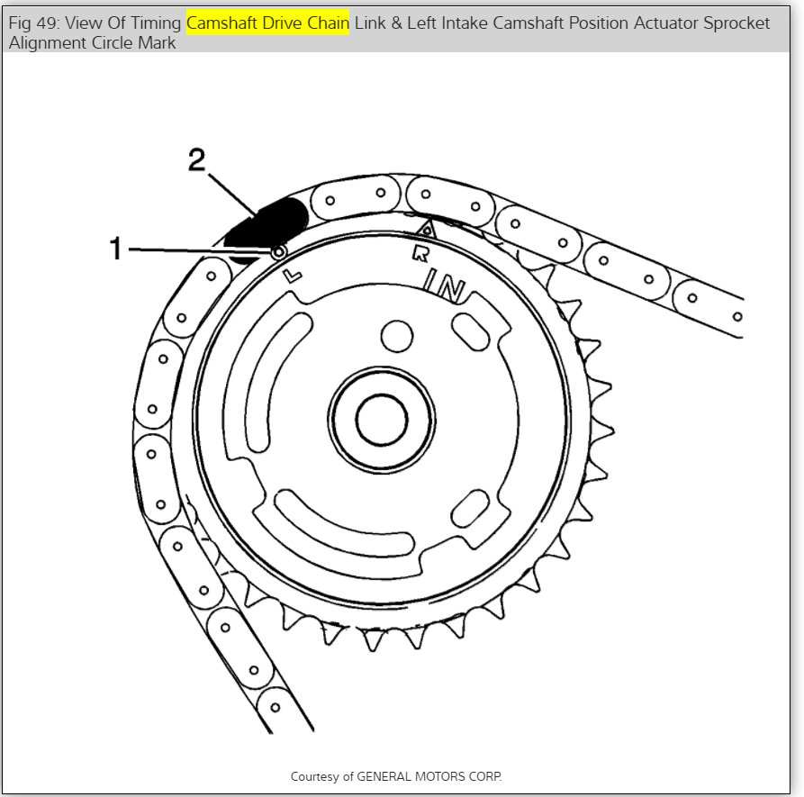

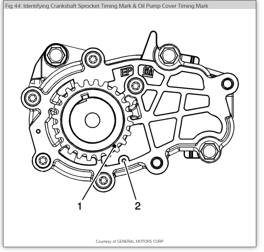

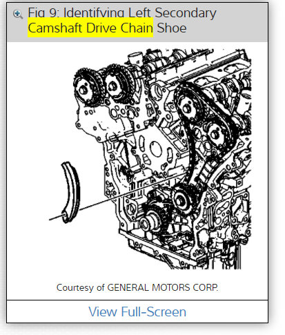

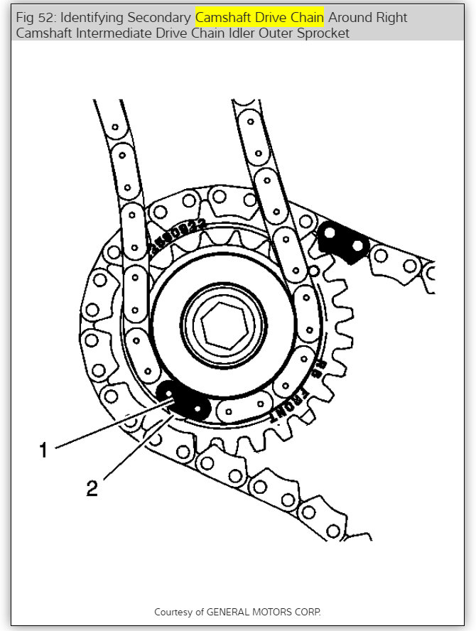

Need stage one and two instructions for replacing timing chains.
Dec 5, 2017 at 1:15 PM
  • 55,051 POSTS

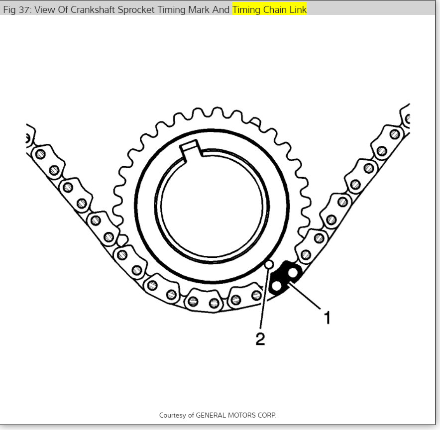

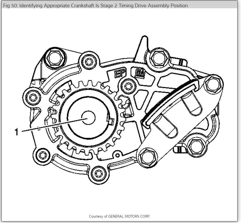

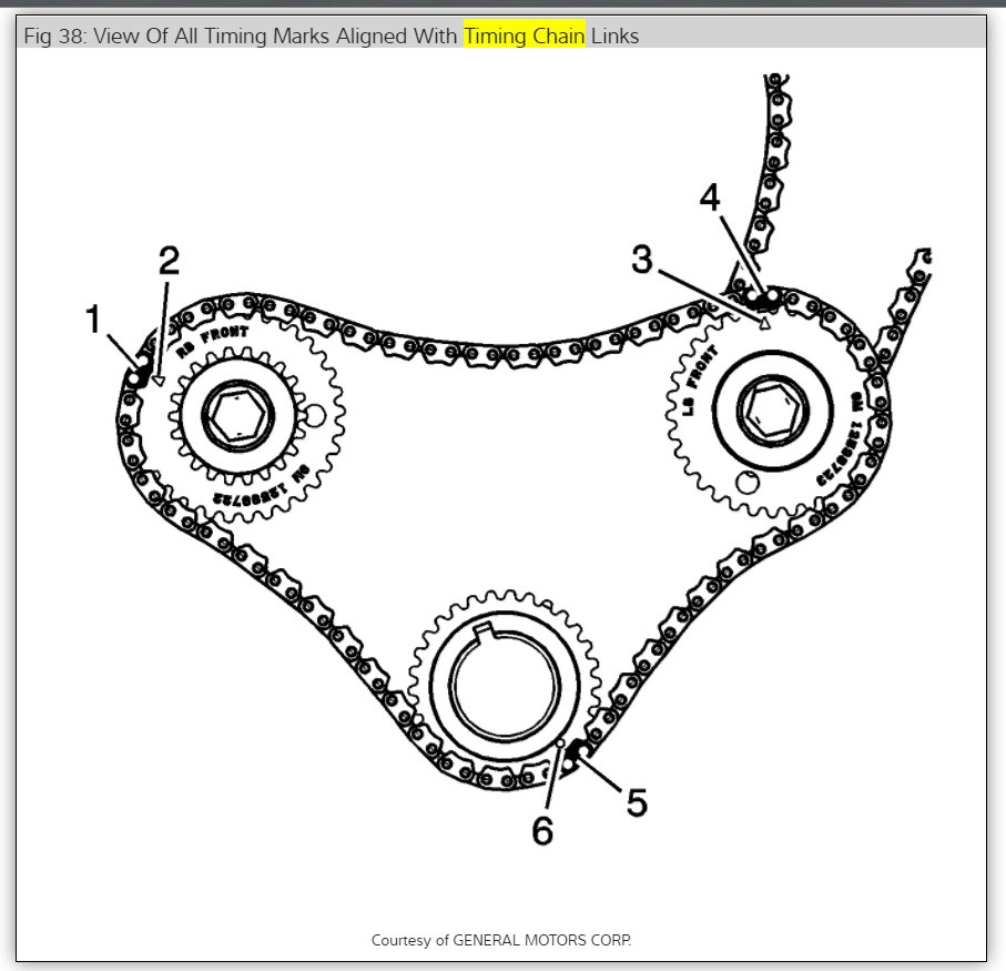

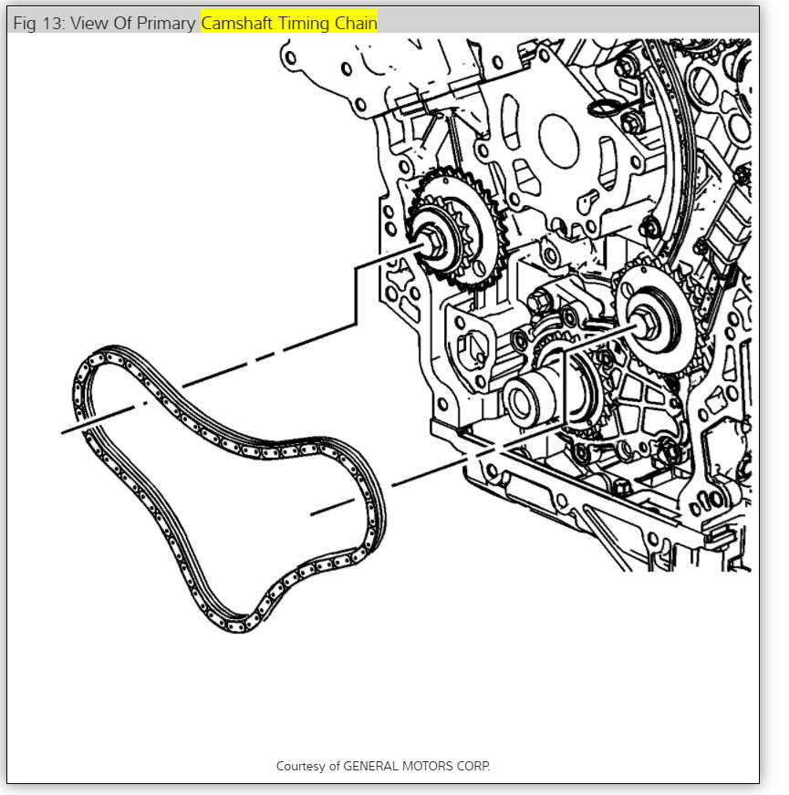

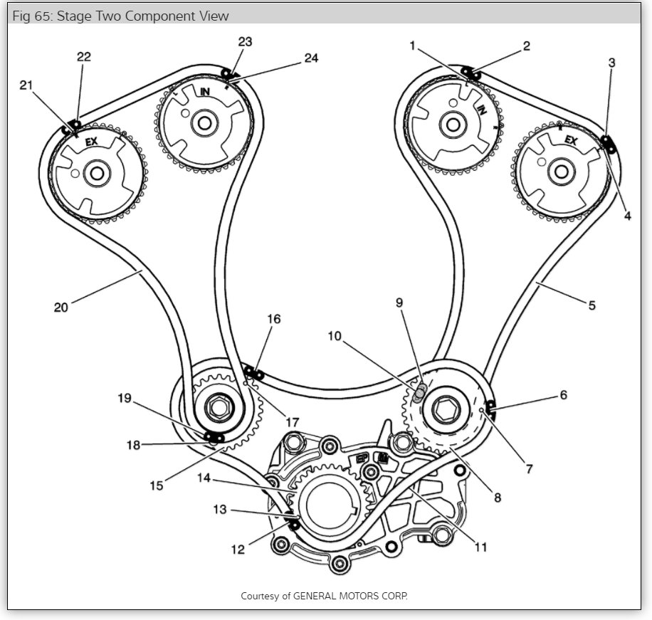

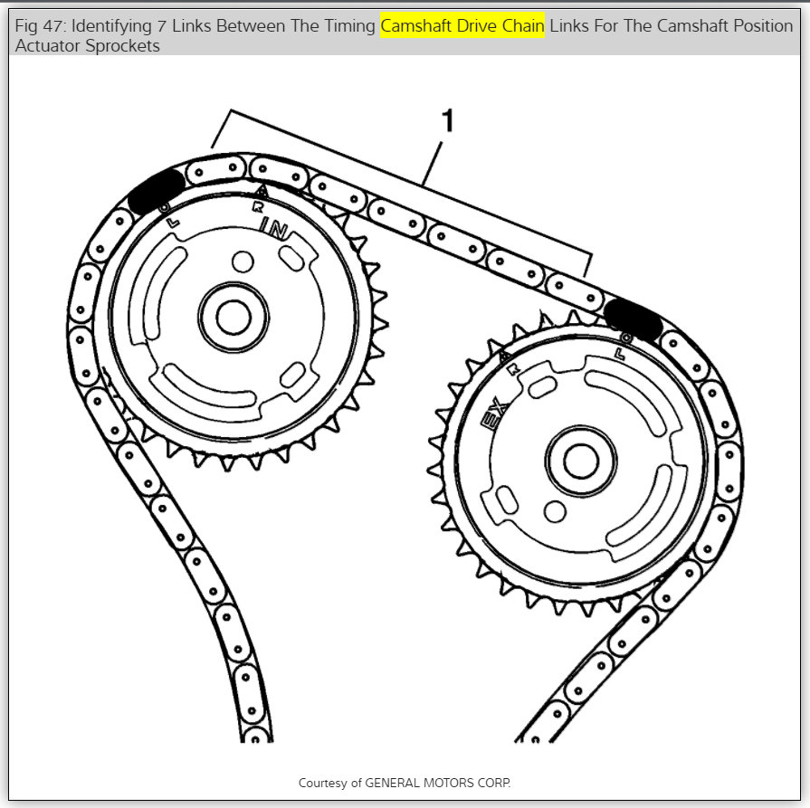

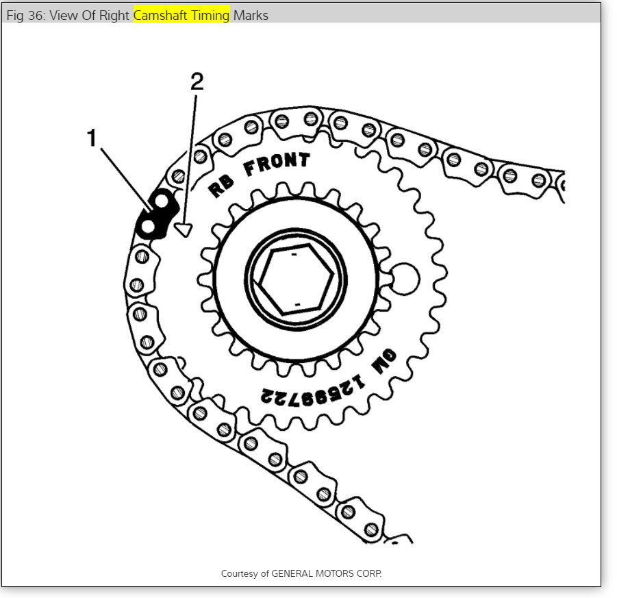

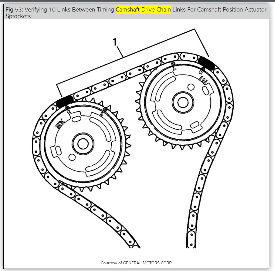

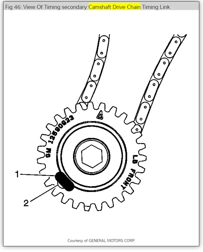

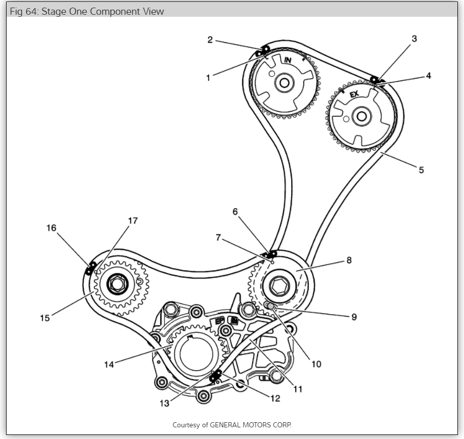

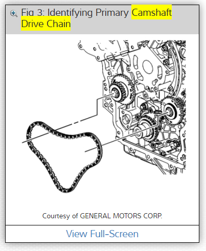

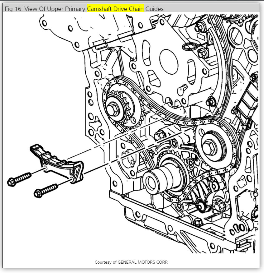

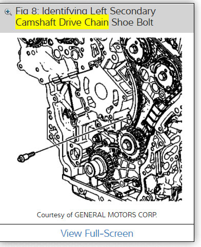

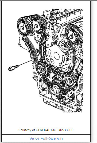

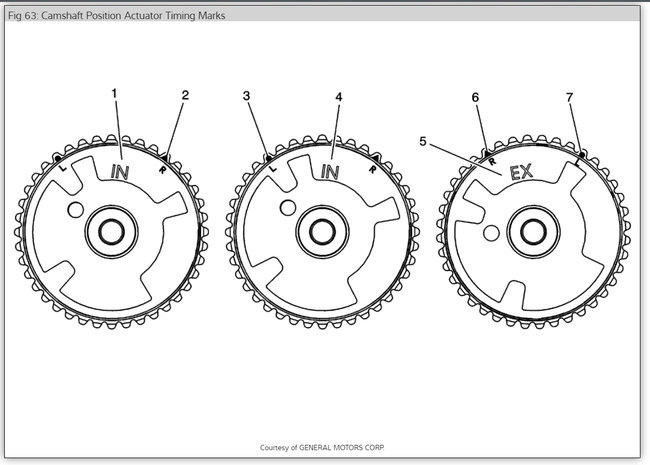

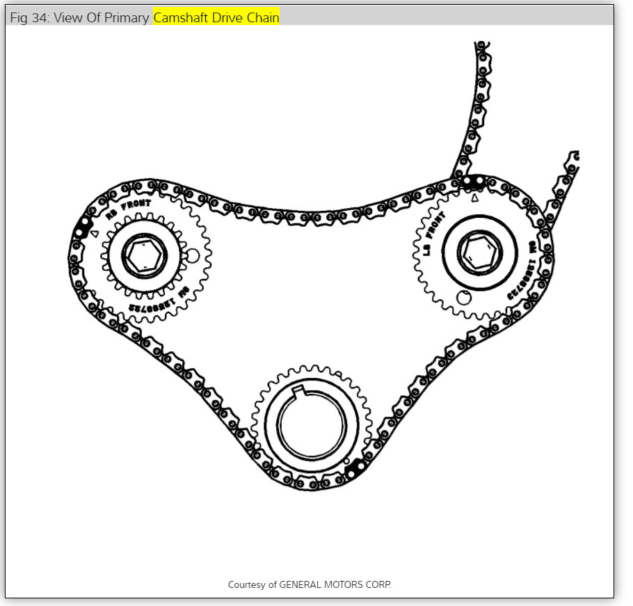

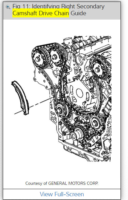

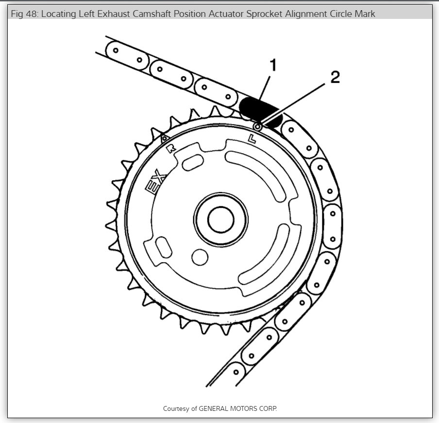

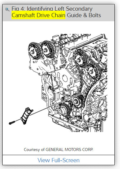

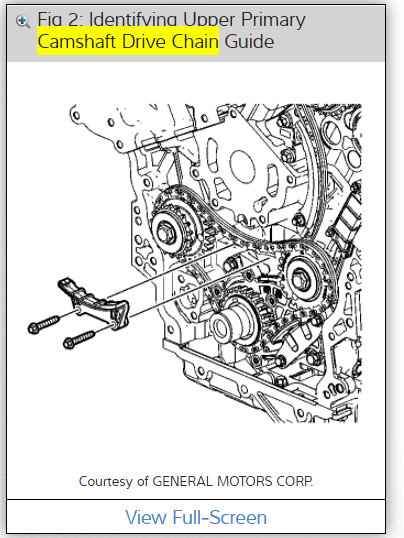

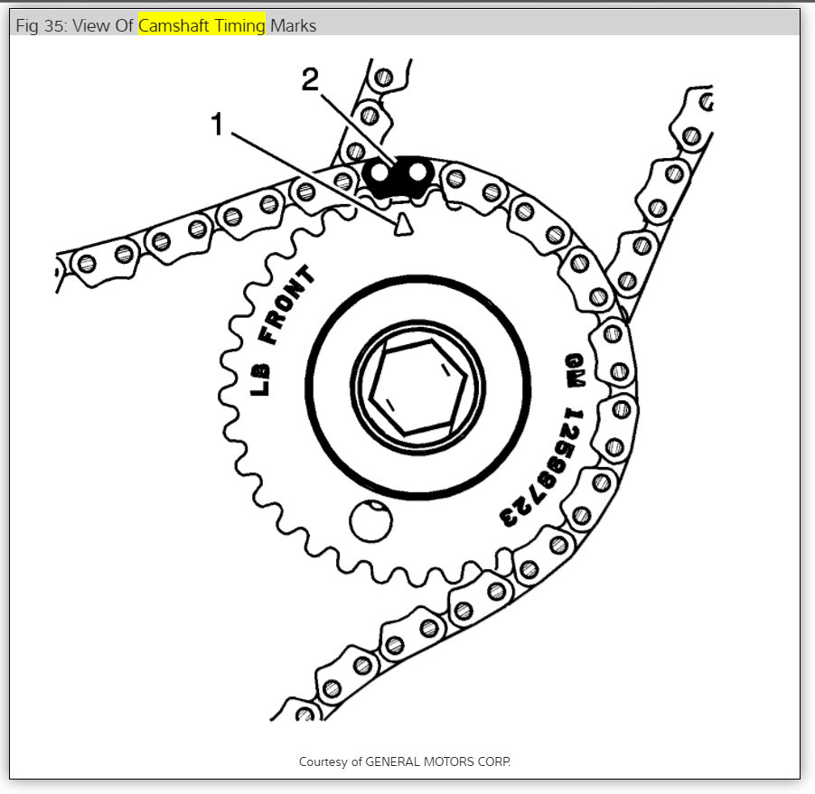

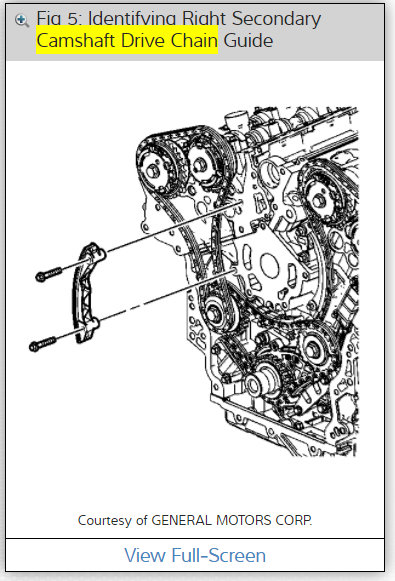

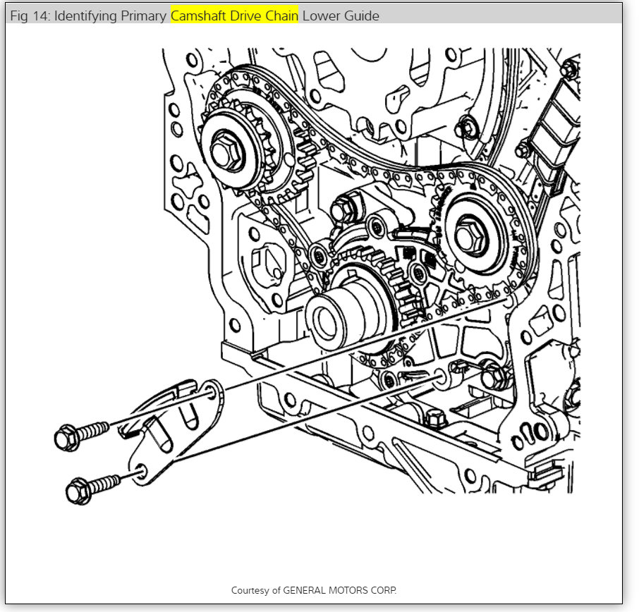

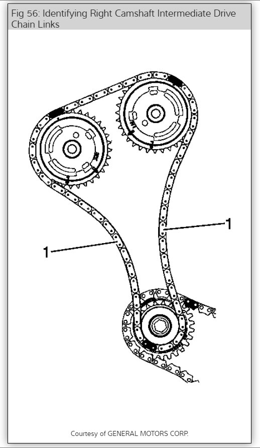

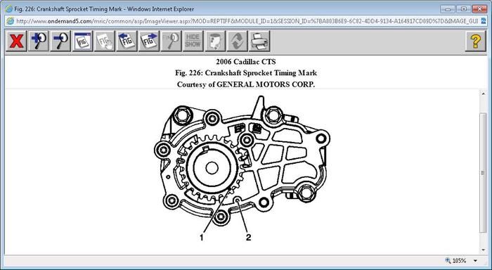

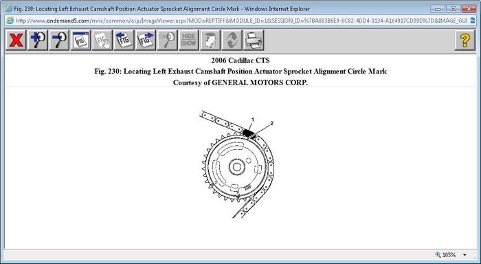

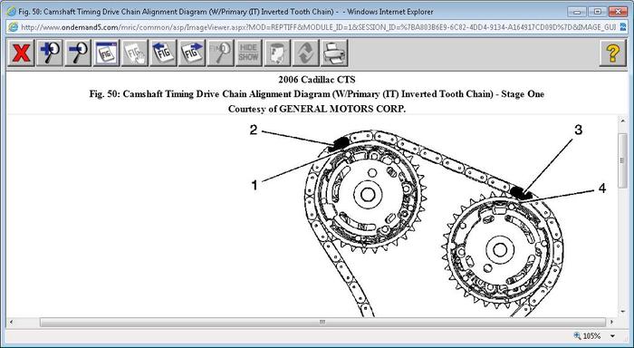

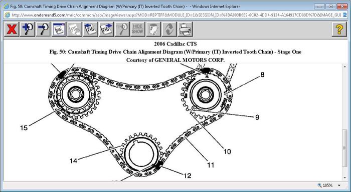

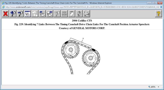

This is a fun job. ;) Here is the engine timing chain marks and diagrams as well as some of the procedure of what it all take to get the timing chain replaced. There are many diagram (below) so take some time to study them.

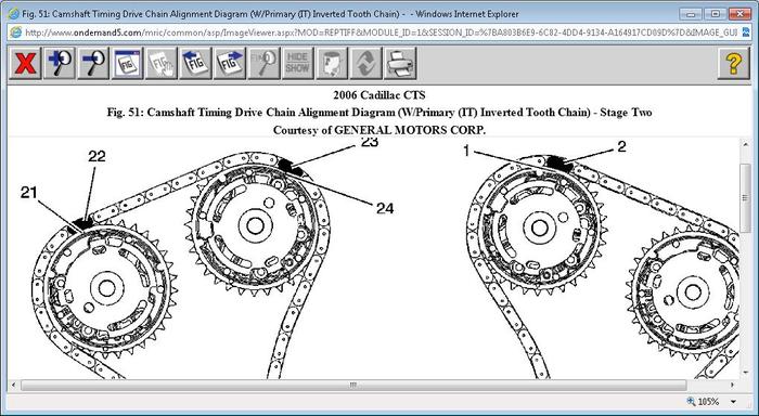

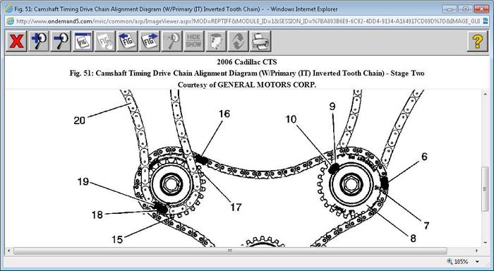

I did the timing on this engine and manually turned it over and now the timing chains won’t lineup. Is that because there’s no actuators in yet. Is it OK that the marks don’t lineup after doing the timing turning it over manually. I just need to know before I put the engine back together.
Jul 14, 2019 at 11:37 PM
  • 55,051 POSTS
You will run valves into PISTON if timing isn't correct. No actuators? Can you please shoot a quick video with your phone so we can see what's going on, that would be great. You can upload it here with your response.
Jul 15, 2019 at 5:32 AM
SCOTT NELSON
I’m not in the car right now. But I did it how Mealing said to do it which is keep it in stage one while you do every timing chain. But if you watch Cloyes video It says to do it in stage two then turn it to stage one to do that right bank chain and AllData said to do that too. And it almost seems like on every full rotation I get bound up a little bit because it pulls a little slack in the chain. I’m wondering if I should redo the timing and deal with how all data says to
Jul 15, 2019 at 6:57 AM
  • 55,051 POSTS
I would, it is important to do the chains as they say, line it up one side at a time. Let me know what happens please.

So I'm setting the timing on my 2007 3.6L CTS. After I get it aligned. The book says to crank the motor by hand two full rotations. To check for chain slips and to make sure timing is set correct. But when I do, the chain slips on the left head exhaust cam sprocket. About a tooth or two. I've put on all new chain set including chains, tentioners, guides and idler sprockets. Why would it slip? I'm guessing the heads??? What should I check
Oct 18, 2019 at 7:27 AM (Merged)
WRENCHTECH
  • 20,761 POSTS
Most likely you are rotating in the wrong direction. You can't pull against the tensioners.
DIYMECH
It should be spun clockwise right
WRENCHTECH
  • 20,761 POSTS
Yes, it appears clockwise is the direction to go.
Make real sure that you aren't hitting the piston against a valve due to incorrect timing.
DIYMECH
Thanks for the response. But the marks are all lined up and Im cranking it in the correct direction. What else would make it slip
DIYMECH
Can anyone help?
WRENCHTECH
  • 20,761 POSTS
I've already given you about the only answer there is. If the tensioners are all in place and working and you are rotating the correct direction, something has to be jamming up the cams.

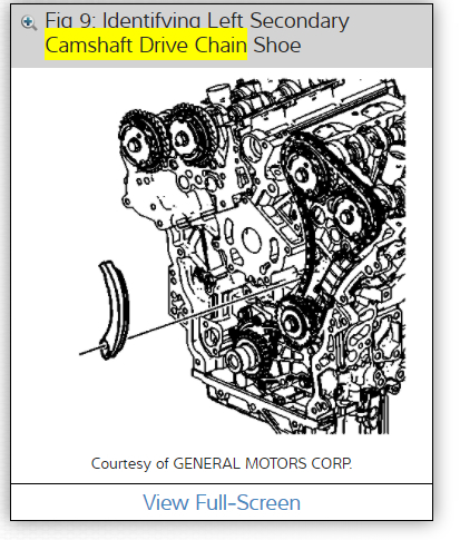

Can I get just a timing chain diagram for my car listed above it has 3.6l dohc engine?
Camshafts are out of sync.
SATURNTECH9
  • 30,869 POSTS
Here are the timing marks the left side marks along with the crank sprocket. There are more in the post below which should be able to get the job done.
SATURNTECH9
  • 30,869 POSTS
The diagrams i just posted should get you there.

TIM ZWAGERMAN
In response to the question about the timing marks not lining up after turning the engine over manually, i had the same issue. I think it is due to the different number of teeth on the sprockets so that everything does't line up in the same spot every revolution. I followed the instructions for setting timing and made sure all the marks lined up, set the tensioners, and after turning engine manually none of the chain marks lined up anywhere. It made me kind of nervous but after reassembly the vehicle started right up and ran fine.
