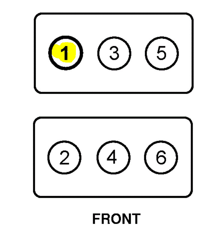

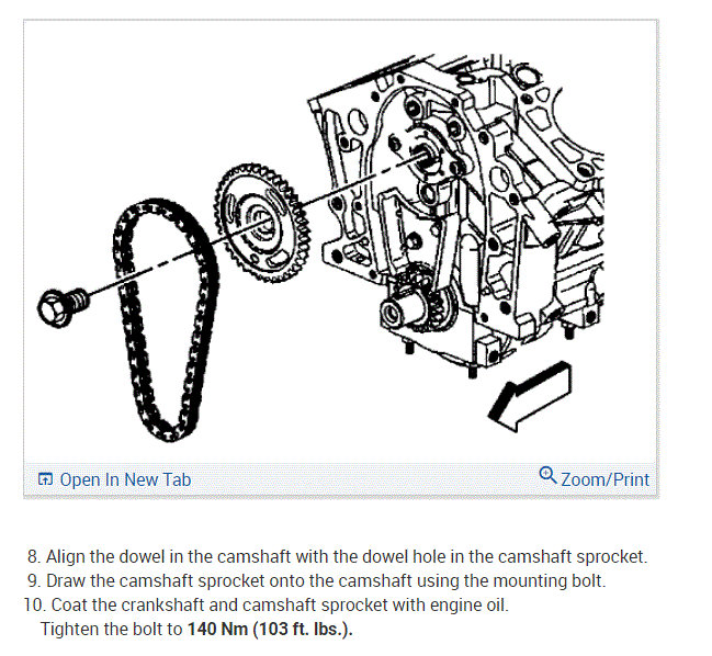

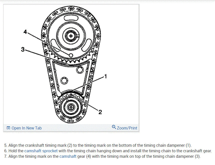

I need to know where the number 1 firing cylinder.
Jun 4, 2021 at 2:59 AM
  • 110,241 POSTS

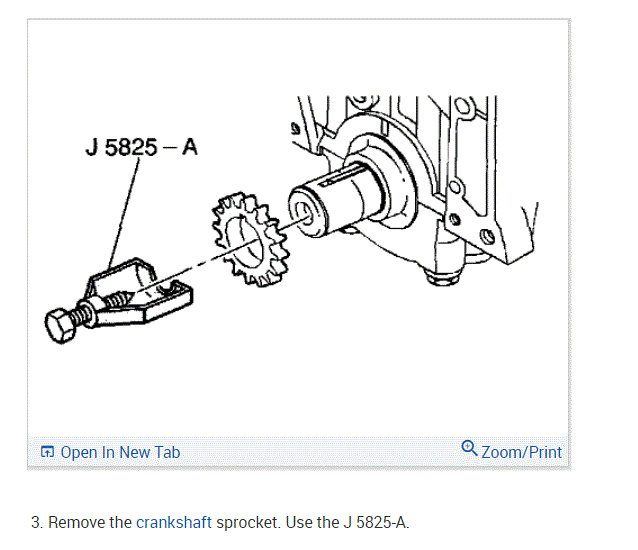

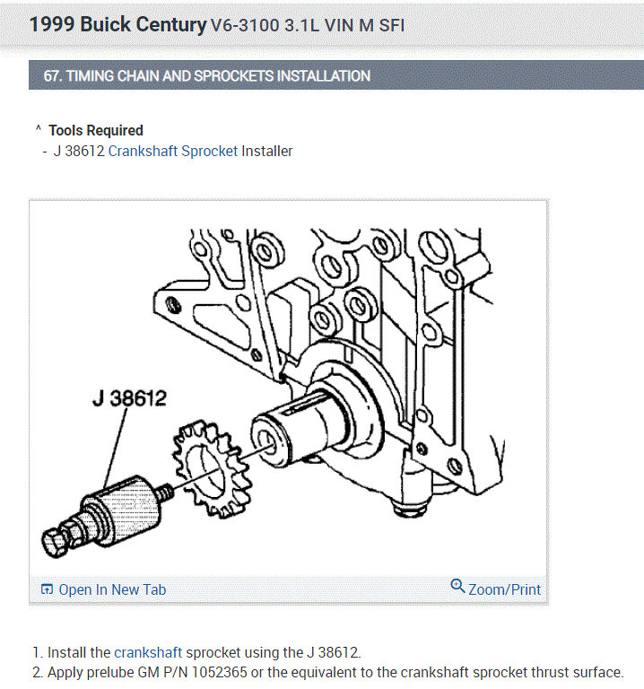

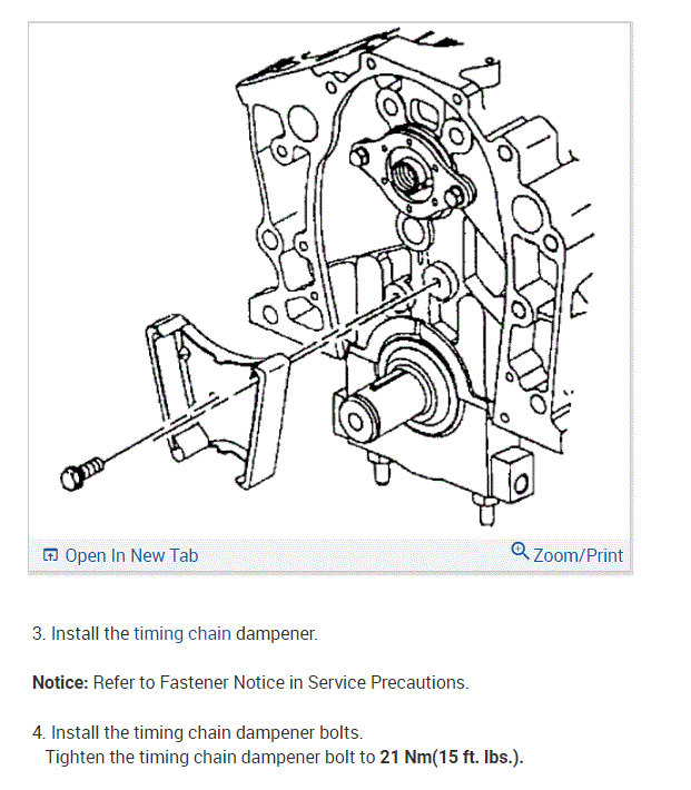

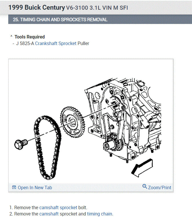

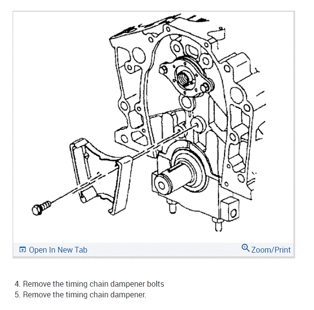

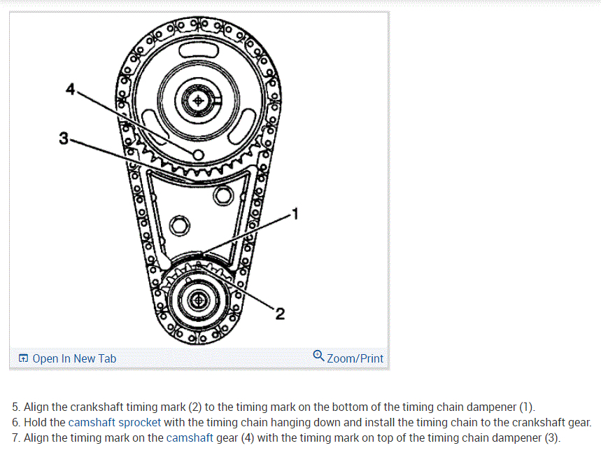

If you look at pic 1 below, it shows cylinder 1 location. Additionally, I included the directions for chain replacement. I'm not sure if you need them but figured I would add them.
