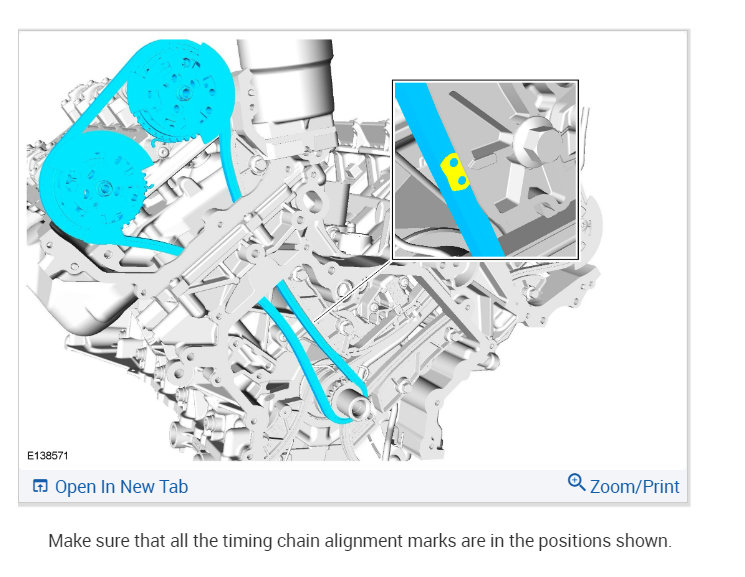

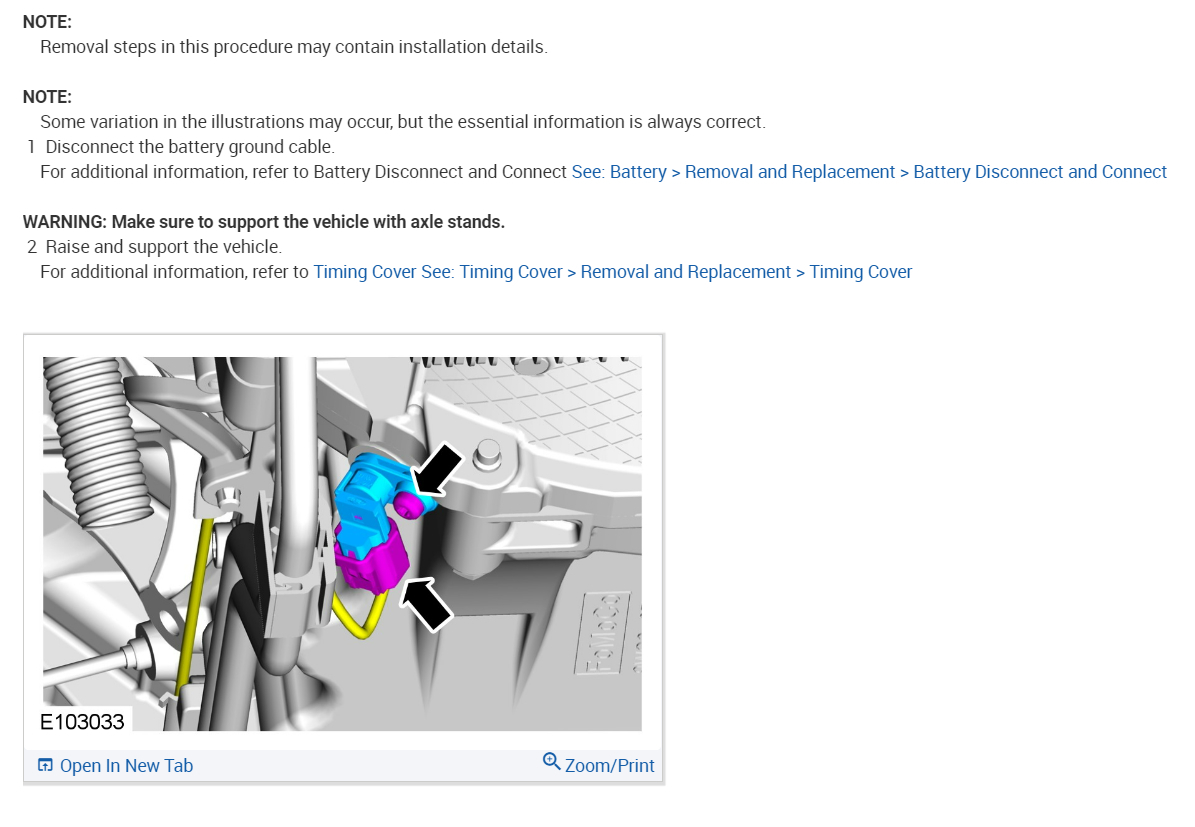

I was unable to find bolt pattern and torque specs with torque sequence for 5.0L non-supercharged Jaguar engine, the only repair manual I found was through Haynes in the UK and won't to the USA.

Can you please be more specific as to which information you require?
A good video on the complete job:
https://youtu.be/isq7kPpLD_g
How to align camshafts:
https://youtu.be/ba6puZxKGHE
Cheers, Boris
Jul 22, 2022 at 1:16 AM

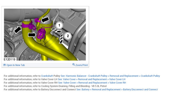

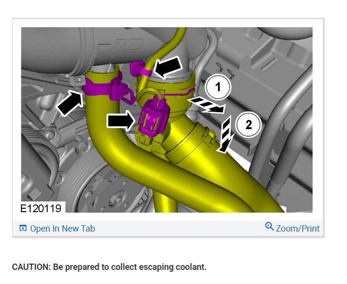

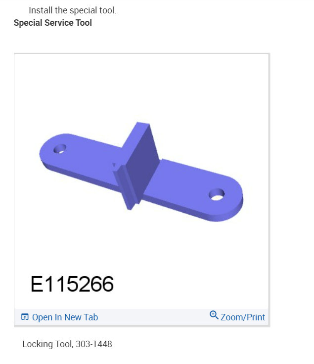

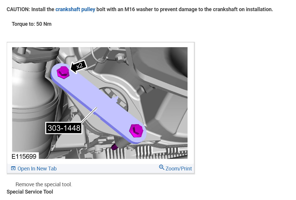

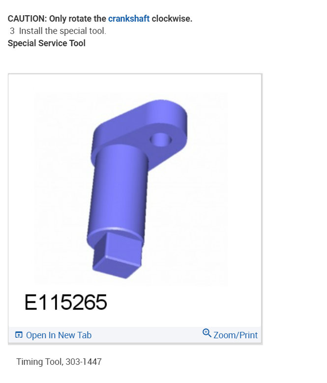

  • 55,421 POSTS

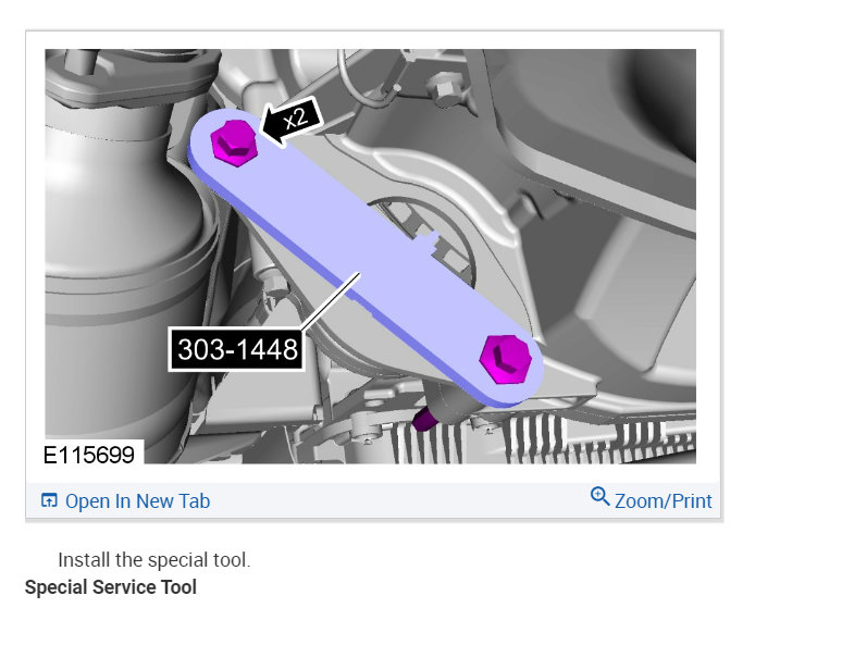

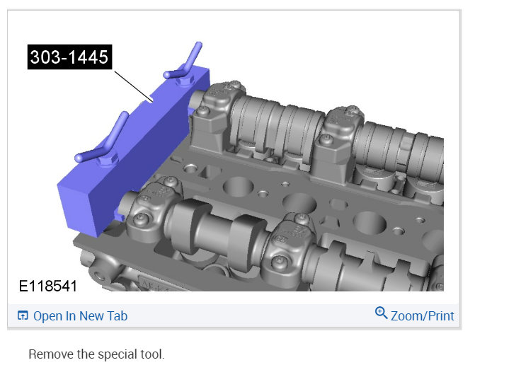

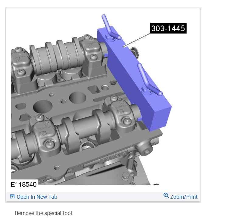

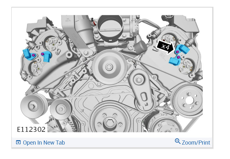

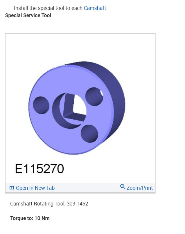

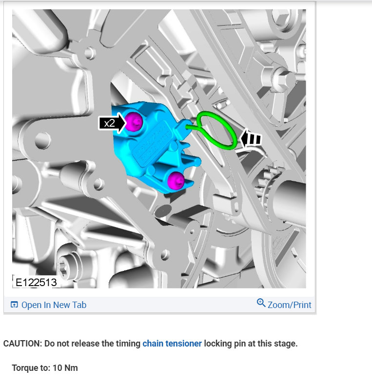

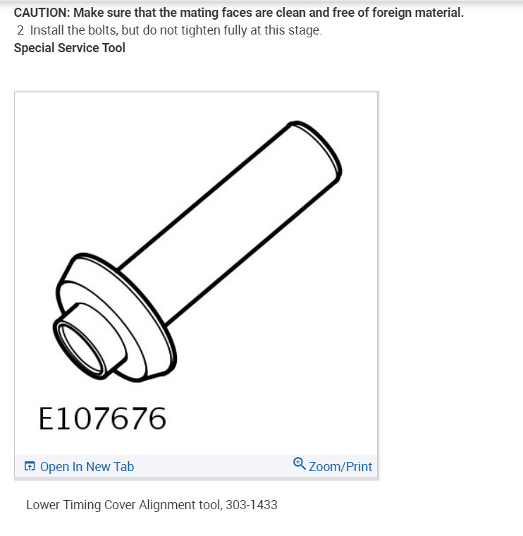

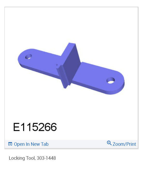

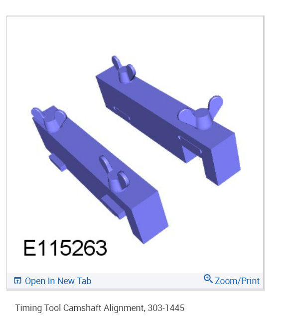

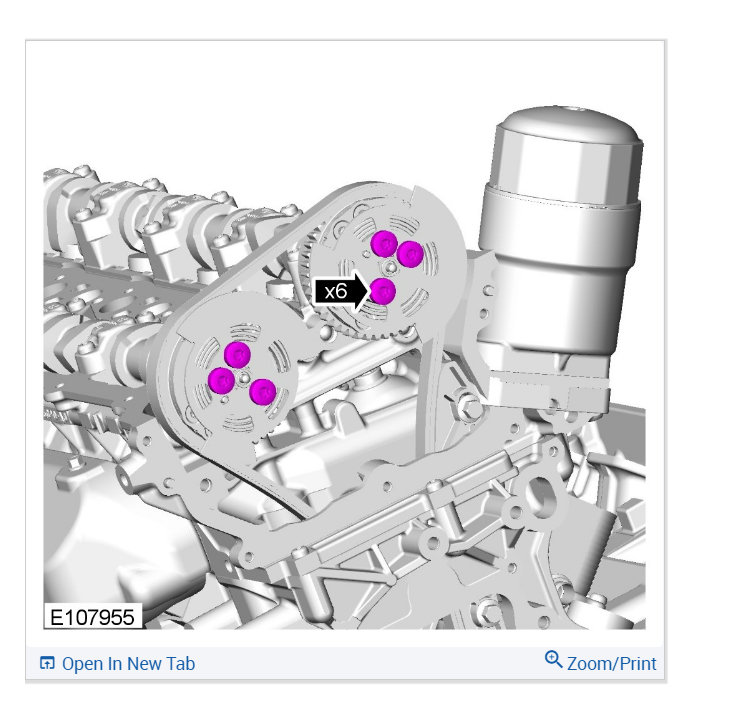

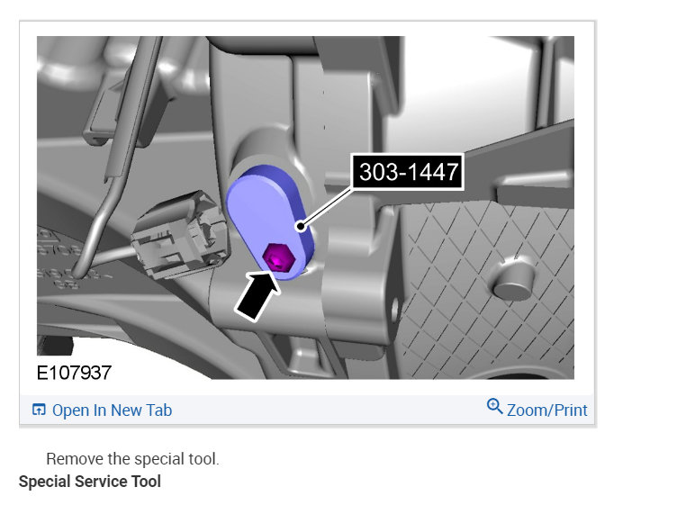

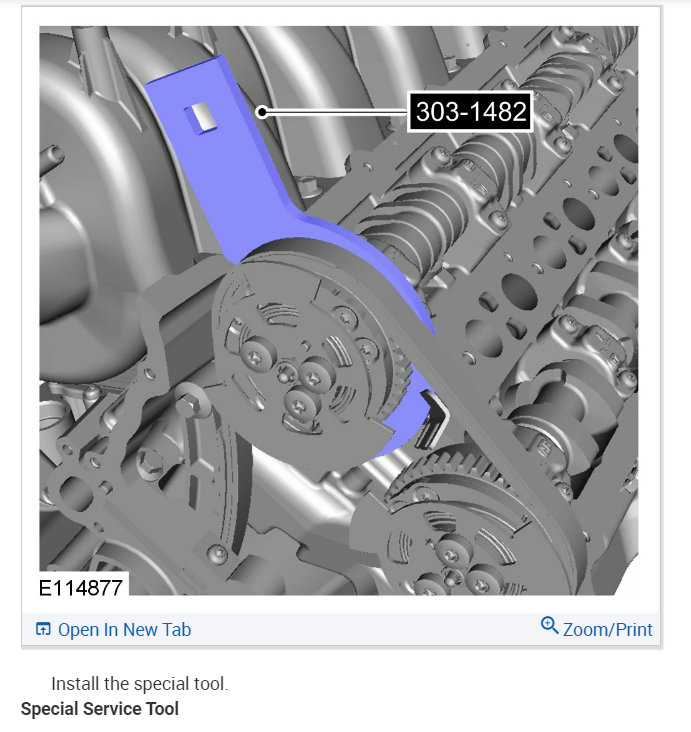

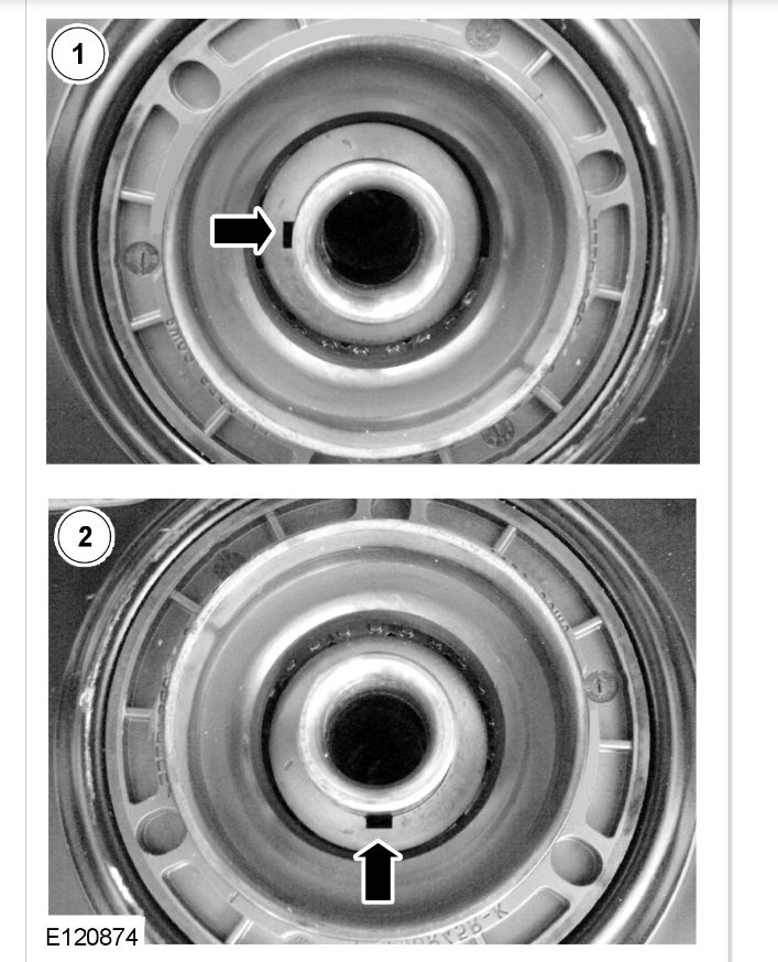

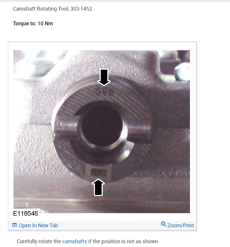

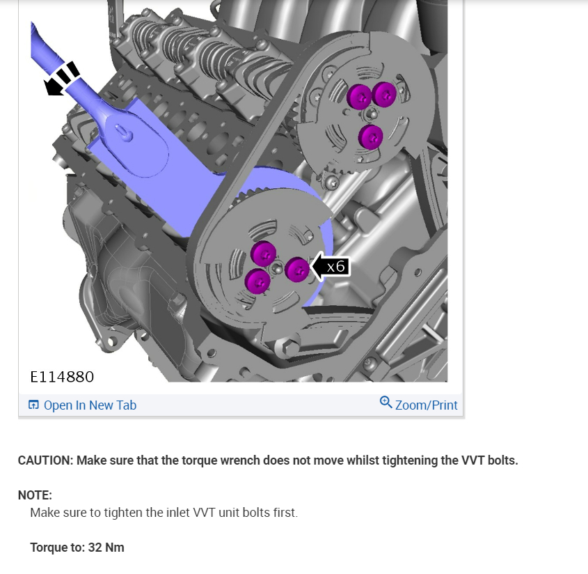

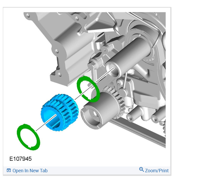

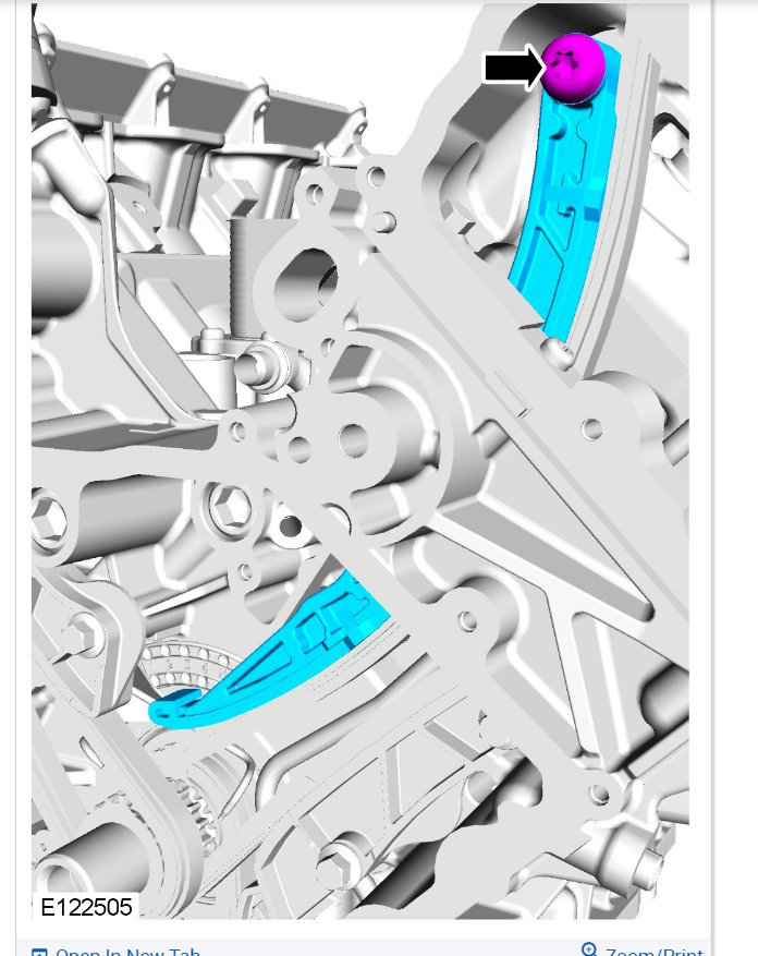

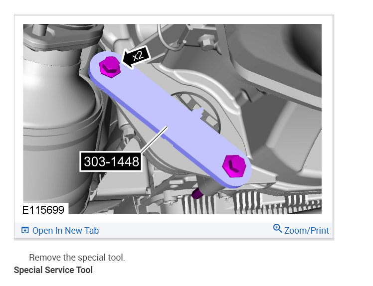

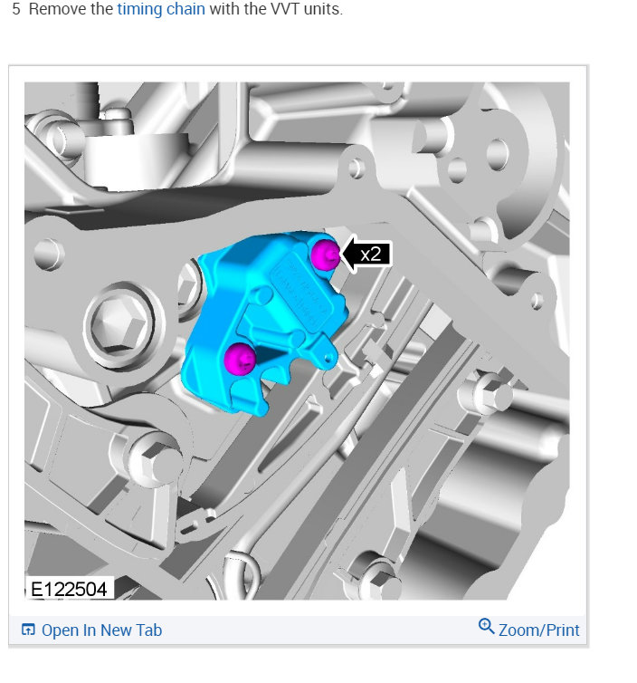

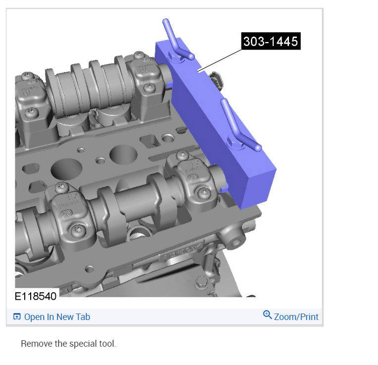

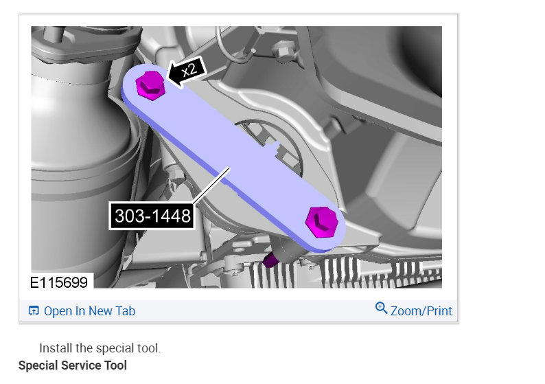

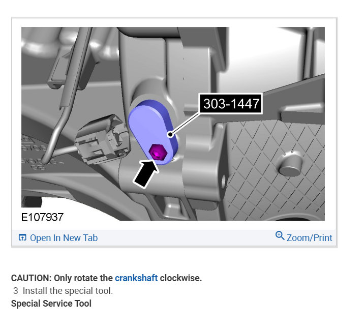

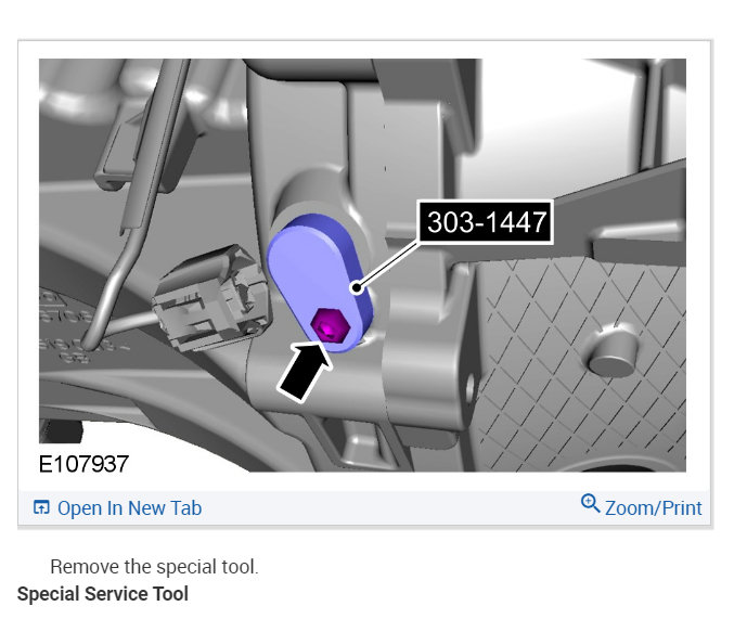

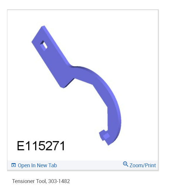

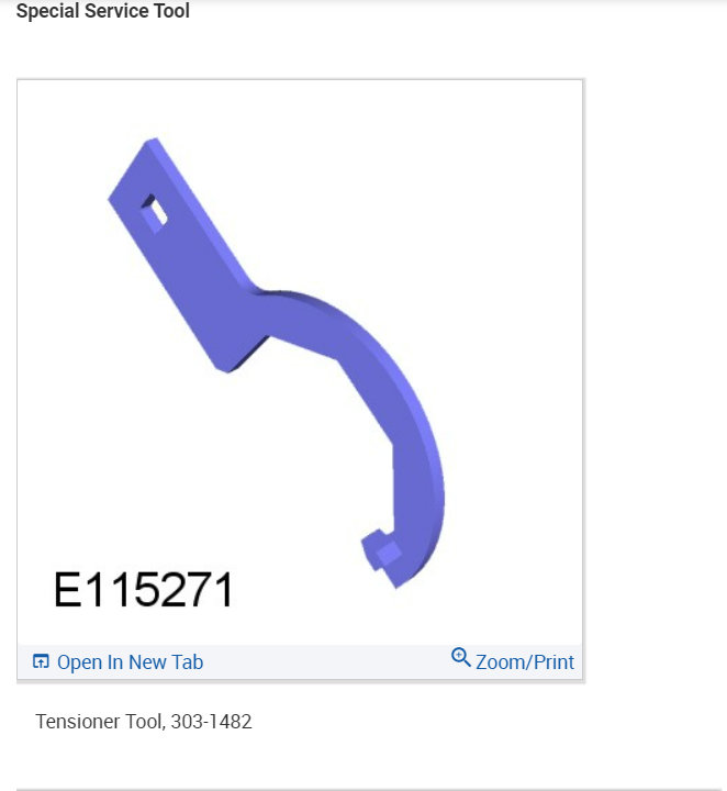

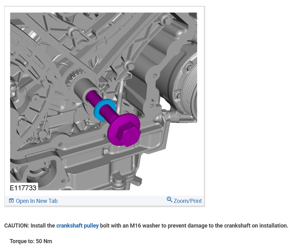

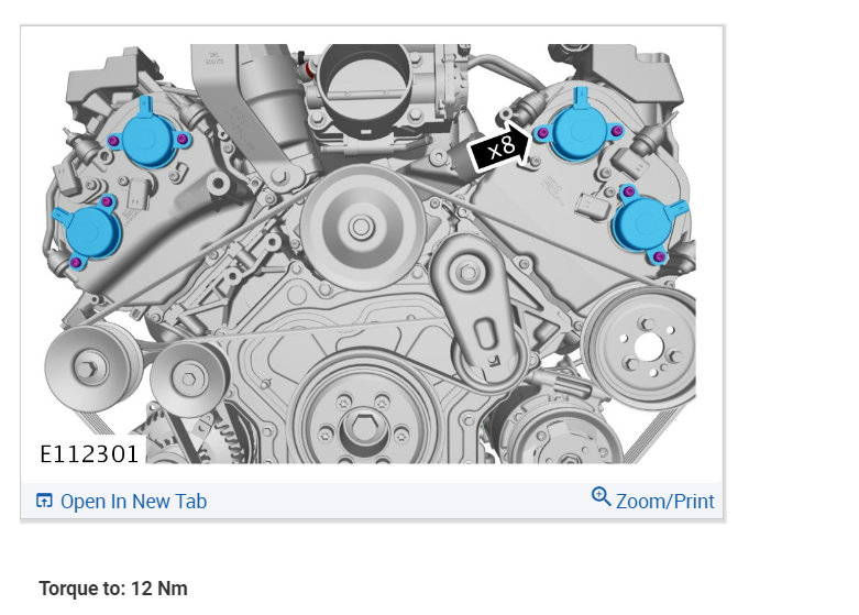

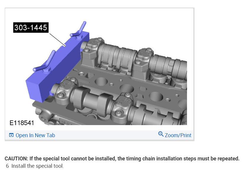

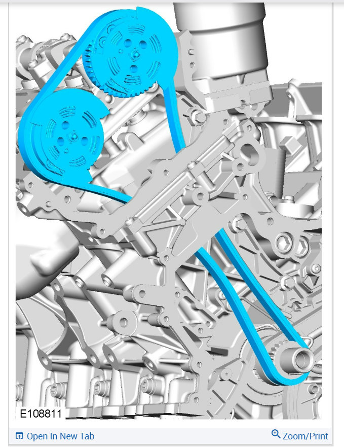

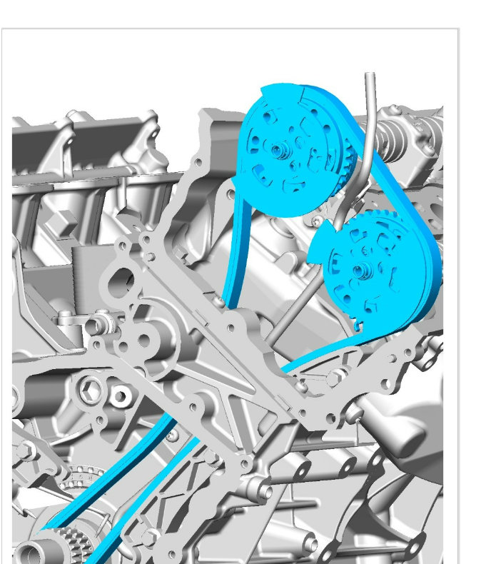

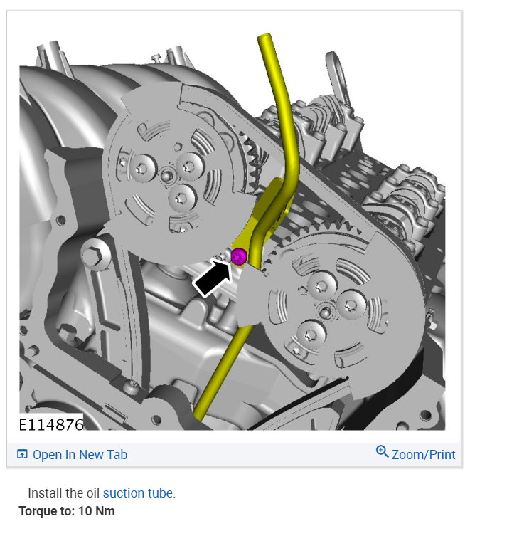

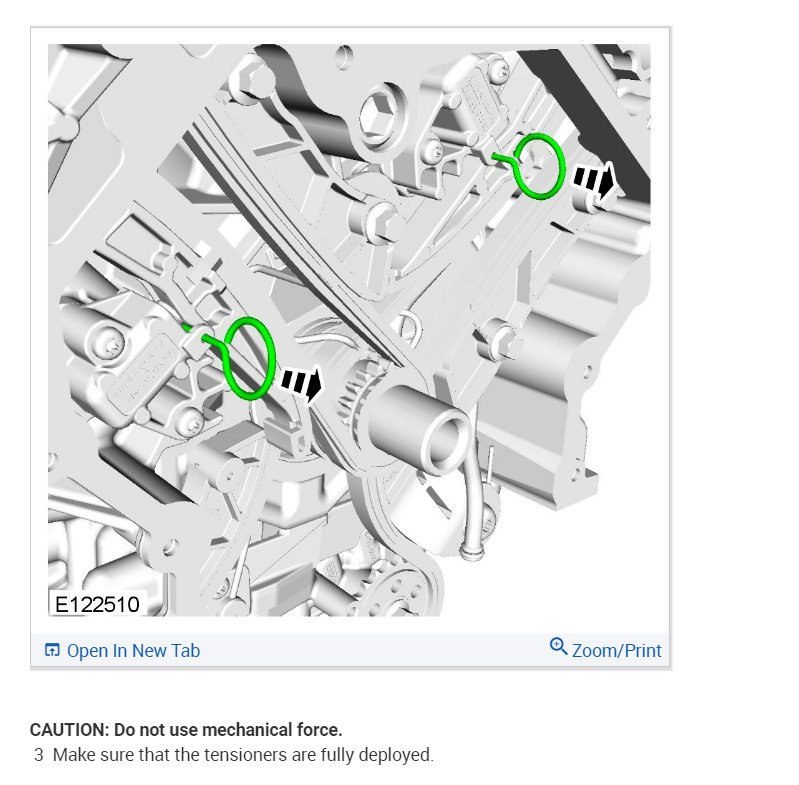

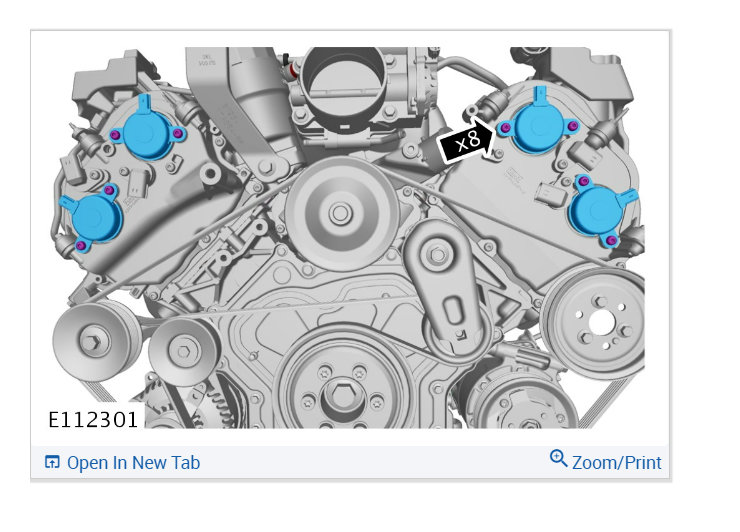

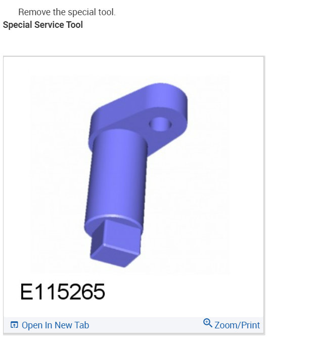

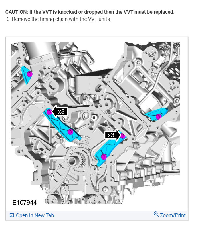

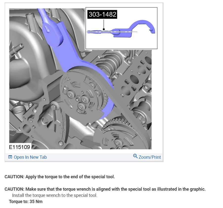

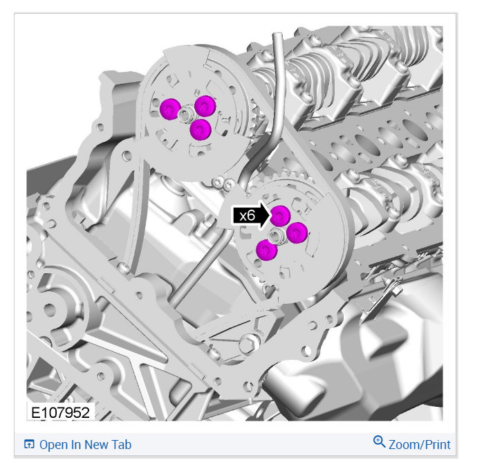

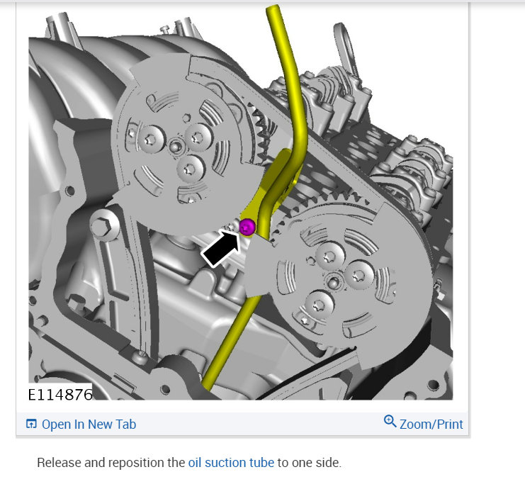

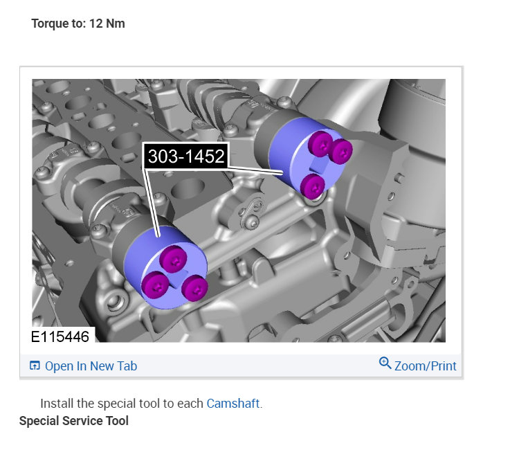

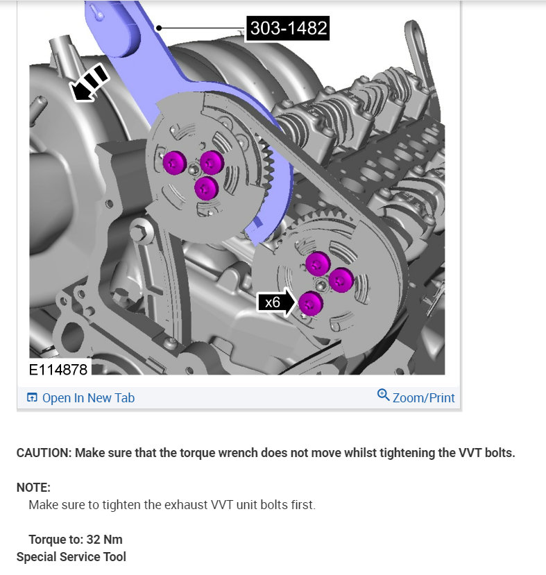

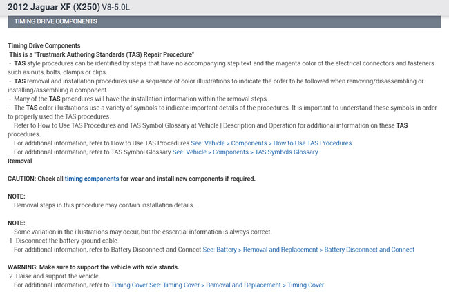

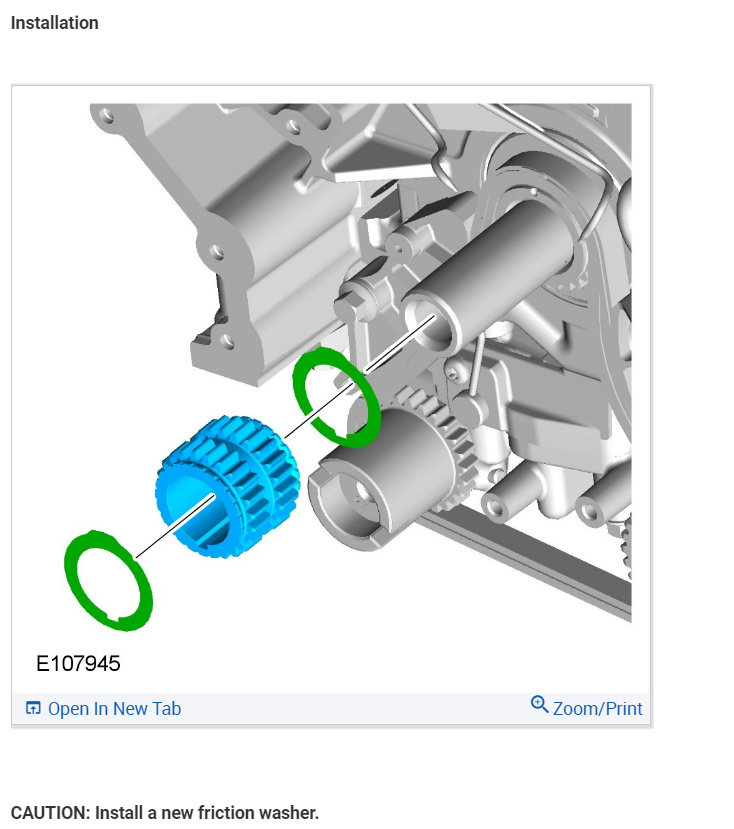

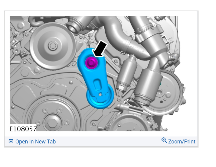

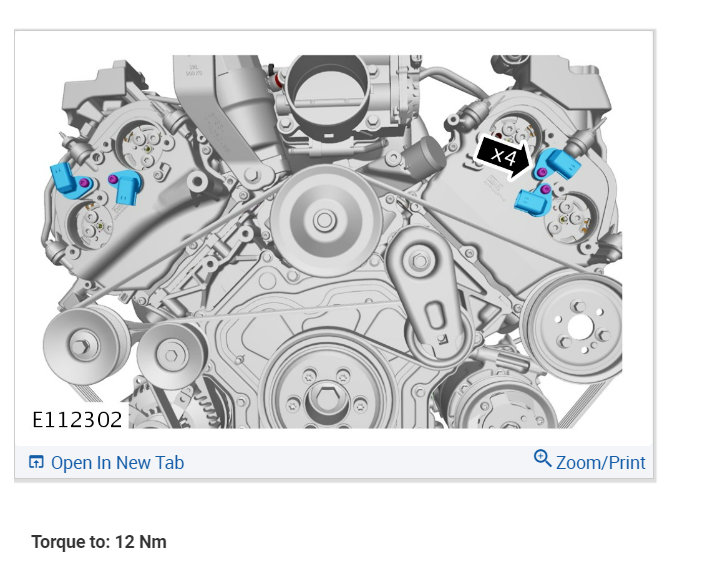

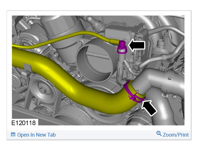

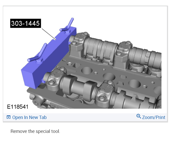

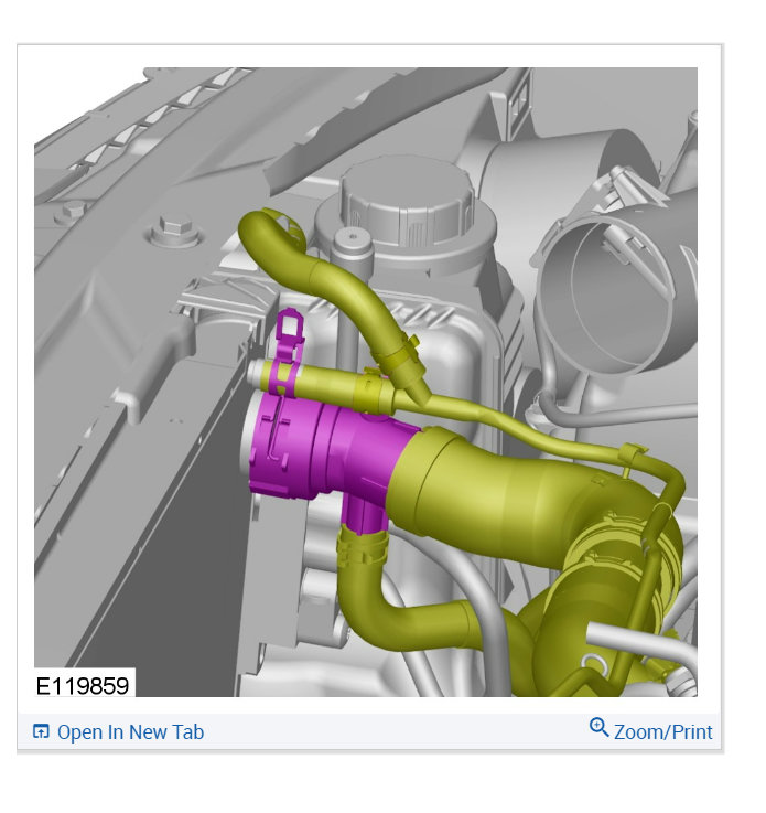

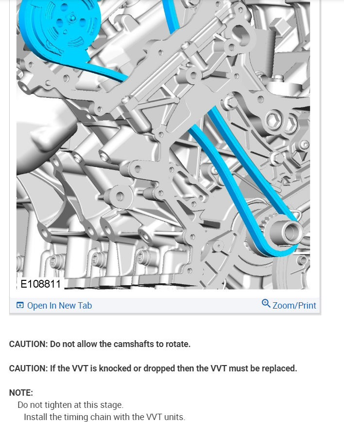

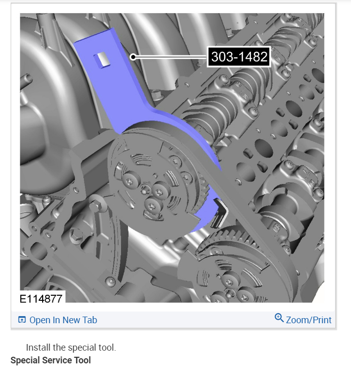

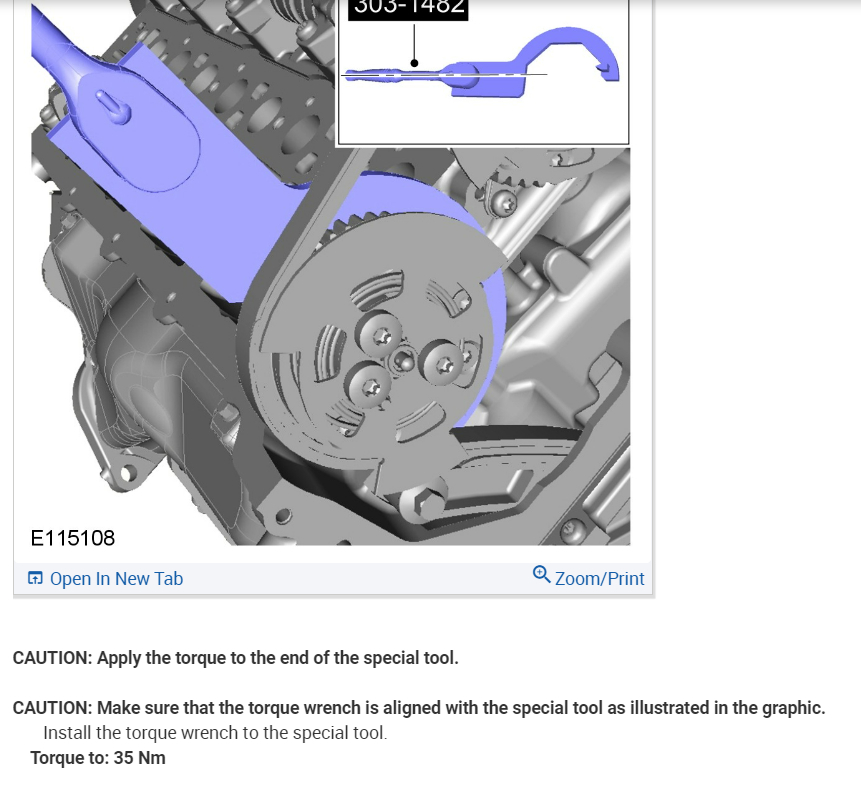

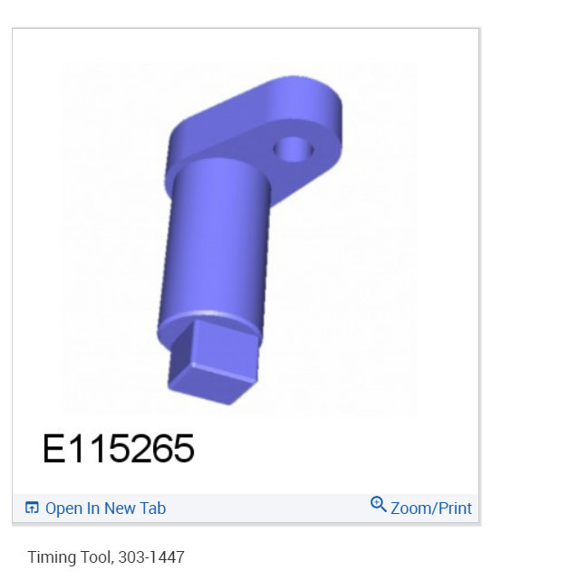

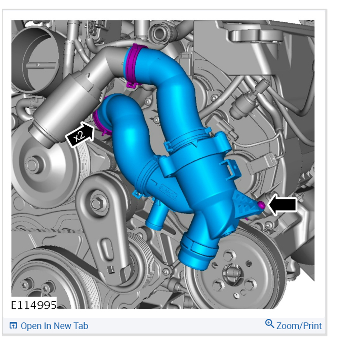

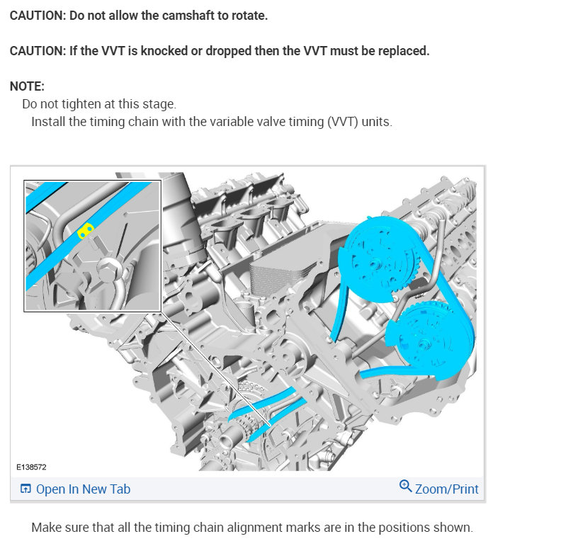

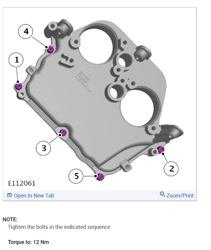

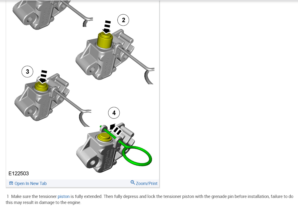

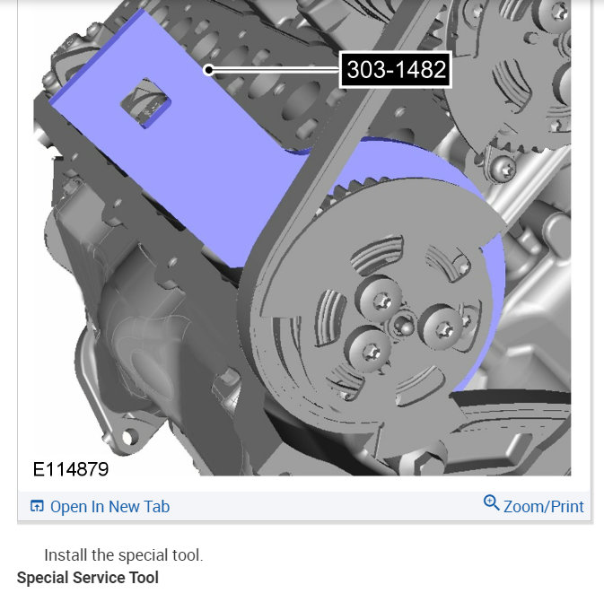

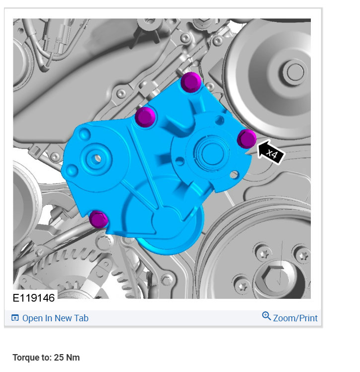

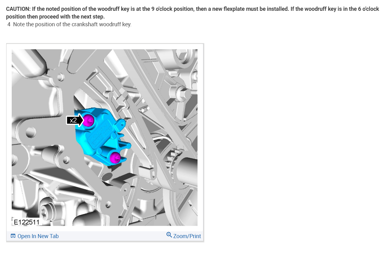

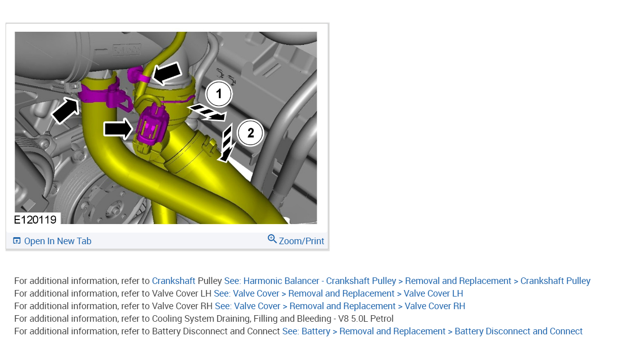

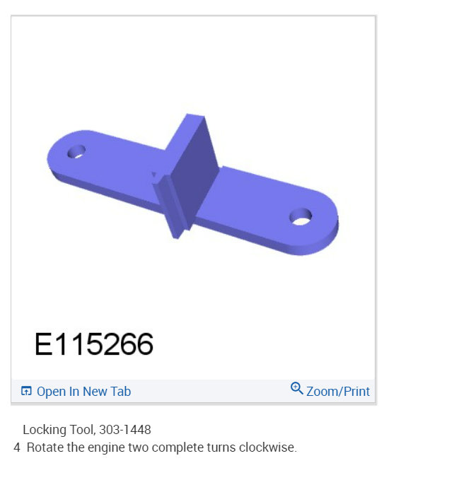

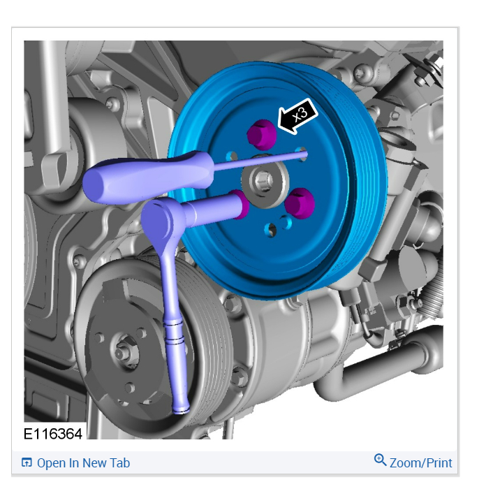

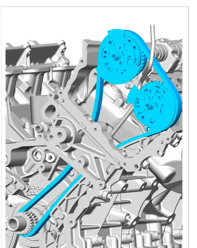

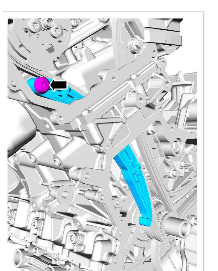

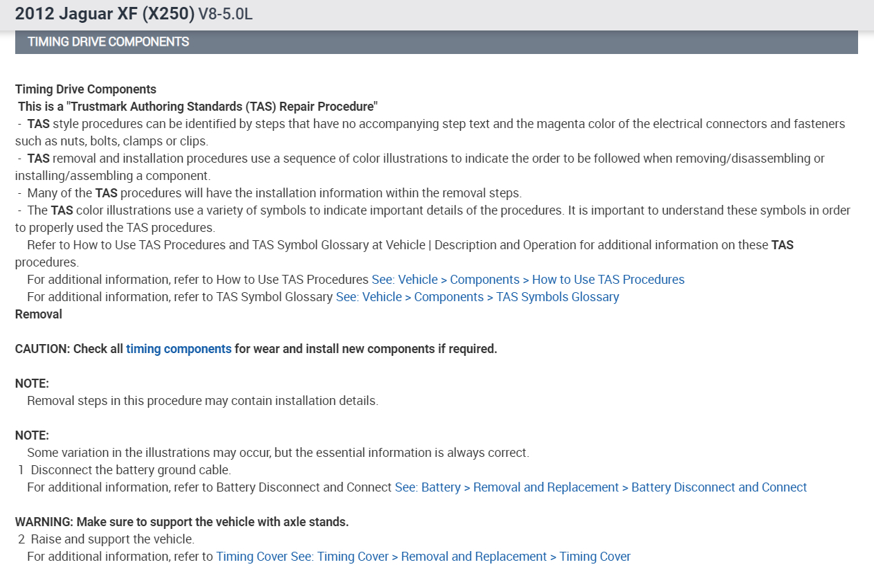

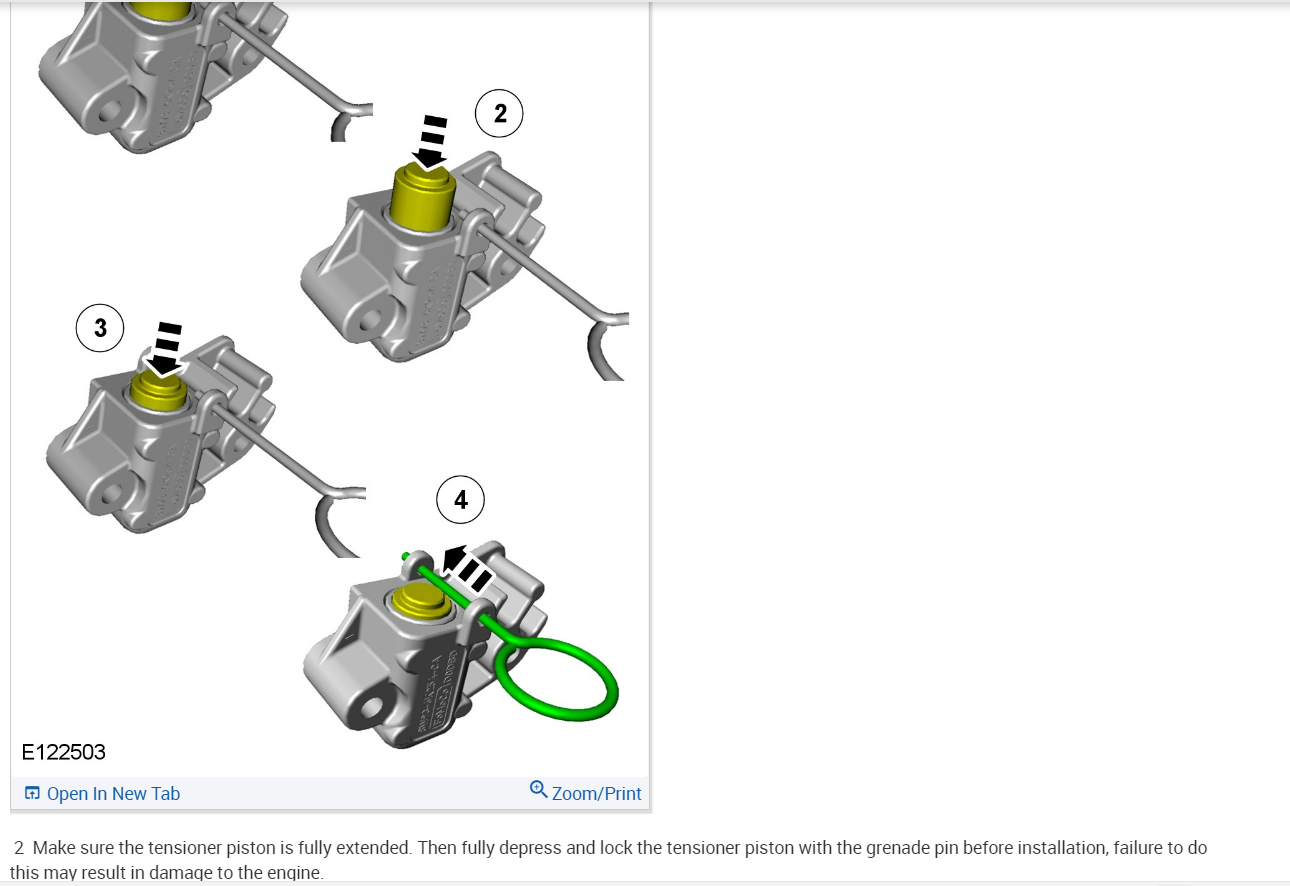

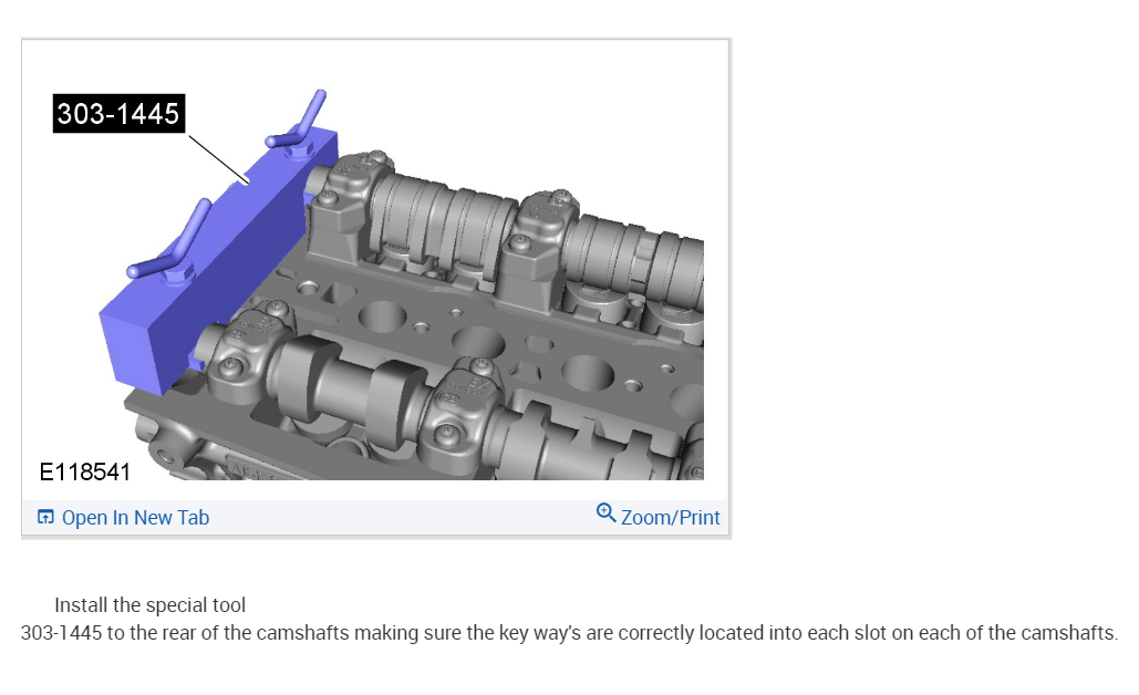

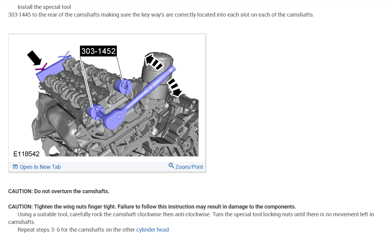

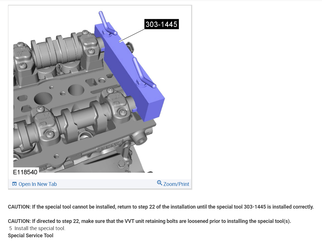

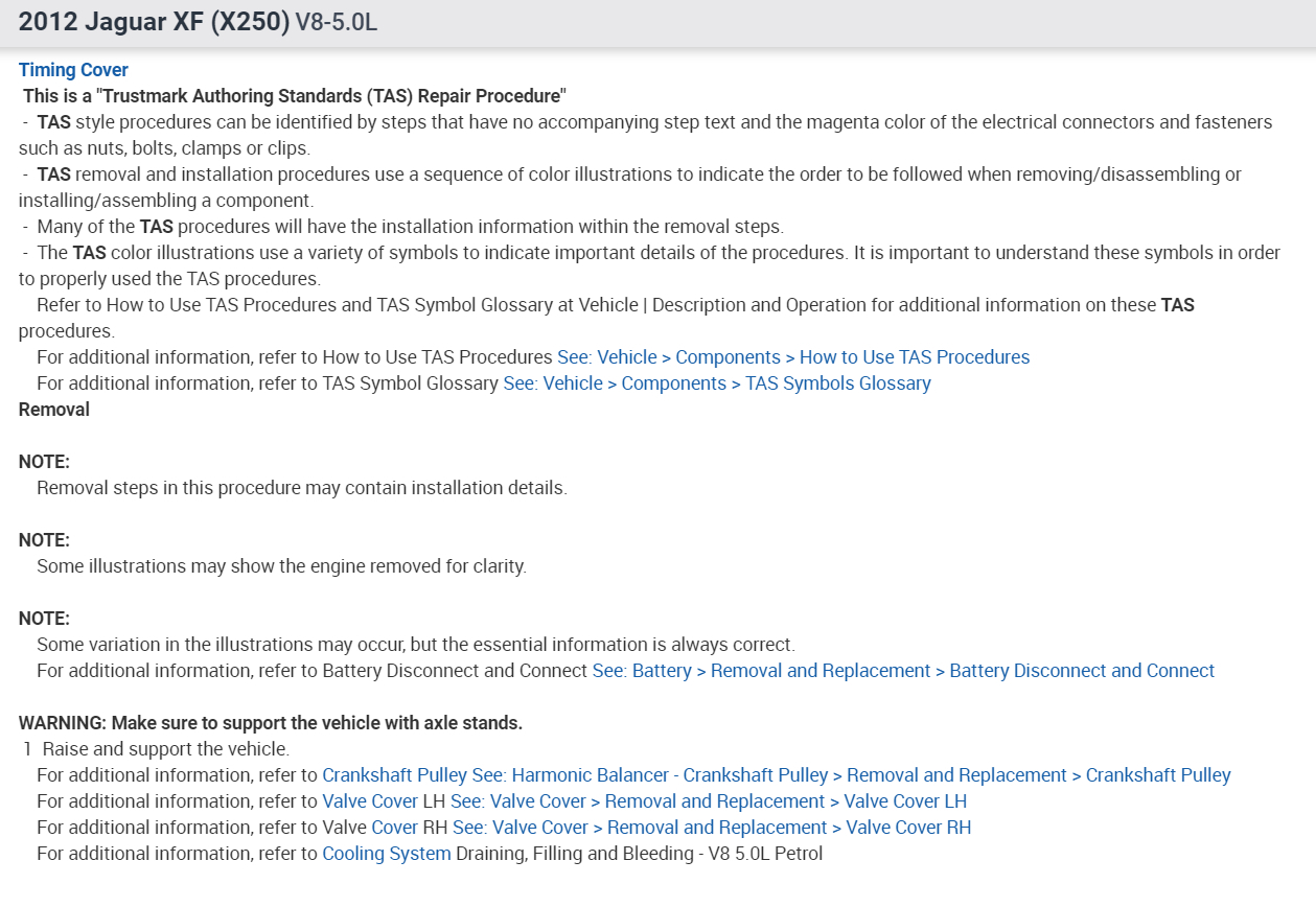

Here are the timing chain replacement instructions and special tools needed to do the job in the diagrams below. Check out the diagrams (below). Please let us know if you need anything else to get the problem fixed.
Jul 22, 2022 at 10:34 AM

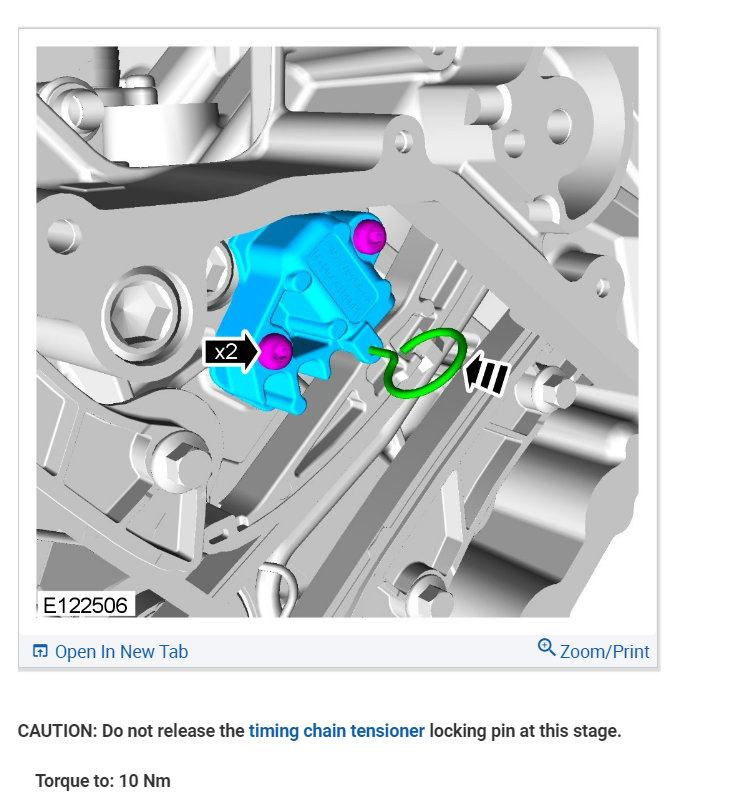

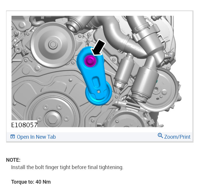

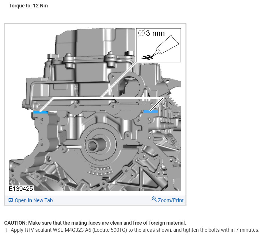

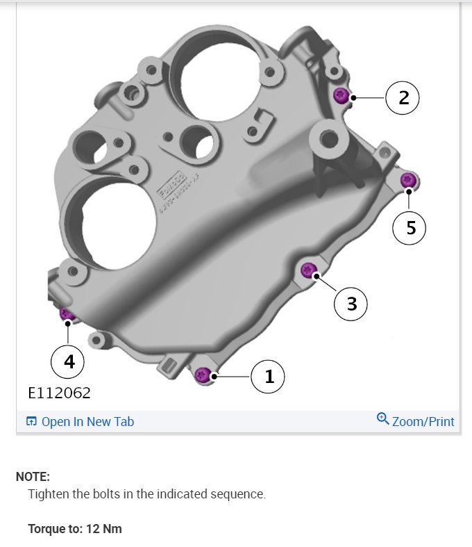

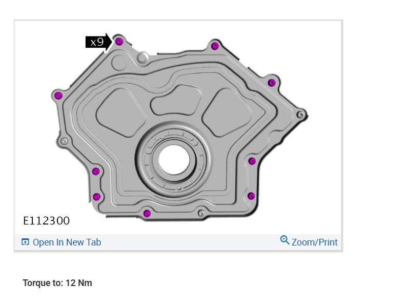

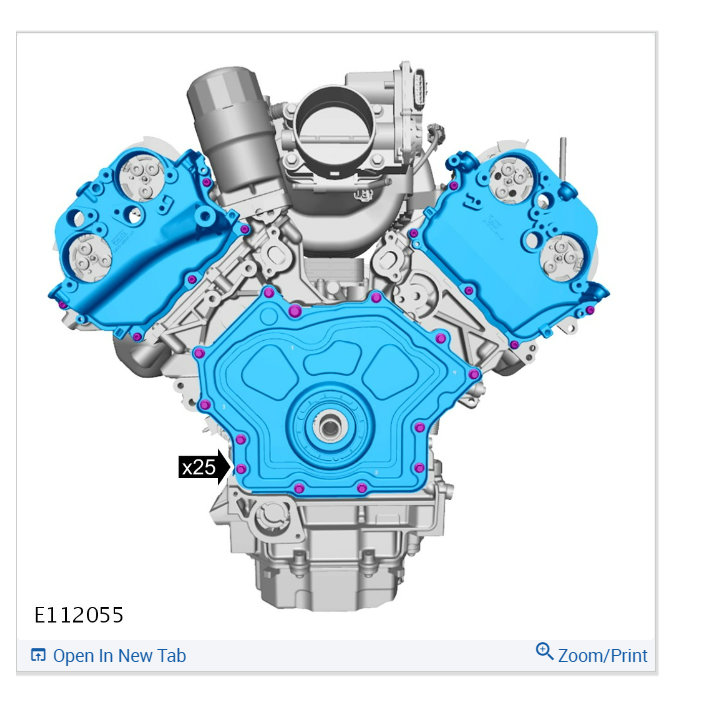

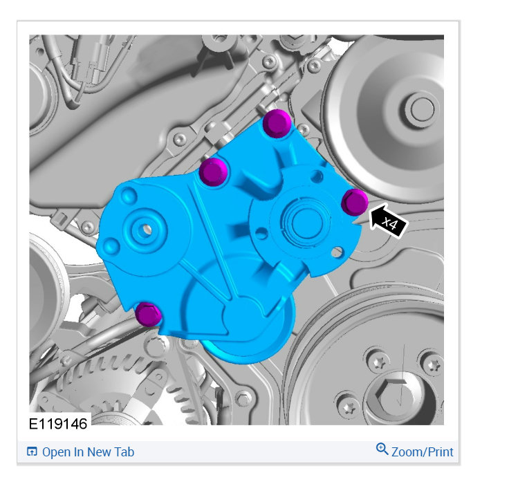

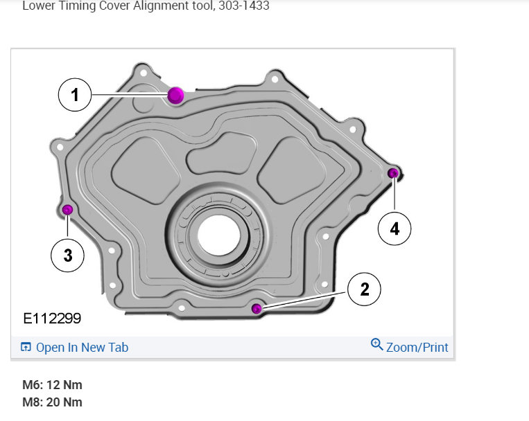

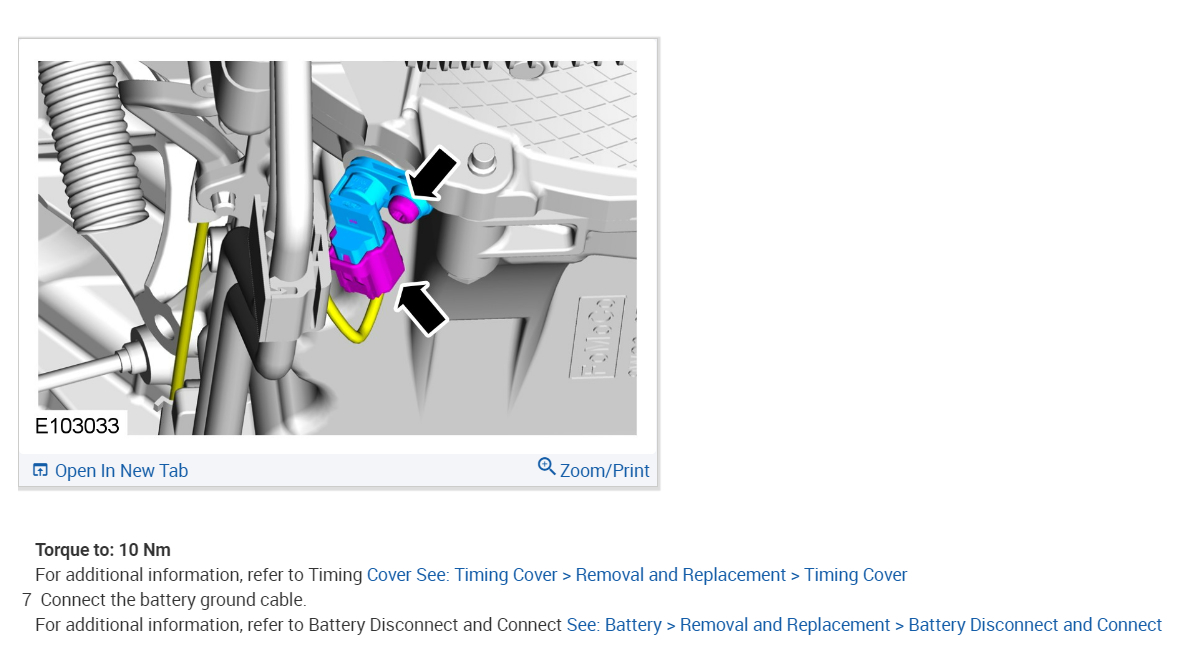

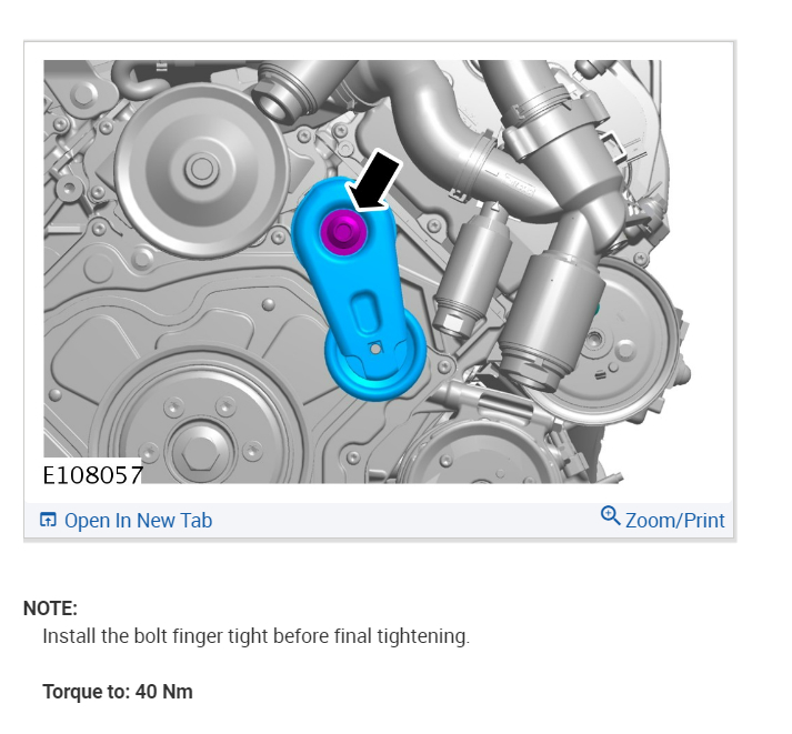

Good morning and thanks for that info. but the question I have was in search of the torque specs for the bolts on the Jaguar 5.0L engine front timing chain cover, I that valve is between 9 and 10 (N 'm) in pattern.
Jul 23, 2022 at 1:14 AM
TRANS
  • 6 POSTS
(I have the torque specs for the valve covers), just can't seem to find anything on the front timing chain cover as far as bolt torque.
Jul 23, 2022 at 1:16 AM

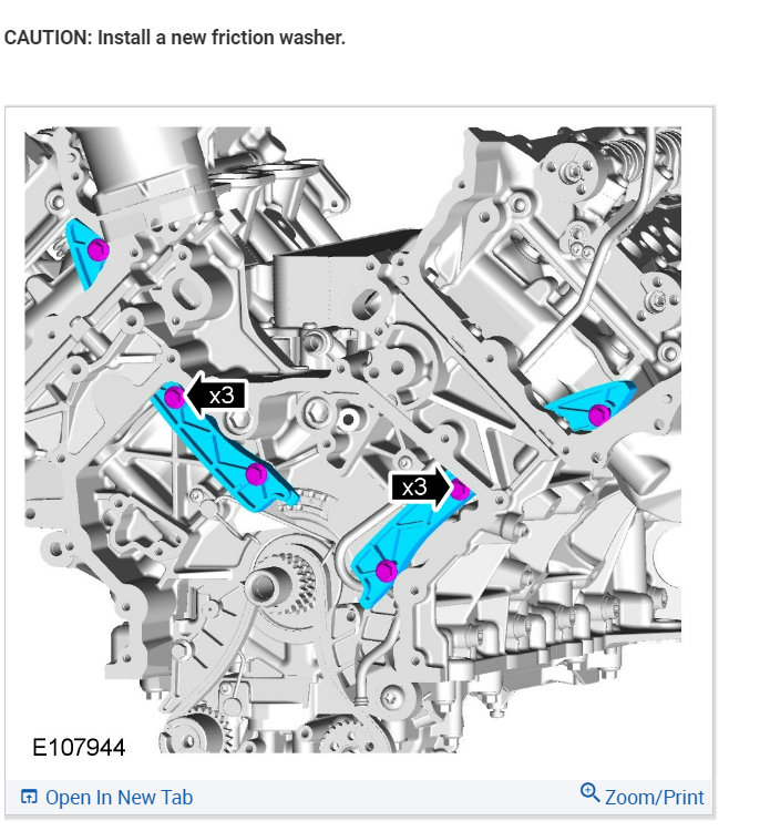

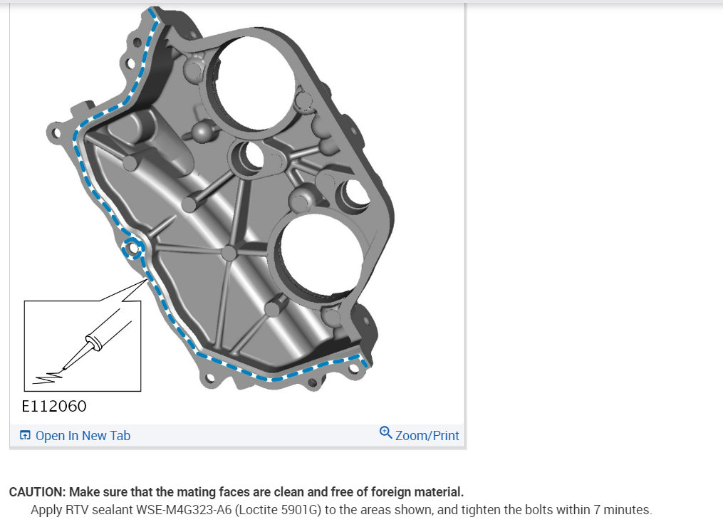

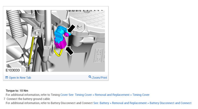

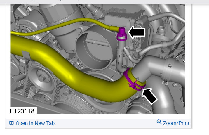

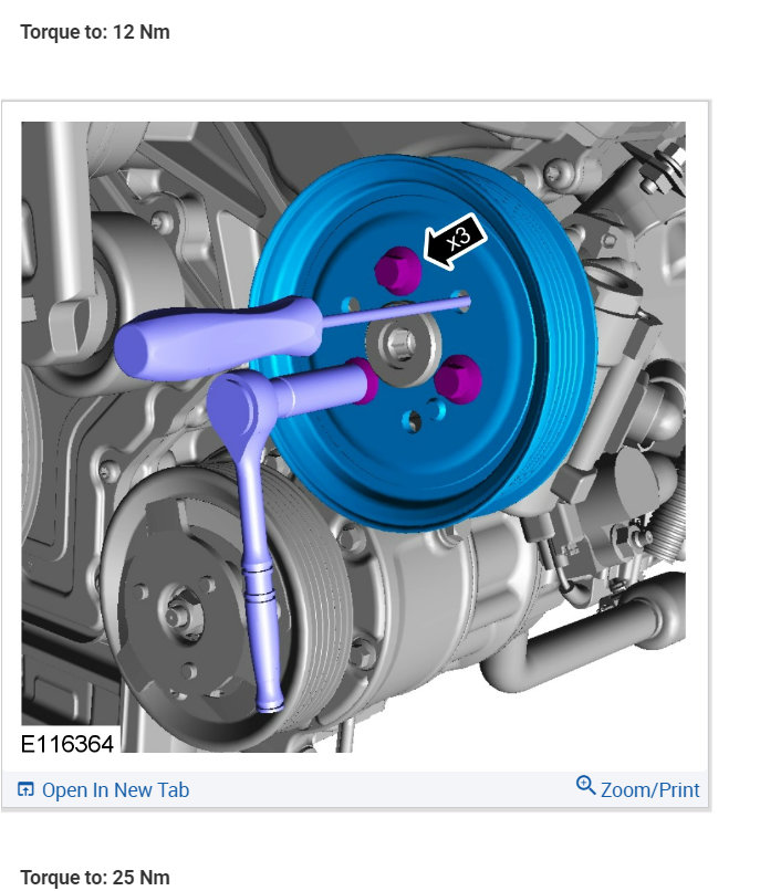

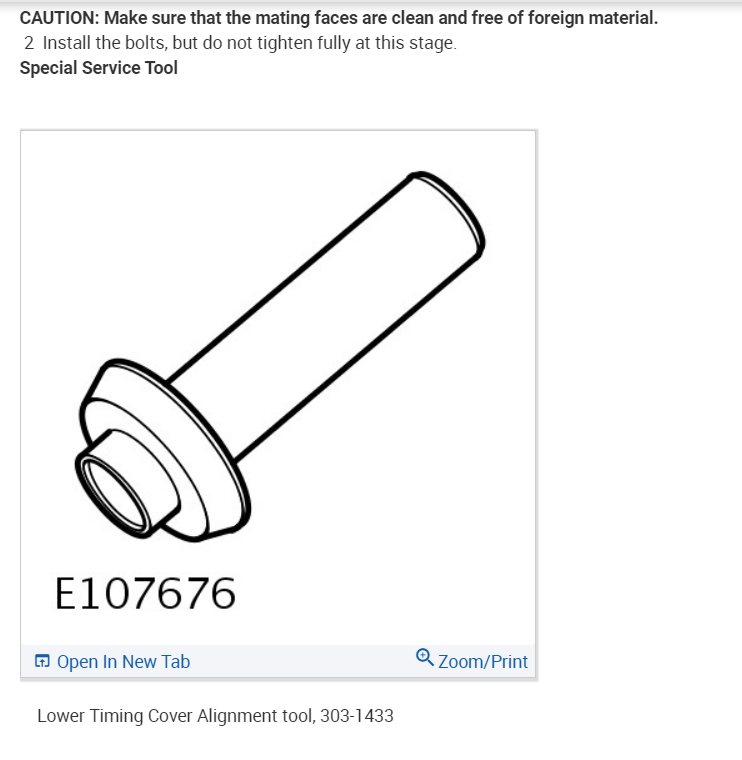

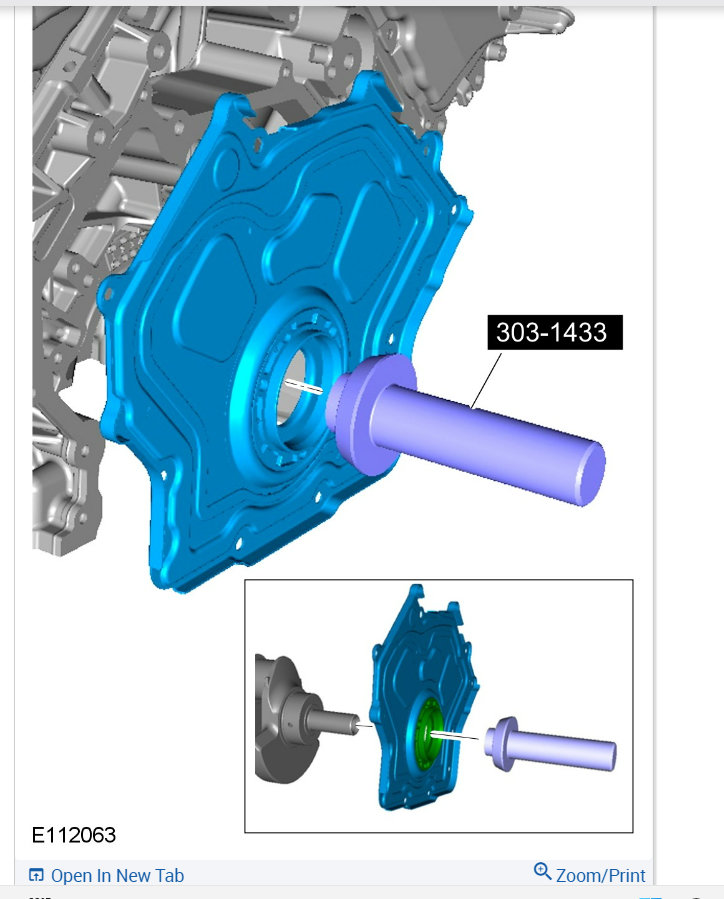

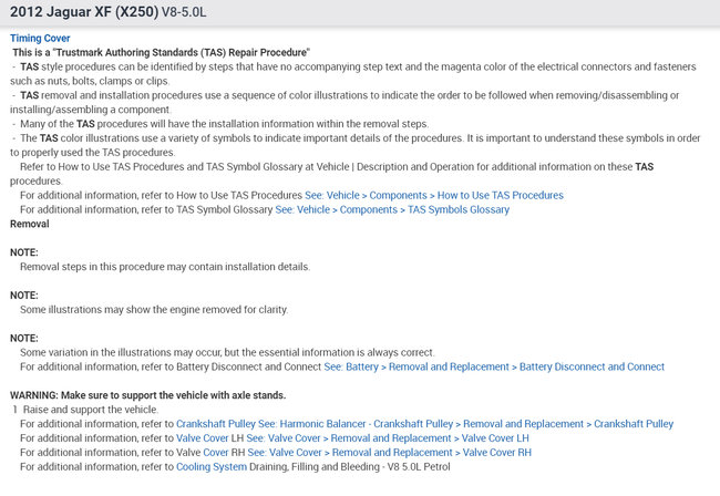

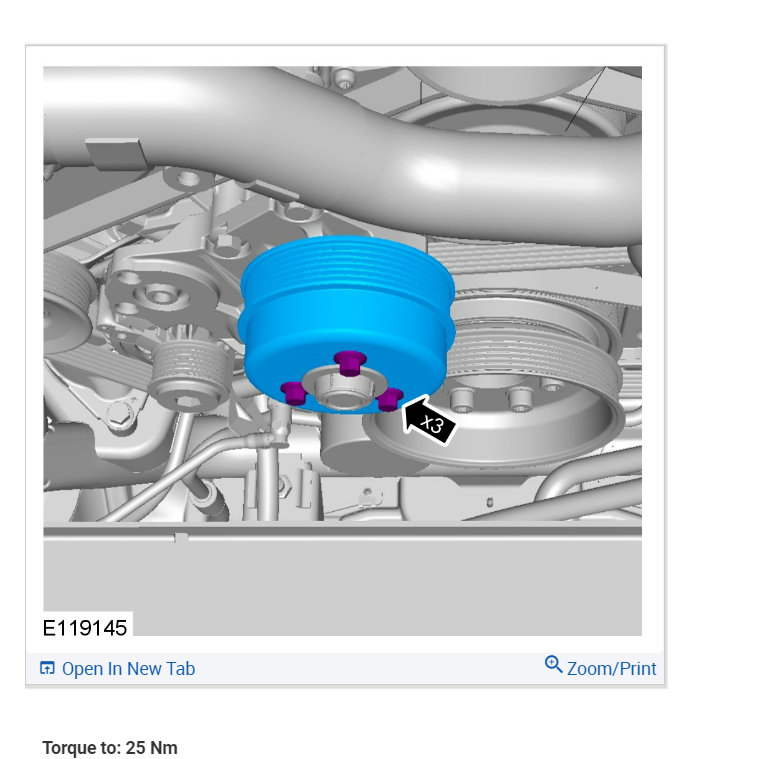

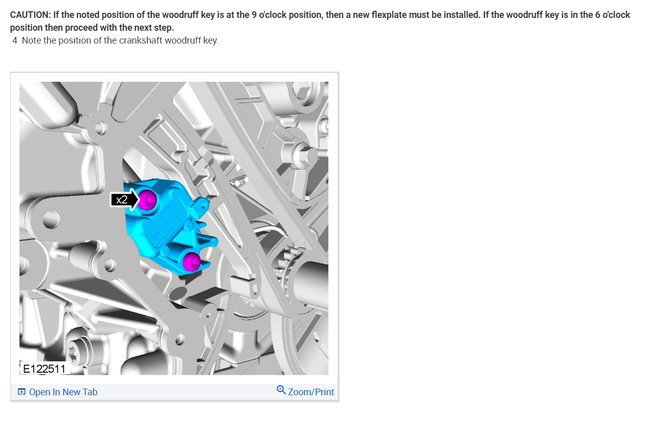

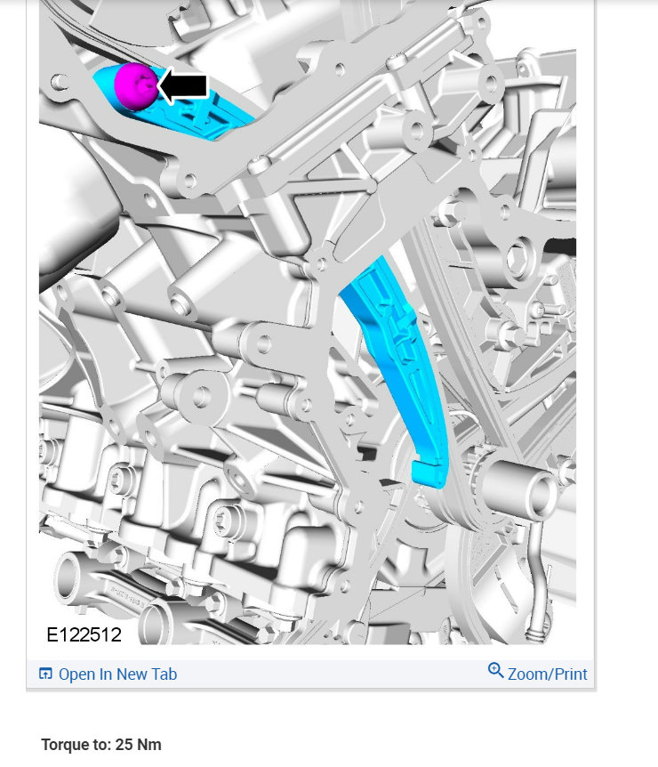

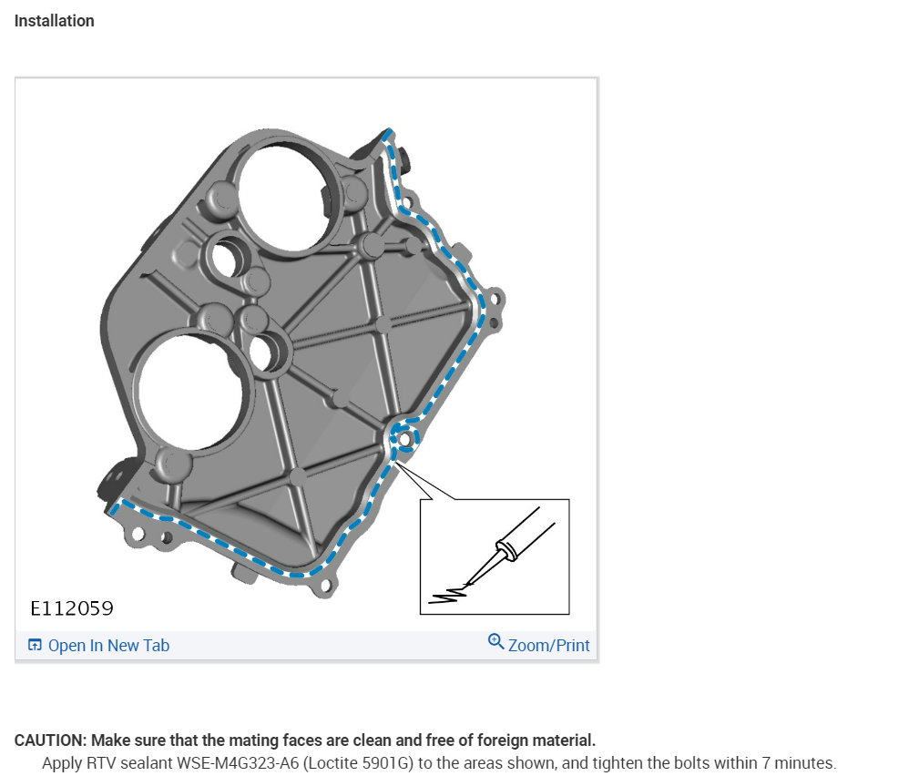

  • 55,421 POSTS

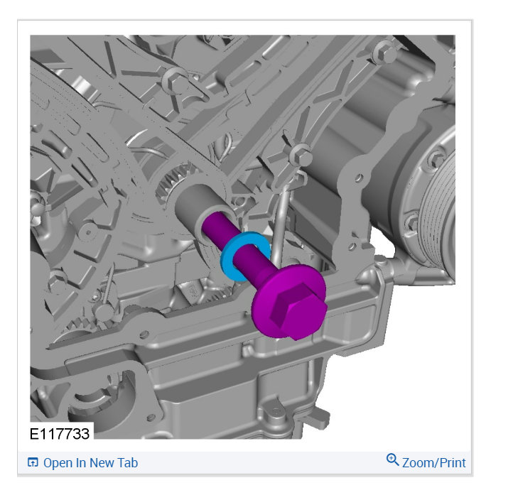

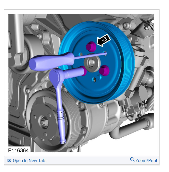

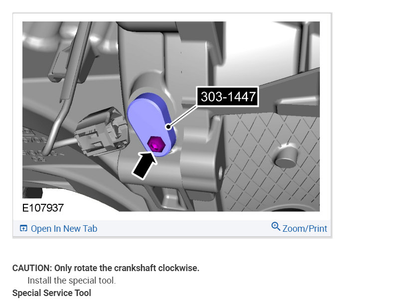

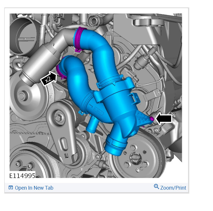

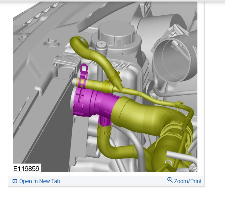

Here is the instructions and torque specs on how to replace the front cover and front main seal in the diagrams below. Please let us know if you need anything else to get the problem fixed.
Jul 24, 2022 at 4:35 AM
TRANS
  • 6 POSTS
Good morning and thank you so very much, this is what I was looking for to start my timing chain replacement job!
