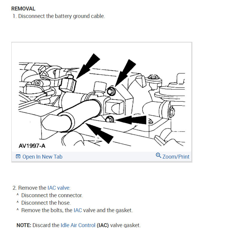

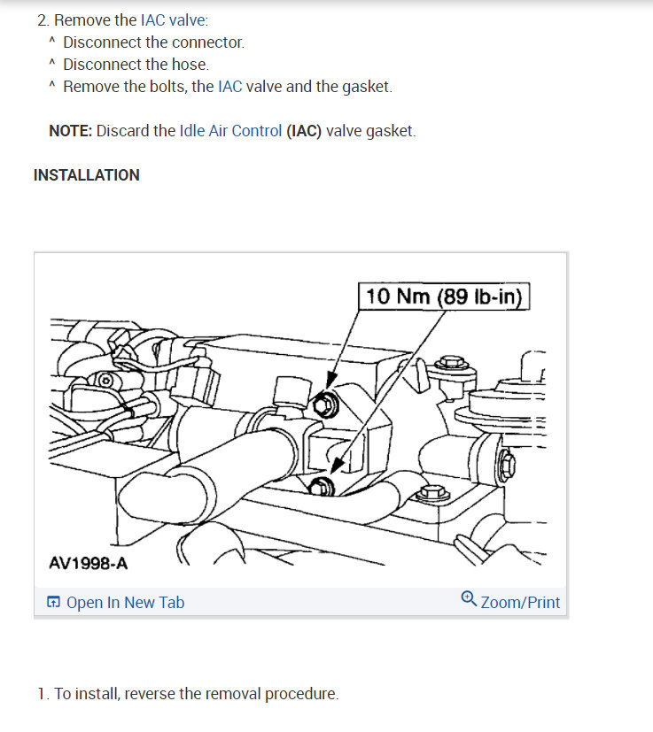

As far as the idle, I would suspect the idle air control.
https://www.2carpros.com/articles/how-to-replace-an-idle-speed-control-motor-iac
