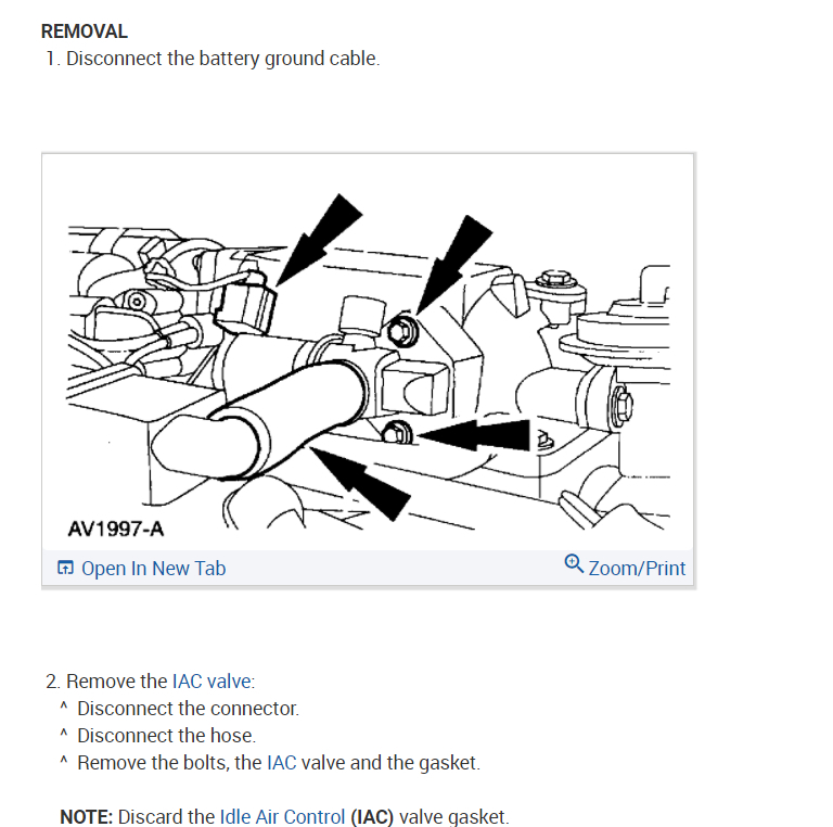

Okay, I hired a mechanic to check my timing to see if everything was right turns out I put the timing chains backwards if that makes any sense. he managed to rotate it 3 times so I went ahead and built everything up myself and now the car turns on, but now the oil pressure is down on my gauge and the car seems to shut off If I let It idle For about 10 minutes. Or if I stop at a red light. Any advice?
Aug 2, 2021 at 1:33 PM
Okay, what is the oil pressure at hot idle and at 1,200 RPMs?
Oil Pressure (Hot 1,500 RPMs) 20-45 PSI
If the pressure is low, it could be the oil pump itself. The pump is behind the timing chains on the nose of the crankshaft. It would mean tearing it down again.
https://www.2carpros.com/articles/high-or-low-engine-oil-pressure
https://www.youtube.com/watch?v=bwJfJ3kJYA0

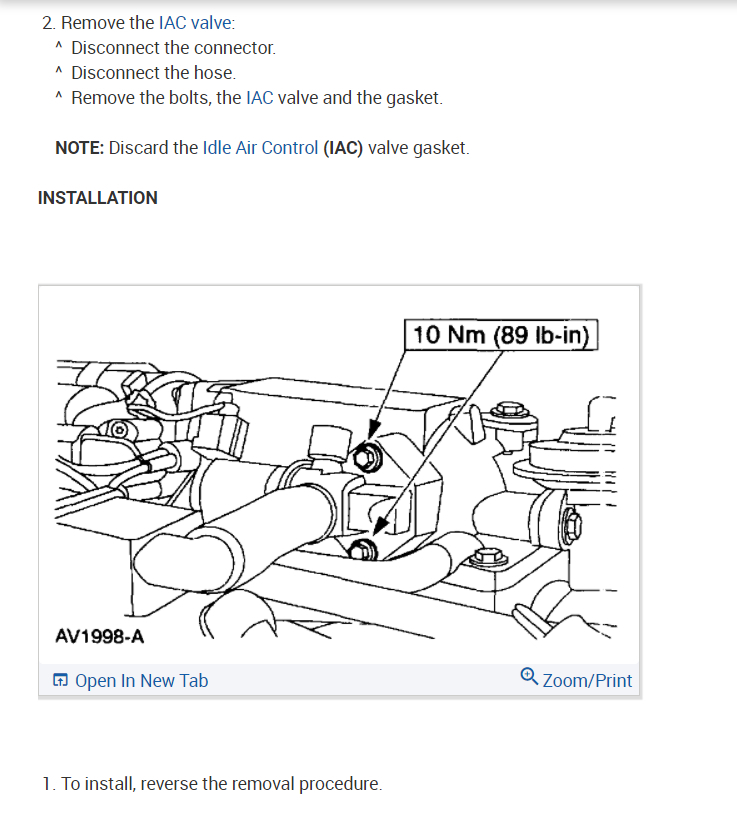

As far as the idle, I would suspect the idle air control.
https://www.2carpros.com/articles/how-to-replace-an-idle-speed-control-motor-iac
