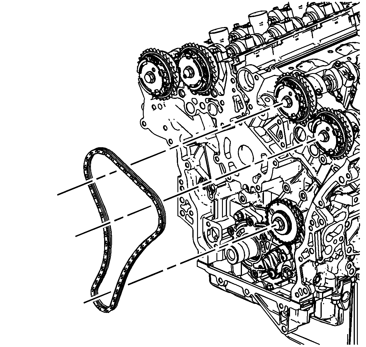

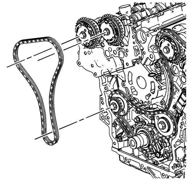

There are three different chains on this engine. I will provide the directions for one at a time. I'm not sure what he is replacing. The attached pics correlate with these directions.
____________________________________
Primary chain
2005 Cadillac Truck SRX 2WD V6-3.6L VIN 7
Primary Camshaft Drive Chain and Sprockets Replacement
Removal Procedure
1. Remove the engine front cover. See: Timing Cover > Service and Repair
2. Remove the right bank secondary camshaft drive chain tensioner. See: Engine Overhaul 22. Secondary Timing Chain Tensioner Removal - Right
3. Remove the right bank secondary camshaft drive chain shoe. See: Engine Overhaul 23. Secondary Camshaft Drive Chain Shoe Removal - Right
4. Remove the right bank secondary camshaft drive chain guide. See: Engine Overhaul 24. Secondary Timing Chain Guide Removal - Right
5. Remove the right bank secondary camshaft drive chain. See: Engine Overhaul 25. Secondary Camshaft Intermediate Drive Chain Removal - Right
6. Remove the primary camshaft drive chain tensioner. See: Engine > Overhaul 26. Primary Camshaft Intermediate Drive Chain Tensioner Removal
7. Remove the primary camshaft drive chain upper guide. See: Engine Overhaul 27. Primary Timing Chain Guide Removal - Upper
pic 1
8. Remove the primary camshaft timing chain. See: Engine > Overhaul > 29. Primary Camshaft Intermediate Drive Chain Removal
Installation Procedure
pic 2
1. Install the primary camshaft timing chain. See: Engine > Overhaul > 120. Primary Camshaft Intermediate Drive Chain Installation
2. Install the primary upper camshaft drive chain guide. See: Engine > Overhaul > 122. Primary Timing Chain Guide Installation - Upper
3. Install the primary camshaft drive chain tensioner. See: Engine > Overhaul > 123. Primary Camshaft Intermediate Drive Chain Tensioner Installation
4. Install the right bank secondary camshaft drive chain. See: Engine > Overhaul > 124. Secondary Camshaft Intermediate Drive Chain Installation - Right
5. Install the right bank secondary camshaft drive chain guide. See: Engine > Overhaul > 125. Secondary Timing Chain Guide Installation - Right
6. Install the right bank secondary camshaft drive chain shoe. See: Engine > Overhaul > 126. Secondary Camshaft Drive Chain Shoe Installation - Right
7. Install the right bank secondary camshaft drive chain tensioner. See: Engine > Overhaul > 127. Secondary Timing Chain Tensioner Installation - Right
8. Install the engine front cover. See: Timing Cover > Service and Repair

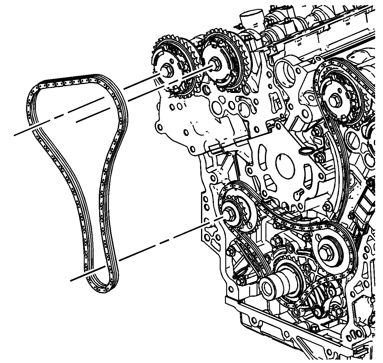

Secondary Camshaft Chain left side
Secondary Camshaft Intermediate Drive Chain Replacement - Left
Removal Procedure
6. Remove the primary camshaft drive chain tensioner. See: Engine Overhaul 26. Primary Camshaft Intermediate Drive Chain Tensioner Removal
7. Remove the primary upper camshaft drive chain guide. See: Engine Overhaul 27. Primary Timing Chain Guide Removal - Upper
8. Remove the primary camshaft drive chain. See: Engine Overhaul 29. Primary Camshaft Intermediate Drive Chain Removal
9. Remove the right bank camshaft intermediate drive chain idler. See: Engine Overhaul 30. Timing Chain Idler Sprocket Removal - Right
10. Remove the left bank secondary camshaft drive chain tensioner. See: Engine Overhaul 31. Secondary Timing Chain Tensioner Removal - Left
11. Remove the left bank secondary camshaft drive chain shoe. See: Engine Overhaul 32. Secondary Camshaft Drive Chain Shoe Removal - Left
12. Remove the left bank secondary camshaft drive chain guide. See: Engine Overhaul 33. Secondary Timing Chain Guide Removal - Left
13. Remove the left bank camshaft intermediate drive chain idler. See: Engine Overhaul 35. Timing Chain Idler Sprocket Removal - Left
pic 3
14. Remove the left bank secondary camshaft drive chain. See: Engine Overhaul 34. Secondary Camshaft Intermediate Drive Chain Removal - Left
15. Clean and inspect all of the camshaft timing drive components. Replace components as necessary. See: Engine Overhaul 70. Camshaft Timing Drive Components Clean and Inspect

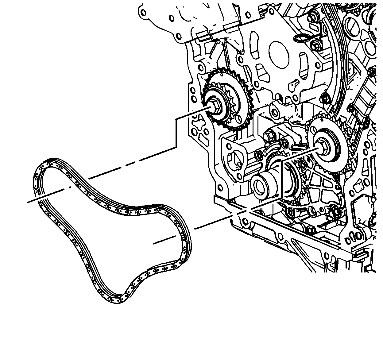

pic 4
1. Install the left bank secondary camshaft drive chain. See: Engine Overhaul 115. Secondary Camshaft Intermediate Drive Chain Installation - Left
2. Install the left bank camshaft intermediate drive chain idler. See: Engine Overhaul 114. Timing Chain Idler Sprocket Installation - Left
3. Install the left bank secondary camshaft drive chain guide. See: Engine Overhaul 116. Secondary Timing Chain Guide Installation - Left
4. Install the left bank secondary camshaft drive chain shoe. See: Engine Overhaul 117. Secondary Camshaft Drive Chain Shoe Installation - Left
5. Install the left bank secondary camshaft drive chain tensioner. See: Engine Overhaul 118. Secondary Timing Chain Tensioner Installation - Left
6. Install the right bank camshaft intermediate drive chain idler. See: Engine Overhaul 119. Timing Chain Idler Sprocket Installation - Right
7. Install the primary camshaft drive chain. See: Engine Overhaul 120. Primary Camshaft Intermediate Drive Chain Installation
8. Install the primary upper camshaft drive chain guide. See: Engine Overhaul 122. Primary Timing Chain Guide Installation - Upper
9. Install the primary camshaft drive chain tensioner. See: Engine Overhaul 123. Primary Camshaft Intermediate Drive Chain Tensioner Installation
10. Install the right bank secondary camshaft drive chain. See: Engine Overhaul 124. Secondary Camshaft Intermediate Drive Chain Installation - Right
11. Install the right bank secondary camshaft drive chain guide. See: Engine Overhaul 125. Secondary Timing Chain Guide Installation - Right
12. Install the right bank secondary camshaft drive chain shoe. See: Engine Overhaul 126. Secondary Camshaft Drive Chain Shoe Installation - Right
13. Install the right bank secondary camshaft drive chain tensioner. See: Engine Overhaul 127. Secondary Timing Chain Tensioner Installation - Right
14. Install the engine front cover. See: Timing Cover Service and Repair
