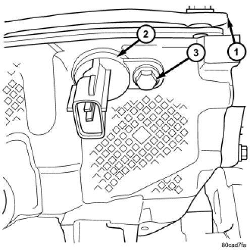

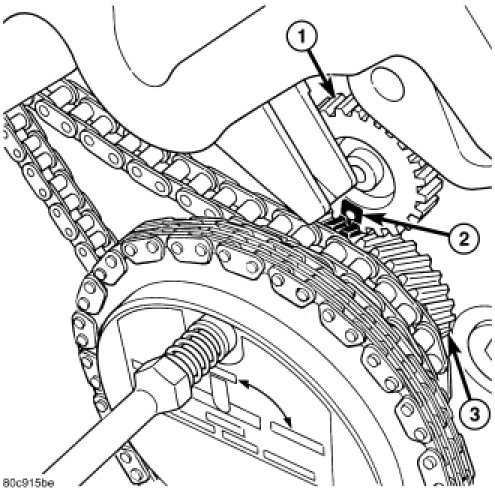

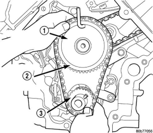

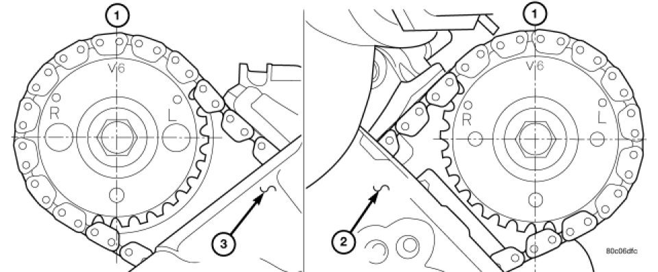

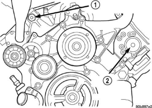

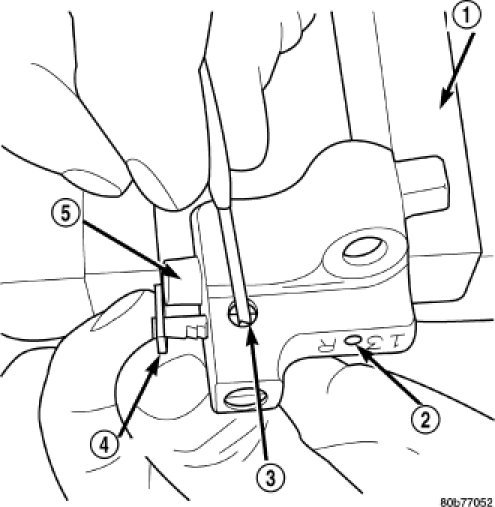

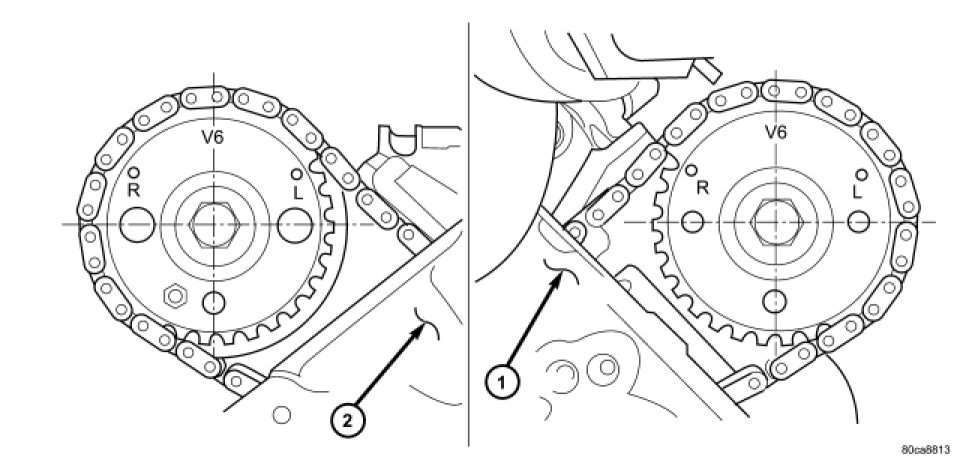

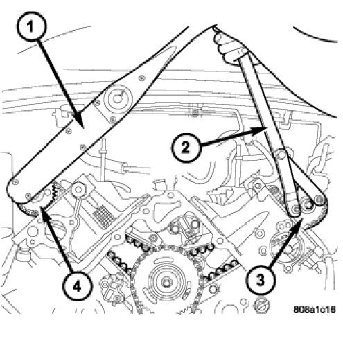

Here are the directions for removal/replacement. The attached pictures correlate with the directions.

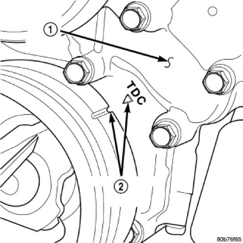

5. Rotate engine until timing mark on crankshaft damper (2) aligns with TDC mark on timing chain cover (2) and the camshaft sprocket "V6" marks are at the 12 o'clock position (No. 1 TDC exhaust stroke).

9. Remove crankshaft damper and timing chain cover.

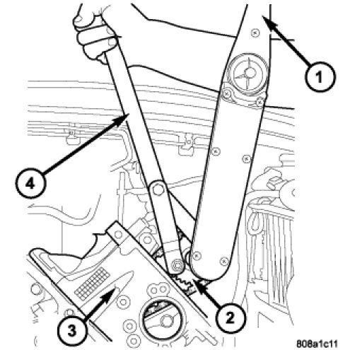

10. Collapse and pin primary chain tensioner.
CAUTION: Plate behind left secondary chain tensioner could fall into oil pan. Therefore, cover pan opening.

12. Remove camshaft position sensor (2).
CAUTION: Care should be taken not to damage camshaft target wheel. Do not hold target wheel while loosening or tightening camshaft sprocket. Do not place the target wheel near a magnetic source of any kind. A damaged or magnetized target wheel could cause a vehicle no start condition.

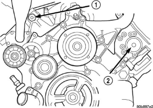

1. Using a vise, lightly compress the secondary chain tensioner piston (5) until the piston step is flush with the tensioner body. Using a pin or suitable tool, release ratchet pawl by pulling pawl back against spring force through access hole on side of tensioner. While continuing to hold pawl back, Push ratchet device to approximately 2 mm from the tensioner body. Install Special Tool 8514 lock pin (3) into hole on front of tensioner. Slowly open vise (1) to transfer piston spring force to lock pin.

7. Install both secondary chains onto the idler sprocket. Align two plated links on the secondary chains to be visible through the two lower openings on the idler sprocket (4 o'clock and 8 o'clock). Once the secondary timing chains are installed, position special tool 8429 (1) to hold chains in place for installation.

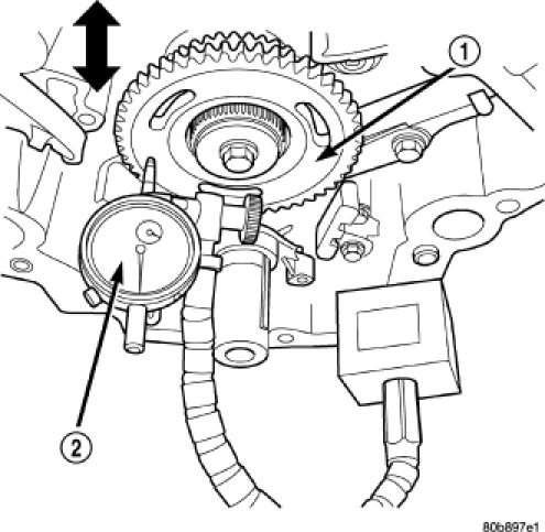

20. After installing all chains, it is recommended that the idler gear end play be checked. The end play must be within 0.10-0.25 mm (0.004 - 0.010 in.). If not within specification, the idler gear must be replaced.
