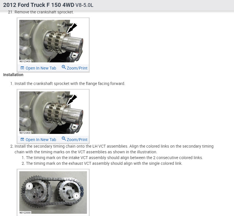

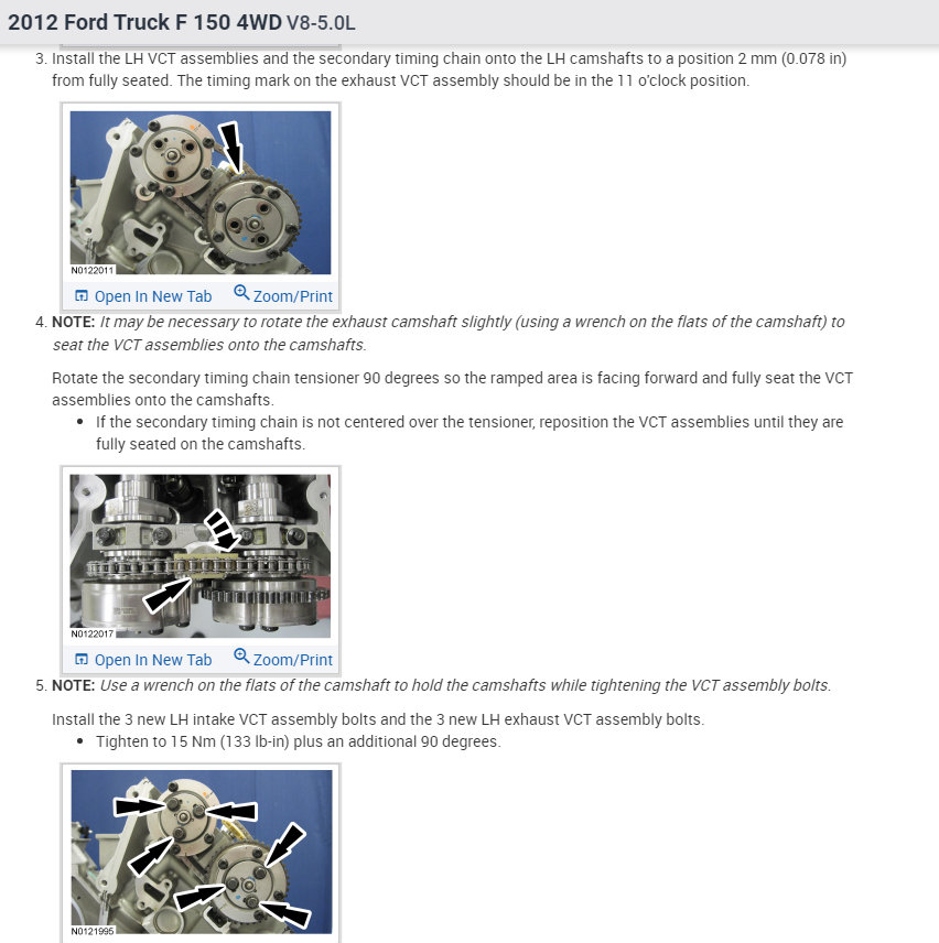

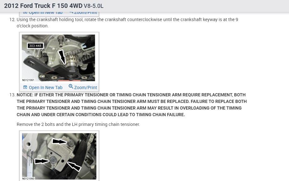

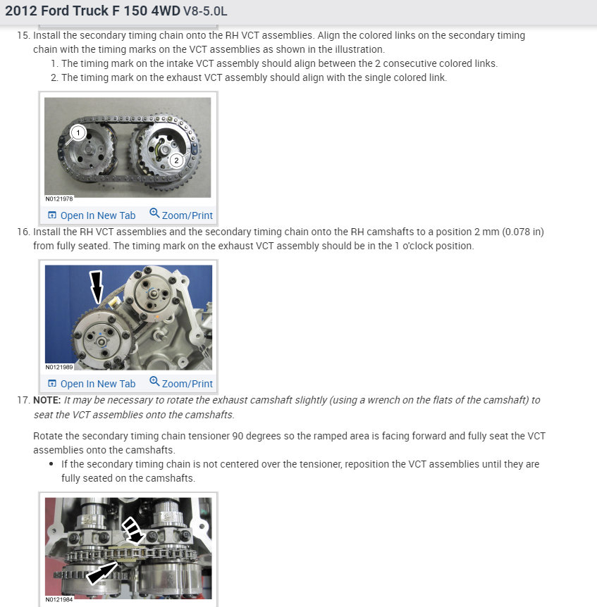

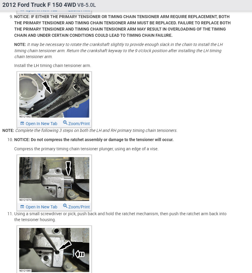

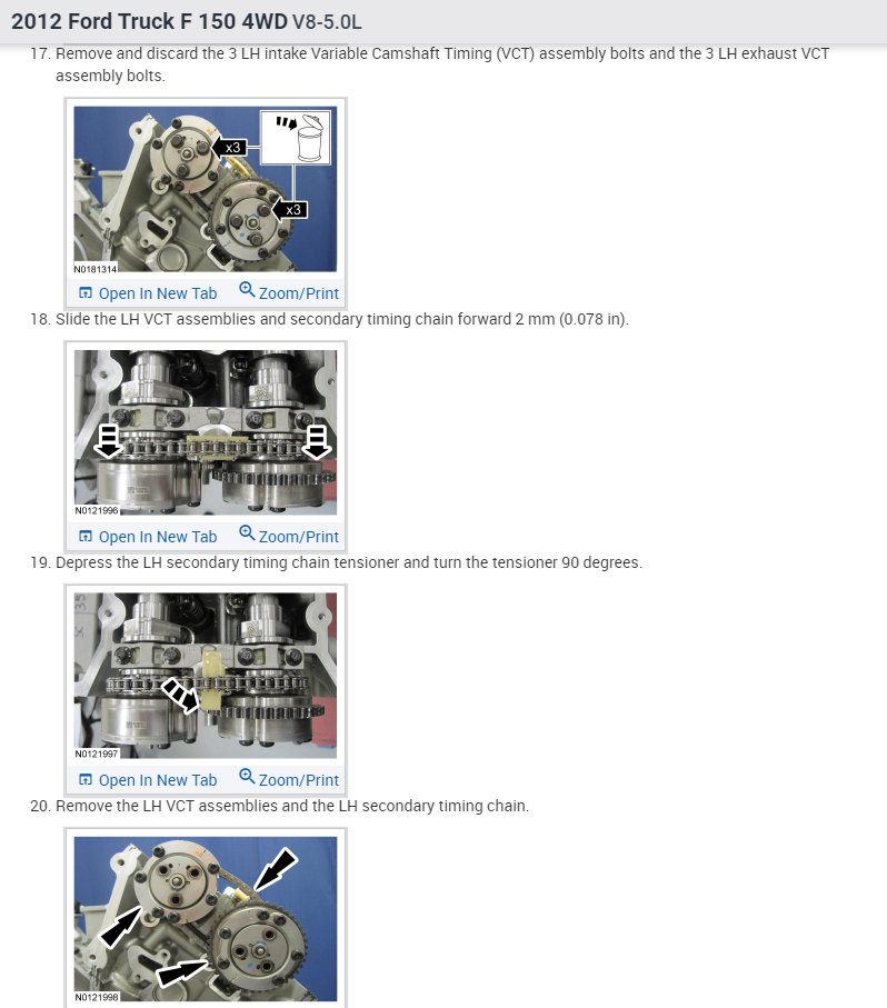

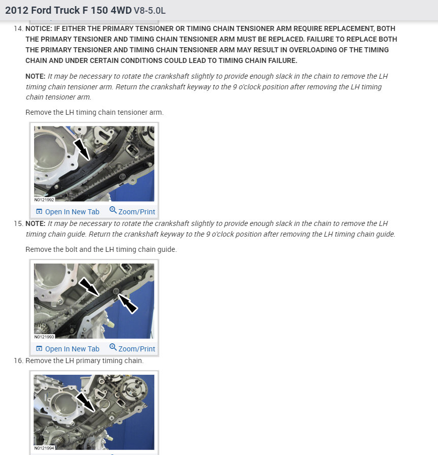

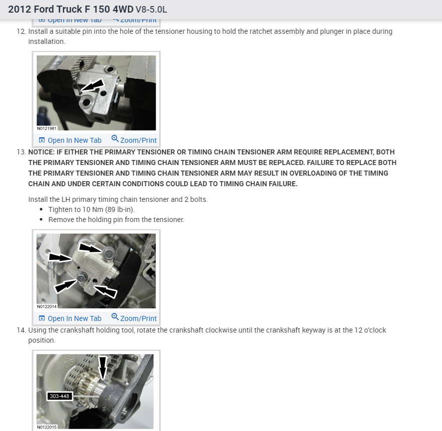

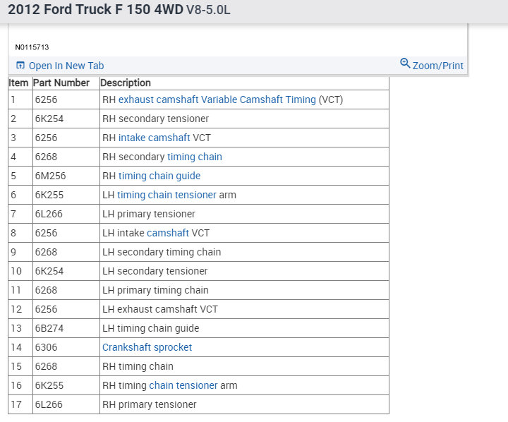

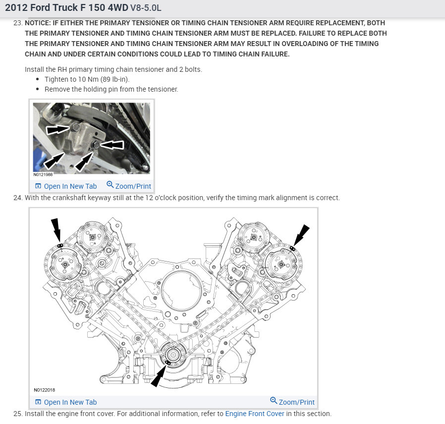

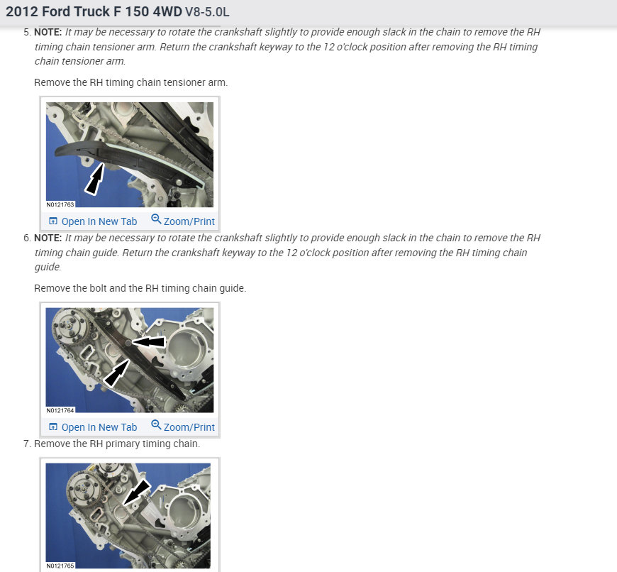

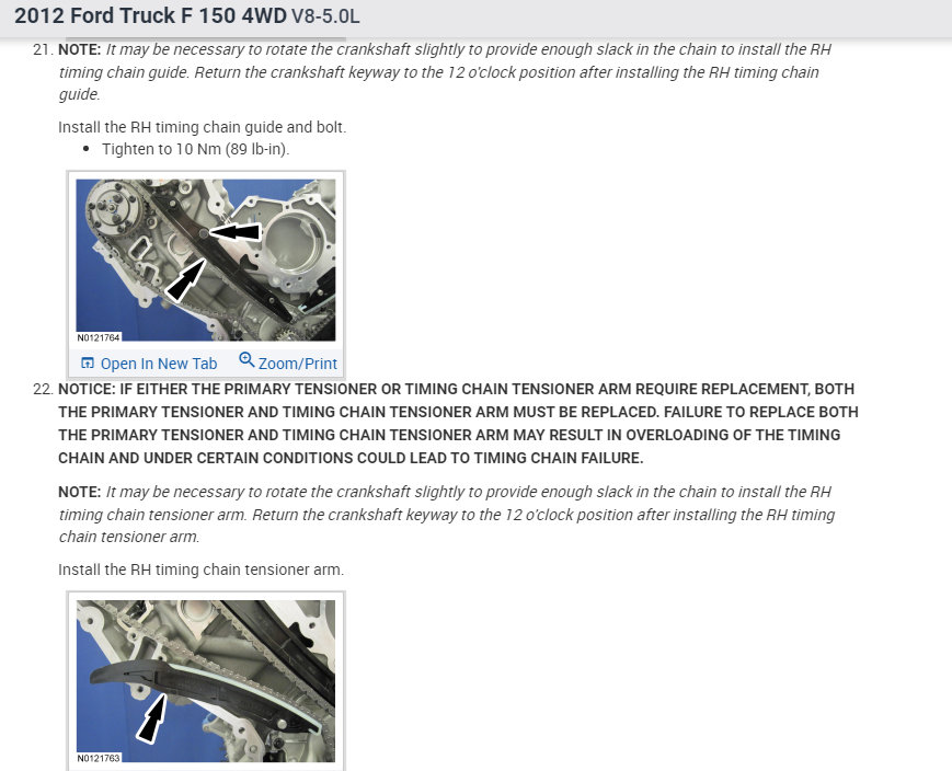

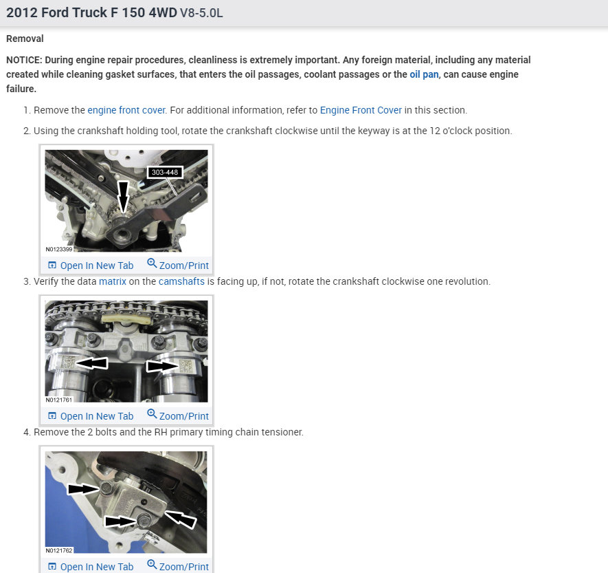

I need the process on how to remove to reinstall.
Jul 2, 2022 at 12:10 AM
SQM
Experienced Mechanic
6,383 POSTS

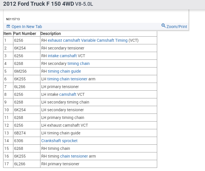

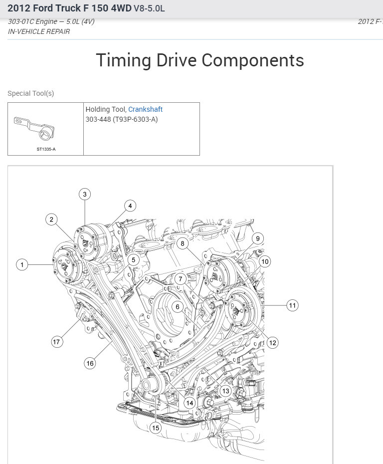

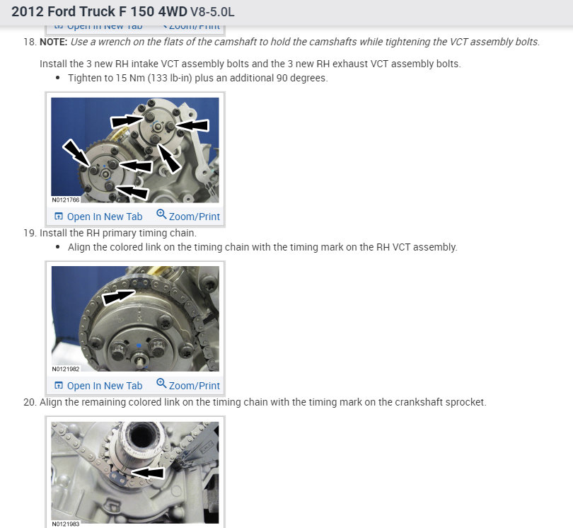

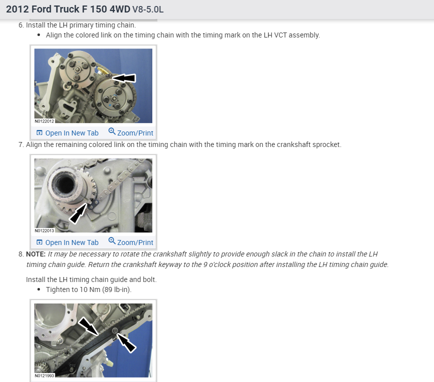

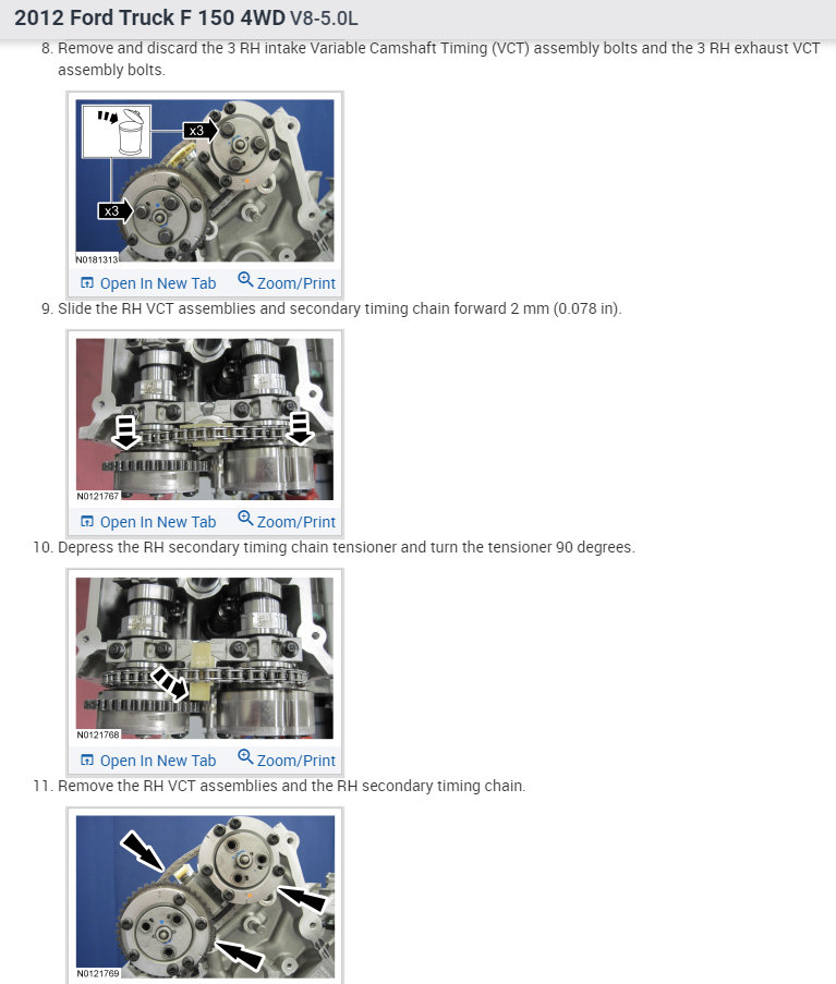

See attached for the timing chain replacement procedure.
Let me know of any questions.
